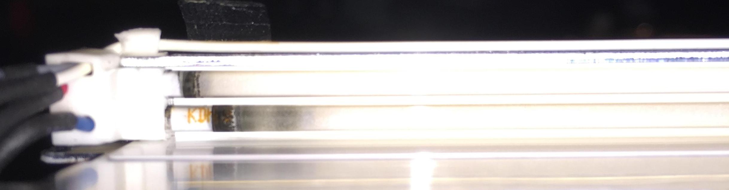

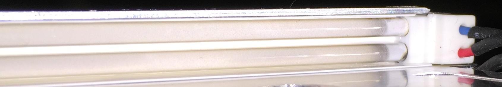

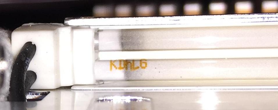

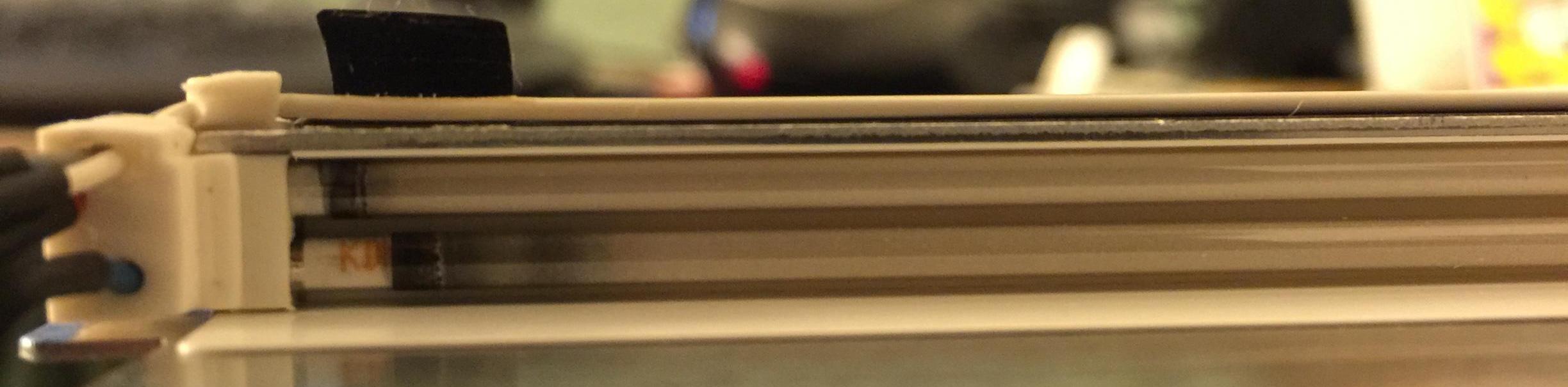

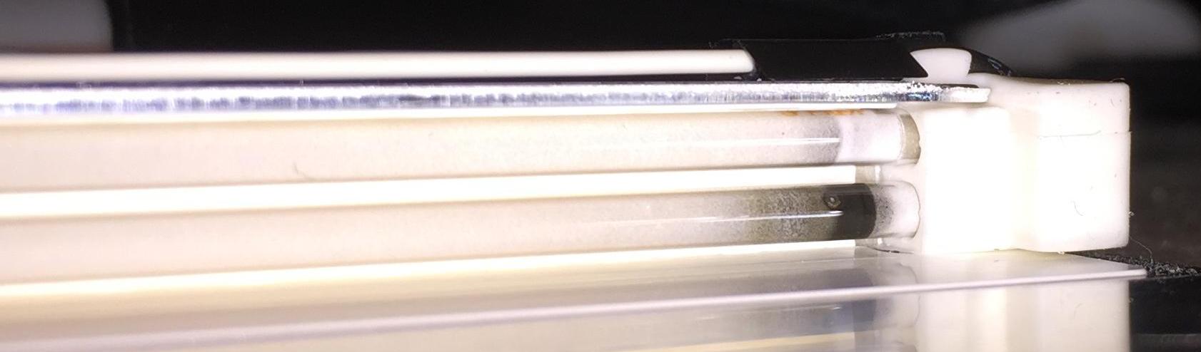

      Thank you for the links. I have dismantled my LCD display unit to get to the CCFLs. I would like to defer to expertise here to inform me if I should replace all 4, or just the one that causes the display issues.
      I have the attached photos:
      The two photos of the CCFLs with the larger blackened areas are the same CCFL. I've identified it as the cause of the "2 secs to black" before I even saw them.
      But looking at the others I wonder if they all should be replaced.
        Re: Acer X233H - bad CCFL
        I will do all four, you do not want to take at apart again, blackened ends like that are bad, it is not going to be cheap.
