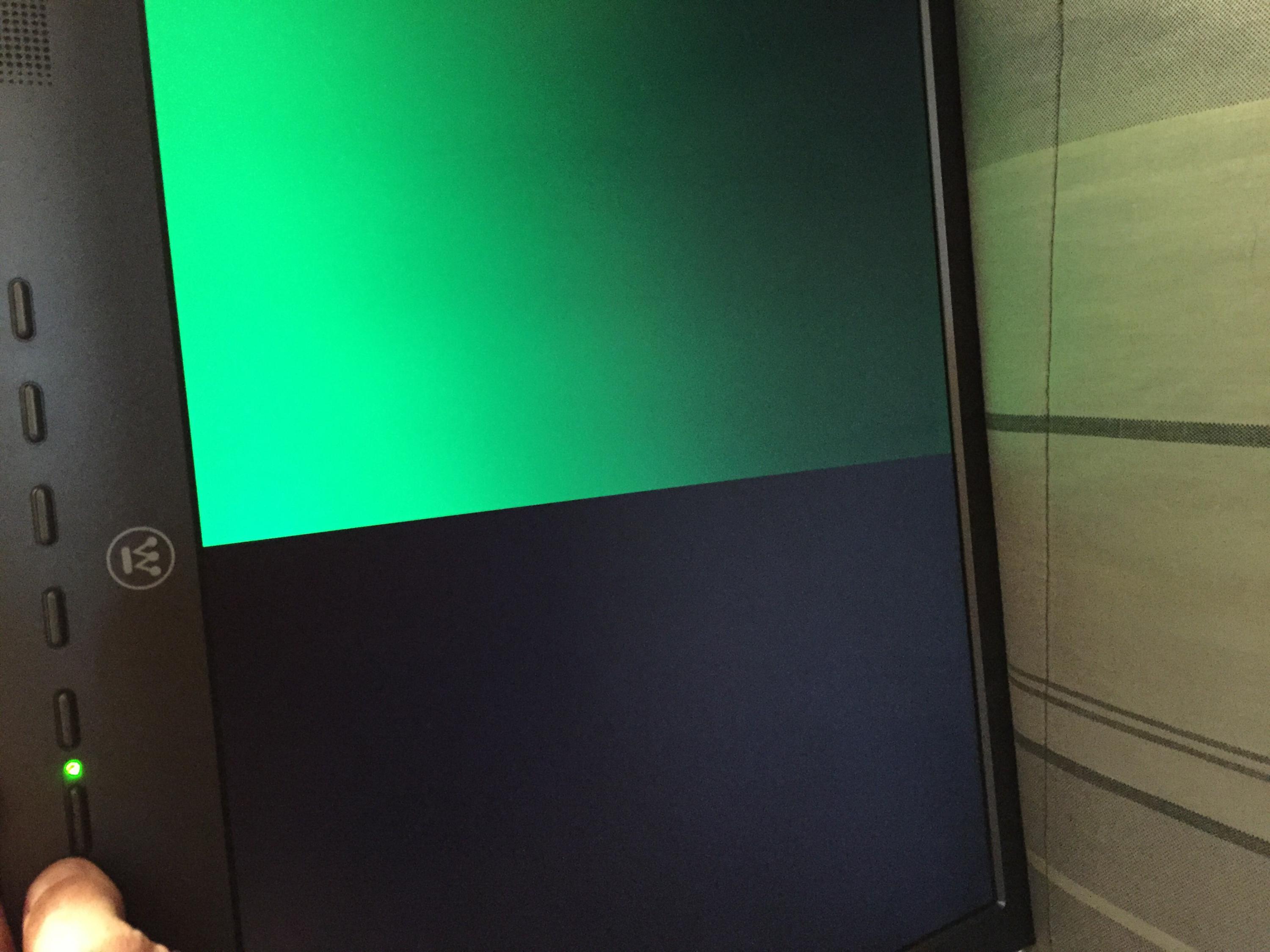

                            Ok I think there's an issue with one of the ccfls. I disconnected the pink/white cable one and plugged in the blue/white connector in its place and the screen flashed this. If I leave blue/white connector in place and just unplug pink/white I get no flash of backlights at all but you can see a "no signal" image
                            • caphair
                              • Nov 2011
                              • 1249
                              #34
                              Re: Westinghouse A190E3-H01 no backlight / shutdown
                              Fixed. Turned out to be a bad connection at one of the CCFLs. Carefully soldered and it's up and running!
                                #35
                                Thanks for the follow-up. So the arcing you were hearing then is from the lamp as I suspected in the beginning of the thread?

                                  It didn't sound like arcing just high frequency. I took panel apart and powered it on and the same noise was heard on the return lines from the ccfls so I figured I'd check the connections out and one of the wires just came apart when handling. Resoldered and all is good.
