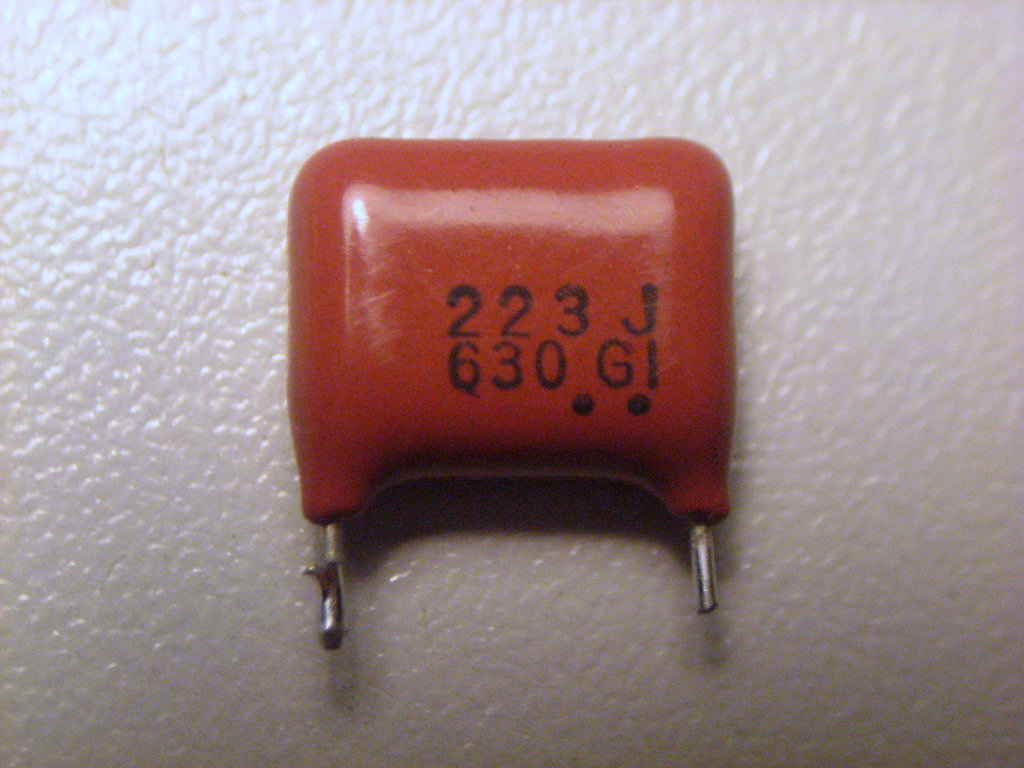

    I don't know what to do. Then I see that it has a polyester film capacitor 22nF 630V ("223J 630V" marking) in parallel with the primary electrolytic filter (150uF/450V). This film capacitor is exactly the same guy than the one from Yamaha receivers and sound bars that fail so nicely and that have been spotted years ago.
    So, nothing to lose, I change it and... it works!! I'll test it more thoroughly to be sure, but I couldn't get it to work not a single time before, so, what should I think?

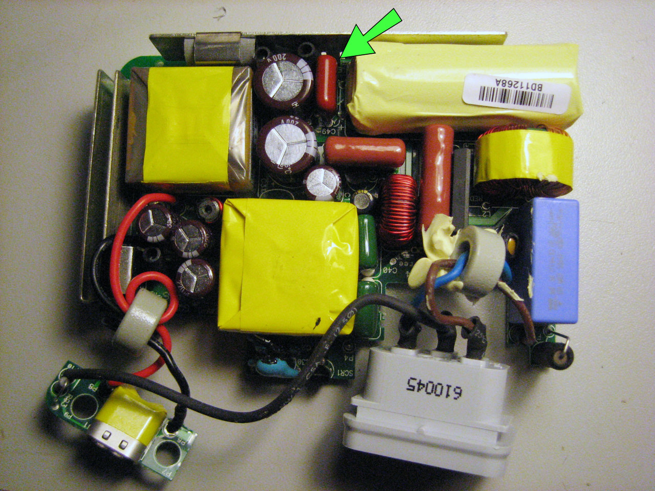

    Can we see this cap and how it is really connected in parallel with the main filter cap to have affect the operation of the circuit? it sounds more likely to be connected to one end of the main switching transformer primary winding and part of the primary drive circuit.

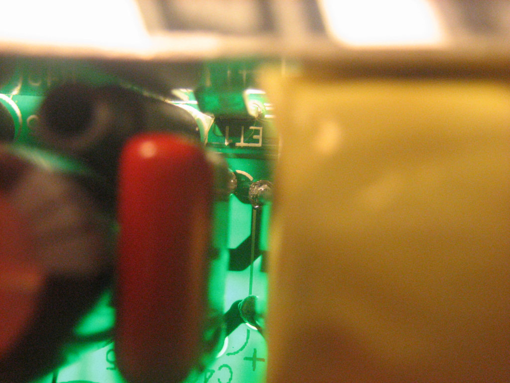

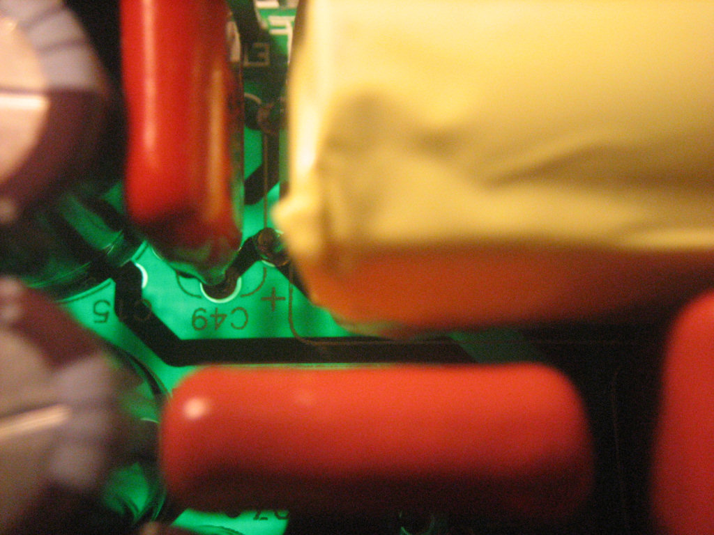

      The PCB is densely populated and double sided, so it’s very difficult to see the tracks on the component side when the components are mounted. I’ve rechecked it with multimeter and the film capacitor is in parallel with the primary HV filter capacitor. Don’t ask me why. I checked the primary voltage while the power supply was failing and the 320V DC were there (230V AC mains here), so apparently there wasn’t anything wrong.
      The capacitor is almost identical to the one that fails on Yamaha receivers (several models affected), pictures here:
      https://www.avforums.com/threads/yam...oblem.1533016/
      The only difference is that the one from Apple’s power supply has tolerance J (5%) and Yamaha’s is K (10%). I’ve replaced it with a K.
      I remember that I knew about this failure two years ago through a Yamaha’s service bulletin. It could be extrapolated to several models of receivers and sound bars. No power? Just find if the PSU has the famous 22nF 630V film cap in primary section and 90% you’re done. Never thought that could even be extrapolated to something so different like this.

              I still doubt very much if that cap is directly connected in parallel with the main filter cap.

                  That cap is the used for capacitive power supply circuit, it is basically used as the Voltage dropping resistor, not connected in parallel with the main filter cap.
                  https://cdn.badcaps-static.com/pdfs/...5df14516be.pdf
                  https://cdn.badcaps-static.com/pdfs/...4cc8de4108.pdf
                  http://michaelgellis.tripod.com/capsup.html
                  I use this kind of setup in lots of the products I designed.

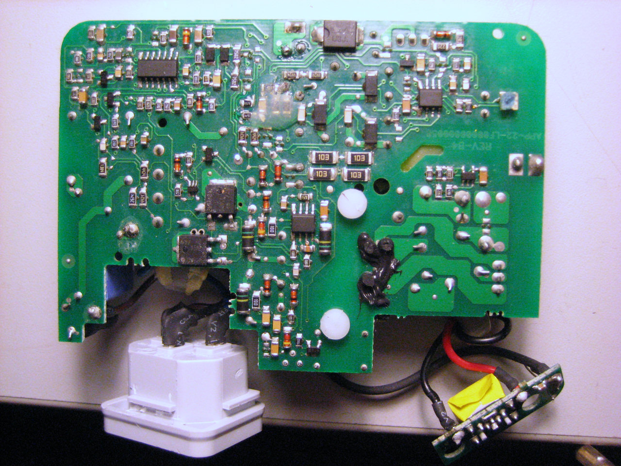

                    I've attached pictures of this thing. First, the actual cap. Then, the board, both sides. And finally, two pictures trying to show that this cap is in parallel with the primary filter cap (wrapped in yellow tape). I've put a light behind the board because these tracks are on the component side.
