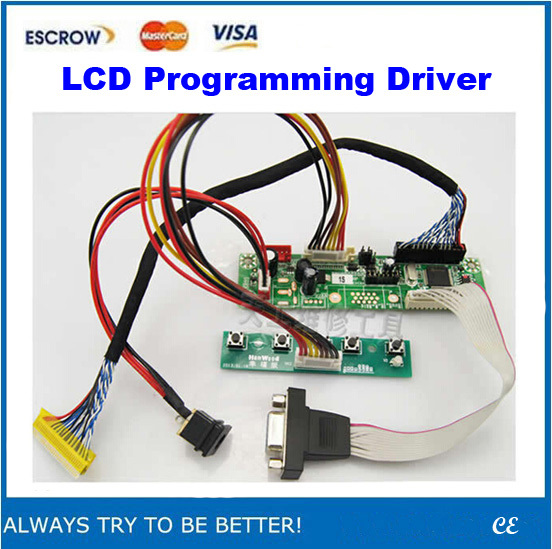

              Universal LCD controller board from China it is then $7 delivered with all the cables included, jumpers to set resolution.

                That will be interesting - not seen one before. Please update when you try it.
                  Re: Acer AL1916 pink tint
                  It might work, as long as the pinout for the LVDS connector is correct, or you can rewire it if it's not. It sounds like an interesting device. I might have to give one a try myself and see what it's like.

                    Attached a picture of that universal controller. Don't hold your breath though, delivery time is 15-30 business days

                      I wonder how it will know which pins are power pins for the LCD panel will be for the T-CON on the LCD panel beside the correct LVDS signal lines. You can easily damage this board or the T-con board if the power pin is not correct.
                      The spec sheet of the LCD panel will be required to get the pin out.
                        I don't think it will automatically work like that. That's why I said he will have to verify the pinouts before powering it up. From the pictures I saw online (though it was for a different, but similar board) they have silkscreened the connector names on the board for the LVDS connector so it shouldn't be too hard.

                          That is why I bring that up, he must be real careful.
