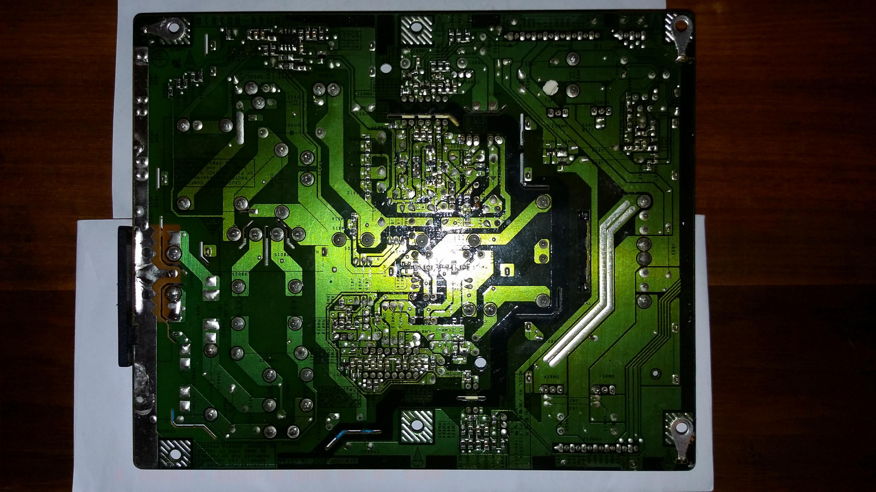

    Issue: over a couple weeks, black flicker on turning on after having been off for a while has grown from a few seconds to nearly a minute.
    I've opened the monitor up and see no obvious fault, such as bloated caps or burnt pcb
    - but a few weeks ago there was detected a burning electric smell in my computer room for which I found no source and which disappeared after a while.
    I haven't seen them listed elsewhere for the 2693hm, so I'll list its cap values here for other people:
    3x 1000uf 35v
    1x 1000uf 25v
    2x 2200uf 10v
    2x 47uf 50v
    2x 22uf 50v
    2x 2.2uf 50v
    And there's one more that I can't discern because it has caulking covering it, CP803. 13 larger capacitors in total.

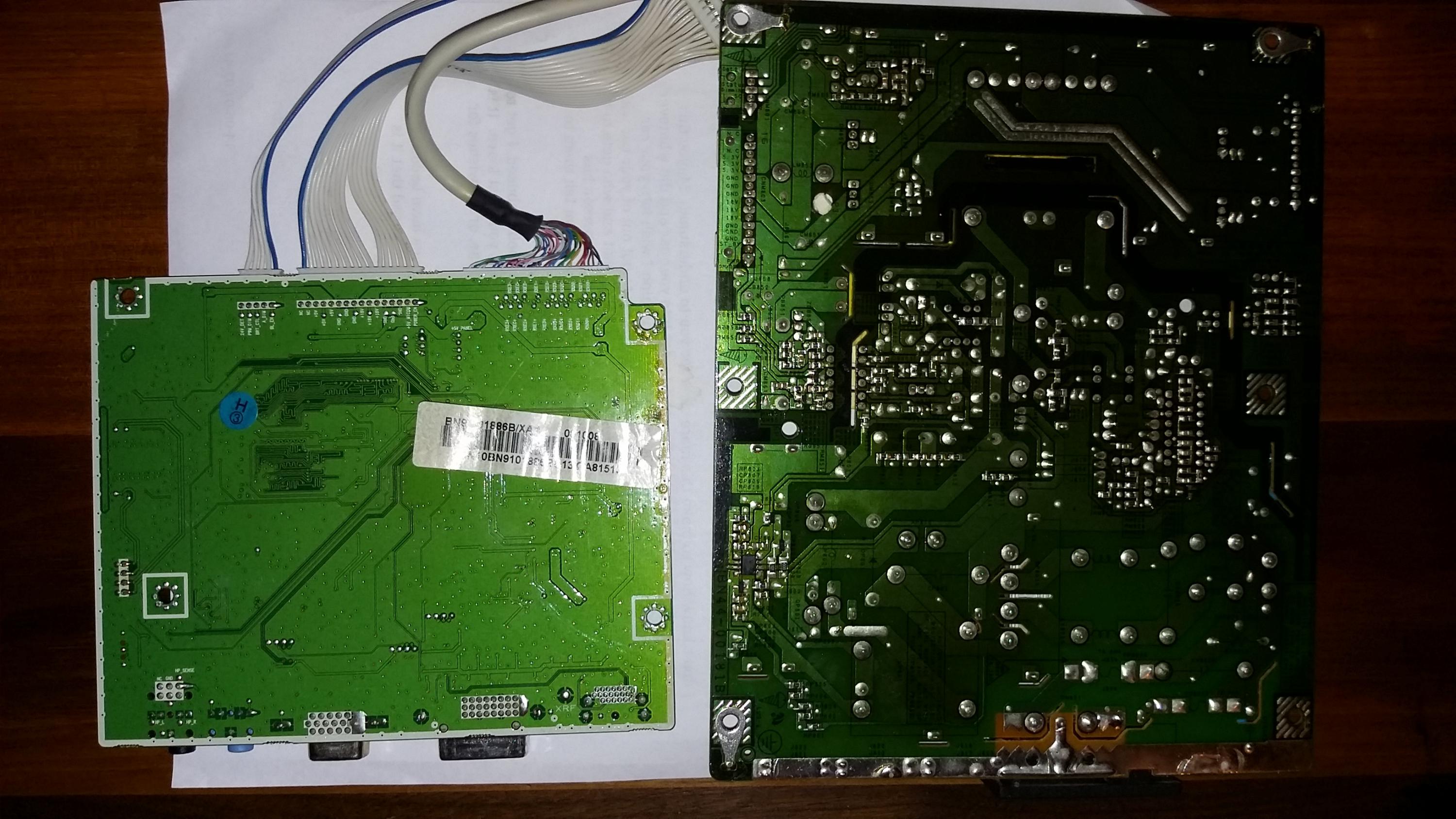

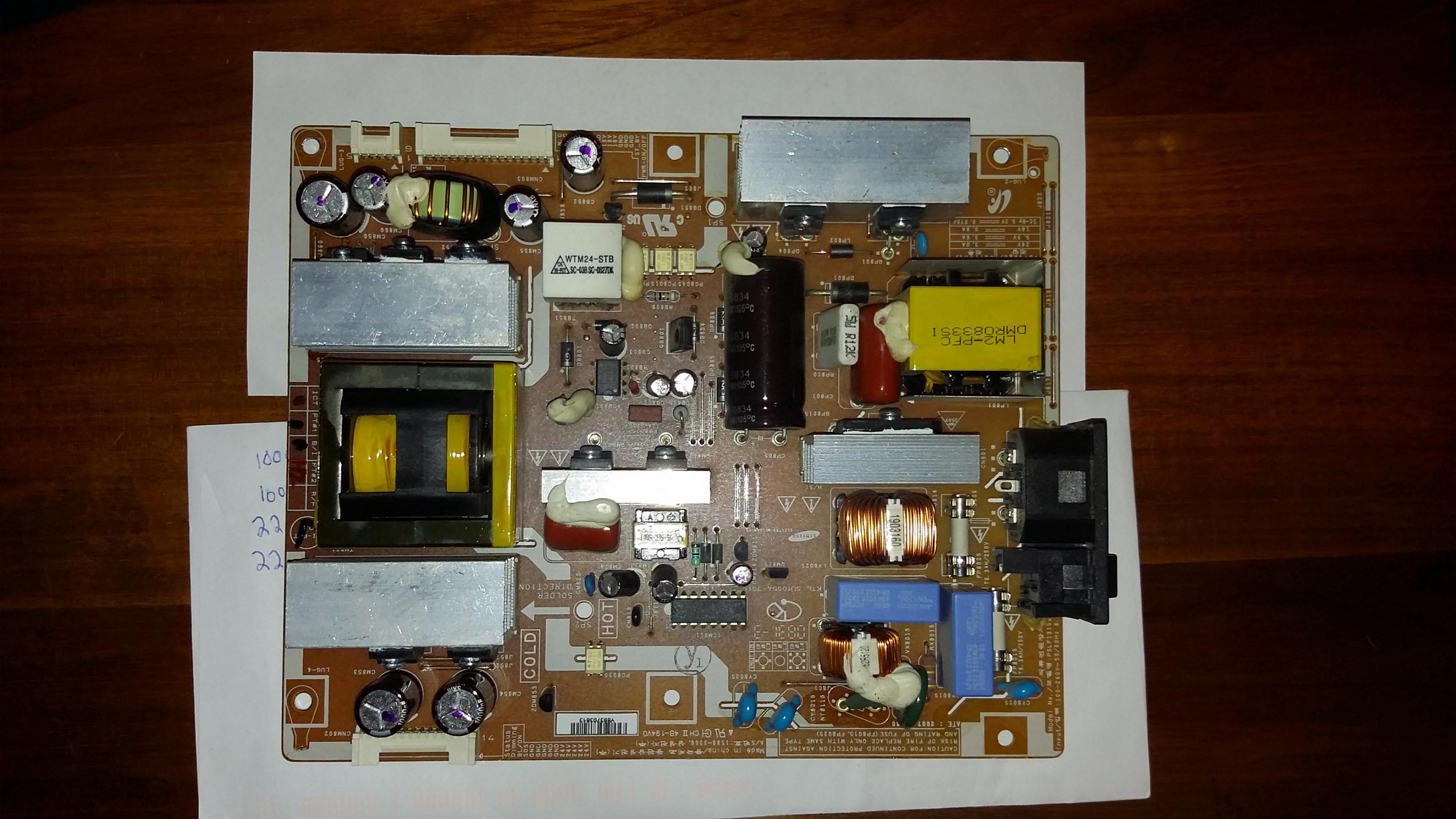

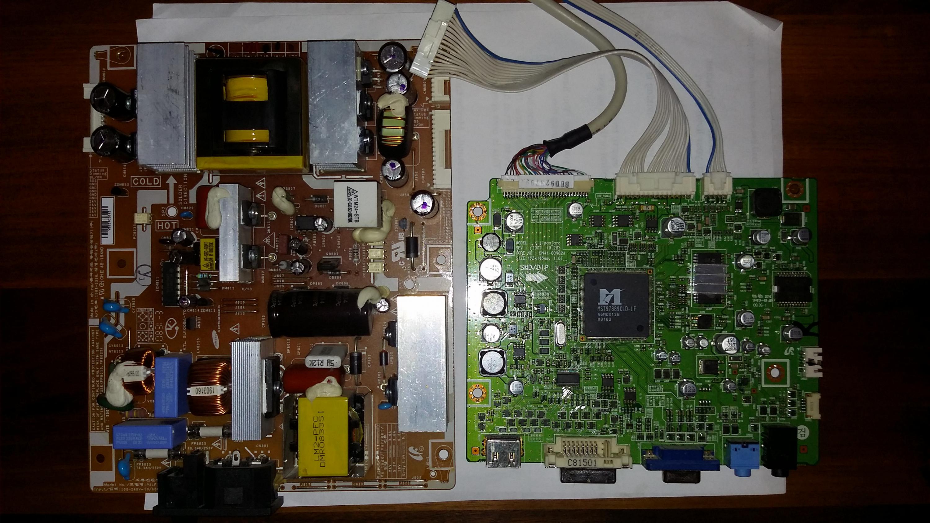

    Urls for images of the power board are:
    http://i.imgur.com/mK1mSKd.jpg
    http://i.imgur.com/4ZPIo4B.jpg
    I'm doing things on a tablet and it's a bit awkward.
    A previous thread I made regarding the issue is here:
    https://www.badcaps.net/forum/showthread.php?t=41718
    I'm thinking to just replace all the caps and hope it fixes things. I don't know if I can presently turn the monitor on as it's presently disassembled.

        If the problem goes away on a warm start, bad capacitors are likely, the hairdryer trick as already mentioned may confirm this.
        But it could also be a lamp\wiring issue.
        You should probably also check for cracked solder joints in the inverter area, around the transformers etc.
        Also please upload your photos to the forum, it makes everything easier. (See: https://www.badcaps.net/forum/showthread.php?t=1868)

          Hope the pictures show as attachments for this post. Front and back shots of the power board, and front/back doors of the power and inverter board.

              I smelled around the monitor screen and sensed no smell, and no cracked solder joints around the transformer.
              I pulled the caulk covered cap out of the way and it's another 22uf 50v, so the total list of larger caps for the Syncmaster 2693hm is:

                I replaced all the listed caps on the power board and reassembled my monitor, and now it's functioning all well.
                I've been turning my monitor off and on and appreciating the experience of it working. It takes ~2 seconds longer to light up after the power button is pressed than it had with the previous caps, but then it comes full on in one moment.
