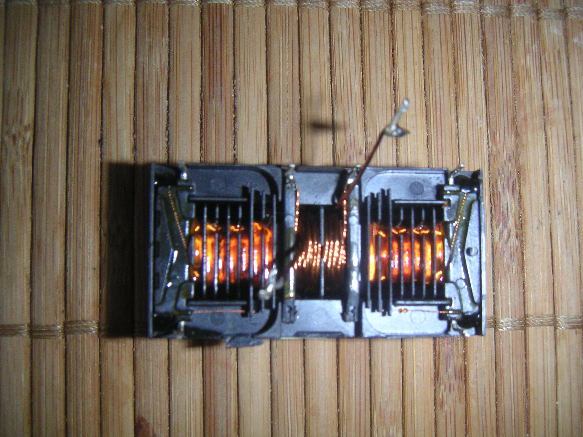

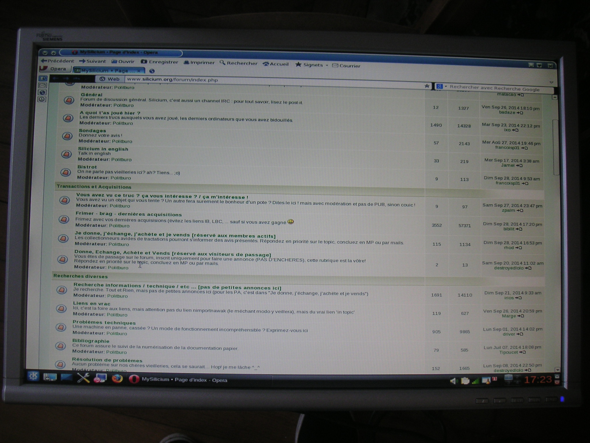

    I did found this Fujitsu Siemens Display a week ago, two caps were bad, so i removed and replaced those for a test.
    I only get a fine display for a couple of seconds, then the display turned itself black.

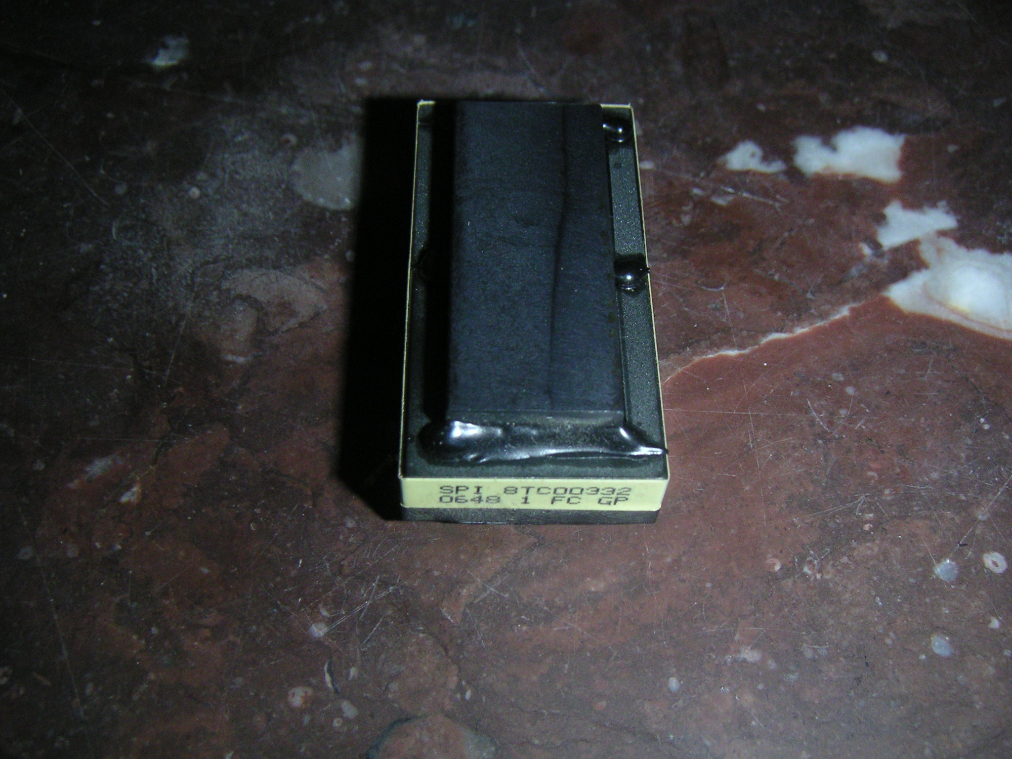

    I found in the forum that an inverter transformer was the culprit most of the time (SPI8TC00322)
    I ordered one, removed the old one and replaced it with the new one.
    Problem solved, the display is working fine
