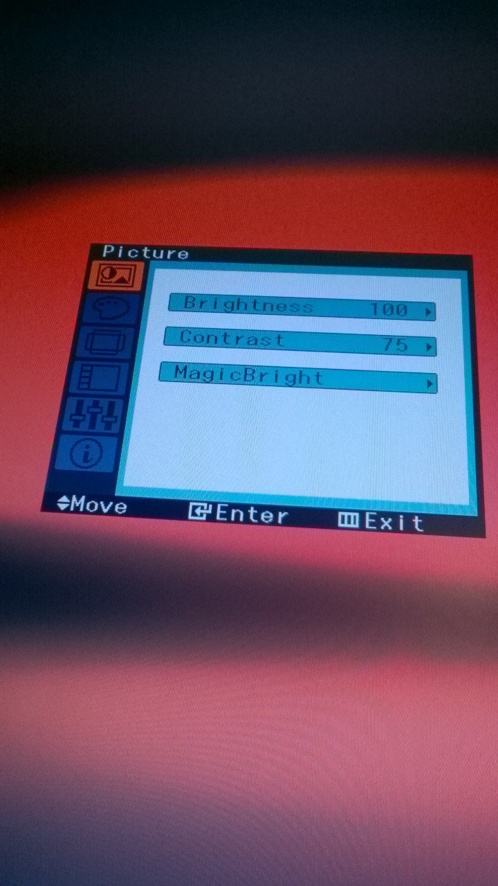

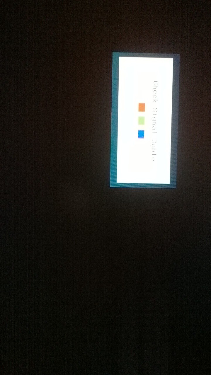

    Hi
    I have problem with this one.
    When signal is applied the whole screen is red(ish). Without signal applied everything is ok ("Check signal cable" is normal as it should be).
    Replaced all caps altough unnecessary because they were fine.
    Tried it on two different PCs, with different OS just in case it is some driver problem, but no joy.
    I assume it is digital board problem (it has only VGA connector, no DVI).
    Any ideas?

          Re: Samsung SyncMaster 743N
          Yes, tried that too. If i set red to 0, green to 95 and blue around 35 then colour is about right as it should look. But if I reset it then to factory defaults it's red again, like default setting is Red on 100 .
          OSD is normal, as you can see it on the picture.
                  Ok guys, thanks for all your help, and especially to lti
                  Cleaned and reseated lvds cable, but that didn't help.
                  Then tried this metod that lti suggested and it worked! Get in OSD menu, selected english, hold enter button for 5 seconds, screen flashed and that was it
                  Thanks again!
                  PS: on picture it looks like it is still bit red display, but colours are normal
