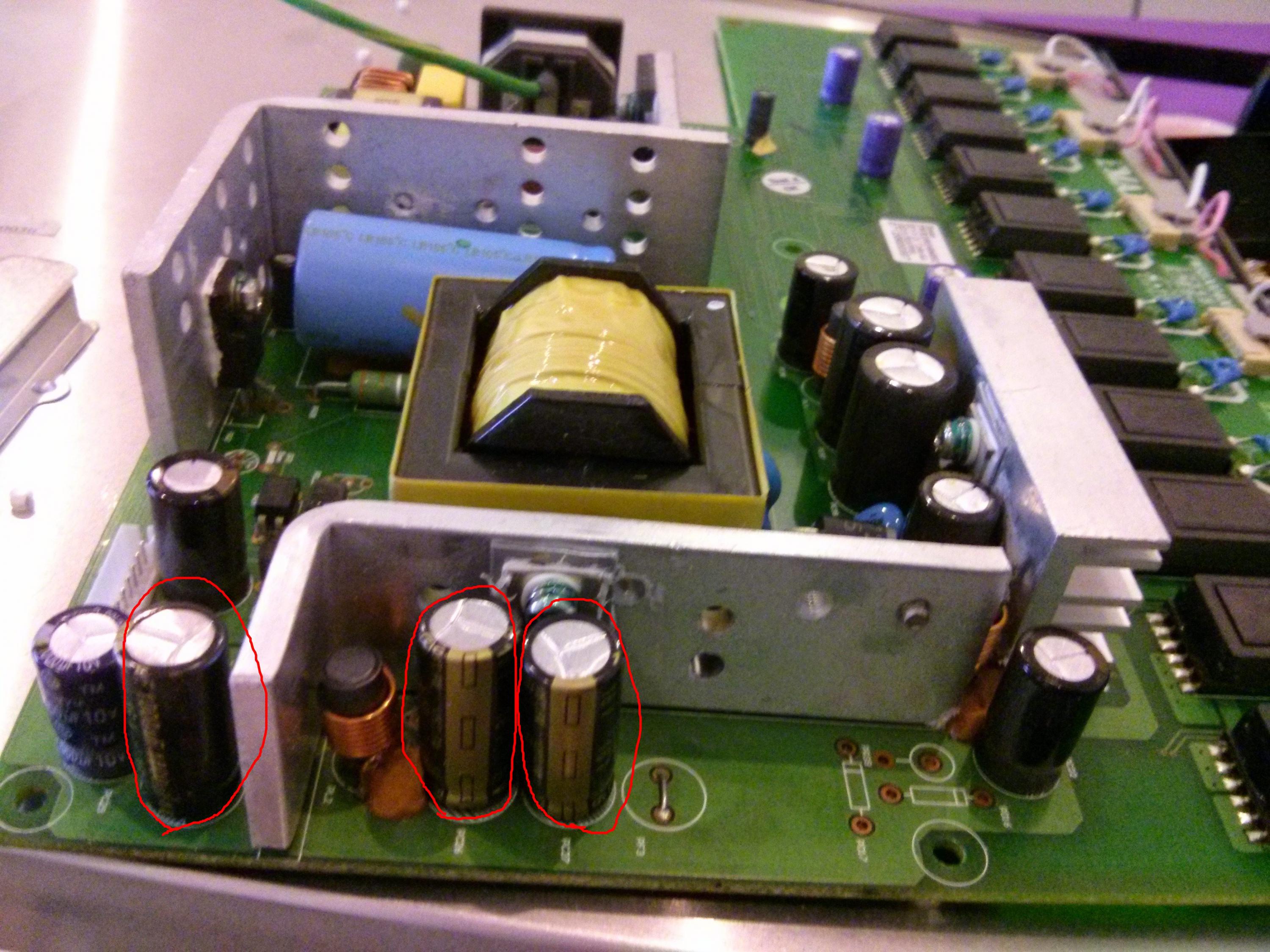

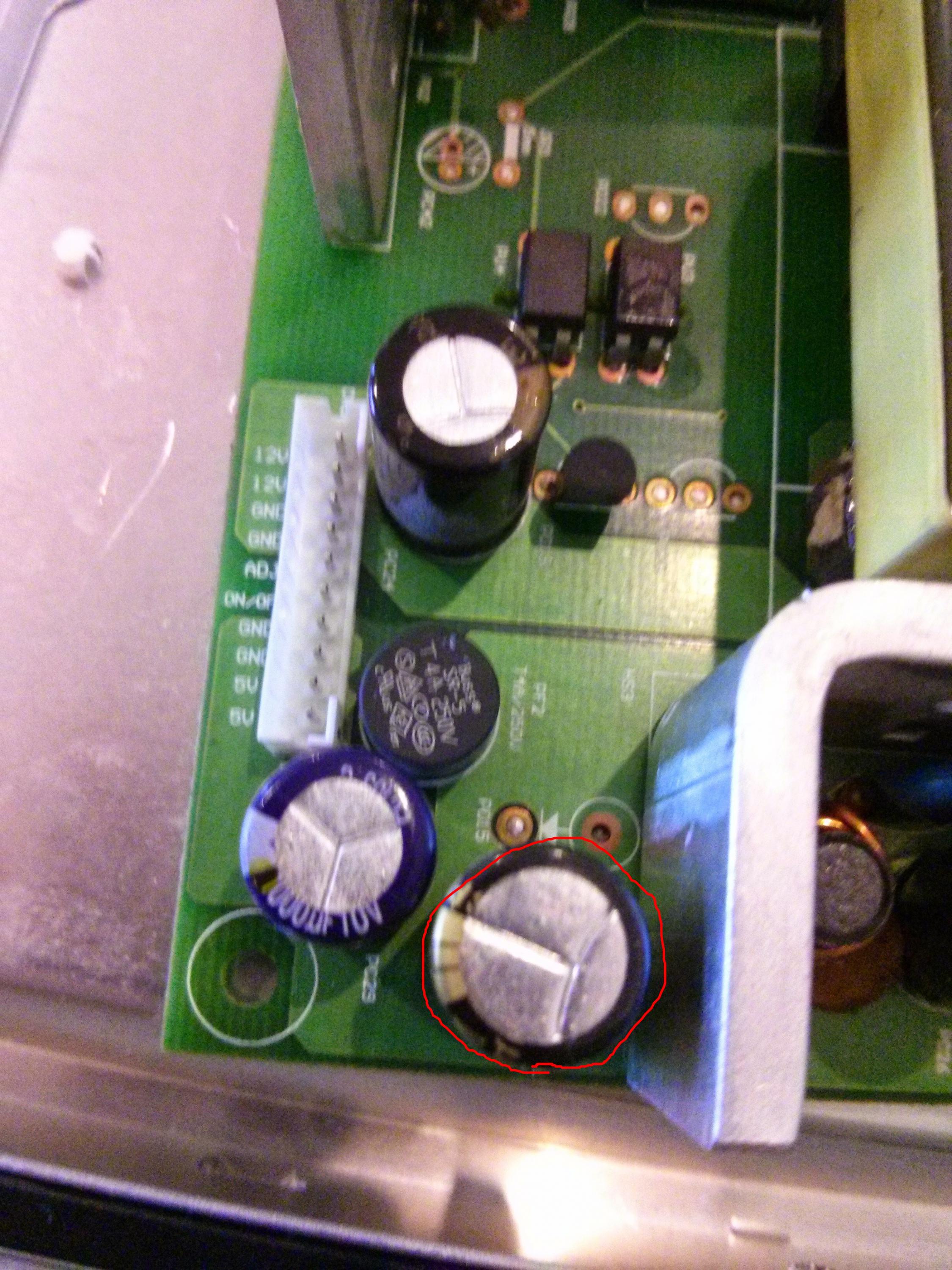

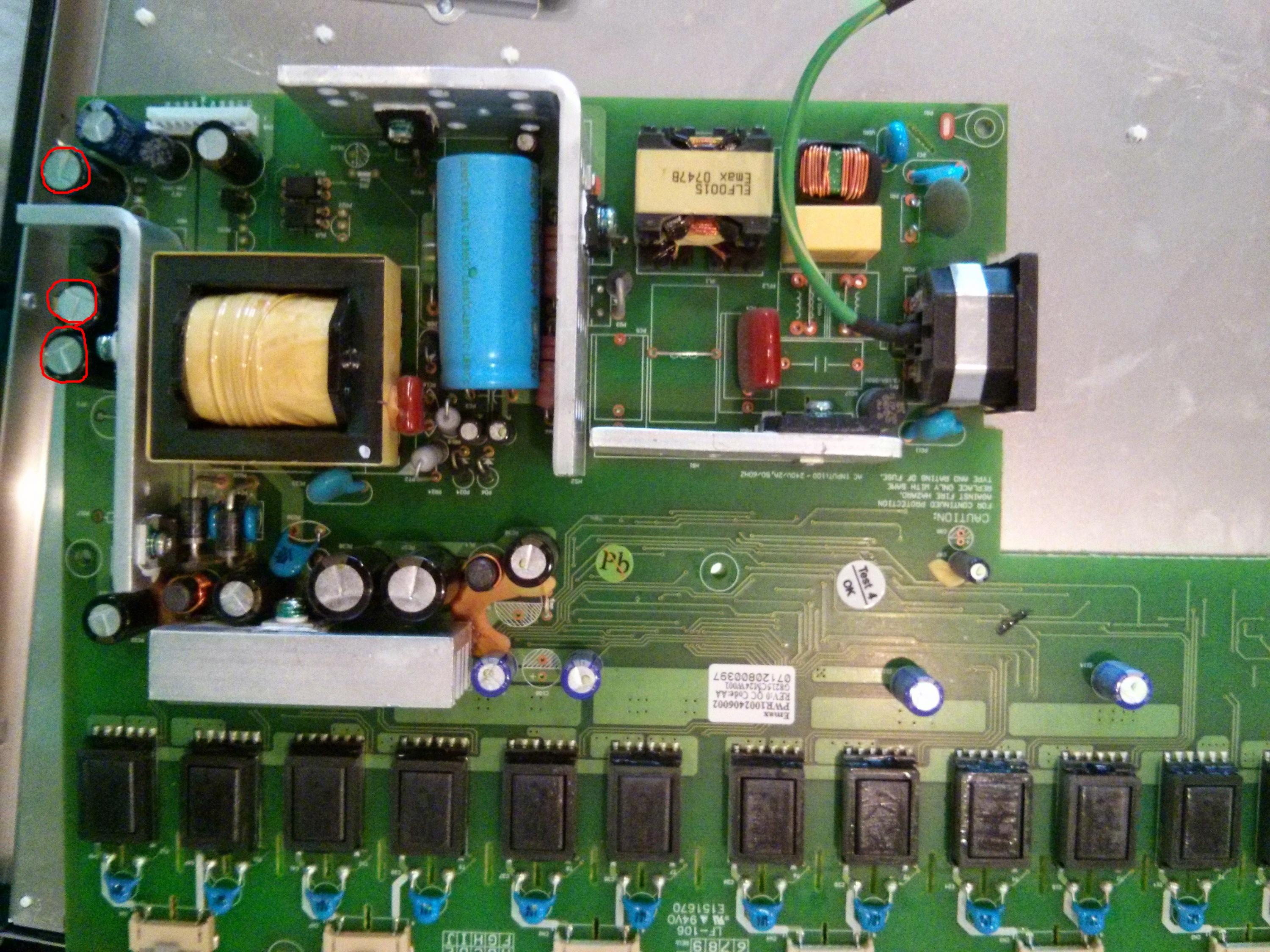

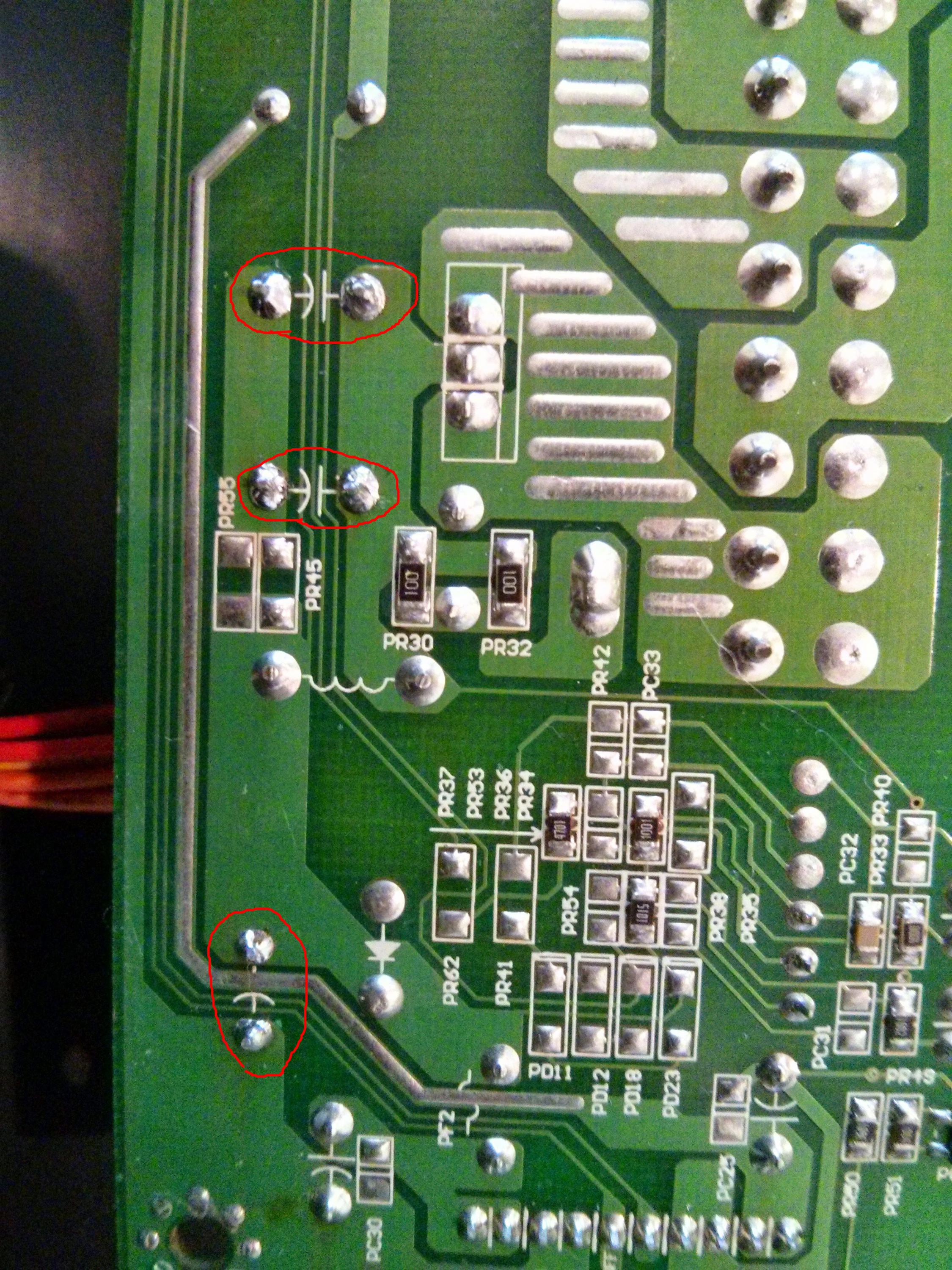

So, after about a year of this seemingly dead monitor taking up space I decided to see if something could be done about it. From looking at similar problems people had both here and elsewhere it seemed as though dodgy capacitors could be the culprit. Opening it up I had a look at what I believe to be the power board. There I saw three purple Hermei brand capacitors, 1000uF 16V, with clearly bulging tops and signs of discharge. These were the only ones of that type on the board and all other elements had no immediate signs of failure so I decided just to replace those three. I ordered some Panasonic replacements from Farnell with the same specs and replaced the caps.

Turning on the pc after the repair I was initially hopeful when I immediately saw an image on the monitor. However, there did appear to be a large amount of blue static/noise over everything, which is obviously not ideal. Furthermore after a short while the screen went entirely blank again and wouldn't display anything. By fiddling around with the monitor layout settings in Windows 7 (I have a dual-monitor setup) I could get the screen to display something again but it would only last for ten seconds or so before going blank again.
It's interesting to note though that the previous problem of a flashing blue light and high pitched noise appears to be gone. Now the power light stays on as if it has found a signal, but just not displaying it.
Also, looking in the Windows screen resolution control panel the OS is noting the presence of the second monitor correctly, although it's also also showing what appears to be a third monitor, with the words "Another display not connected".
So, my question is, where should I go from here? Do these symptoms give any indication as to what's currently wrong with the device? Does this seem like I simply did a bad repair job? Any other thoughts?

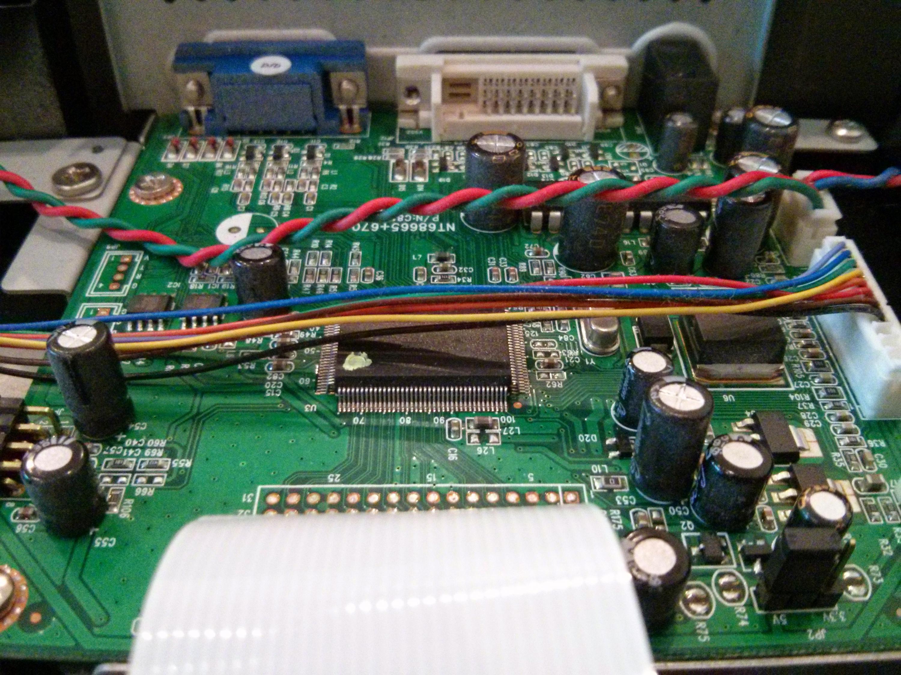

I can get some pictures for you guys if you like but I'll have to open it up again.
