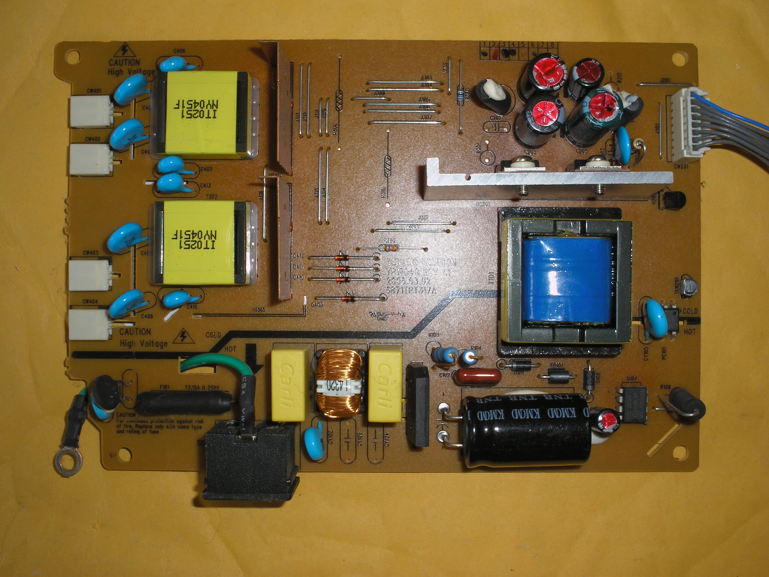

    I have repaired many of these units by replacing the caps (except the large cap on the hot side of the board), however, this one has a problem that is beyond my expertise.
    When turning on the monitor, the power button turns blue, the screen turns on for a split second, then turns off. The power button blinks and the screen flickers yet again. This cycle continues until the unit loses power.
    The power board is a Yuyang Telecom YP1704G. Stock with Samxon capacitors.

    Re: Troubleshooting Gateway FPD1965 - Blinking LCD and Blinking power button
    That sure is a blast from the past
    I just dug one up from my goodies
    first thing to check is to see if any of the red caps are bulging at the top or if the bottom is showing any signs of leaking
    also check the large cap that is laying down is bulging at the top or bottom
    if no bulging
    use a dc tester and check what the 5 volts at the wiring harness is doing with the board all by itself
    if it is around 5, check it again with it connected to the vga board
    if 5 is low or turns on a drops, the small cap by the largest cap should be changed first (this small cap can fail without showing physical symptoms)
        I recently fixed an AOC LCD monitor that was power cycling due to shorted transistors in the inverter circuit.
        The good thing about the inverters is you have two identical circuits side by side. Test all the semiconductors in them with diode test function on your meter, and compare between each circuit. If the results are quite different, or you get shorts, you may have found the problem.
        It could also be a faulty PWM Controller in the PSU or faulty DC supply capacitor\diode for the PWM Controller. This would be the small capacitor right next to the mains filter one.
          It could also be the inverter transformers - I had an LG monitor that kept cycling the 2 seconds to black and it was the transformer I dont know why it
          kept cycling though.
          I have tried to find a pinout but failed. No power to the board, set meter on ohms 2000 and check the resistance on the 2 transformer legs that go to the lamp sockets.
            Sorry for the delay. Yesterday was hectic.
            Anyway, both +5 leads are at +12 and the +12 is 0 with the power board not connected. When I connect the board, both +5 leads cycle between +5 and +12. The +12 lead is still 0.
            I have already changed the small cap (47uf 50v) and it still does the same thing.
                check your 12 volts rectifier diode for shorts
                it is the one of the two on the one heatsink and it is the farthest from the power plug that goes to the main board.
                check center pin to outer pins
                mbr10150ct
                PS: the 12 volts does not make it to the 12volt connector
                you need to check your 12 volts at the J202 jumper that is next to the plug
                  you can also check for 12v at the 2 jumpers at J303 and J304
                  if there is no short at the 12v rectifier pins and the 12 at these jumpers is messed up, disconnect both of these jumpers at the side of the group of capacitors and try testing again. these jumpers feed the inverter side of the board and if once removed, your 5 volts is back to closer to normal, then you may have a shorted 4502C transistor on the inverter side.

                        • 8
                        J303/J304 are ground .. voltage between J303/J304 and +5 is +12 when disconnected and cycled +5 to +12 when connected.
                        While I was checking, I tested a few other locations. These are the results:
                        GND to J305/J306: +30 / +32 to +22
                        GND to COM (D201): +30 / +32 to +22
                        GND to COM (D202): +12 / +12 to +5
                        I did notice an interesting phenomenon, on D202, when the voltage switches between +12 and +5, there is a steady discharge to about +3.5 before it jumps back up to +12. The complete cycle takes about half a second.
                          Additional info:
                          With the jumpers removed the voltage at +5 stabilized at +12 and did not cycle. The voltage on D201 and D202 common also stabilized at +32 and +12 respectively.
                            oop's
                            I meant J305 and J306 are the 12 volt pins to the inverter
                            the other ones are ground and may or may not completely isolate a short on the inverter side
                              no problem, with all 4 jumpers removed, voltage on +5 is +12 and D201/D202 common voltages remain unchanged at +32/+12
                                did you recheck your tester using a battery ?
                                and
                                What are you using as a ground pin for testing ?
                                I would use the large aluminum heatsink if you are doing testing from the top
                                and if testing from the bottom use the heatsink tabs or the negative side of one of the capacitors on that corner of the board
