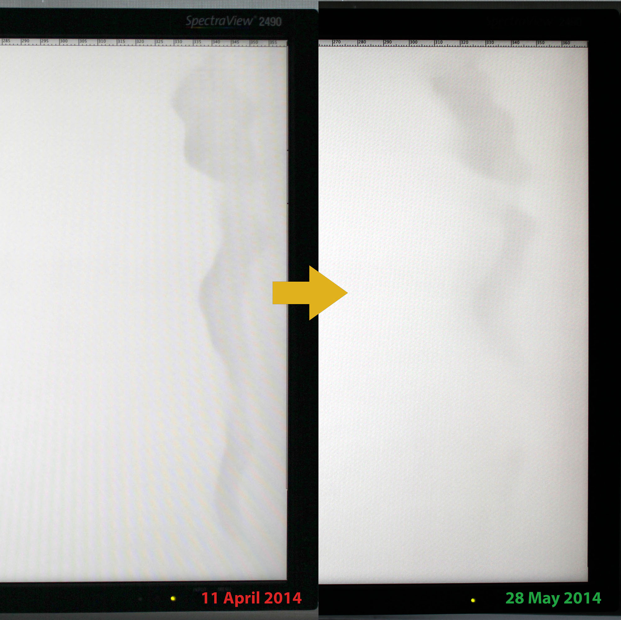

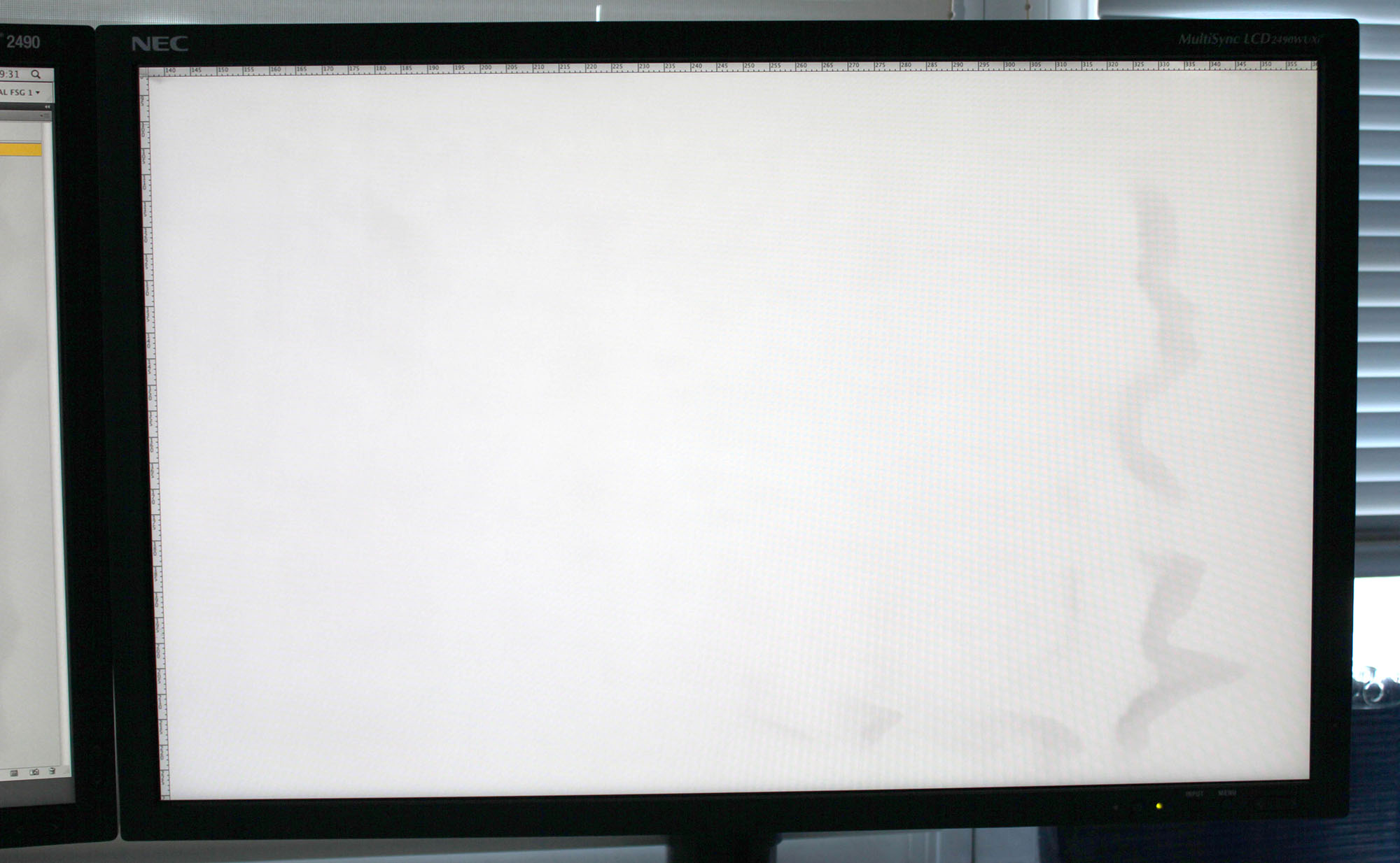

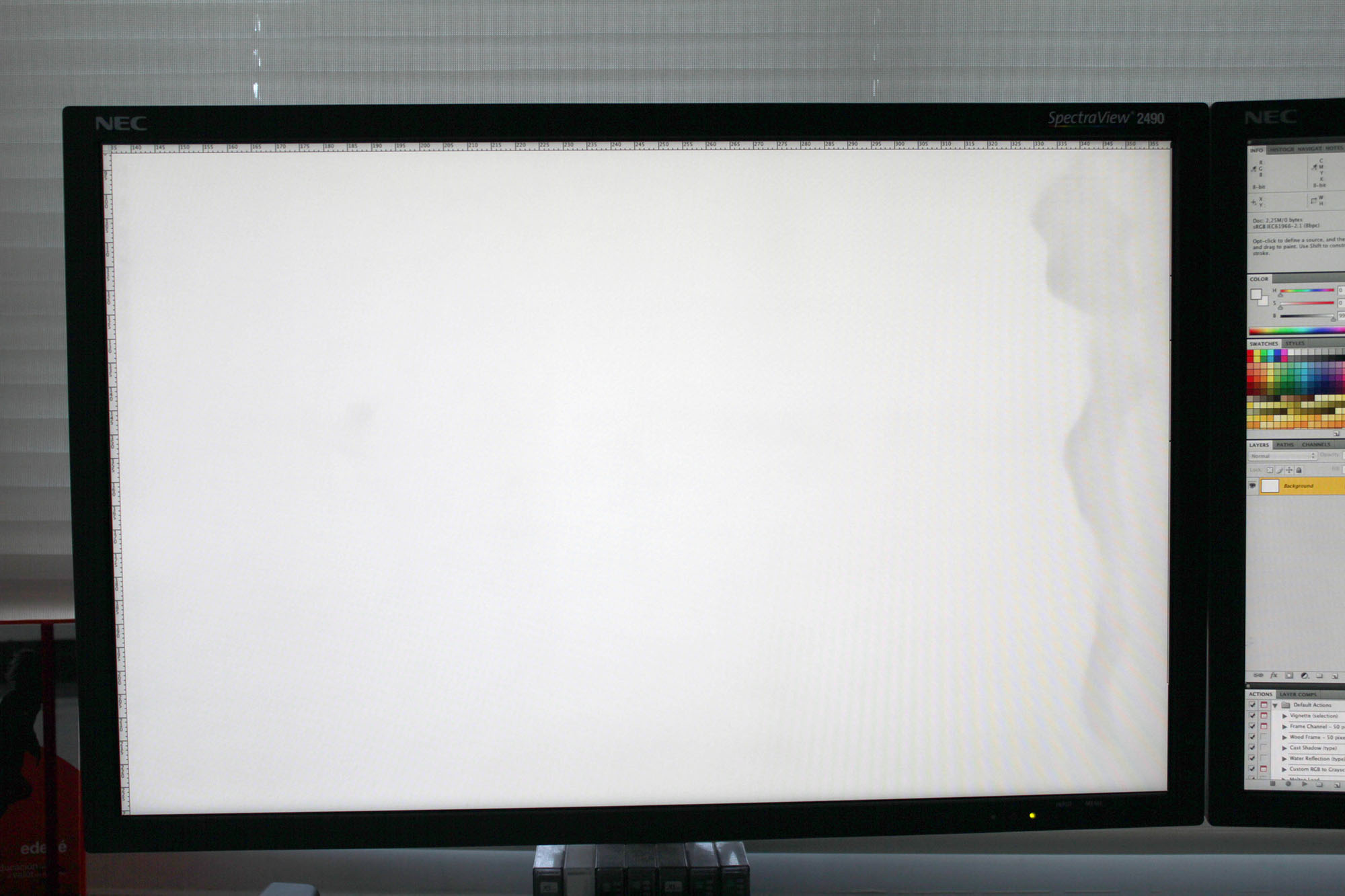

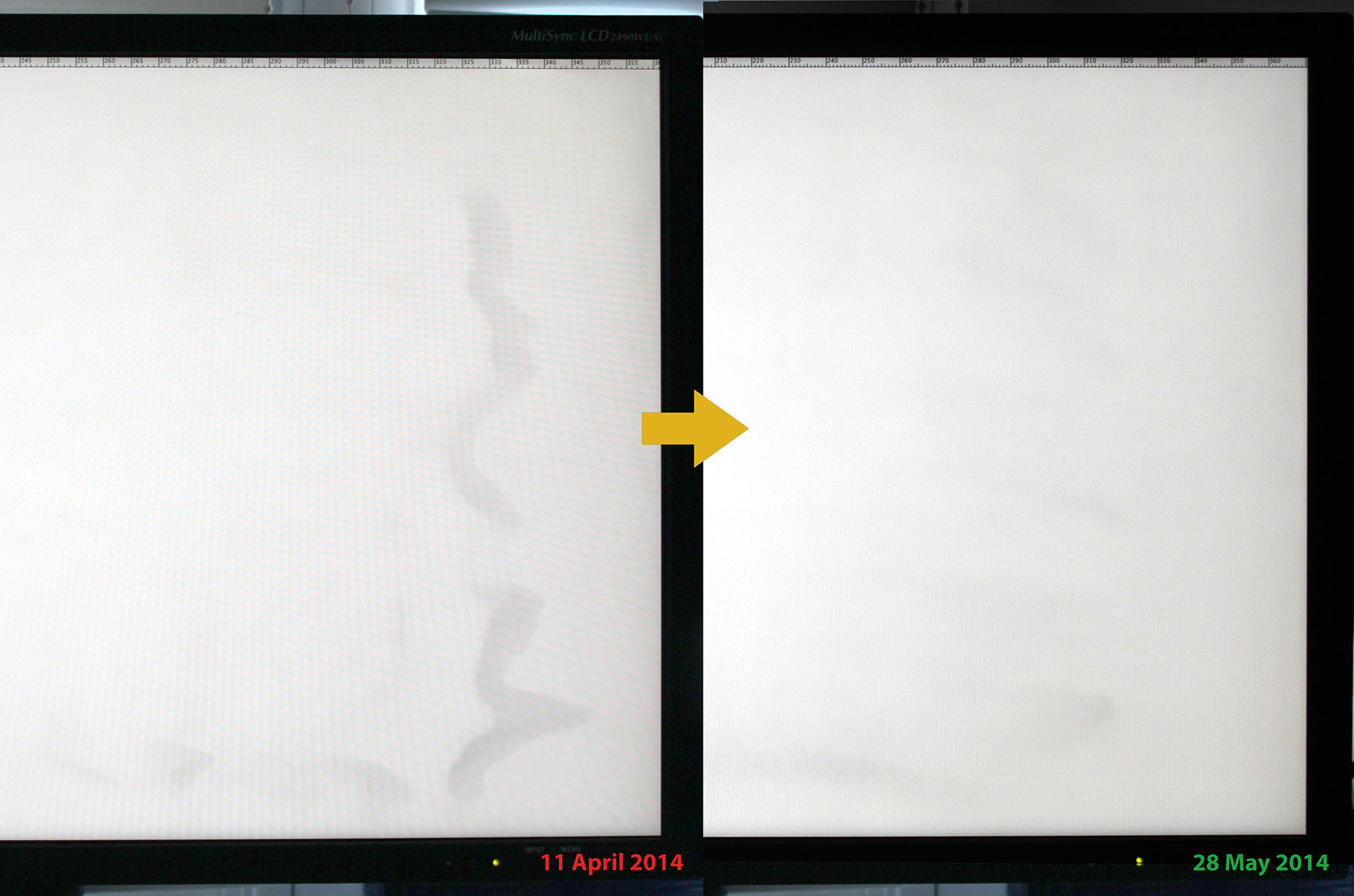

    I´m asking you for any help about a problem affecting both my NEC SpectraView 2490 and my NEC MultiSync 2490WUXi² LCD monitors.
    Description of the problem:
    After a year - year and a half of use, both displays began to show irregularly shaped dark "shadows" on the right edge from top to bottom of the screen. At first they are not much annoying because they don't affect the main working area, so I tend not to care much about it; also somewhat reassured as I can see that they change over time and don't seem to be a permanent electronic nor mechanical problem (and maybe hoping they will disappear as they have appeared)
    In the next year they have evolved slowly, but lately the change pace has increased, and they are getting wider and "moved" towards the center of the screen affecting the main working area and leaving the displays marginally useful for my professional image editing work.
    Other characteristics of the issue are:
    - As said, the problem seems to be the same, affecting the same area of the screen and appearing between an interval of few months in both monitors (first the LCD2490WUXi2, who seem to ever "lead" in the process, then the SpectraView 2490).
    - The "shadows" are near invisible at the moment of turning on the sets, with a very subtle opposite effect: a clear (light not dark) "cloud" (barely noticeable against the blue uniform background of the start up of the system) the same shape as the "shadows" that appear after 10-15 mins of warm-up, and stay so mostly unchanged for the rest of each session.
    - The "shadows" change slowly over time, "moving" towards the center of the screen as a wave in a beach, with different relative "speed" of the "leading edge", diffusing themselves and leaving relatively clear areas previously covered by them.
    In the attached images you can see the problem in photos taken one and a half month ago, and the evolution to their present state.

  • bammbammfran
    • Apr 2014
    • 476
    Re: "Shadows" on LCD screen. Mura effect?
    Looks like probably interior staining caused by moisture build up in that area
    Since this is a ccfl lighted screen, the bulbs tend to be the hottest on this end
    There is a chance it can be wiped out of there with good microfiber cloths and with just a touch of distilled water
    You could try lifting the lcd glass and that will tell you if it is on the glass or in the films
    It is a bit tricky to do and you have to be careful around the lcd ribbons
    you would have to obviously open the screen, then remove the metal trim around the lcd panel (this is usually clipped on and may have some tape and possibly a few screws)
    you might be able to do it with the boards in place depending on how they are mounted ?
    if you have to remove the boards, you'll have to connect them back up after the trim is off so that you can turn it on to see what you are going
    wear rubber gloves, to stop finger oils from transferring to the films and glass bottom. Then you'll have to gently lift the glass up from the bottom edge while maintaining forward pull on the panel so it does not slide backwards towards the ribbons. A suction cup may help get it started. Once it is cracked loose, then turn it on and lift it and see if the discoloration goes up with the glass or stays down below in the films.
    AGAIN, you will be hinging on the top ribbons, so take it easy and slow
    Once figured out you can reach in and try a dry wipe with minimal pressure and see if anything comes off.
    If you try and get stuck or are not sure of something, send a message.

        • 30953
        it's a panel problem, i'v seen it before.
        if you can fix it is anybody's guess.
        you have a sheet of glass with a polarizer on each side,
        that's your actual "panel"
        behind that are a number of semi-reflective sheets of plastic to act as a defuser and then a thick sheet of acrylic with a white backing.
        now it *may* be between the layers of defuser, but you need to be very carefull if you strip it.
