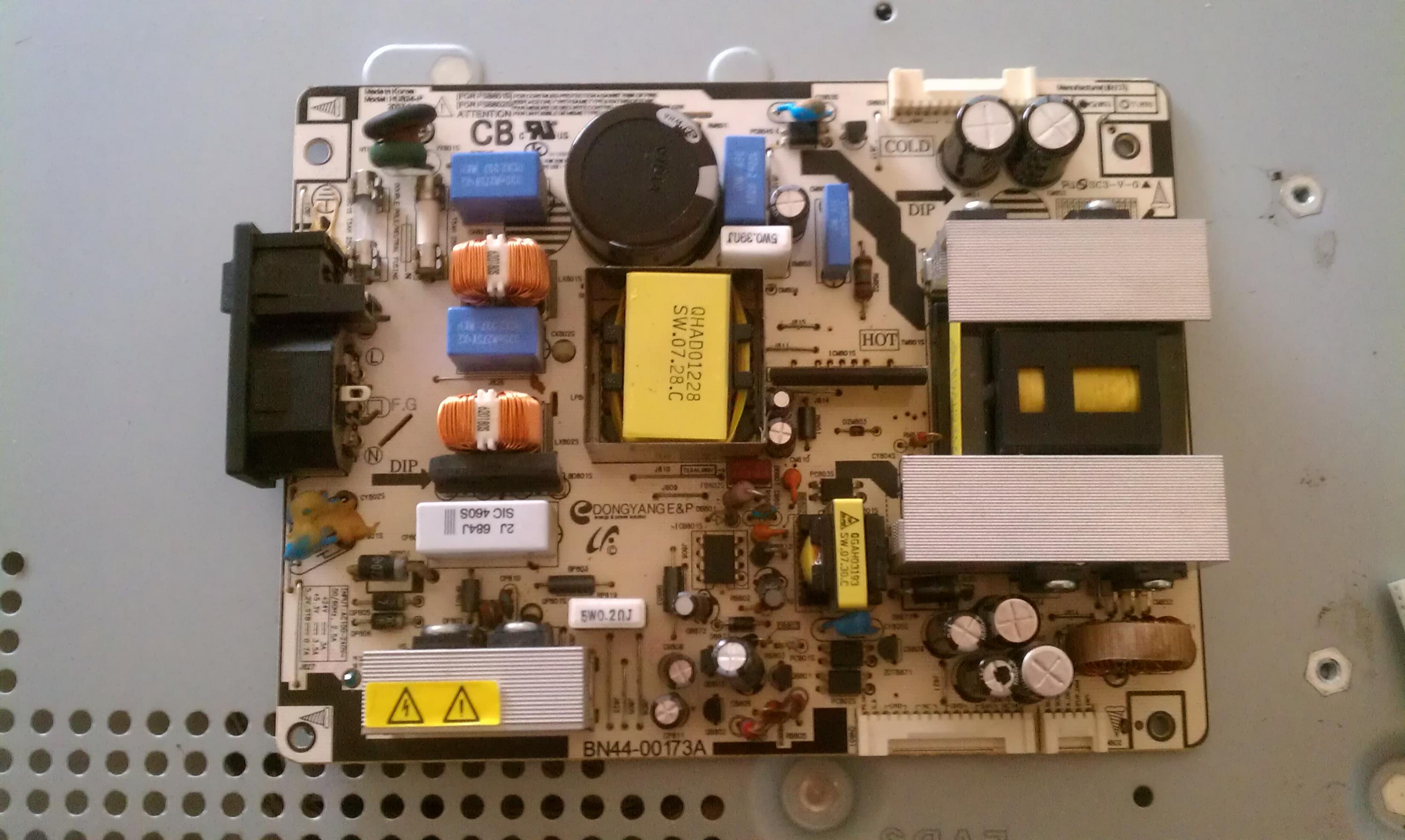

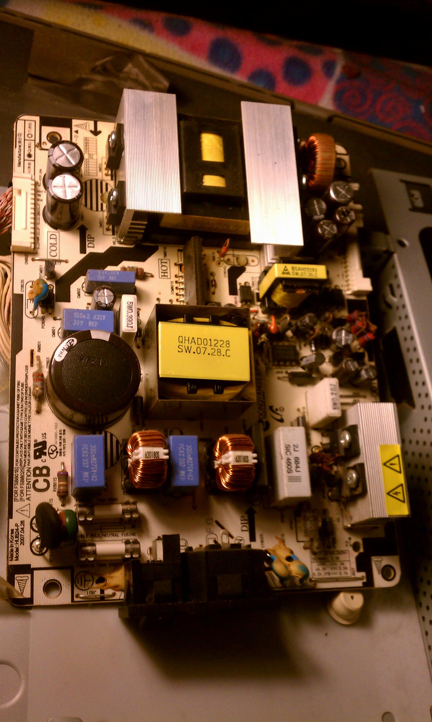

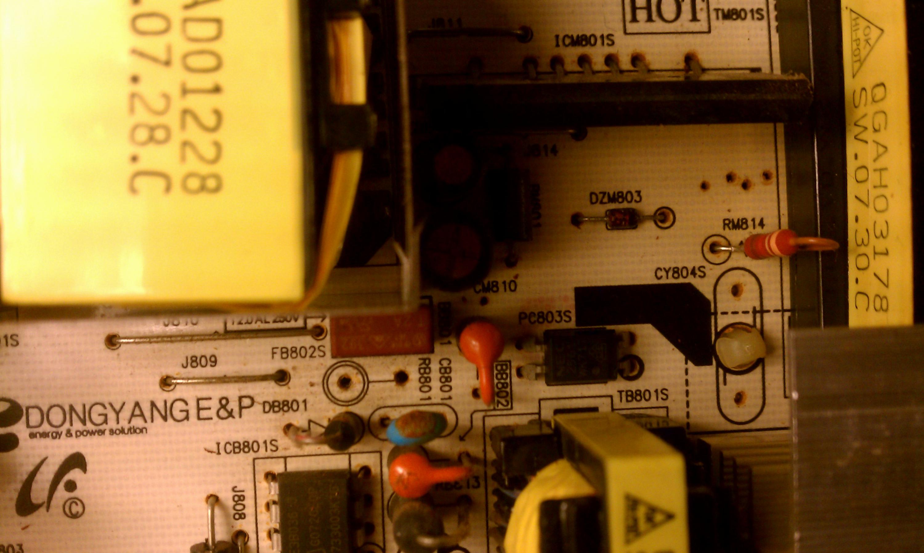

    got a really nice PC monitor here a samsung 245BW that wont turn on.
    well the power LED lights up blue but the backlight does not come on and the screen is just black.
    i took it apart but couldnt find any obviously blown or bulging capacitors.
    is there any useful test i can do with my voltmeter to tell if a capacitor might be faulty? i got a kit to build a ESR meter but i havent assembled it yet...my soldering iron sucks and im waiting for a new one to come in before i try to put it together. and even when thats done, i'd have to remove the cap from the board to test it, correct?
    i did find a resistor that looks questionable...idk it might just be that glue stuff thats all over everything and completely normal but it just looks a little too messy and like something went wrong there. the resistor is right next to (and touching up against) what i think is a capacitor but not the cylindrical kind...its one of those blue ball shaped ones.
    before i start messing around with this power board i'd like to safely discharge the large capacitor. in the past i just used a rubber handled screw driver but i think i read somewhere that its better to discharge them with some kind of resistor so its not so sudden.
    i still hardly know anything about these basic concepts but if a guy says to discharge it with a 1-3 watt resistor, what does that mean in ohms? my volt meter can measure resistors in ohms but i dont understand how to figure out what 3 watts would be...
    as always i will appreciate any and all of your de-noobifying words of wisdom.

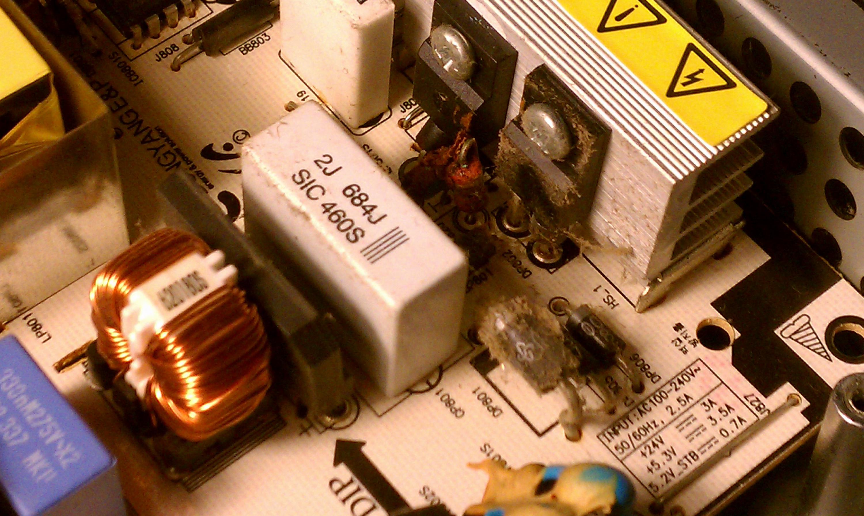

    i read in this thread https://www.badcaps.net/forum/showthread.php?t=15647 that the resistors are a common problem so i started checking mine...the one i said looked suspicious checked out fine. so did the 3 that are grouped together (rb805,806,807)
    this one resistor though...RB801 which has the color code brown black yellow gold which should equal 10*10k ohms (would that be 100k ohms?) anyway it only tests at 420 ohms. and a weird thing (or maybe not) is that if i reverse the probes i get infinite resistance. why would reversing the probes have any effect on my resistance measurement?

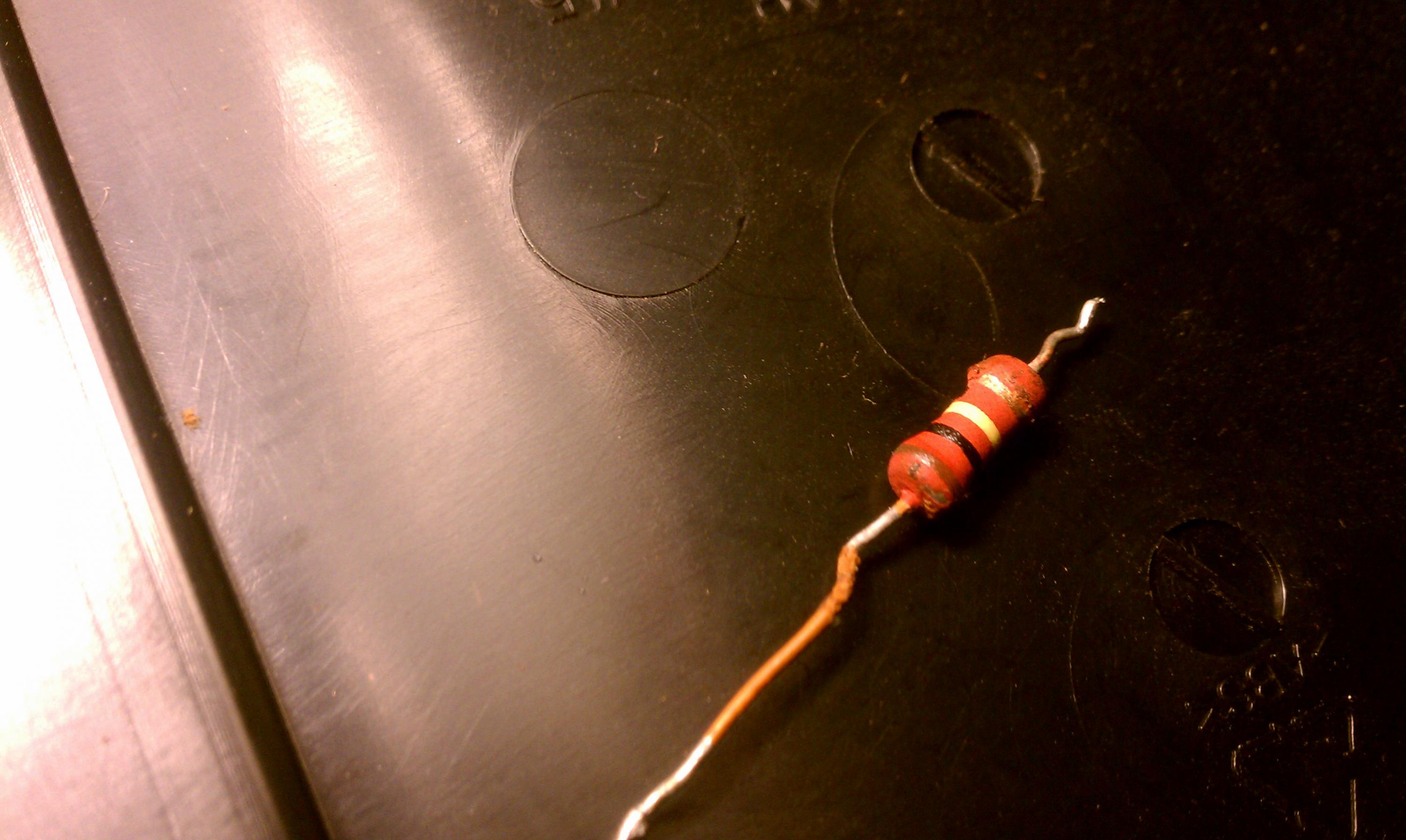

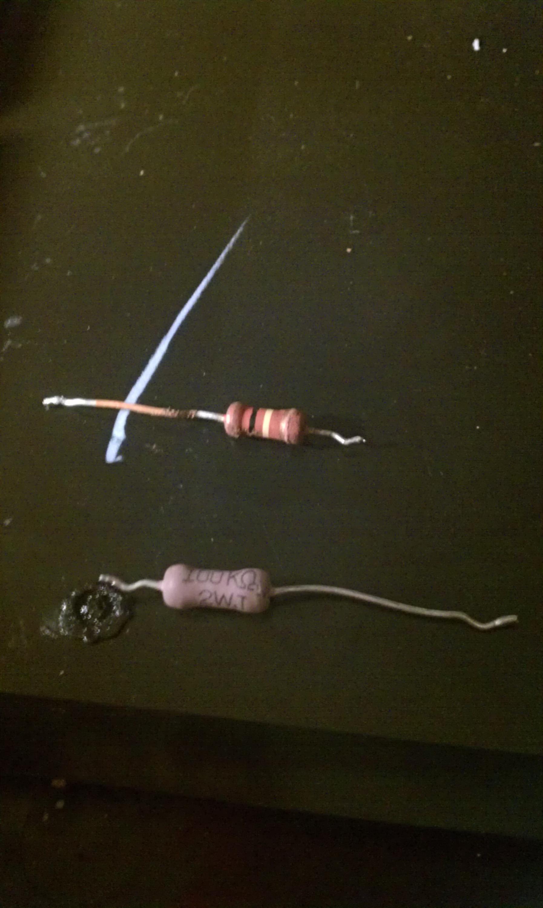

              ok so i decided to remove the resistor to get a better reading on it.
              now that i have out out of the board it reads infinate resistance no matter what setting im on.
              the bands are brown black yellow so 10 x 10k should equal 100k ohms...
              is it possible i could have ruined the resistor by too much heat from the soldering iron? whats my best bet at getting a replacement resistor? should i try to scavenge it from parts lying around or would it be a wild goose chase as there are so many different resistors? could i use one rated at any different resistance? like greater or less? or does it have to be exact? im thinking it has to be exact but i thought id ask since with capacitors u can get away with slightly different values...

                Re: Samsung 245BW power led comes on but no backlight
                amazingly in my small collection of salvaged resistors i happen to have a 100k ohms resistor! but it is of a different type that doesnt have the color bands. also it says 2WJ on it...what does that mean? 2 watt joules???
                also it says F054C ...is 54c like 54 degrees celsius? if so that doesnt seem very hot...
                anyway im not entirely sure if i can just go ahead and replace this thing so im gonna wait here until someone actually reads all these posts!
                  should be 100k
                  so 200k on your tester (when you check the resistor with your tester, do not touch the probes with your bare fingers or it may affect readings)
                  soldering heat should not have affected it
                  part number 100KZCT-ND at digikey.com
                  the pink no lines one should work, just check the resistance before installing it

                    i couldnt wait so i went ahead and soldered it in. seems like its ok. but that didnt solve the problem... i notice i only have .88v going to the inverter board..... trying to read some of the other threads on this board but it gets a little too complicated for me. like they say to check the F9222L and they seem to say it has 23 pins and i can only count 20 pins on mine, a lot of which are just stubby pins not connected to anything...
                    please in very simple language explain what i should test next, and how i should test it

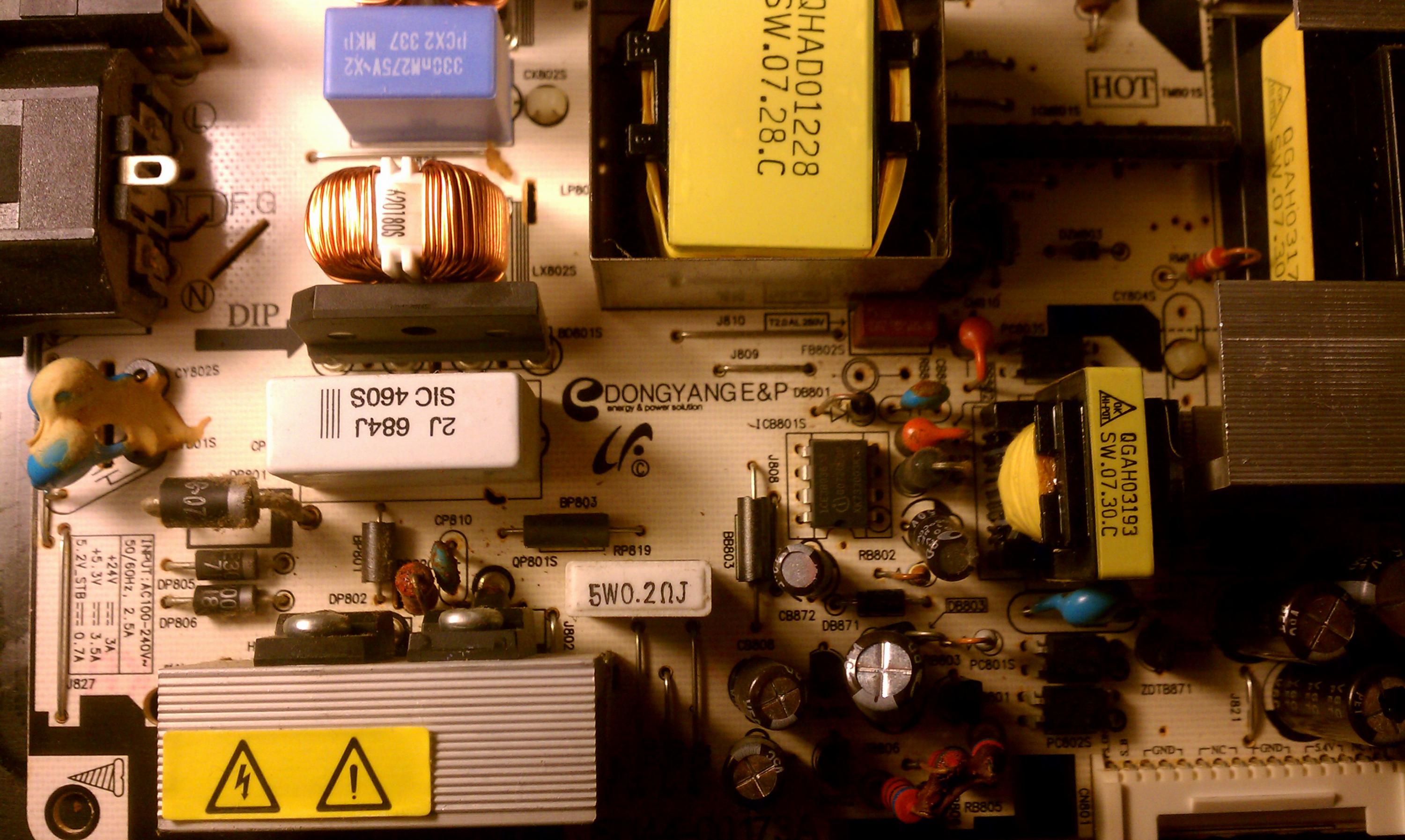

                      on the F9222L btw i get 58v on most of the pins, but i get 28v on 2 of them
                      Don't fear the repair...
                      • triplefour
                        • May 2014
                        • 1747
                        and for cm802 i get 311v on the side closer to the mainboard and 155v on the side closer to the inverter board
                        • bammbammfran
                          • Apr 2014
                          • 476
                          I could use a good picture of both sides of the board to help.
                          23 pin must have been a typo ?? 20 pin makes more sense but the voltage looks all wrong based on your numbers.
                          Check your tester batteries before going to far.
                          We have to check voltages in several other places
                          Fist spot would be for the 5 volts at the CN801 connector plug that goes to the main logic board.
                          It looks like those pins are marked for values on the board and so are the grounds

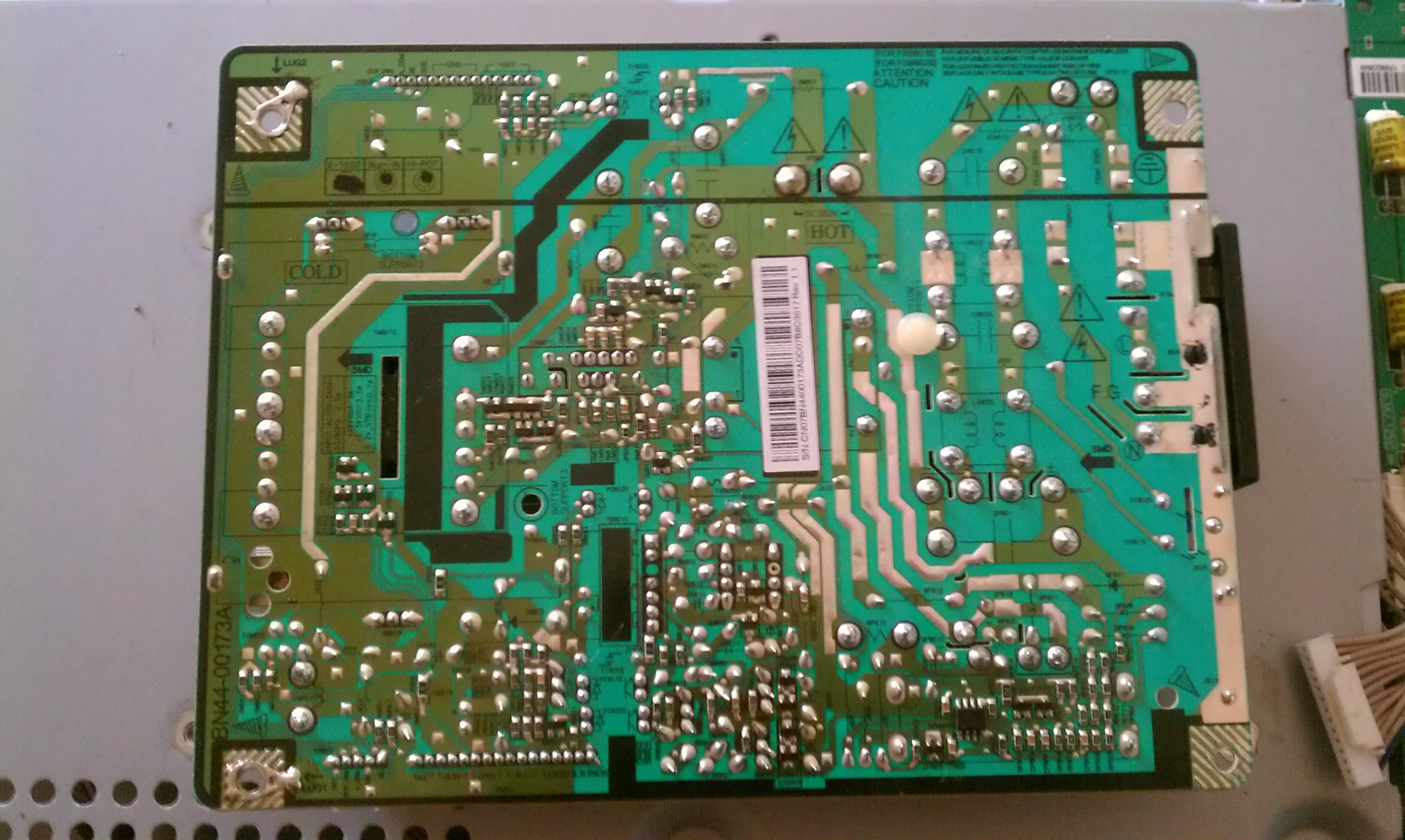

                                      heres the front and back pictures of the motherboard. and yes budm i removed all glues after taking this picture... still no dice. did the flashlight test too...nothing :/
                                      im not getting the 24v out from the power board....
