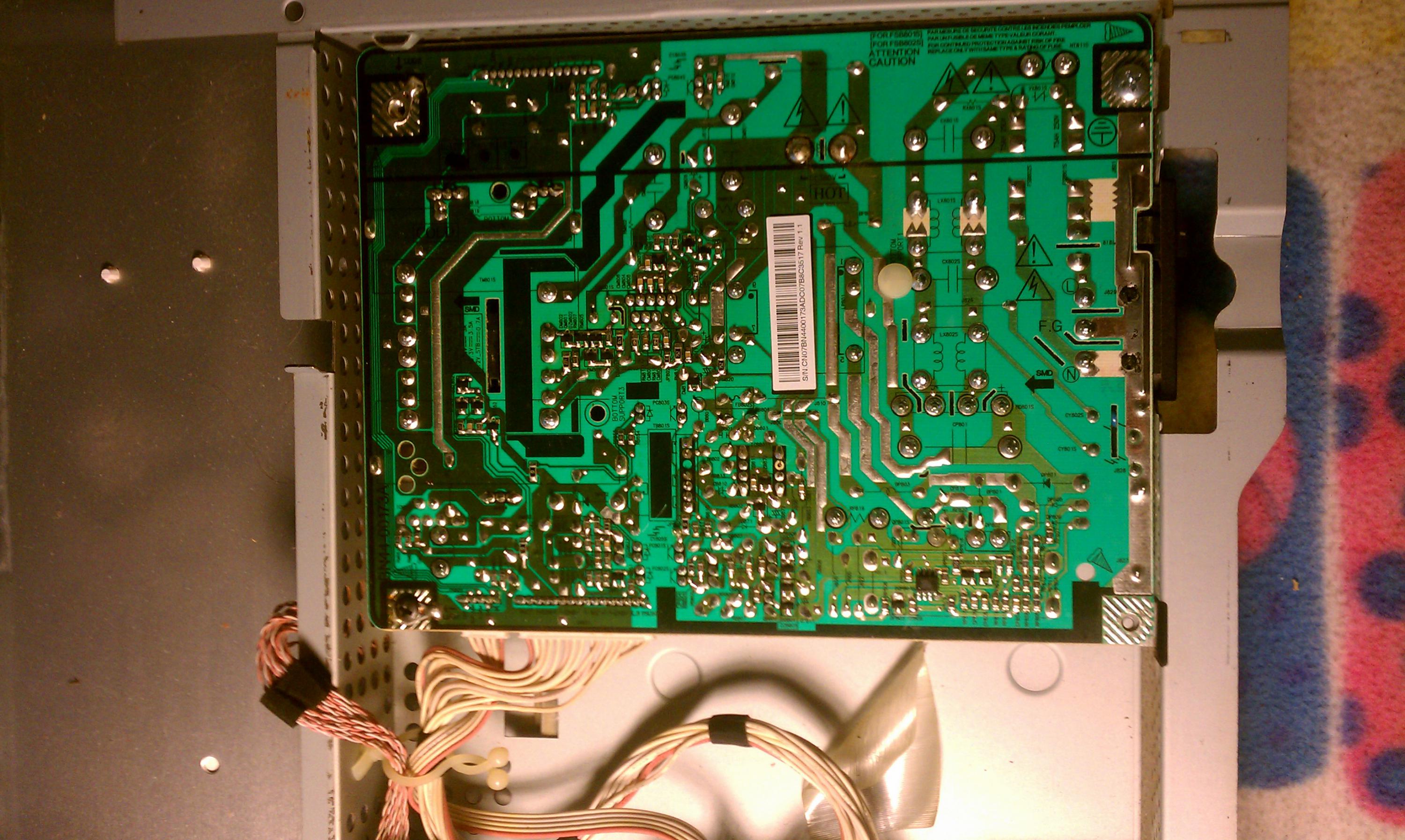

    Re: Samsung 245BW power led comes on but no backlight
    heres a little bit better pic
          Are you getting about 292VDC right at the two legs of the main filter cap CP803?
          Also the another common failure for not having the 24VDC is the bad capacitor CM802 (18nF 630V) you will need the cap to verify the value. Just remember one thing when making DC voltage measurement in the primary side, the negative leg of CP803 is your ground ref for your meter.
            how do i tell which side of the psu is the primary side and which is the secondary side? if i have the black probe on the negative lead of the big cap (cp803) and i try to take a measurement of something on the secondary side, what will happen?
                  I mean meter that can read the capacitance of the cap. You have to remove it to test it off the board. Did you verify your meter battery?

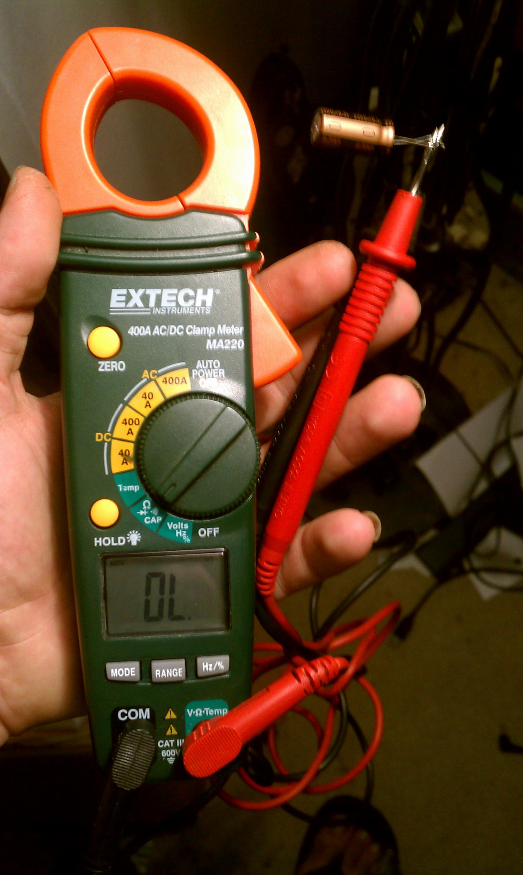

                        i desoldered the cm802 cap... a friend of mine supposedly has a DMM with a capacity feature so im waiting for him to come over with it
                        Don't fear the repair...
                        • triplefour
                          • May 2014
                          • 1747
                          #32

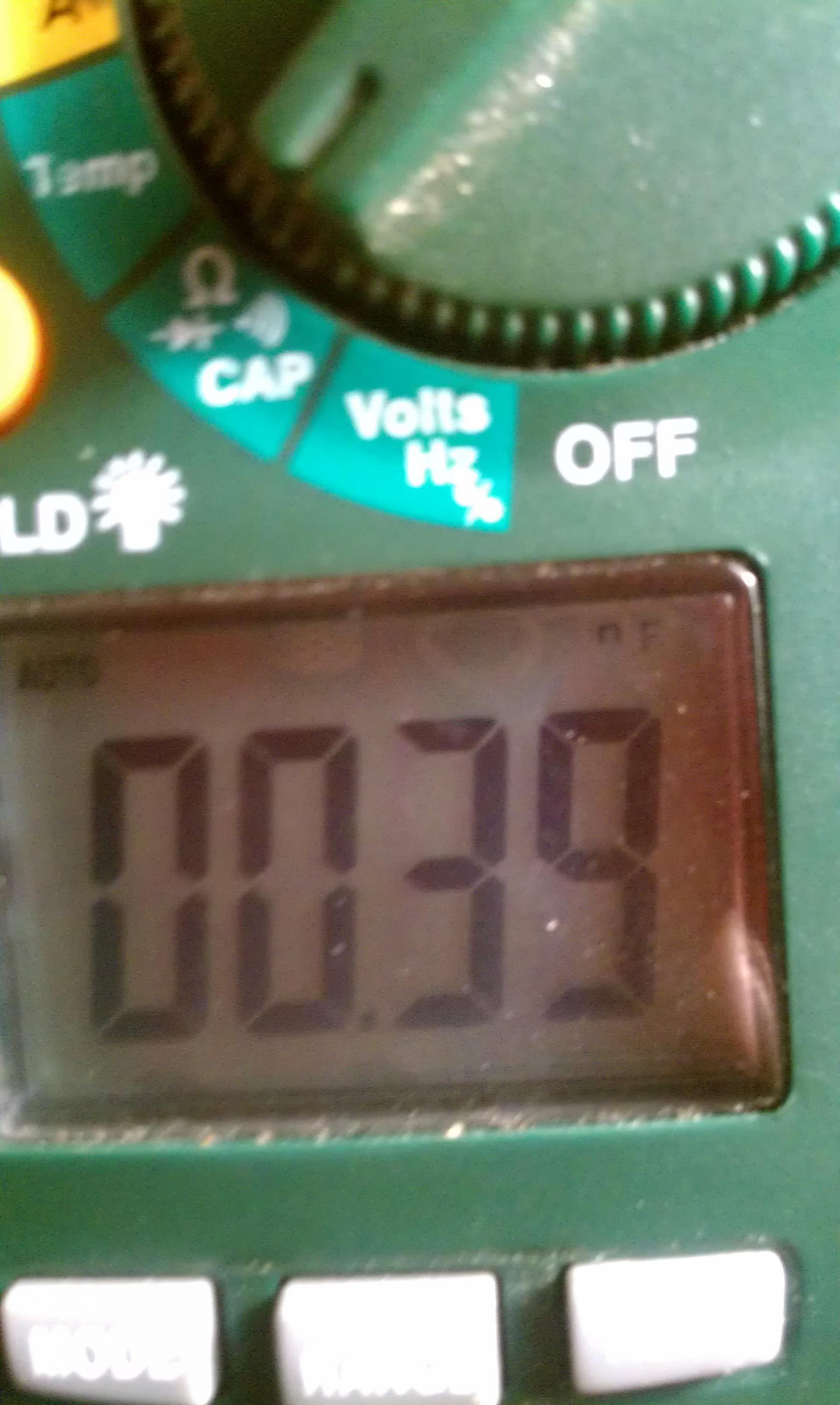

                          so my friend came over with his DMM that can supposedly test capacitance but i cant seem to get a good reading out of it. i tried testing caps i salvaged, and even some brand new caps i ordered to fix my xbox360 but havent put in yet. i guess its autoranging..
                          with the probes probing the air, and the mode set on what i assume to be capacitance (says nF in the upper right corner of the display)
                          it reads .39
                          sometimes it reads .44 or something close around that
                          anyway i put the probes on the capacitor leads
                          black to the one with a stripe (shorter lead)
                          red to the other one
                          the display on the multimeter usually does not change.
                          once in a while it does change but to some number like 1.8 or 3.7 or something meaningless like that. it will stay at that number for about 10 seconds then it switches to saying OL (open line?)
                          if at any time during this "charging process" i remove the probes, i get a random reading of anything from 5.something to 27.something ...i cant see a pattern really. i think the longer i hold the probes there before it says OL the higher value i get but i cant be sure.
                          when it switches over to saying OL the little icon in the upper right of the display switches from nf to uf...
                          do i just not know how to use this thing, or is it broken?
                          *frustrated*
                            oh yeah i should mention i tried the same thing with the probes reversed and it makes no difference
                              i guess youre supposed to zero it out first...but i did that and it still pretty much does the same thing...

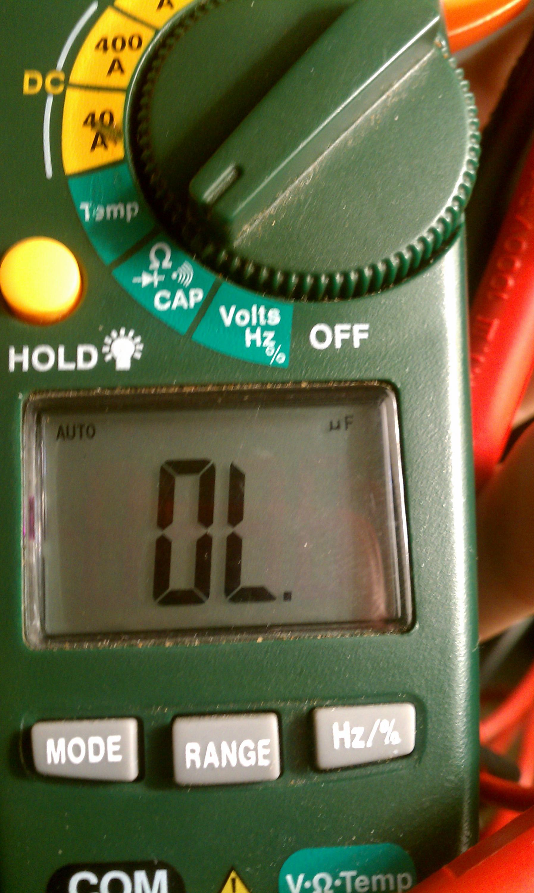

                                ugh i think i figured out why its not working. on page 7 of the manual for this DMM it says it can only read up to 100 uf ... is that right?
                                pretty useless...why would it only go up to 100uf???
                                • triplefour
                                  • May 2014
                                  • 1747
                                  #36
                                  oh wait but if the thing im trying to test is only 18uf then that should be fine.
                                  so i tested a bunch of smaller salvaged caps and most of them come up close within a couple microfarads of what they are supposed to be... what is the tolerance on these things? anyway i think i verified that my DMM is reading capacitance mostly accurately up to 100uf anyway. so trying the test on the 18uf capacitor in question for this tv, i find it goes to OL after some time and thus... it is most likely bad. but without being able to test it on the board before removing it, what confidence can i have that i didnt ruin it myself with too much heat or pressure while removing it?
                                  • triplefour
                                    • May 2014
                                    • 1747
                                    #37
                                    oh man i just realized i was misreading.... its supposed to be 18nf not uf ... either way they are both in range of this DMM which i have verified as giving accurate readings... so i think its safe to assume the capacitor is bad... but as i still would like to know how to tell that i didnt destroy it myself while removing it...seeing as i cant test it prior to removal...?
