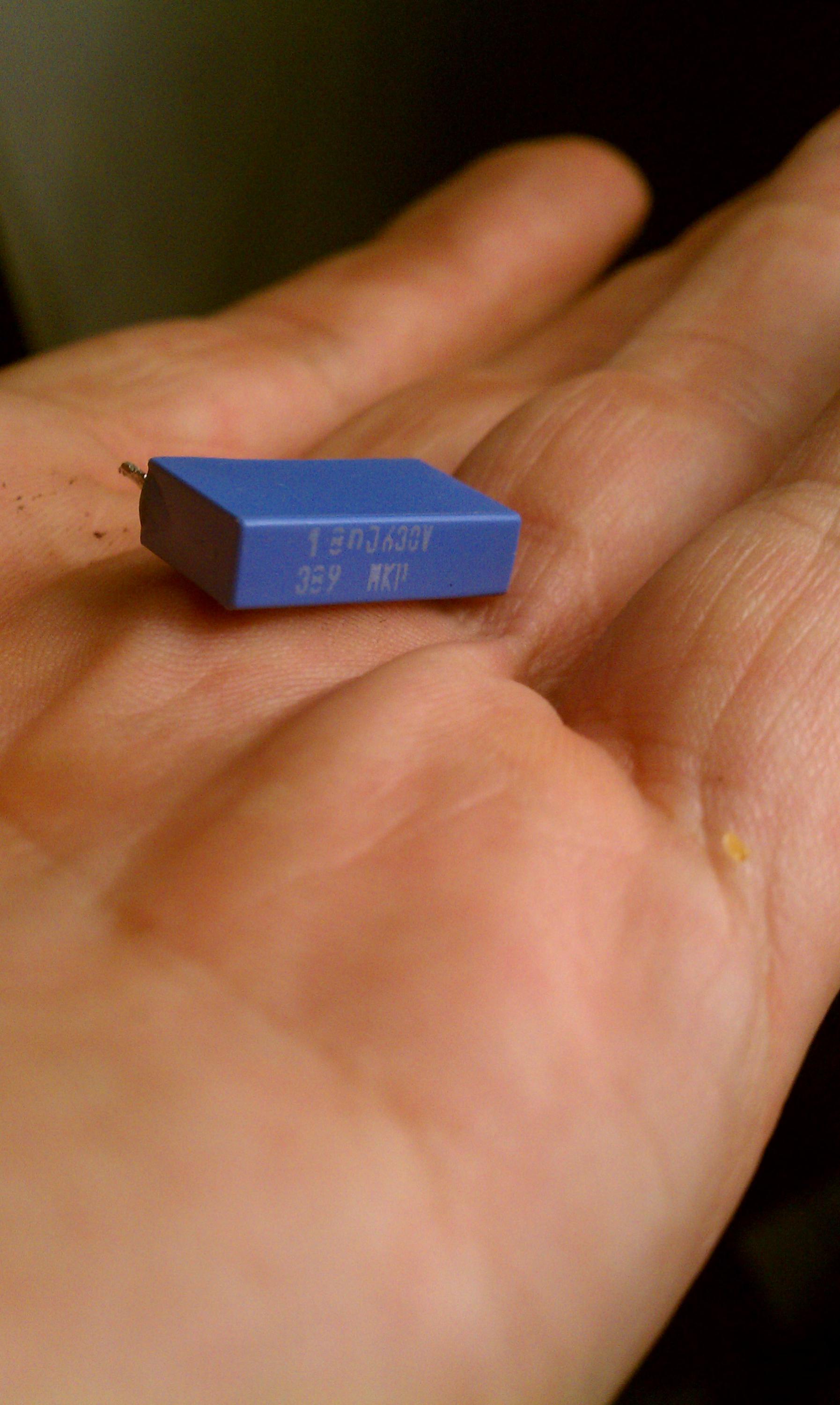

      thanks for all that and yes i am a noob so i could be wrong about a great and many things but of this one thing i am sure: the resistor i was measuring is dead as a doornail. there is no corruption from my fingers (i figured that one out...my resistance is something like 1600k) i replaced that resistor and now i think i may have found the problem in the cm802 cap which is giving me only a 10 nf reading when it should be 18 .. im going to try replacing that first and if that doesnt fix it i will definitely remove and test the other caps.

        so how do i go about ordering a new one of these?

          is this the same thing? http://www.aliexpress.com/item-img/1...143960248.html
          Don't fear the repair...
            #45
            Re: Samsung 245BW power led comes on but no backlight
            High Frequency, Switching
            http://www.digikey.com/product-detai...2121-ND/585188
              #46
              thanks. ordered it. will let u all know what happens when it gets here
                  thanks for all your help so far.
                  the capacitor came in the mail yesterday and i am going to put it in today
                  but then i realized its not like a normal capacitor that has a clearly marked negative and positive side. can i just put it in either way?
                    #49
                    according to what i read, film capacitors and ceramic capacitors are not polarized and can go in either way. so i guess im alright then
                      #50

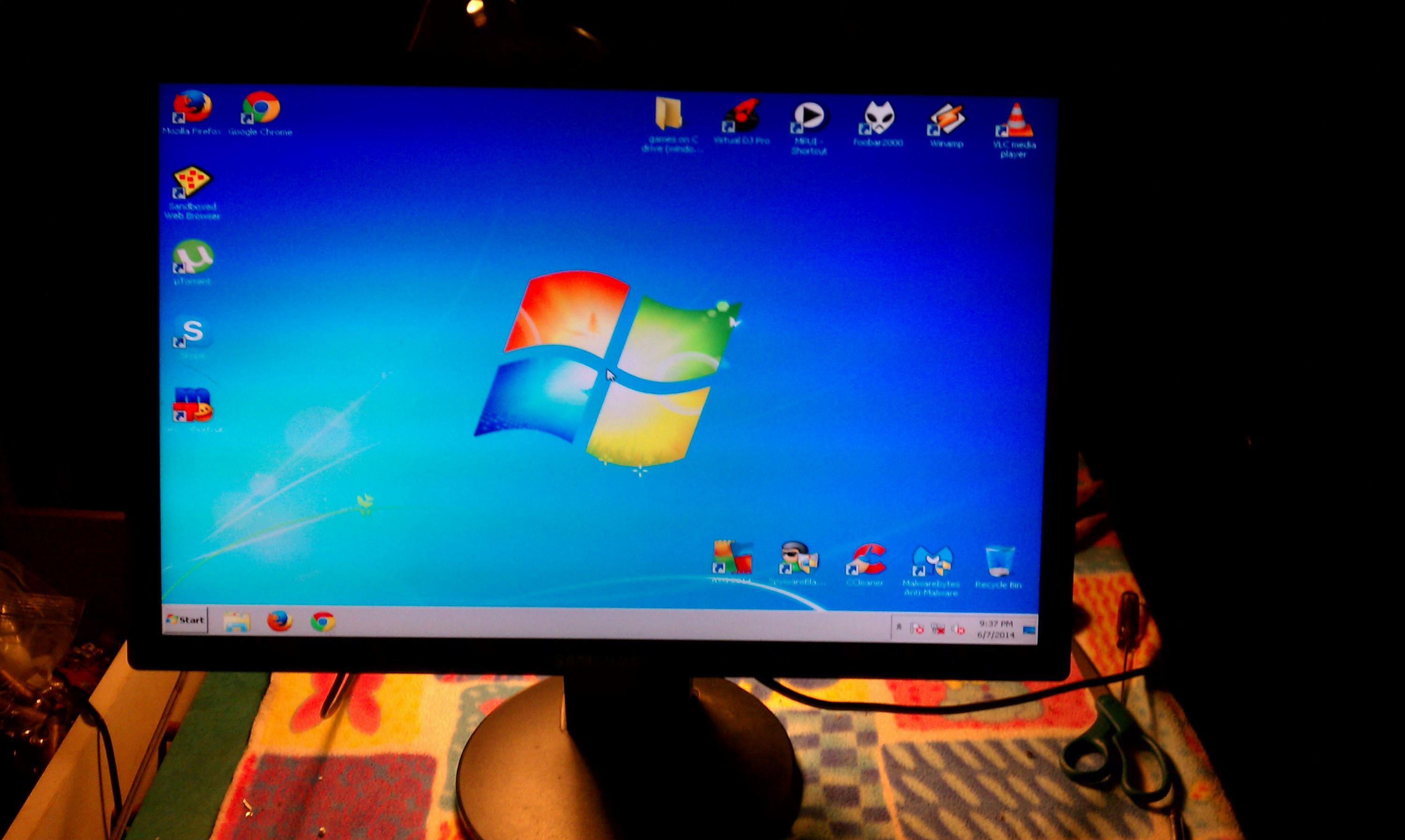

                            success! it turned out to be that 18nf cap! monitor works fine now! nice! THANK YOU!

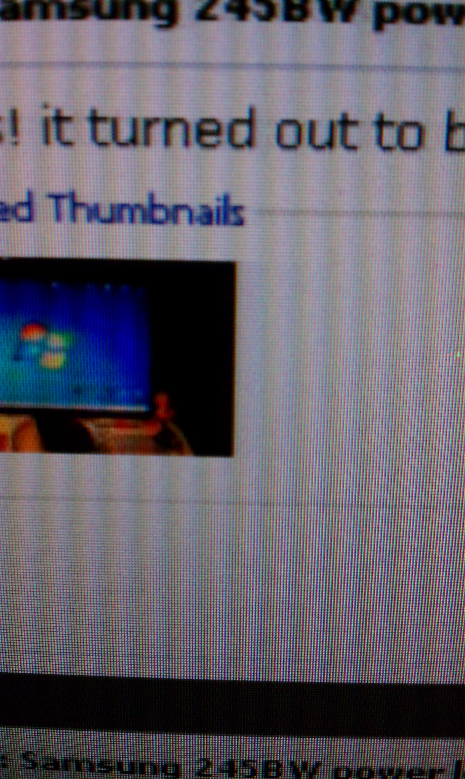

                              dang this is a nice monitor! 1920 x 1200 24 inch!
                                #55
                                just one small complaint though.. i see a faint ghosting effect on some things like 3 super light gray bars coming off to the right of anything with color...like for instance the thumbnail above should appear sharp but the right edge "bleeds" a little creating a kind of shadow of faint bars...
                                you can just barely make it out in the picture i took.
                                if you ignore the vertical lines which are a product of the camera trying to capture something that is refreshing, you can see that the image has a shadow to its right.
                                what could cause this effect, and am i calling it correctly "ghosting" or "shadowing" ?
                                its also happening in various other places of high contrast or certain colors...
                                not life threatening but still not perfect.
                                is this just a LCD screen problem, or could it be something crazy like capacitors almost but just not quite doing their job??

                                  Make sure all the connectors are seated, all the circuit board mounting screws are tight (a lot of boards are grounded through the mounting screws). It can also be bad filter caps on the main/scaler board.

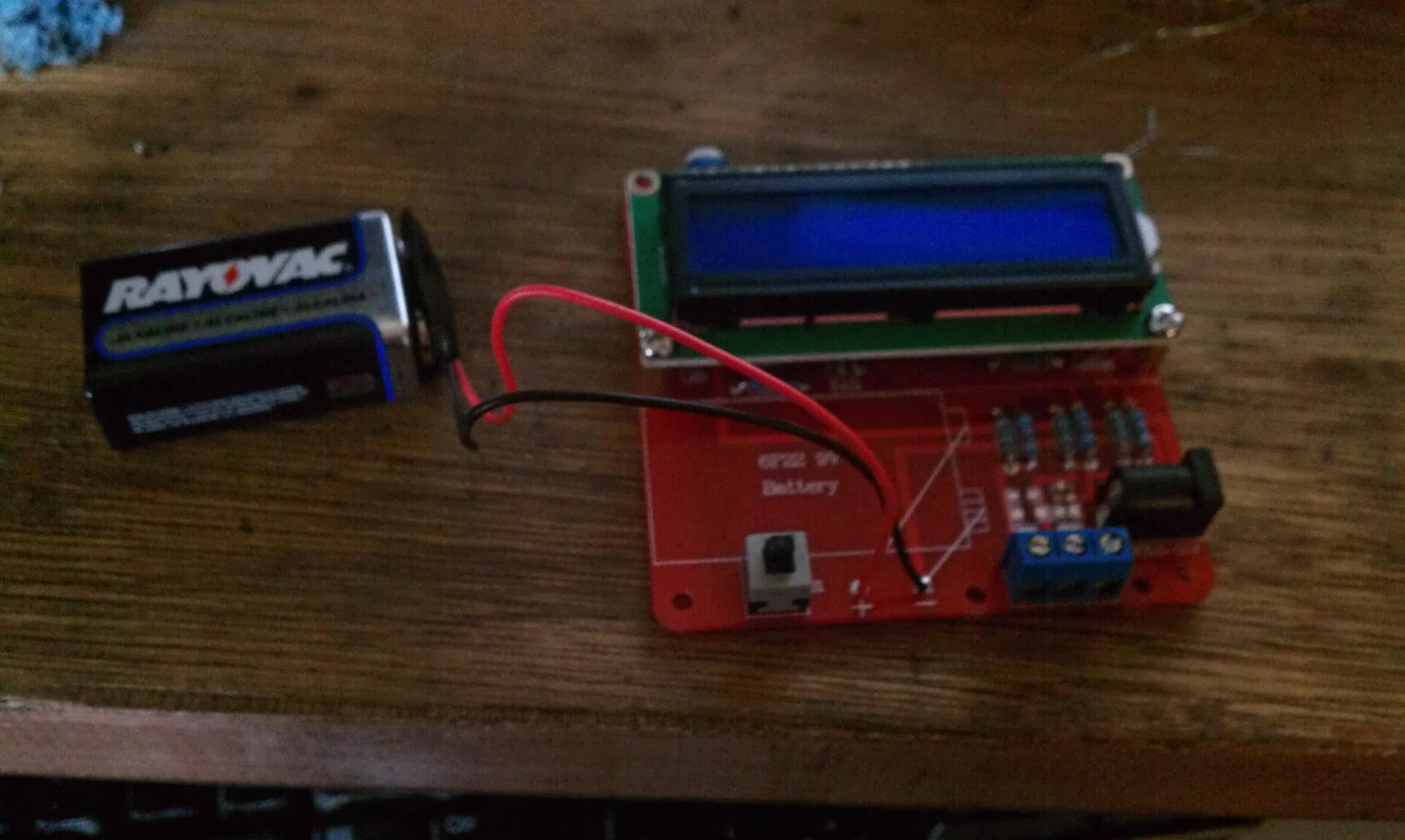

                                    yes i have the pieces for the ESR meter and now they gave me the instructions how to put it together so ill try to do that tonight. how necessary is it to get an oscilloscope?

                                        this is awesome. i bought a kit on ebay for 15 bucks, did a little soldering, and now i have a ESR meter.. well it tests a bunch of stuff...resistors, transistors, capacitance...
                                        http://www.ebay.com/itm/281262386306...%3AMEBIDX%3AIT
                                        so uh.. now i can desolder all the caps from the mainboard and test them! what fun! if only there were another way...

                                          #60
                                          hah good thing i caught myself before doing any of that...it was just a problem with the vga connector on my computer. switched to DVI connection and its all good now!
