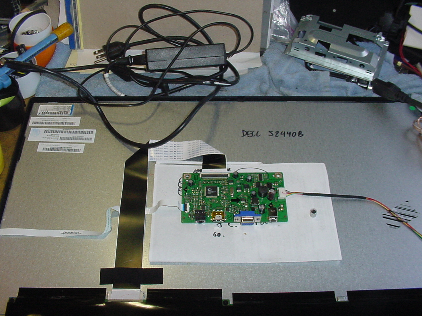

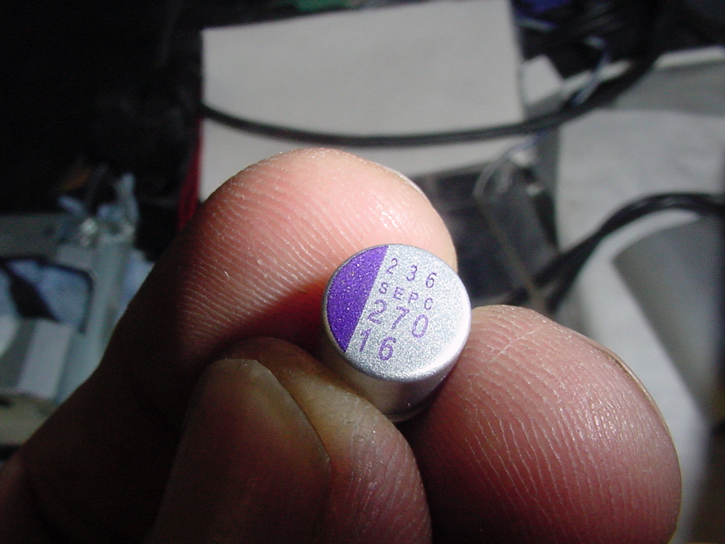

Dell S2240LB with shorted out solid capacitor

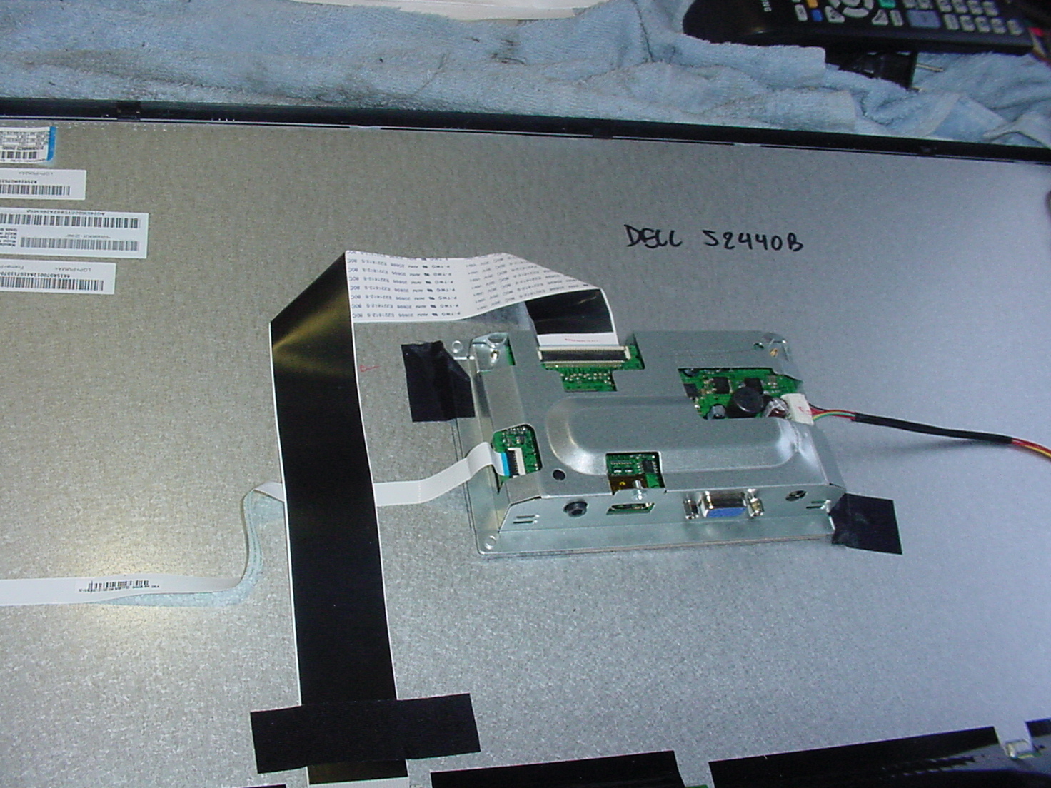

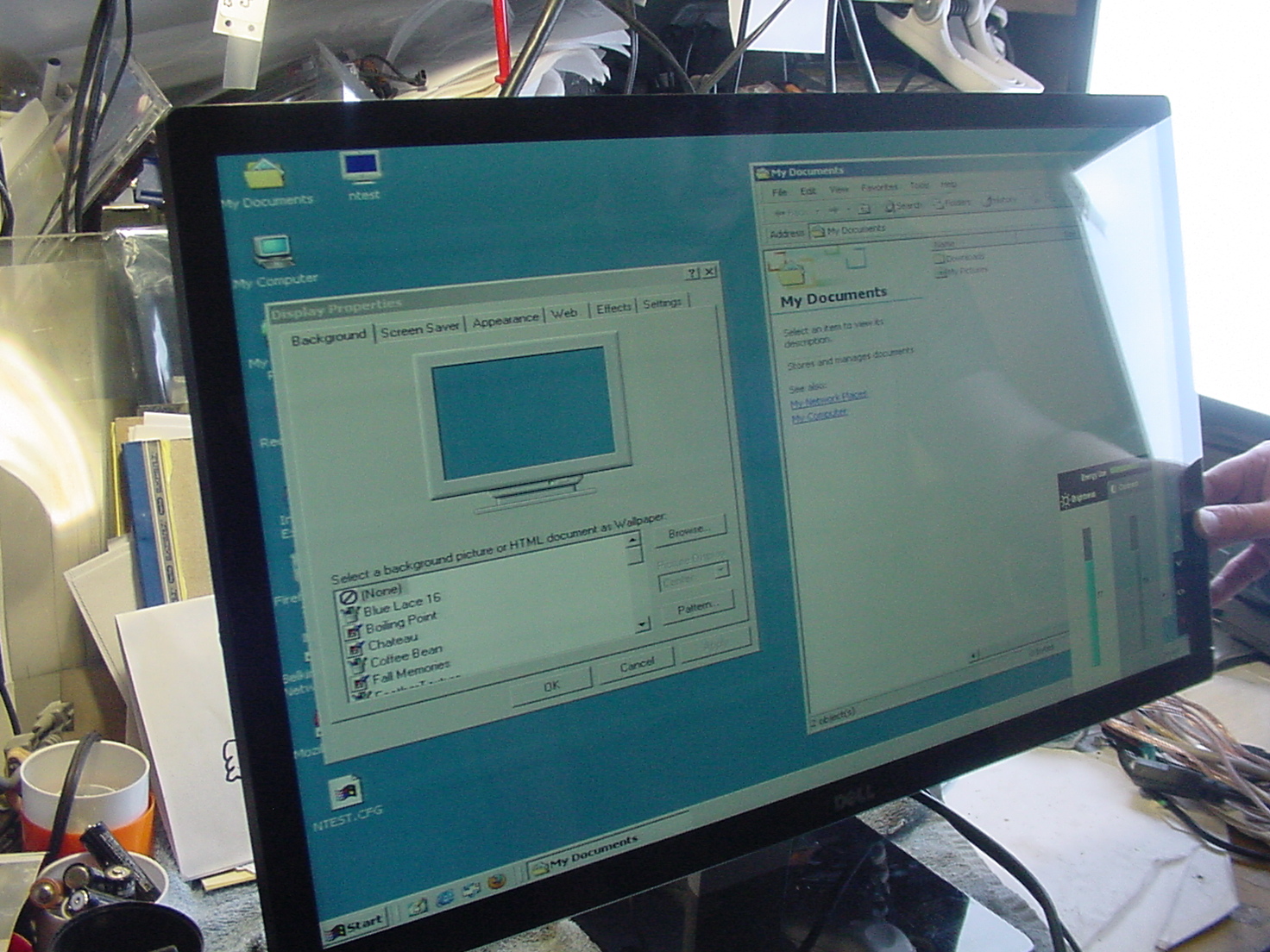

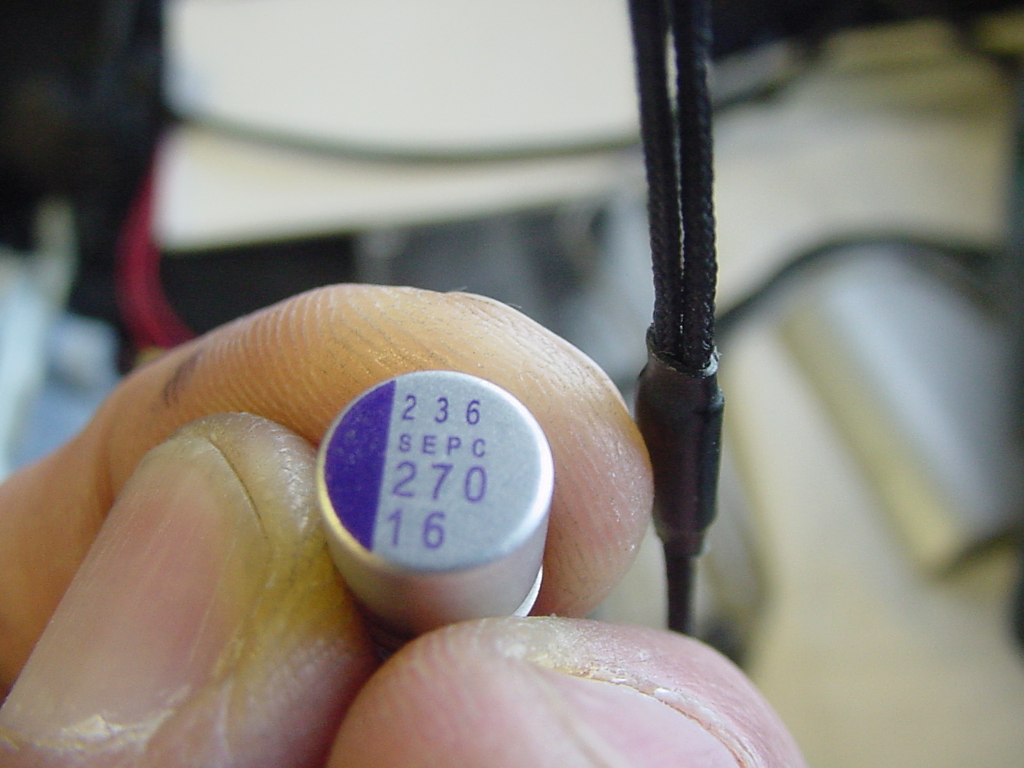

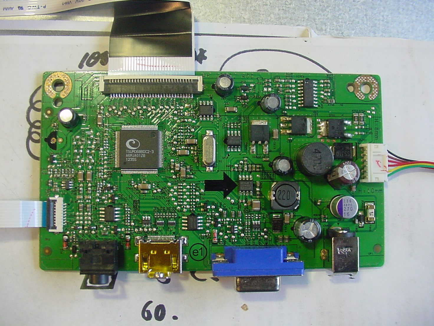

    Got this one in today, the AC adapter will shut down when plug into the DC jack on the monitor. The resistance between the + and - pin on the DC jack shows < 1 Ohm, remove the INDUCTOR that is connected between the + and the power MOSFET, the MLCC but the short is still there. I remove the solid cap then the shorts went away. I am surprised that it has this solid cap at the DC input jack but not at the outputs of the switching power supplies on the board. I install the PANASONIC FM in place in stead and check to see any ripple at the DC jack with the scope, nothing there to be concerned about. I will be burning in for about a week.
