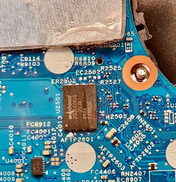

    Laptop does not power on but has a fix white light on power button, when connected to power.
    I found, while trying to diagnose, a hot spot in the motherboard and found it to be a shorted capacitor (see photo below) on the 2.5v (2D5V_S3 on schematics). After replacing it with one from a donor board, still, the board does not turn on...
    The usb-c meter reads upon connection 20.1v and 0.00a, with some occasional flashes to 0.03amps. After 10/15 seconds circa, it goes to 5.2v and draws an almost constant 0.07amps. (same behaviour as before)
    To my fingers, nothing seems hot (I don't have a thermal camera). I do however have a bench power supply, if injecting voltage can find the culprit.
    Thanks in advance

    try to check the mostfet main power
    • im_trying
      • May 2025
      • 14
      • Italy
      It is getting through both mosfets of dc-in, it measures 20v when the usb-c sends 20v. And 5v when it sends 5v.
      The 3.3v coil and the 5v coil are both present.
      All measurements are taken with the motherbard out and nothing attached.
      I just noted that with the battery attached, sometimes the white led on the power button doesn't turn on, even though all the coils have the same voltages.
      • kakazu
        • May 2025
        • 4
        • Philippines
        Try to check if power IC is good if not replace it
        • im_trying
          • May 2025
          • 14
          • Italy
          I don't know how to do that exactly... Still a newbie, but im trying. Should I check for any pin in particular on the chip? Like LDO?
          • im_trying
            • May 2025
            • 14
            • Italy
            I checked the the LDO I found in the schematics, which there are two. A 1.8v near the PD controller, and a 1.2v on the other side of the board. The 1.8v is present, the 1.2v is not. I guess we're making progress but I don't really know how to procede. Is it a bad EC chip? A bad BIOS for the EC chip?

              Please provide me the value of these two resistors near the bios chip
