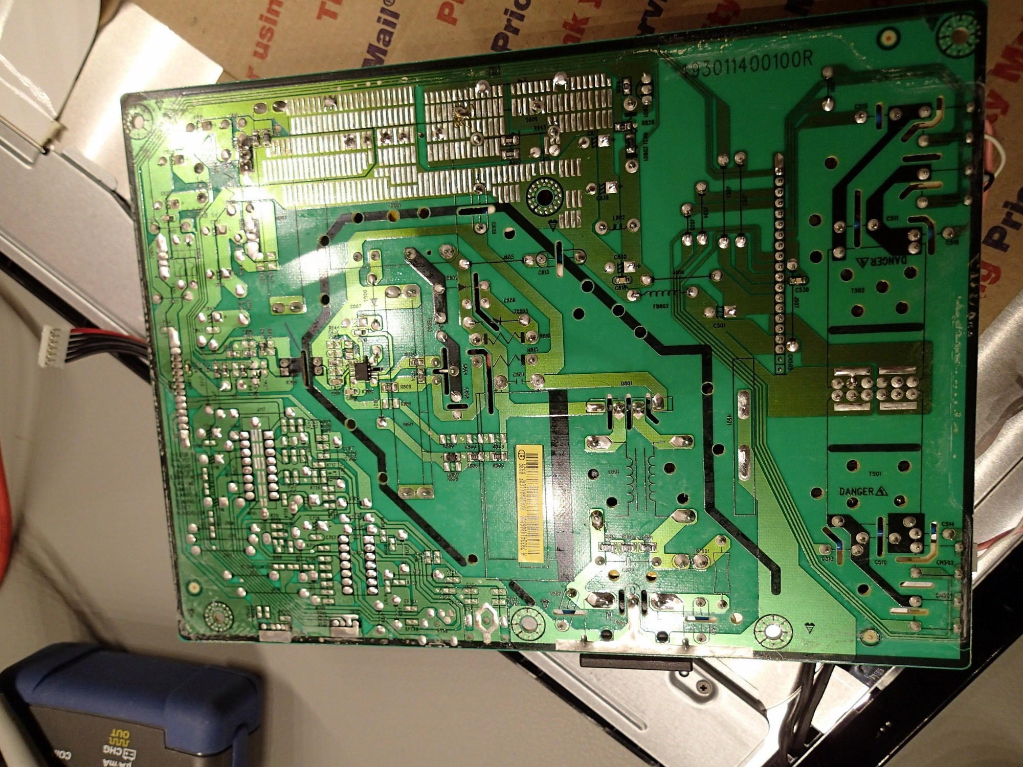

    Hi All,

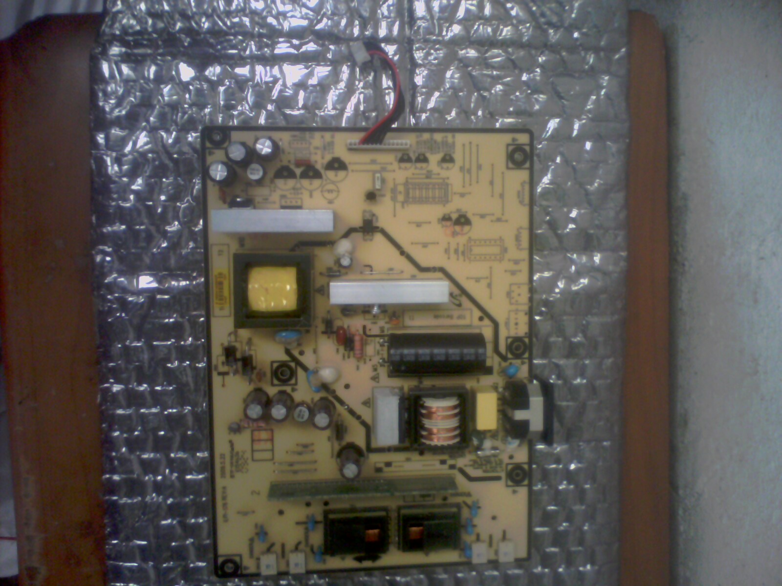

    I've got a faulty Samsung Syncaster 2333 LCD with faulty PSU : IPLI-176 Rev A. Some of the components are blown and can measure or read resistors R809 and R813 values.
    I'll like to know if someone can please upload the schematic or picture of the bottom side or please tell me what the components values of resistors R809 and R813 are?
    I've searched for the schematic to no avail; besides finding a IPLI-024 schematic which doesn't correlate with some of the components on the IPLI-176 board.
    I've also tried to zoom-in on photos of IPLI-176 PSU boards i found on the forum but can't really make out both components values as both pictures values doesn't seems identical. I've got some presumptions in mind (don't wanna reveal) but i need confirmation.
    Thanks alot

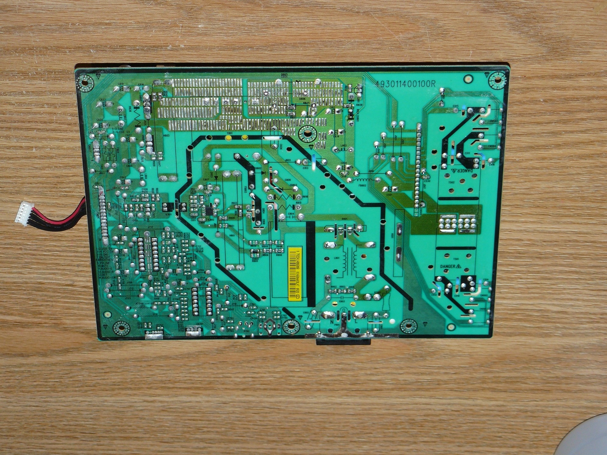

    Re: Samsung Syncaster 2333 LCD with faulty PSU : IPLI-176 blown resistors value
    There should be a barcode sticker on the board with BNXXXXXXX numbers printed on it.
    Post good clear pictures of the board.
    Is this the version you have?

      Hi Budm
      Thanks for the feedback.

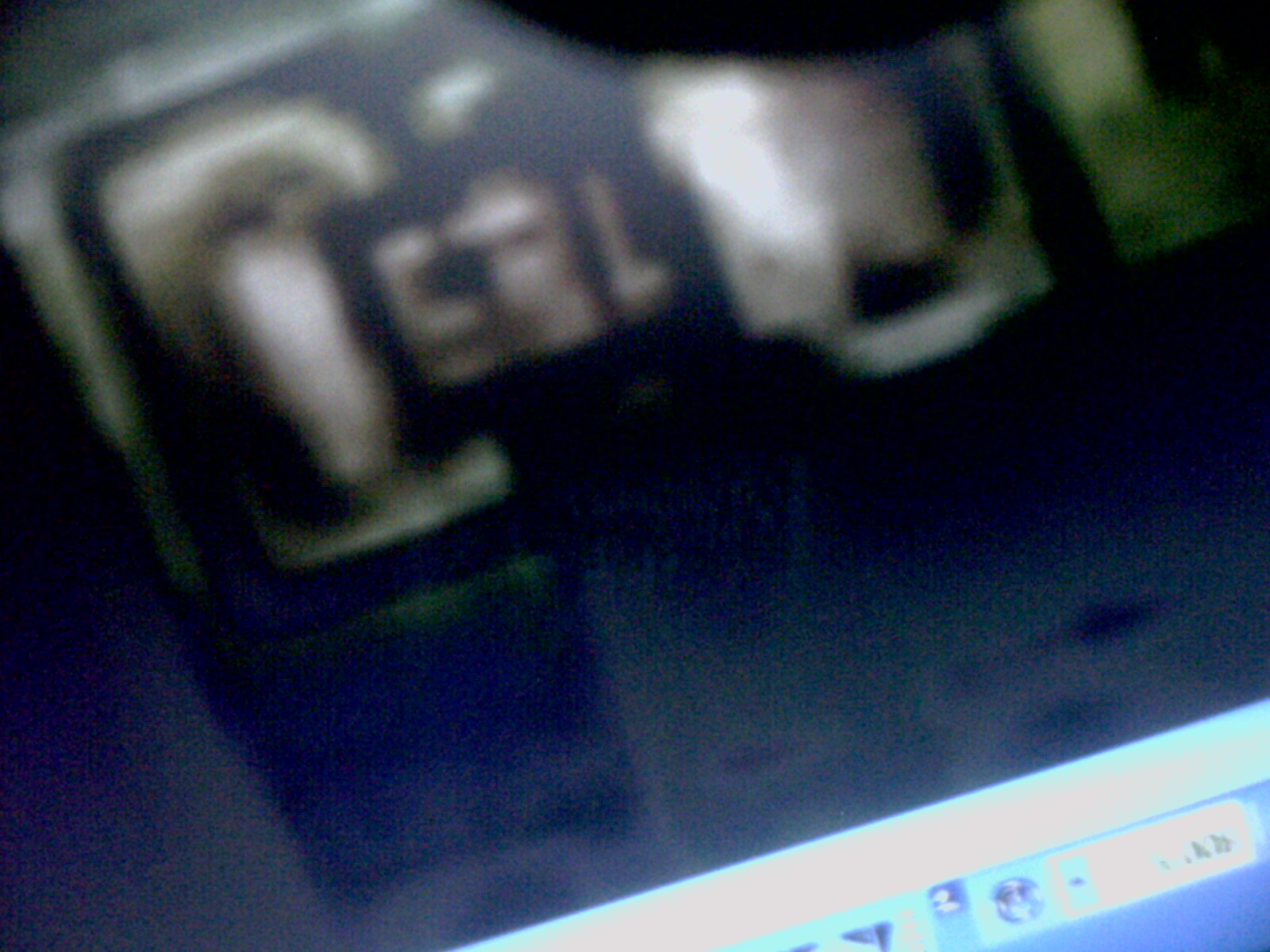

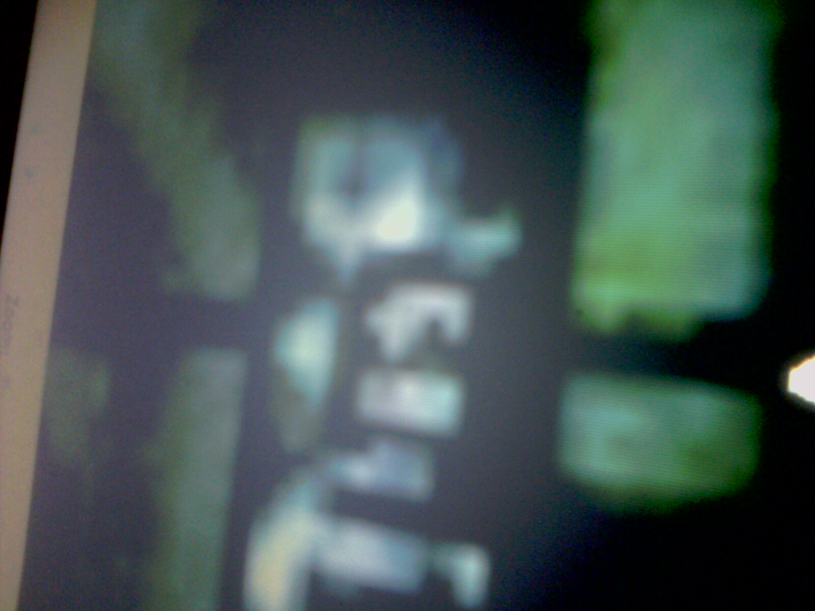

      Well, the blown resistors values can't be reliable identified since the marking almost wiped out and too blur, especially R813; therefore, i find it unnecessary to send photos of the actual PSU (well, except you have some sort of supervision )
      However, attached are photos of the identical PSU (which i got from the forum and the link you mentioned).
      The pics named R809_from_a_IPLI-176 are the outcomes (which doesn't seems identical!) of R809 on two different pics of IPLI-176 psu boards.
      I hope the above helps a bit, if not confusing.

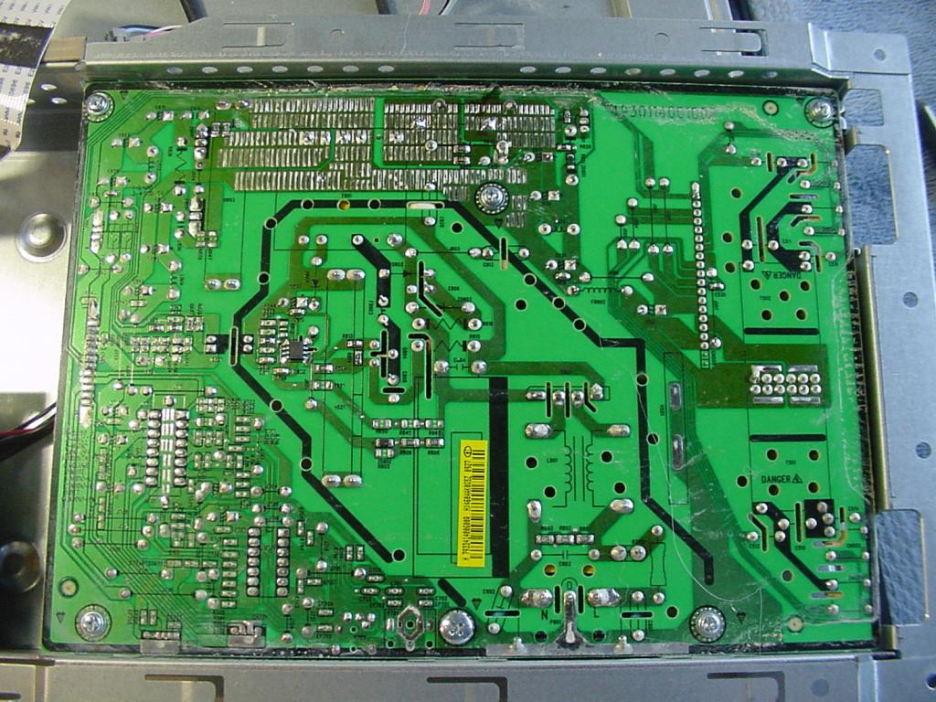

        Well, I will look and see if I save one of this board from broken monitor.
          That will be great Budm!
          By the way, the PSU board name is ILPI-176 Rev A and not IPLI-176Rev A as was written. My apologies for the typos (copy and paste!).
          The badcode or serial number you requested is H 793341 400600R
          Attached are photos of (i) the board under-repair (some blown components removed) and (ii) interested components.
          I could've uploaded clear photos of the specific spots/resistors but my current phone camera can't zoom-in nor produce high quality photos.
          While we're on this, can you please as well confirm whether suitable replacement for the pwm chip (OnSemiconductor NCP1337) could be Fairchild FL6300A.[/B]
          Perhaps, it might come in handy in future, just in case.
          Looking forward to your soonest feedback and thanks for the assistance so far.
            Well. I looked through my spare boards bins and could not find the board, sorry.
                Thanks Budm for your time.
                Thanks Iti for the link; but i did come across that a while ago and is more like user manual. There isn't any schematic of the PSU, besides a block diagram.
                Well, i have nothing more to loose, i'll go for 20 Ohms for R813 and for 1K for R809 and if it doesn't do the trick, i'll have both values.
                Regards
                Paul

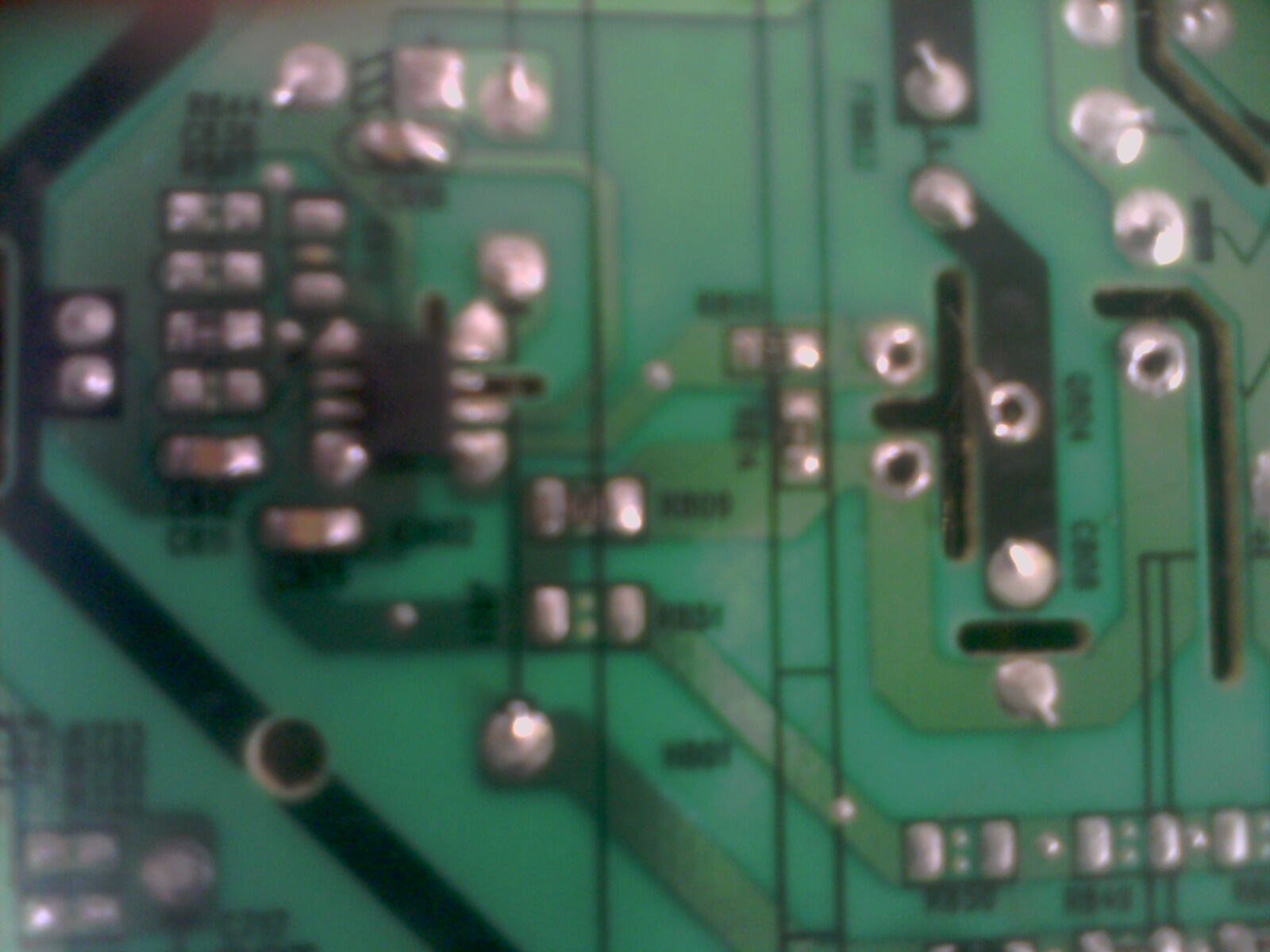

                  That R809 is the current sensing resistor which measures the voltage drops of the Source resistor R815, typical value will be around 1K. You can look up the application notes of that SMPS IC.
                  Did the MOSFET get damaged? That may be the reason that resistor R809 and the Gate drive resistor R813 (typical is 10~100 Ohms) are damaged, you should replace that IC 802 also otherwise you may blow up the new MOSFET. Check R815 also.
                    I'm not in contact with the ILPI-176 PSU board at the moment.
                    However, if i can remember correctly, the following known components were tested damaged: I've forgotten the component reference designations number.
                    - The PWM chip
                    - The Power MOSFET -- 2761I
                    - The 2W 0.43R (the short circuit resistor on the top layer of the board)
                    - R809
                    - R813
                    Regards Budm
                    • Pauldesign
                      • Apr 2013
                      • 49
                      • South Africa
                      The included link is the closest representation of the ILPI-176 schematic i've come across. Although it differs slightly but it' s good enough to chance on.
                      Included as well is the datasheet of the PWM chip, with so-called typical application schematic with little or no component values nor formulars to compute them in that regards.
                      https://cdn.badcaps-static.com/pdfs/...f457e2054a.pdf
                      However, the NCP1337 application note enlightens a bit.
                      But still, some of these semiconductors manufacturers should learn from Texas Instrument on how to do device schematics and appliaction note. How do they expect users to easily determine those values, besides thumb sucking them?
                      Anyways, I think i'm armed with enough info to un/smoke the PSU board now
                      Will feedback, if i made it in one piece
