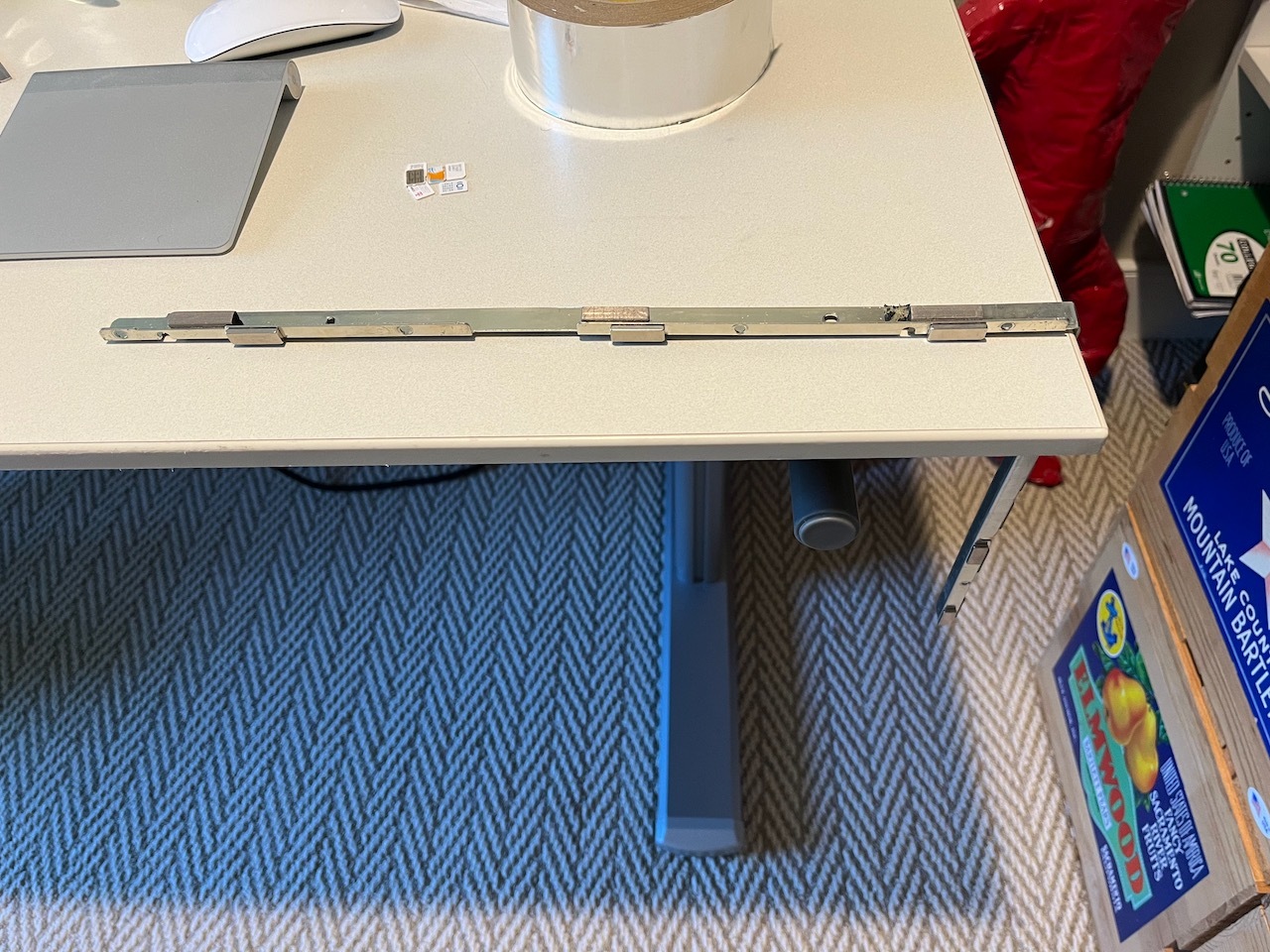

3 magnetic brackets
Each is secured by 4 T10 bolts. The 2 L shape ones have a really sticky surface and is quite difficult to remove the first time. Wedge tool is helpful. However, there is another couple of layers framing internally so probably want to review the steps ahead to make sure don't wedge into the wrong place.

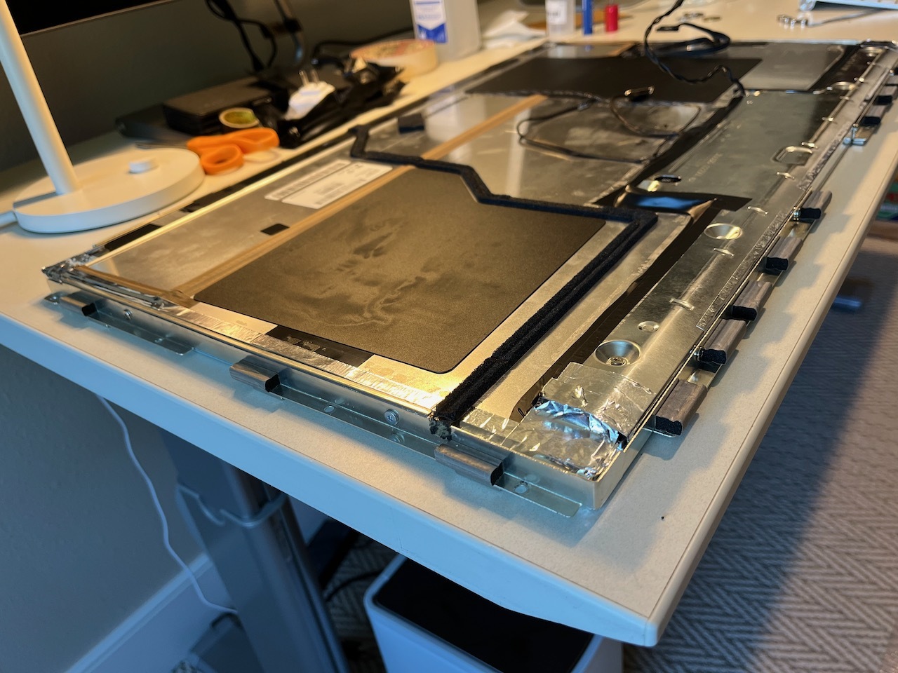

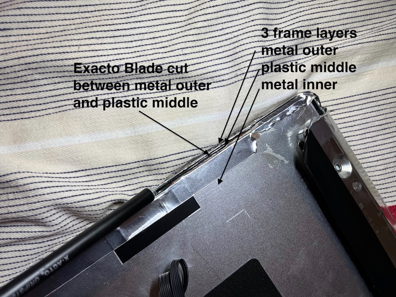

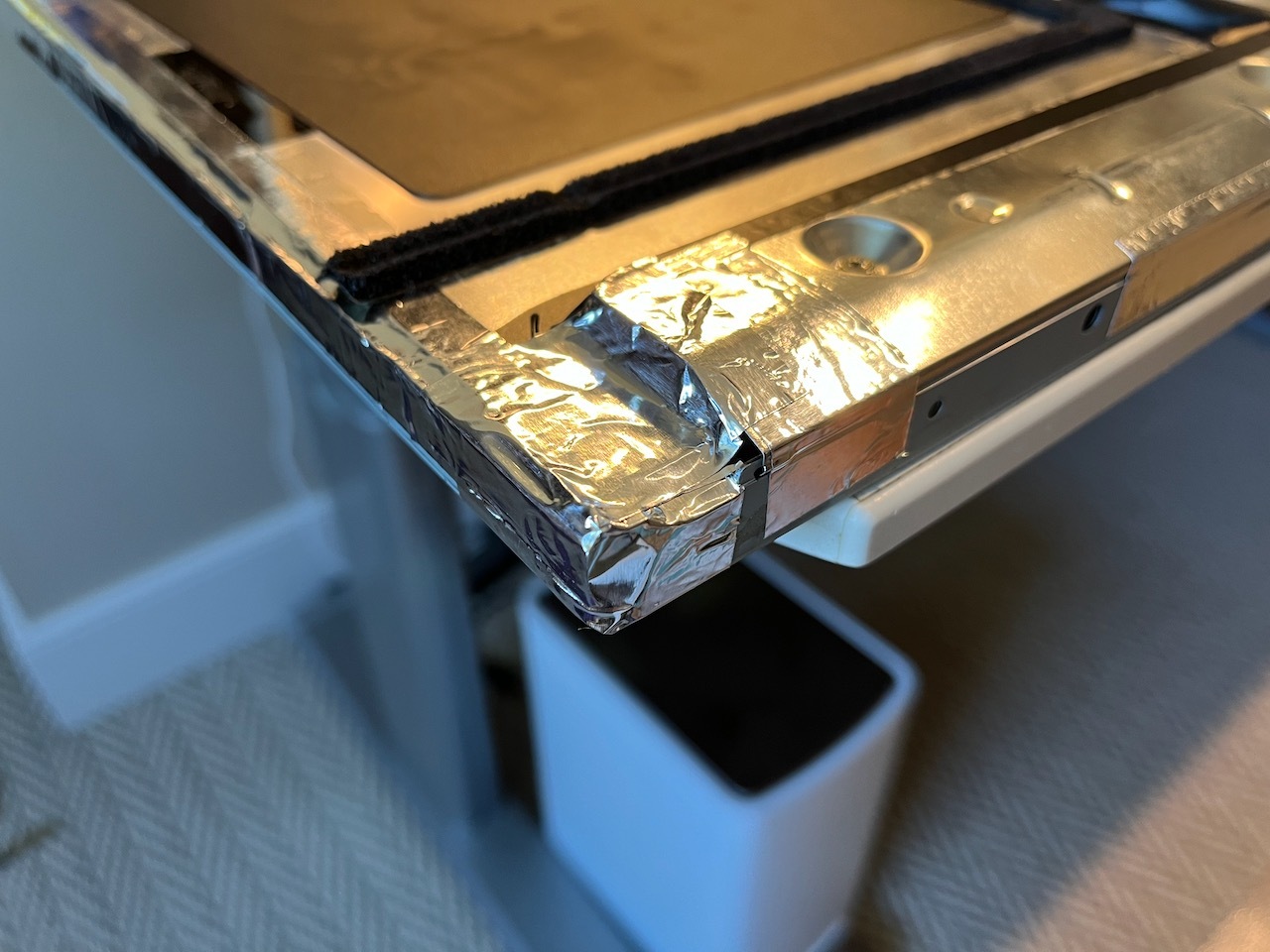

Outer Metal Frame
This frame clams over LCD and internal diffuser/light guide/LED bar assembly and is one of the most difficult steps. Looks like this once removed

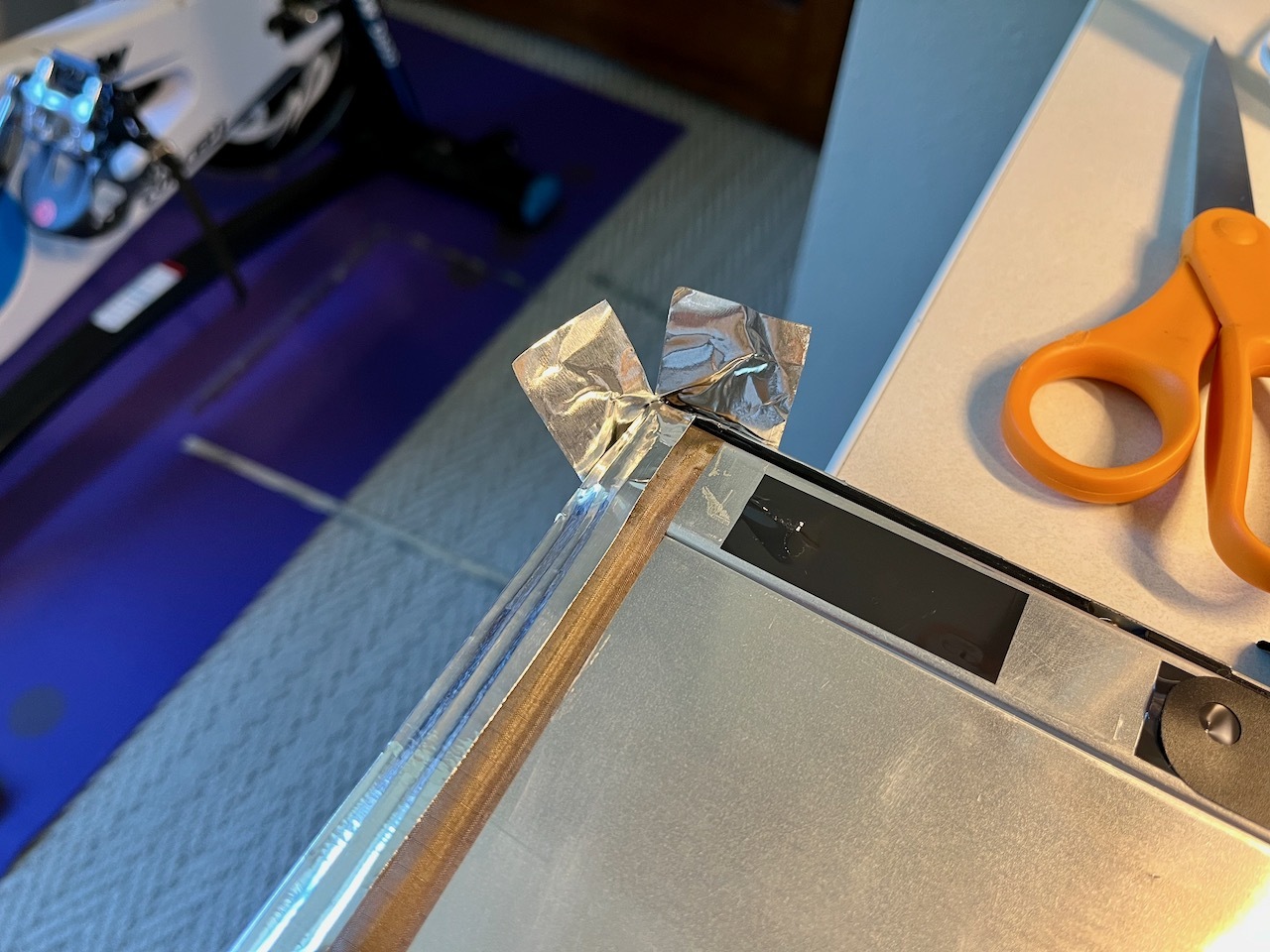

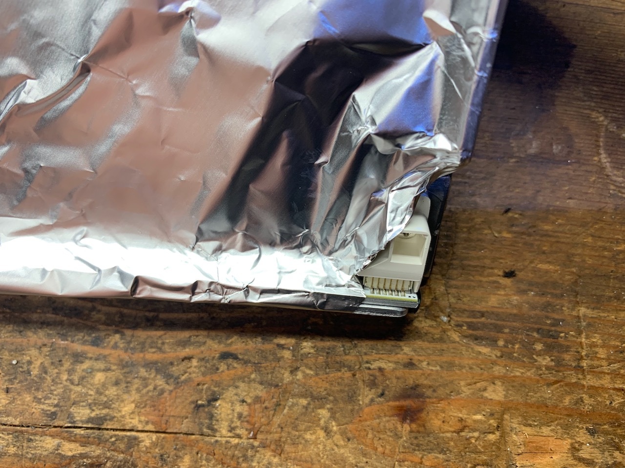

Foil Tape Removal
First remove the aluminum foil tape. Quite laborious. Can cut this IF know where to cut but maybe too dangerous for first timer. On reassembly need to be refoiled to avoid thermal cycling metal popping noises. Can just tape over cut foil but maybe best to remove all the old foil tape for first timers. Take a lot of time but is safer process to remove the frame without so many sticky parts and not sure where to pull / wedge etc.

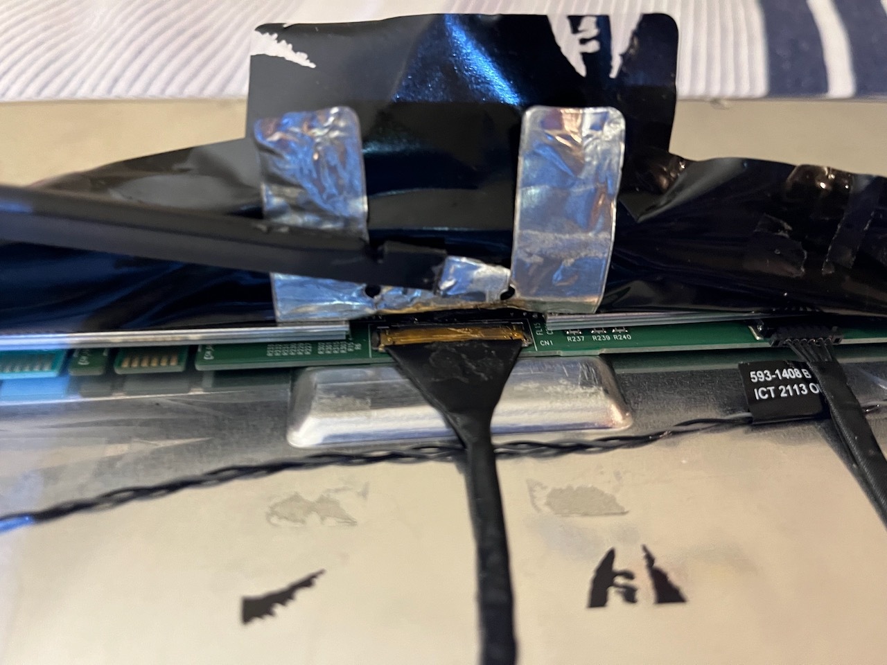

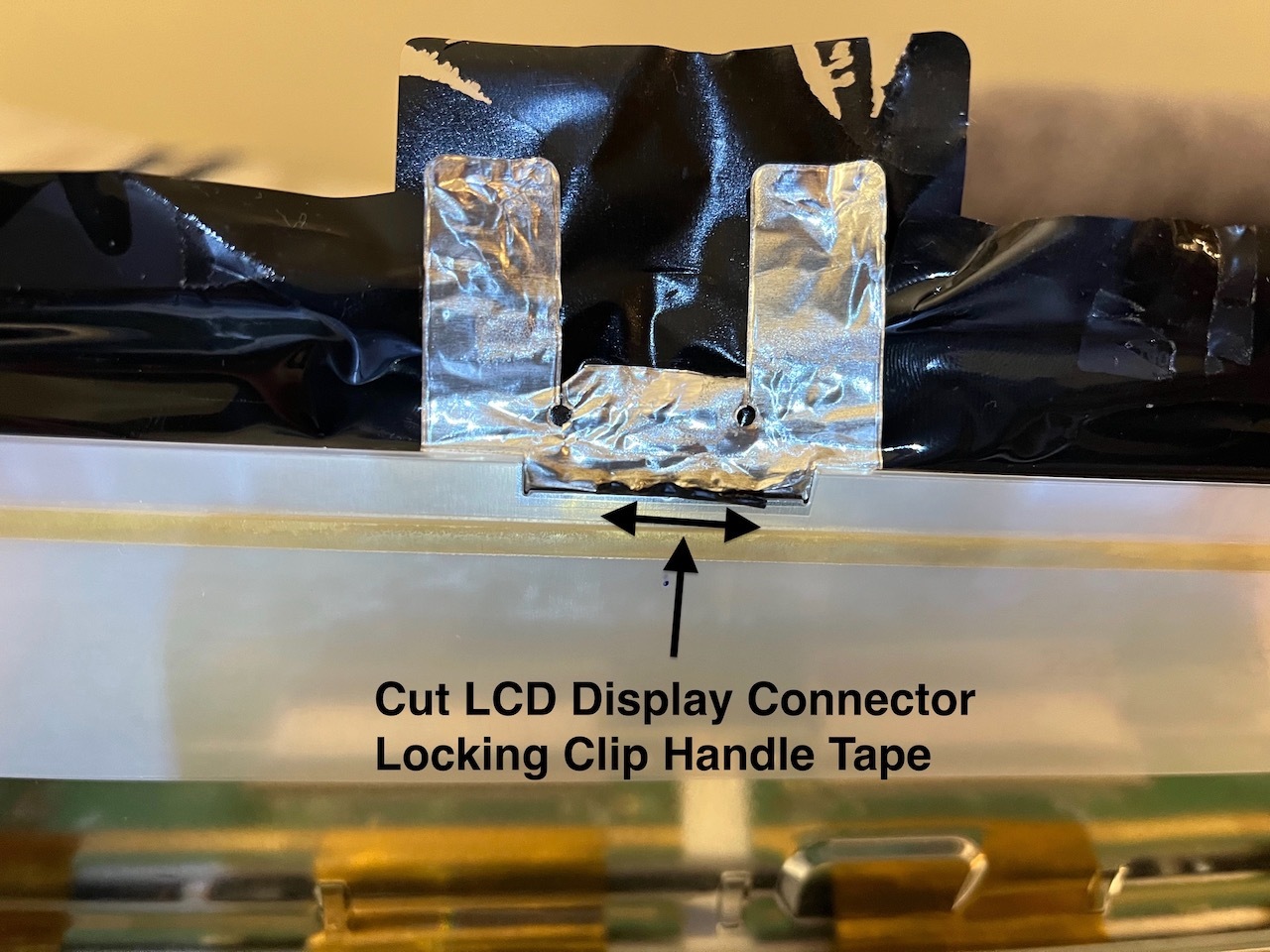

Open T-Con LCD buffer board metal cover
After the side + corner foil tape removed. On to opening the LCD buffer board + T-Con flip metal cover.

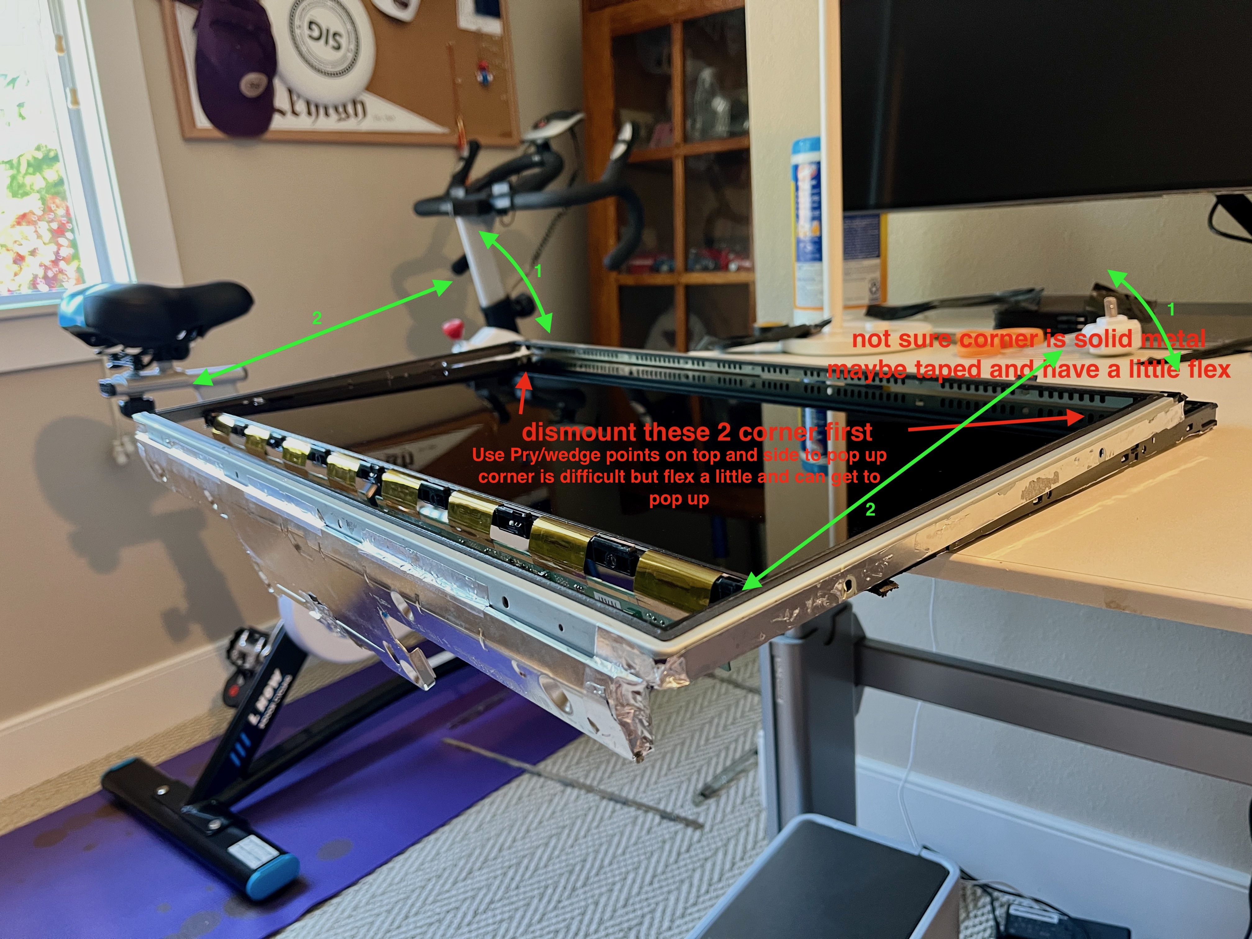

Removing the outer frame
Peel back the 2x black lifting tabs off of the outer frame.
Finally able to remove this frame. But note all the fragile LCD buffer board is exposed now AND LCD screen can easily fall out once this frame is removed. Need to be ultra careful.
NOTE it is MUCH safer to wedge up frame from the opposite end to the buffer board for removal. This way you never squeeze the frame against buffer board to LCD flex. During reassembly, its the reverse, you want to insert the buffer board end first to keep it safe while clipping on the opposite end.
Dangle T-Con / buffer board cover and buffer board over the edge of the table so these don't get damaged. However, it is then harder to use a wedge to pry loose the metal frame clipped into the plastic frame underneath. But this is what I do. Tilt up and wedge open from the opposite (to the buffer board) end. 7 Clip points total (see removed outer metal frame pic above). First 2 corners are the hardest.
Maybe good to have a 2nd person to help handle LCD/tilt while the other find wedge points and free the 2 challenging corners.

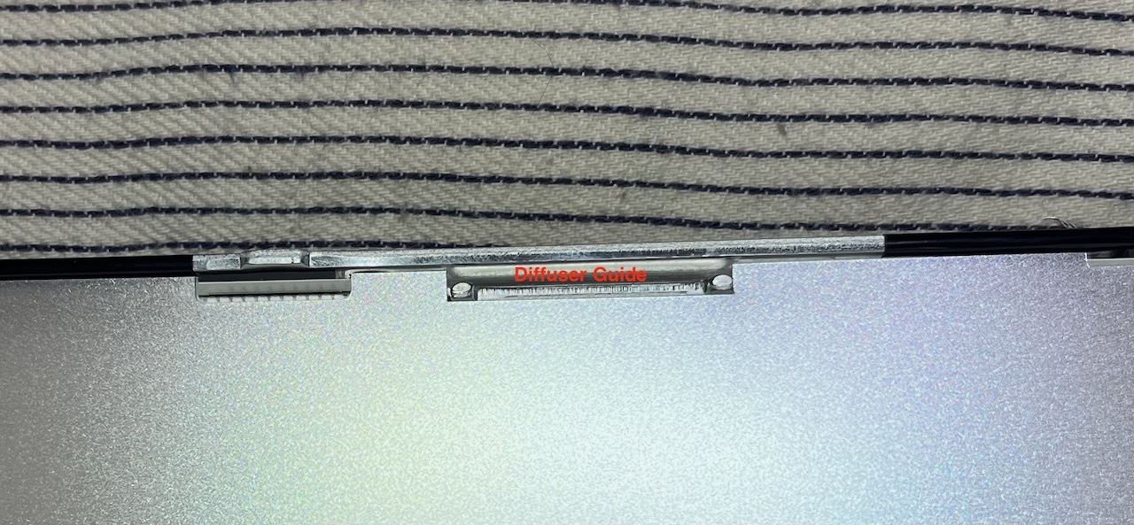

Diffuser Reassembly
The tub has guide posts that diffuser sheet must align to. They are slippery so carefully align these

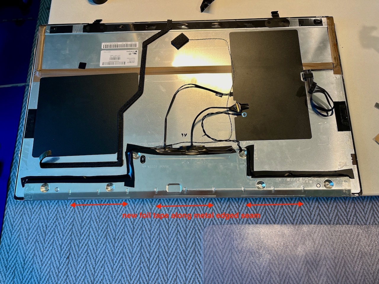

Its really important to reseal this cover properly or likely will produce popping noises between metal cover and metal tub and the rotating seam.
This step is really really important. The T-Con/buffer board cover is thin sheet metal folded against the sheet metal tub with a long seam between them. Cover is also a long piece only held on by 4 screws. If the foil and black retape is skipped, display will have random pop/click noises as it thermal cycles.

Outer Metal Frame
- Once this frame is removed, LCD can fall out so need to be quite careful handling and orienting.
- Frame is aluminum duct taped on and then need to be wedged off of few clips. Again, more internal framing so need to be familiar where to wedge.
- Frame folds over the T-Con and LCD buffer boards which are also double sided taped down.
- Foil is along the 2 sides AND all 4 corners. Foil also over the flip metal cover for the LCD buffer boards and t-con.
- Side foil also cover a brown fabric tape that covers wiring so be careful and not cut that.
- To lift corner of tape off of metal chassis, a razor blade is helpful and much easier than fingernails.
- 4 screws + numerous tape secures the cover.
- Remove ground strap and screw
- Peel off all black tape (can carefully save it and reuse but I used electrical tape instead to minimize chance of thermal cycling noises)
- After black tape removed, removed the remaining 3 screws
- Unlatch the LCD cable and remove it
- Disconnect 6 pin connector
- Disconnect LCD temp sensor connector
- Lift up the cover
- Carefully clear the temp sensor cable

Diffuser Reassembly

- Extend the tub over the edge of the work table so LCD buffer boards dangle in air when LCD is installed.
- User suction cup to handle the LCD for reinstall
- Insert the 2 corner opposite of the buffer board into the slotted corner on the plastic frame
- Lay down the buffer board end, note the buffer board flex cables will lay into cut open channels in the plastic frame.
- Reattached the 1-2x brown cloth tape on the edge of the LCD.
- Extend the assembly over the edge of work table so buffer board + tcon cover can dangle over the edge
- Insert/install the buffer board end first
- Gently press and clip in the opposite end
Reinstall buffer board + T-Con
- Buffer boards and T-Con screw holes are also alignment posts for board screw holes. Line these up
- Insert the tcon to buffer board flex cable and latch it, lock the wide latch with 2 fingers from both hands.
- Use a little pressure to secure board against their double sided tape.
- Attach the LCD cable, 6pin cable, temp sensor cable
- Close the metal cover. Becareful not to smash the temp sensor cable
- Install 3 cover screws and ground cable screw.
- I use electrical tape to secure the cover seams against the tub
- Peel off the 3x foil along the seam and install new ones. This is a long metal to metal seam. Important to secure this area without movement as display thermal cycles.
- Cut strips of foil tape and seal the left and right side similar to original.
- Foil tape all 4 corners
- Foil tape both edge of the buffer board cover firmly against the tub.
Magnetic bracket installation
Lay LCD face down on a flat surface (and make sure nothing scratches it) Use the flat surface as a guide to level the magnets on the magnetic bar. Note the LCD will rest on the foam around 4 sides of the LCD. This foam is easily damaged so be gentle rotating and sliding the LCD AND when working over the table edge (for better screw access) where it can damage the foam.
Make sure the bars are as straight as possible. The L bracket likely have slight bend due to difficult disassembly with its sticky inner surface.
- Install bottom straight bar. Make sure the 2 black lifting tabs are under the bar (between the bar and outer metal frame) Press down with magnet flush on the table and therefore flush against the foam around the LCD on the outer metal frame.
- Tighten the screws reasonably tight but not over torque.
- Install L brackets. Press down and alignment magnet to table surface. Top maybe more difficult to get it completely flush to table surface.
