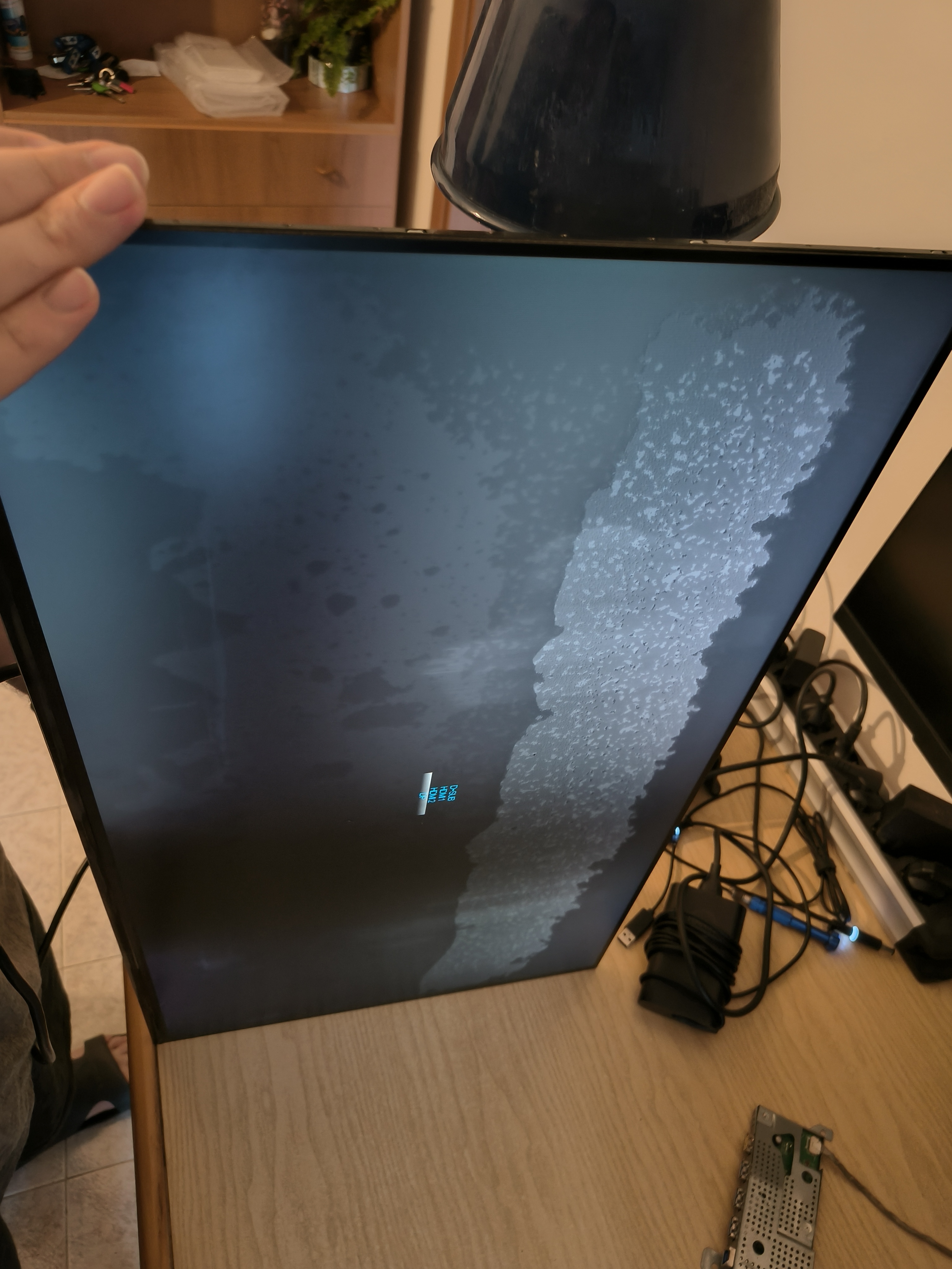

    Hi everyone, i have this monitor that has this problem. The monitor goes on and the buttons work. Click image for larger version
    Anyone know what Is the problem? Thanks

    It looks like the monitor was exposed to rain...
      It Is fixable? What Is damage?

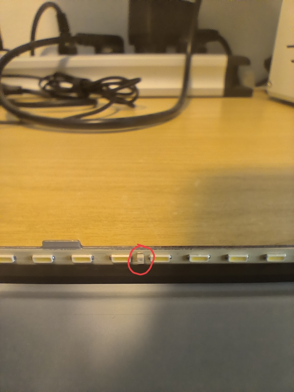

            I don't have a doner. I noticed that the leds don't work are all nearby. And there Is 2 components at the estremità (meaby 2 diods). Can be them the problem?

              • rogfanther
                • Jul 2006
                • 458
                • Brazil
                Possibly one of them is bad, and the whole segment will then stop working.

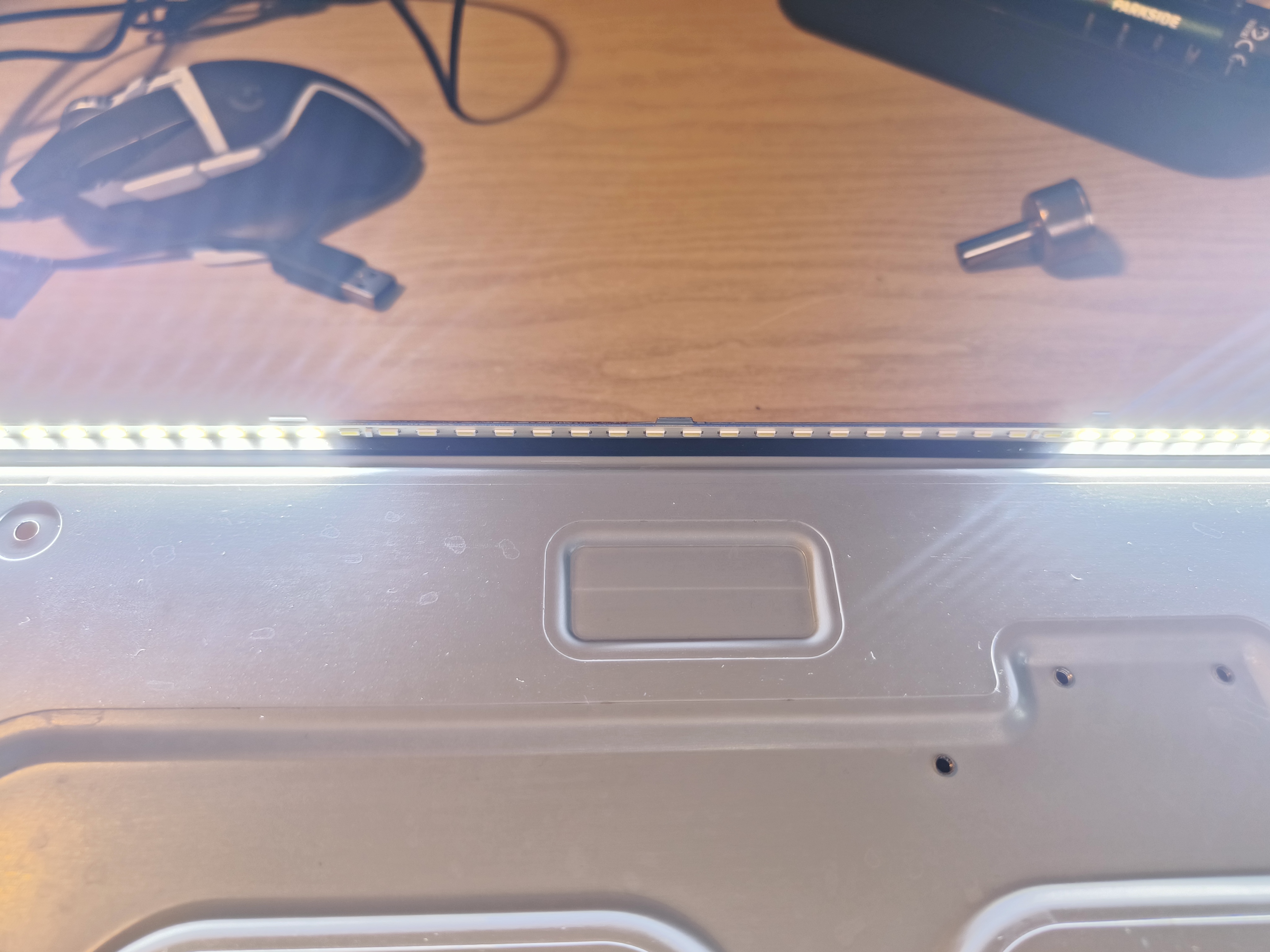

                            Click image for larger version  Name:	IMG_20240630_192453.jpg Views:	0 Size:	658.0 KB ID:	3299785

                            I test each led individually and each works fine. Now I don't understand.. can the problem be the two components at the extremity of the section that doesn't not work?
                            What Is that?
