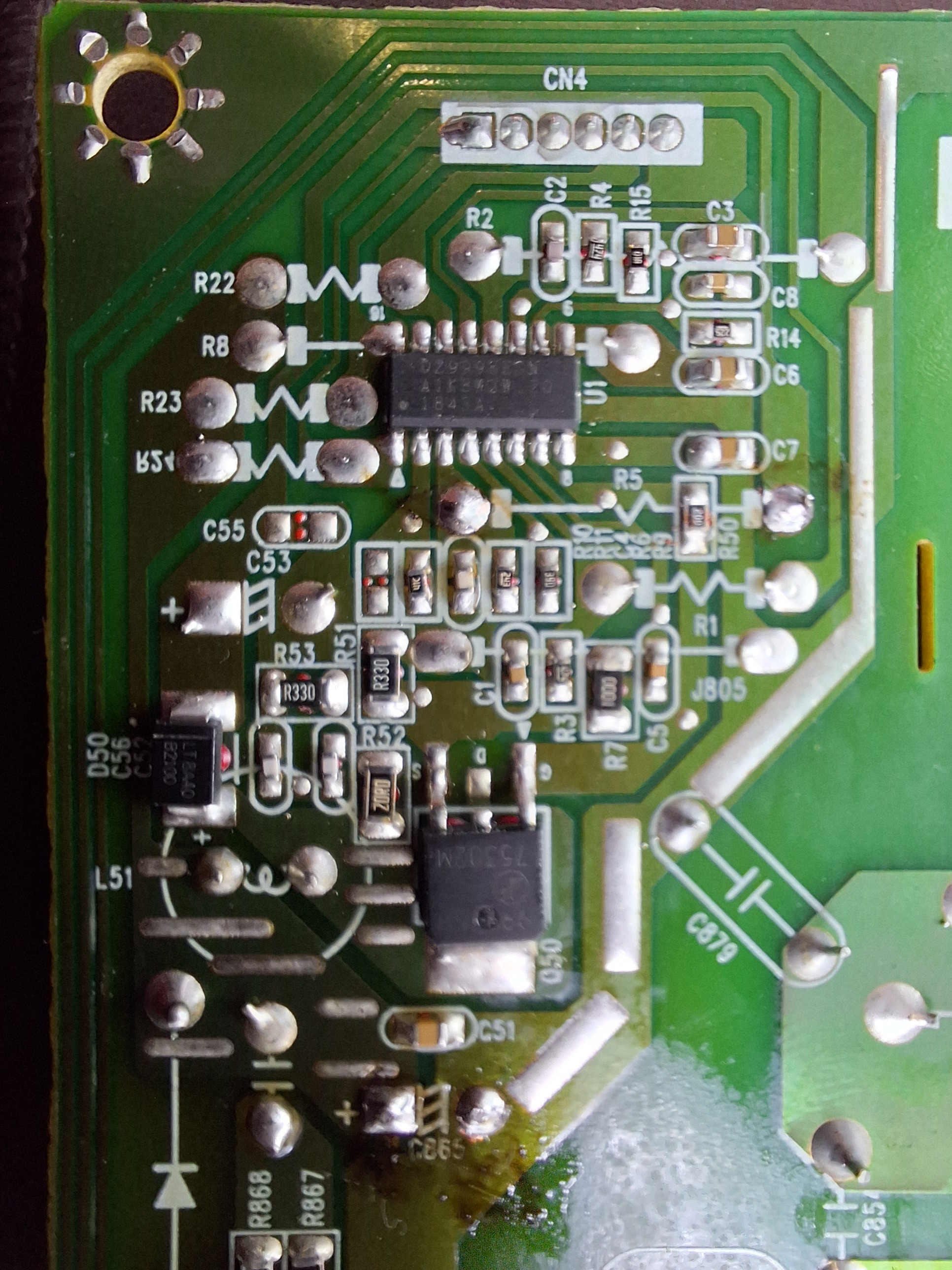

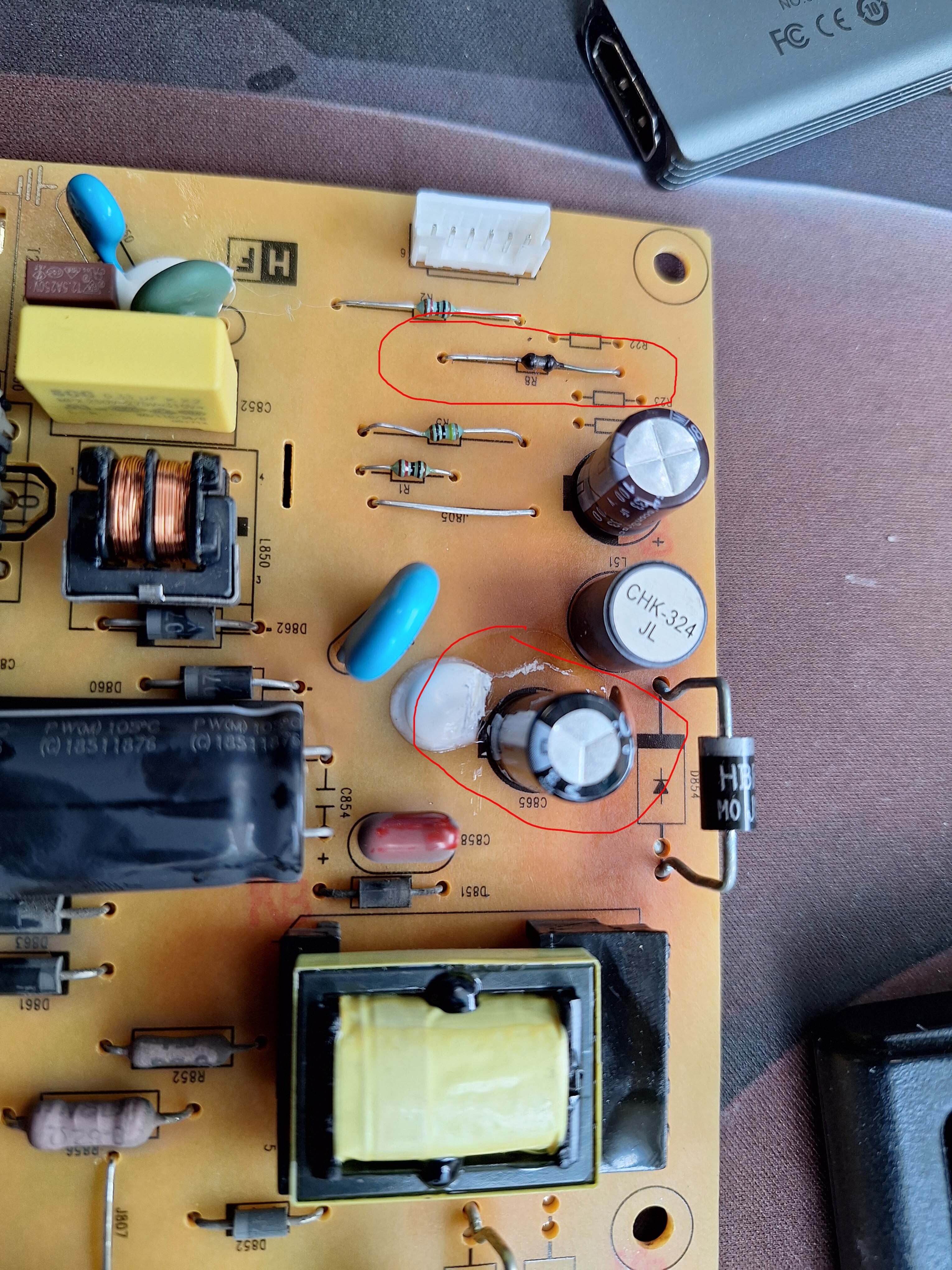

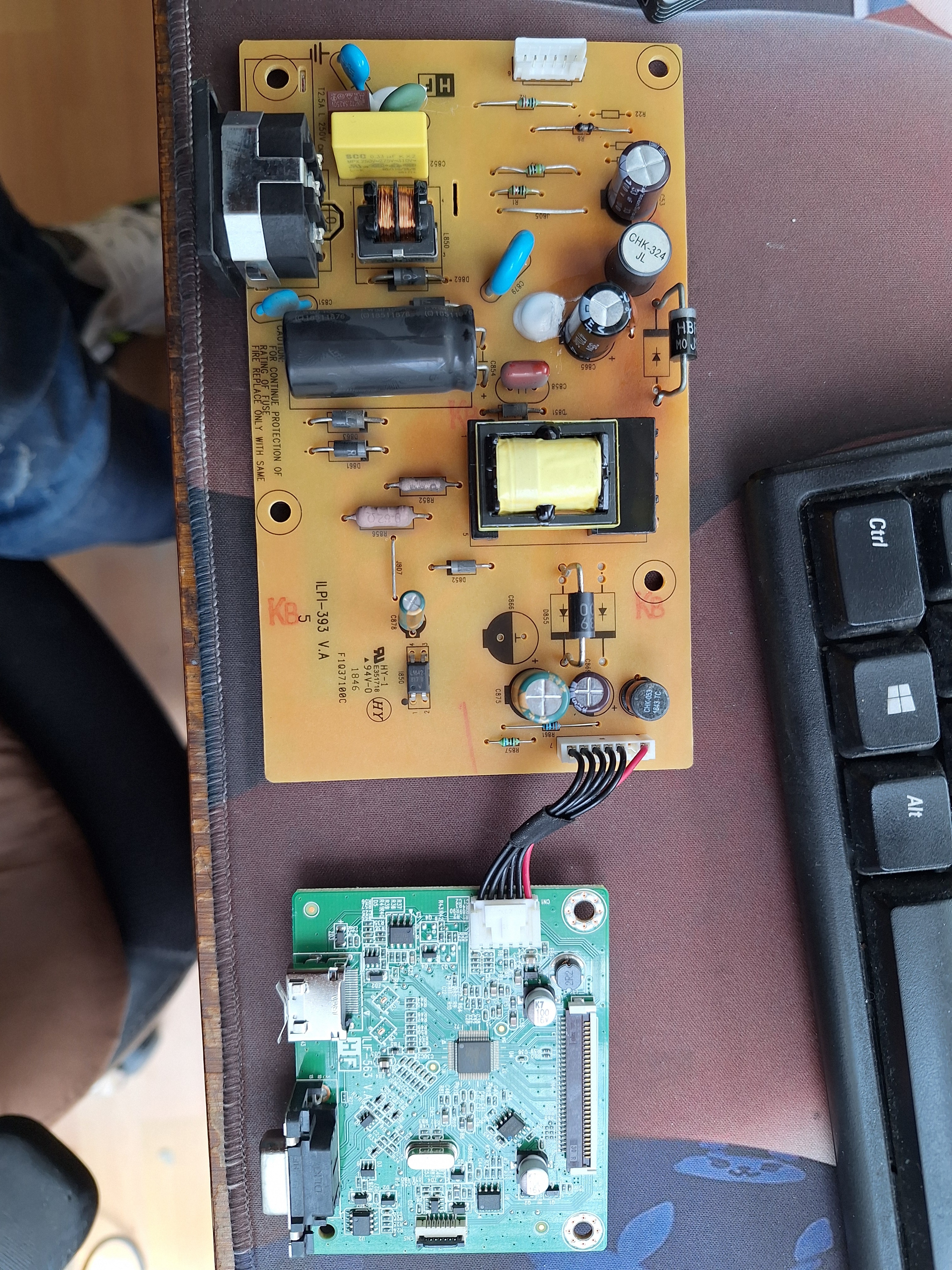

    Hi there!
    The power supply is ILPI-393 V.A
    The main PCB is ILIF-563 V.A
    There was a blow-up capacitor on C865. I chang it, but no luck.
    I see that there is a black resistor on R8, but I don't know the resistance of the resistor to change it.
    Did someone have a schematic for the power supply board or can you give me some help on this resistor?
    On the other side of the resistor is the LED module OZ9998EGN.​

    I just replace all capacitors on power supply board and now everything is ok.
