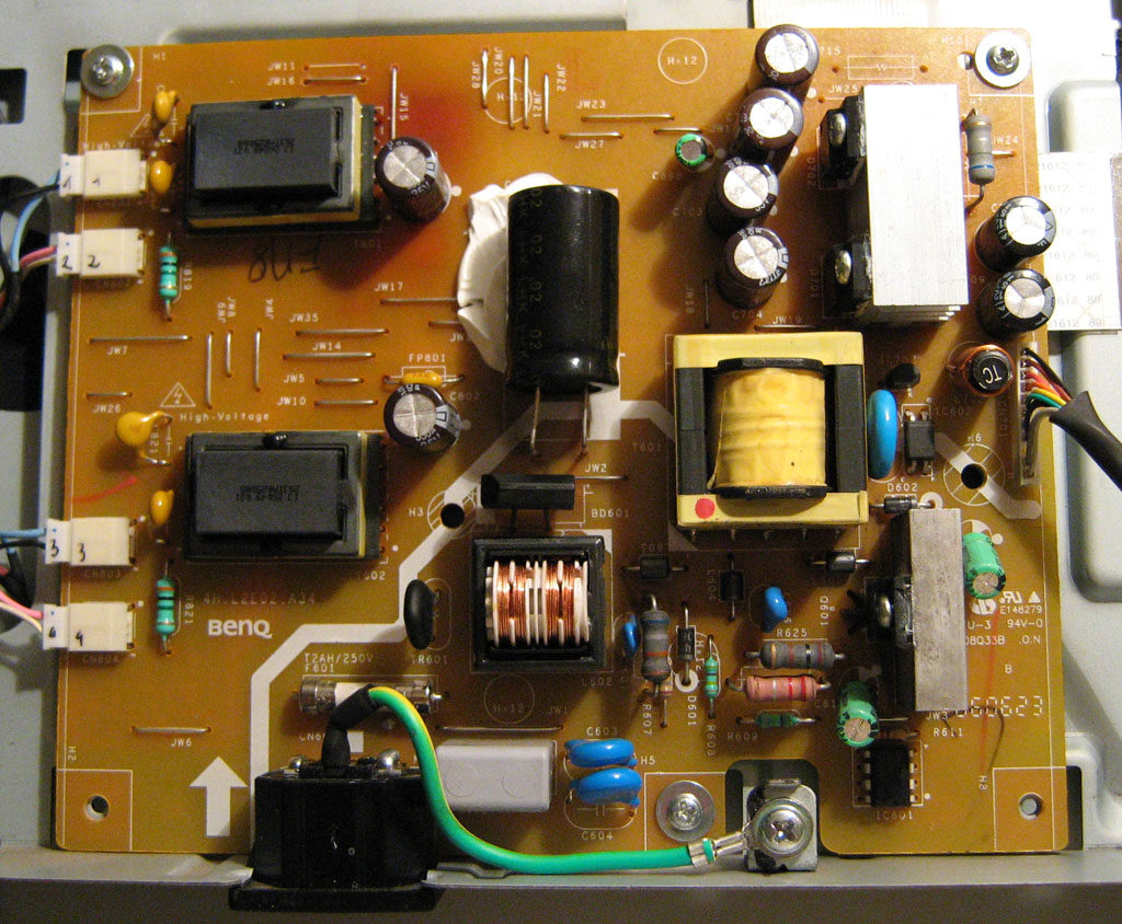

    repairing a benq. This works but make noise like frying and the backlight sometimes flashes to full bright. If the fry increase the screen may become black with power led remaining on and i have to power off and on again. The board is toasted on the point where seats the two LR3410 (expecially the upper one) that drive the only two inverter transformer. Caps checked, transformer's and others joints resoldered.
    I think i should change the LR3410 but i can't find them. Do you know an equivalent?
    Thanks.

    The explanation that pops up in my mind is that the CCFL tube must be defective cracked at one end and the frying sound is actually sparking.
    This would also account for the heating up on the board.
    You need to connect external CCFL (from Panel or spare) to confirm.

      I tore up the screen because there was some dust underneath so I can say that the hiss comes from the power board. After that I found that the leg of one 3kV cap was bend too close to one pin of one ccfl socket causing some little sparks. Well it was not enough so I finally found a reseller for LR3410.
      Today I changed both LR3410 (changed one first but found there was a huge difference in brightness between upper and bottom ccfls) and the hiss was dramaticaly reduced but not totally, and I still had that little blinking of the ccfls.
      Now it seems to work. What i've done is to clean the board removing thoroughly the soldering flux that remained after my previous works. I think that it was literally frying... d'oh!
      EDIT: Nope. It started again.

        Check the wires going to the CCFL bulb(s) for arcing. Also check for shorted high voltage capacitors (those little blue ones).
        Muh-soggy-knee
          Re: Benq FP71G+ frying noise
          In this case, they will be brown/yellow disc caps by the lamp connectors.
          Bad wires:
          http://s807.photobucket.com/user/bud...tml?sort=3&o=9
            Bad wires:
            Whoops yeah that is what I meant ... I'm used to them usually being blue instead xD
              Thank you.
              Because the noise comes from the board I'll try new hv caps.
