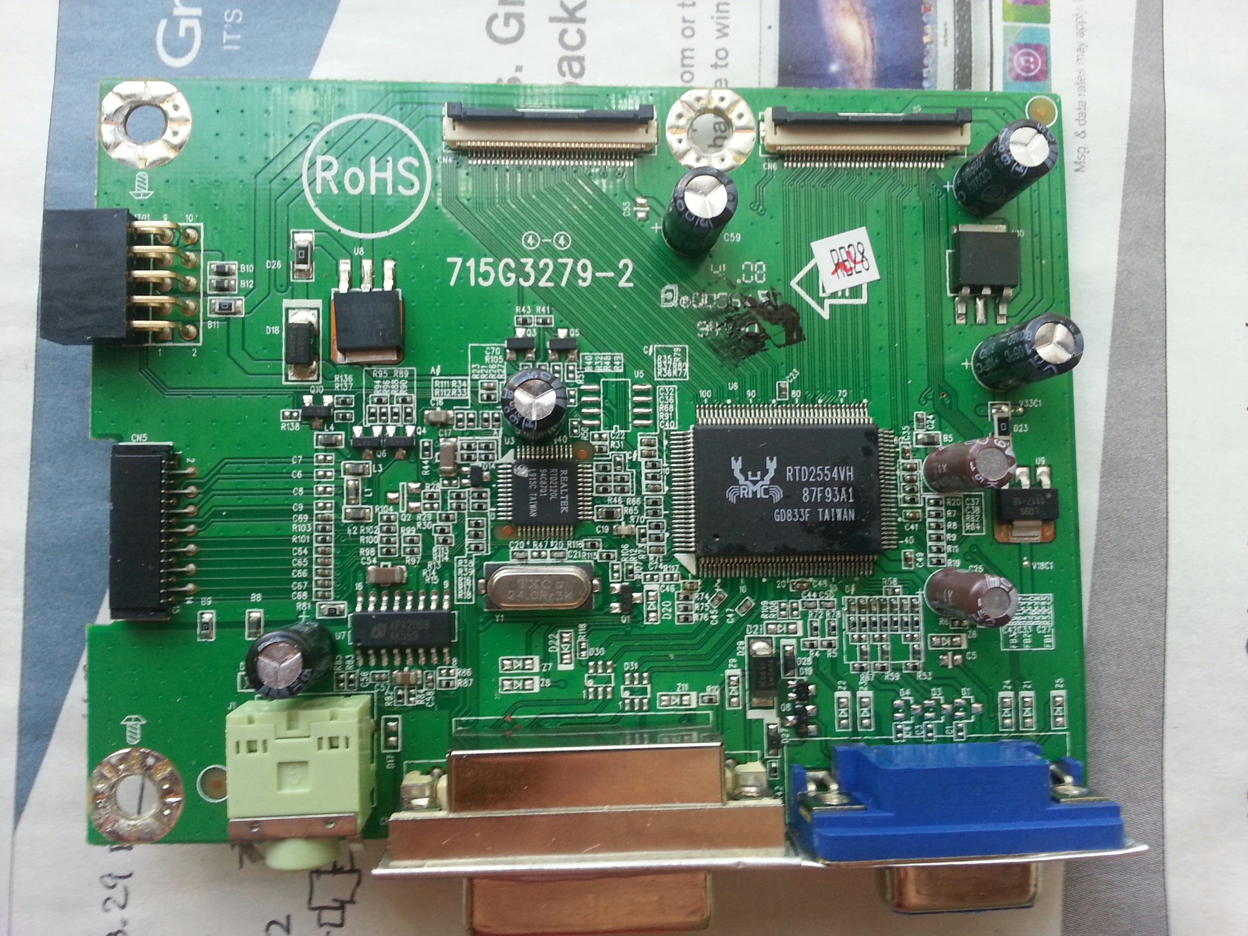

                      I have added a picture of the main logic board. But Im not sure of which component is the voltage regulator.
                      Here is the picture
                      http://sdrv.ms/14NK1J1

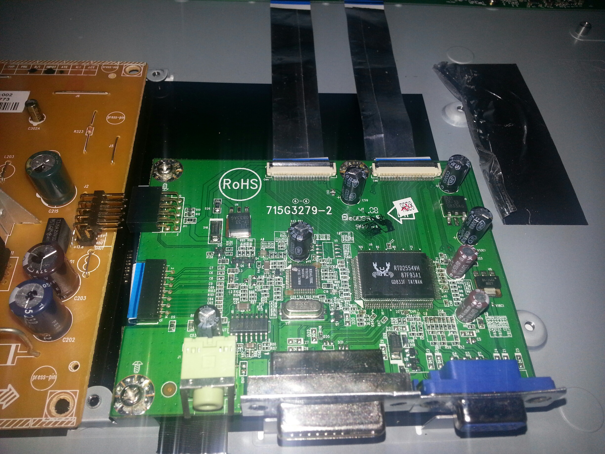

                            This is the mainboard, which one here do you think is the voltage regulator.
                              Re: Viewsonic VG2230wm no power
                              Those that say 17-33 are LD1117 fixed 3.3v regulators. Instead of "LD", it can be anything else, it's a generic voltage regulator.
                              U9 is also a fixed voltage regulator, again a 1117 but a fixed 1.8v voltage regulator this time.
                              Put the multimeter on DC voltage. As you look at the chip with the text the way you can easily read it, the pins are arranged like this: GROUND, OUTPUT, INPUT. On the regulator with only two pins soldered to the board, the one that's in the air (the output) is also connected to the large tab.
                              So between GND and OUTPUT, you should have about 3.3v for the 3.3v ones, 1.8v for the other one. Between ground and input, there should be at least 1-2v above the output voltage... I would guess around 5v for the 3.3v regulators and 3.3v for the 1.8v regulator.

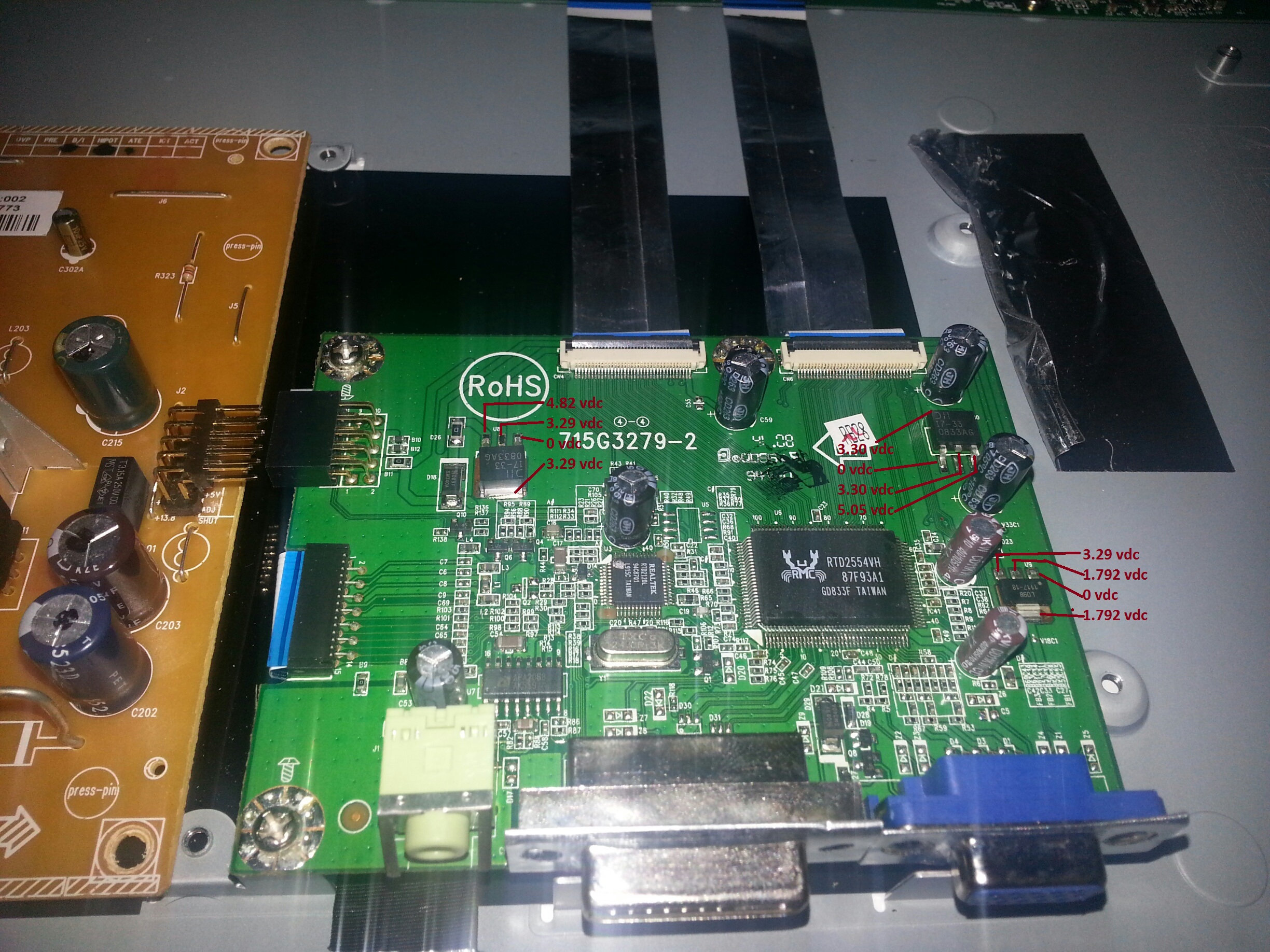

                                Correct!! here is a picture with results by each pin. I did the test with the mainboard connected to the powerboard and the power cable.
                                No idea what should be wrong?

                                  After read the voltage in the regulators in the main board. It is normal that regulator in the left side read 4.82 VDC in the input pin??
                                  Please help don't know what else to do.

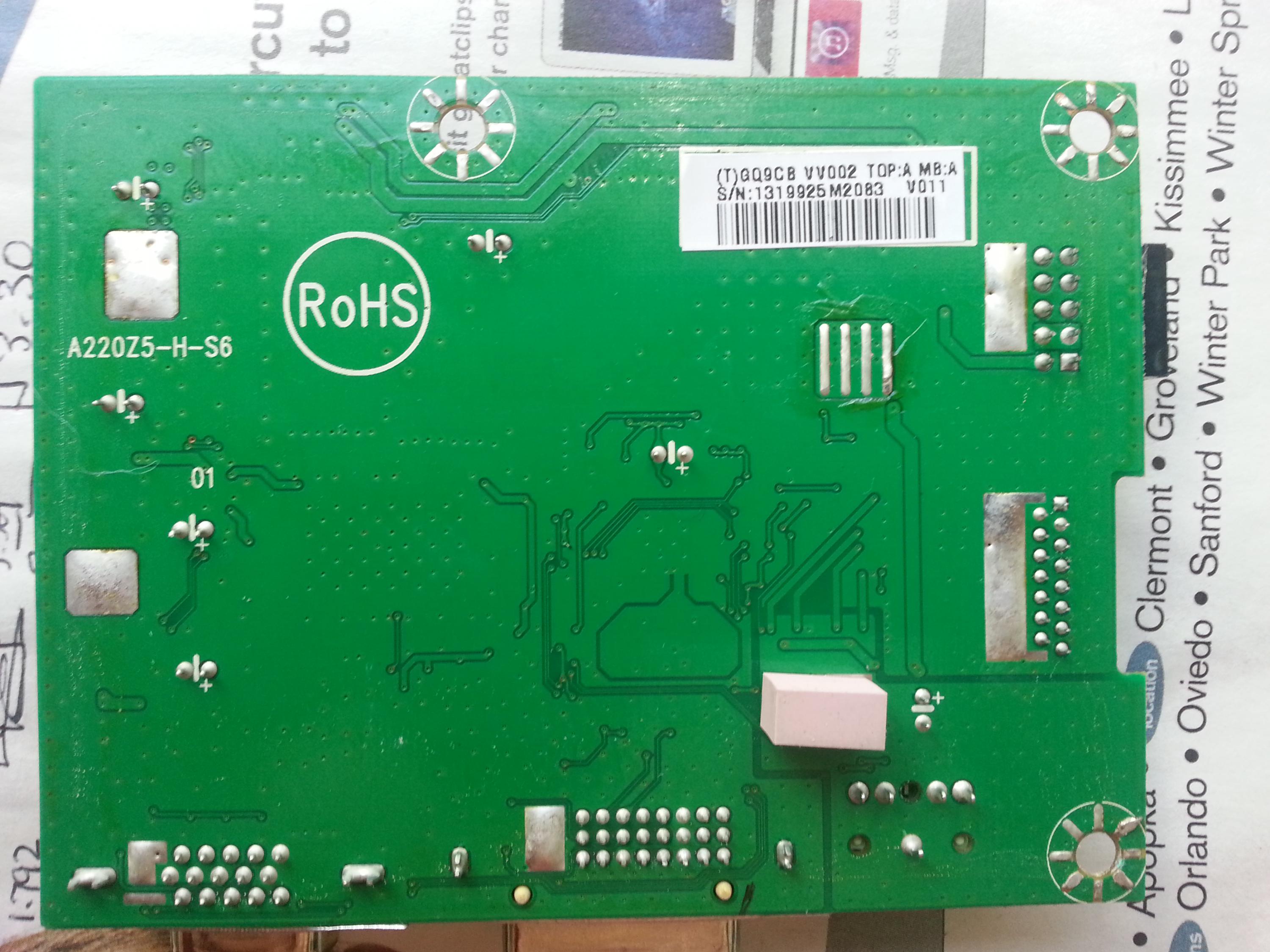

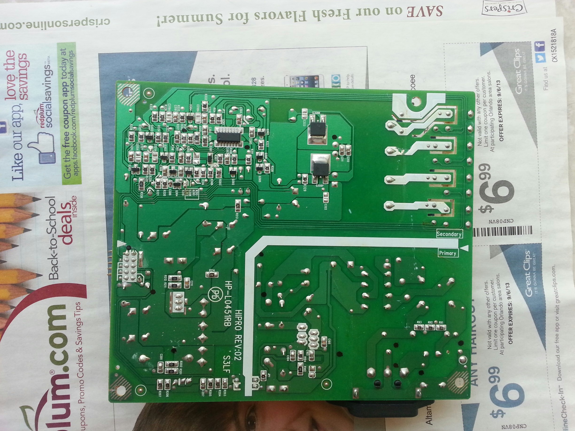

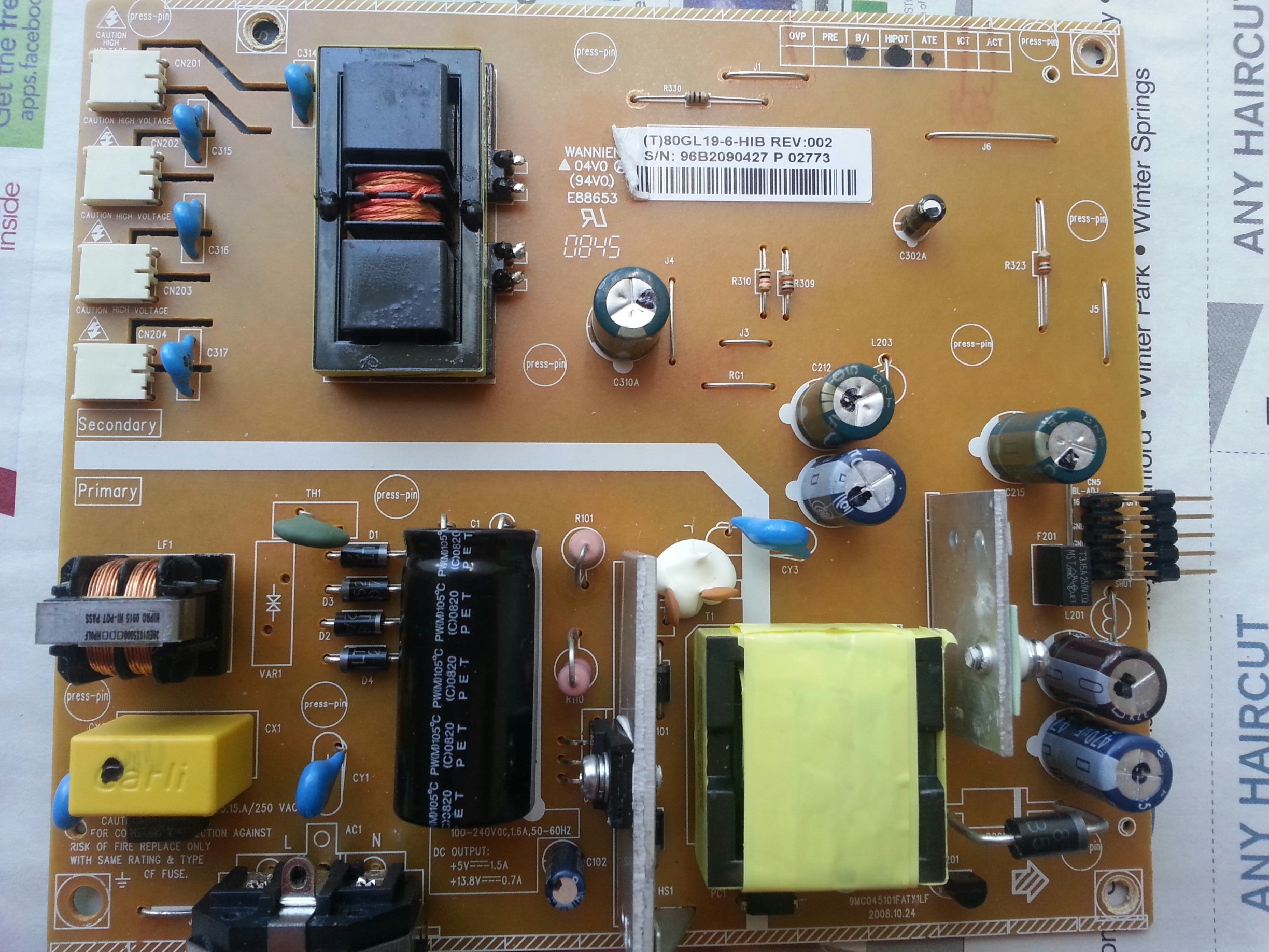

                                    I'm including better top view pictures of both side of the PS board and logic board, in case somebody need to see them.

                                      4.82V is on a low side but the main board IC does not run directly off the 5v power supply but from regulator. At this you will need to locate the service manual for this version of the main board to do more probing.
