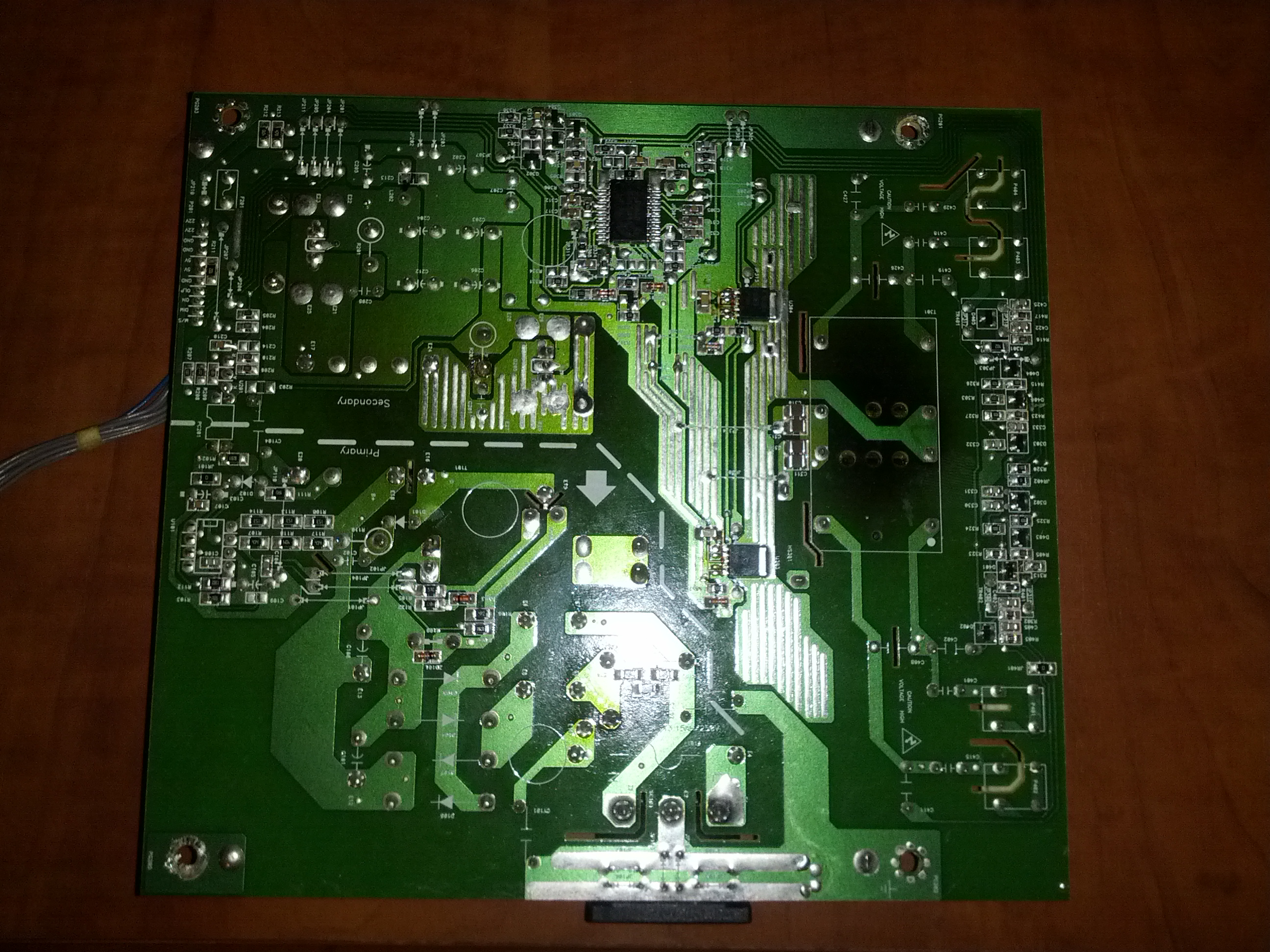

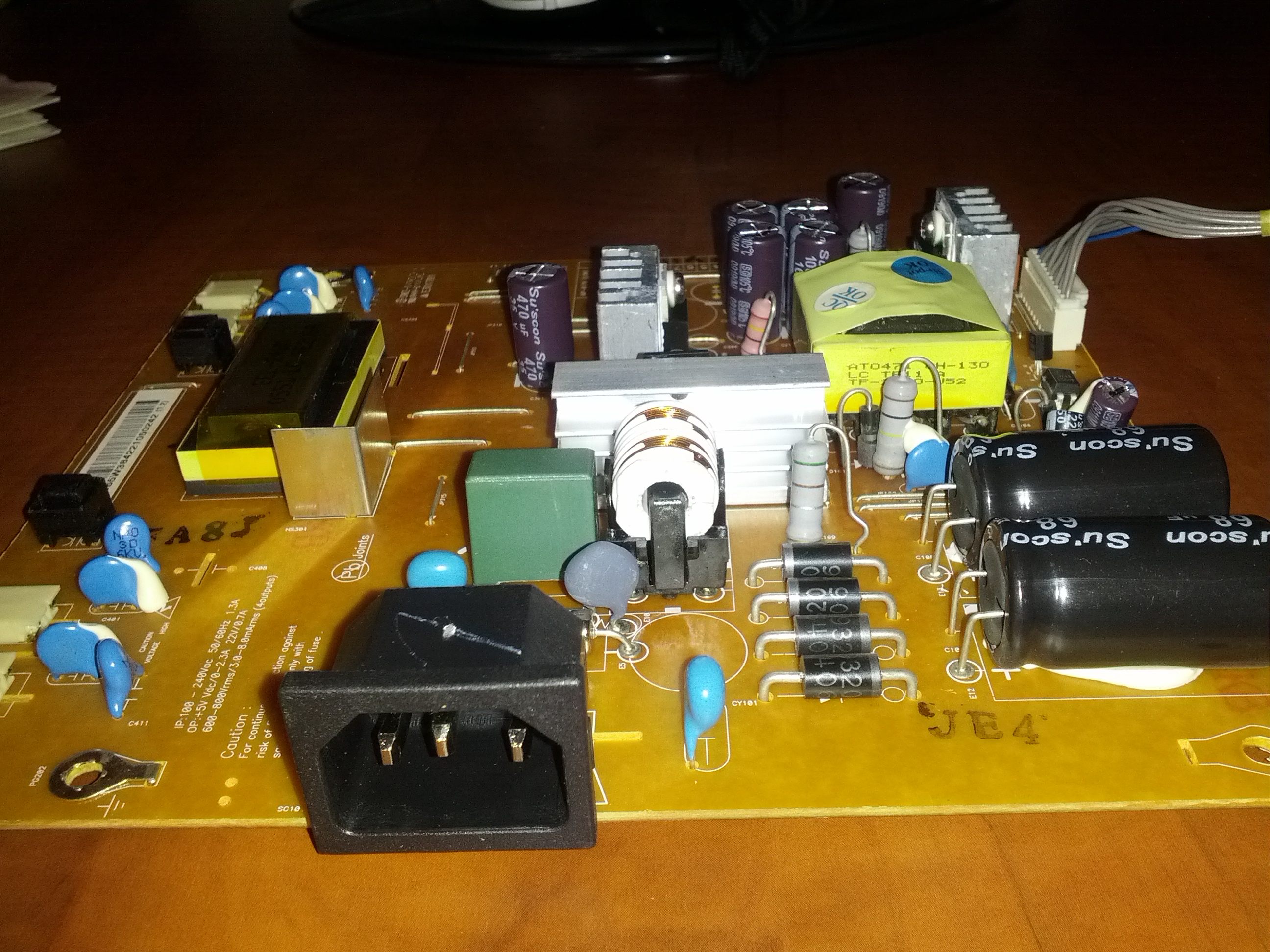

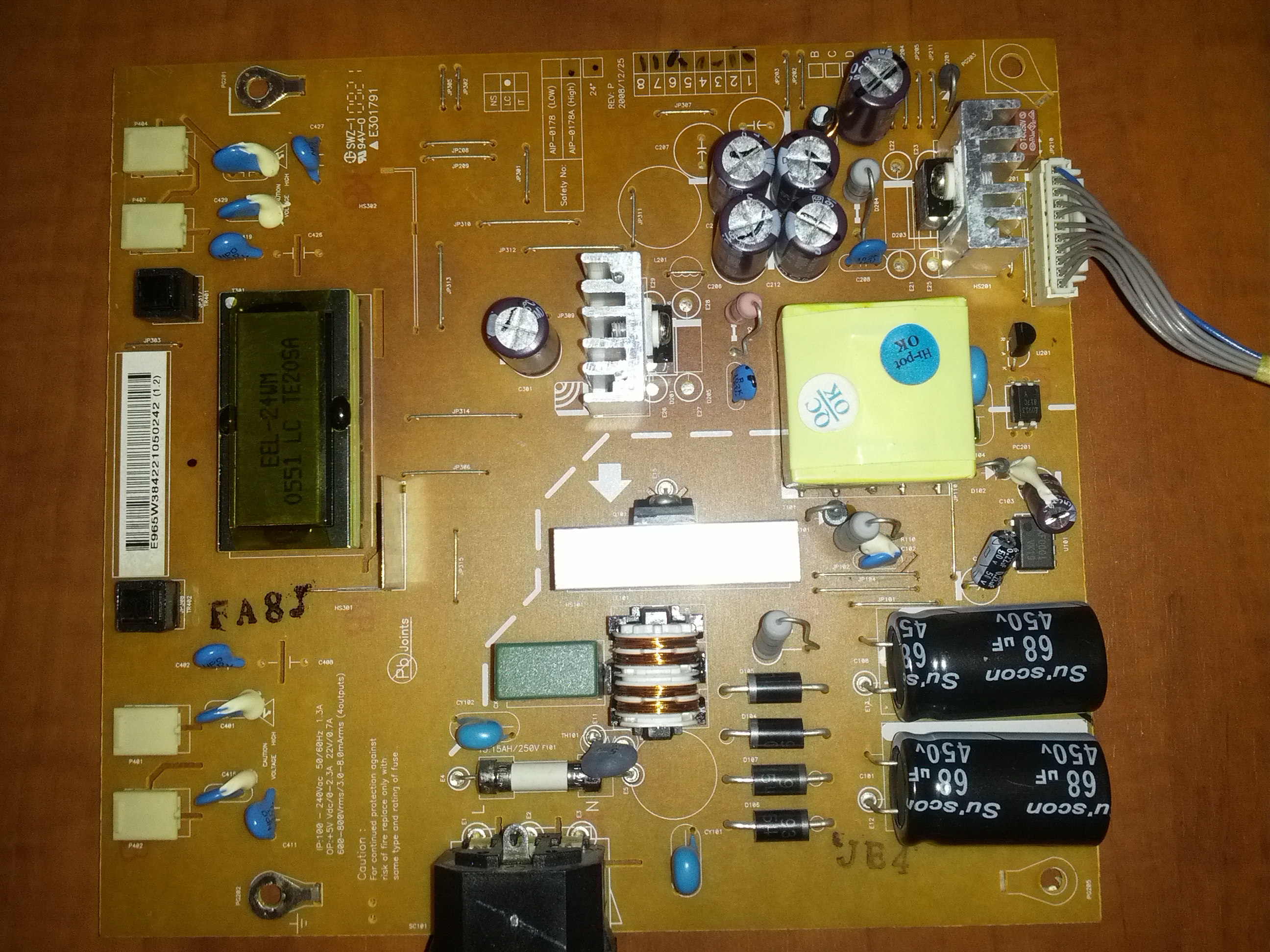

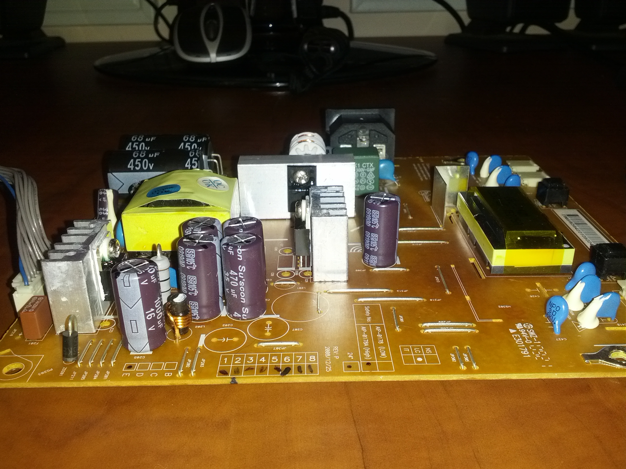

    So i have a problem with an LG W2453V, i connect it, it turns on and shows a picture and after about 2 seconds the picture turns off but the on button light is still on. If i unplug and reconnect, the same will happen again.
    After reading a bit and coming across this place i found out the problem is likely bad caps.
    I took the monitor a part and took some photos of the power board.
    At first glance it looks like the small 33 uF has leaked but is it enough to cause that problem? The other caps look alright, no leak, no weird shape.
    Now, after a while of looking at it i noticed that there is also some white stuff below the big 68v caps, is that normal? I read that they rarely break.
    Another possible problem that i found, if you look at the back photo i took, the back side of one of the big pieces (i think it's inverter?) is really black, kinda like it was burned, also has some burned smell to it. I assume it's not normal, not sure though.
    I looked on ebay and a kit for the normal caps i need goes for $10 but i also found used from china some complete power supply board for $22. Might be more cost effective to get the whole board if indeed it's more than the normal caps, only problem though, the caps it will come with are the same standard ones it came with and plus shipping is probably 2-3 weeks.
    One small note i was wondering about, the board has lots of small blue things to it which kinda look like M&M, about half of them look like they leaked the white stuff. I've seen some photos of the same board before and they all have that white stuff leaking from them, is that normal? I guess so, but why?
    Any ideas?

    If the 33UF cap is leaking then you will need to change it.The 'white stuff' under the big caps and on the 'blue M&Ms' (which are caps as well)...is Glue and unless it has gone yellow,and can become conductive in that state, it should not be a problem.The Black part is under the Inverter transformer,and at each end of it are two pins.You need to measure the Resistance between each set of two pins and advise.....they should be within 3-5% of each other.

      As I learned from my Viewsonic, if you change the caps and it still isn't staying on, check the CCFL's. You might want to read the 2 seconds to black sticky for more info.
        Re: LG W2453V Picture Dies After 2 Seconds
        The inverter transformer looks like it runs hot, you can see the PCB underneath the transformer is blackened, so check the resistance readings of the HV sides as suggested by RTECH.

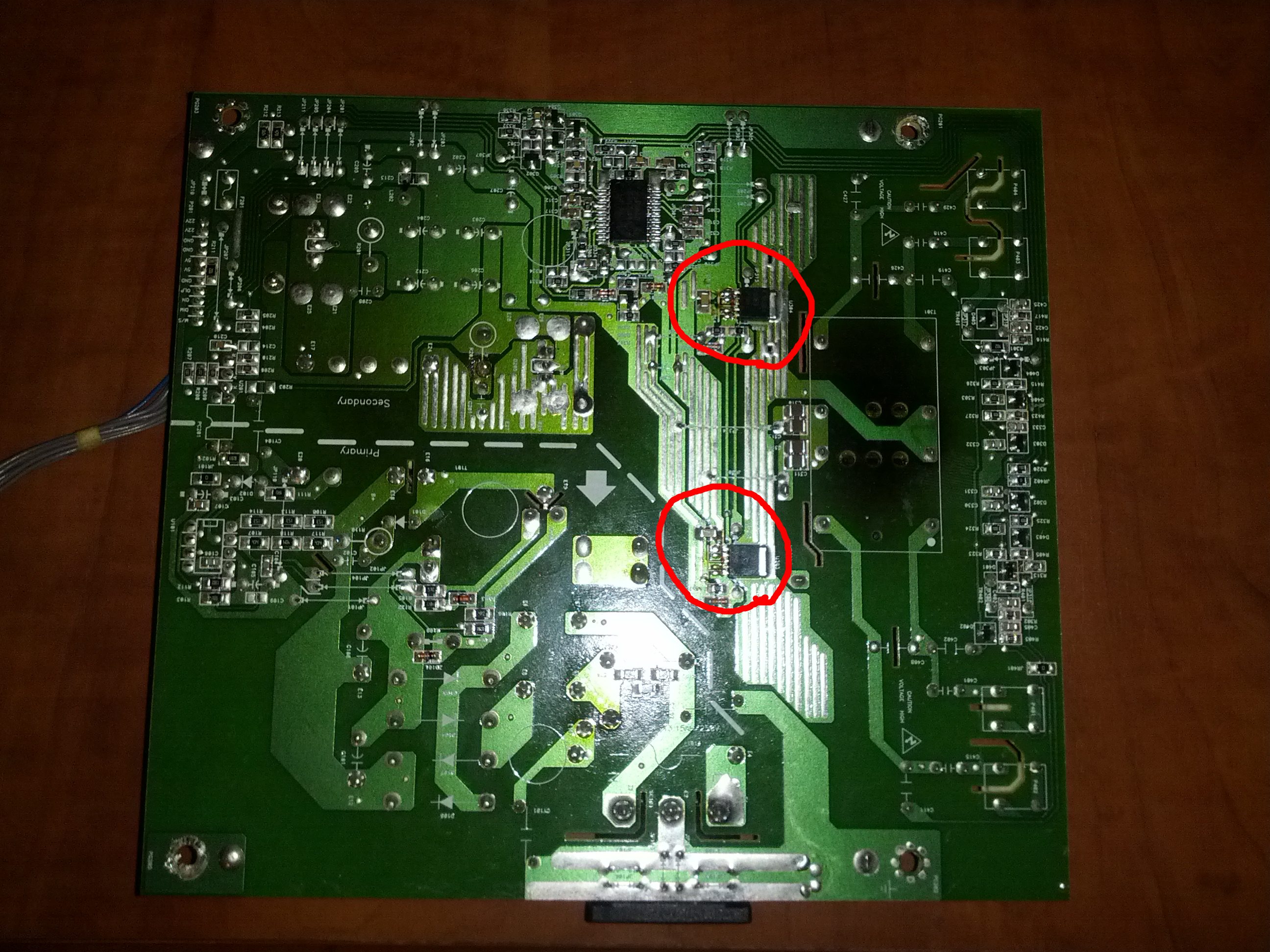

                  Yes the lamps may be the problem. There are two dual MOSFETs (the SMD devices with 4 pins and big tab on top) that drive the high voltage transformer, P/N? We need to check them too. You can also make two test lamps using old CFL.

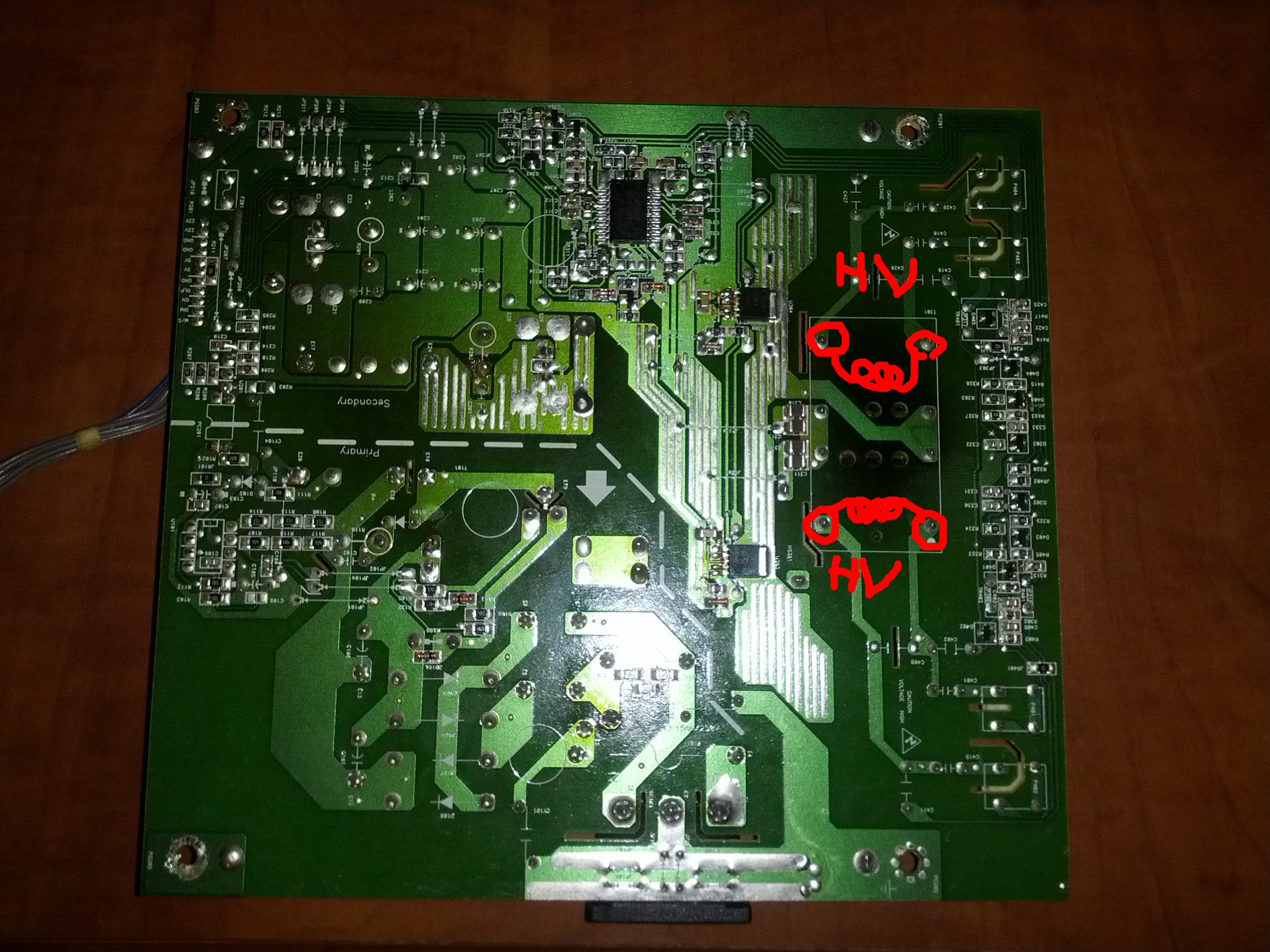

                      See the picture, you can have board problem or lamp problem.
                      Bad lamps:
                        Also, there are a total of 8 ceramic caps near both lamp connectors. These "ballast" caps, by virtue of their capacitive reactance, limit the current to the lamps.
                        Sometimes, they start to break down. Only under full operating voltage, this can cause excessive lamp current, leading to the lamp OCP ckt operating and killing the backlights.
                        It's important to use good caps here, they handle quite a bit of reactive power, despite the lamps only being a few watts apiece.
                        Since they tend to act up only at full voltage, it's pointless to check them w/ a meter. Just replace with equal value and higher voltage. Same type- NP0.
