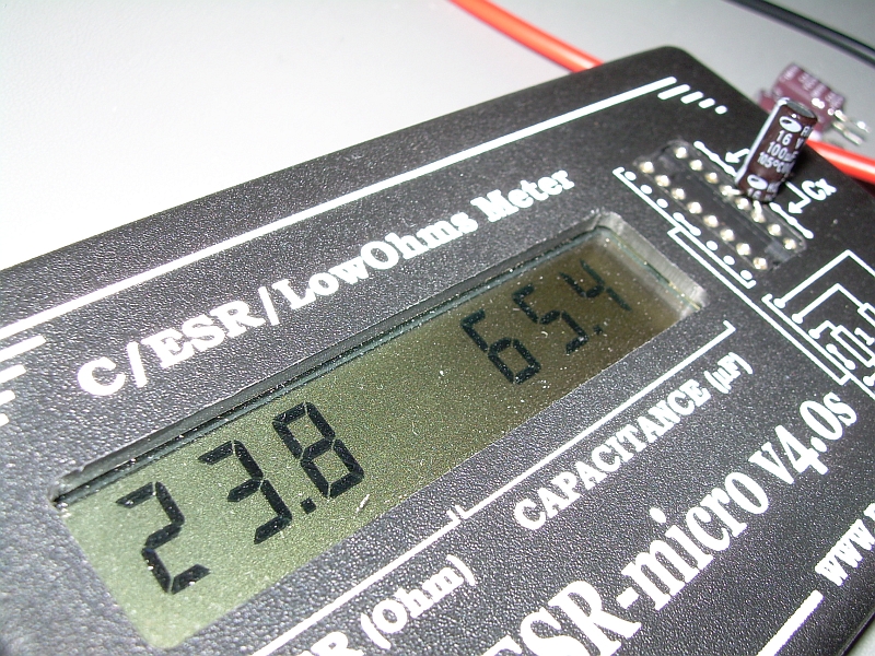

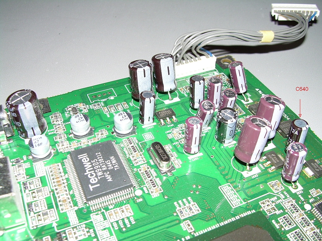

    Found this at the dump, took it home since there are a lot of posts on this monitor.
    Monitor had stripes over screen, removed all caps to measure them and found that not only c635 and c637 fails on these.
    C640 is right next to c635&c637, it measured a hefty 23.8ohms.
    Replaced it and monitor is working as it should.
