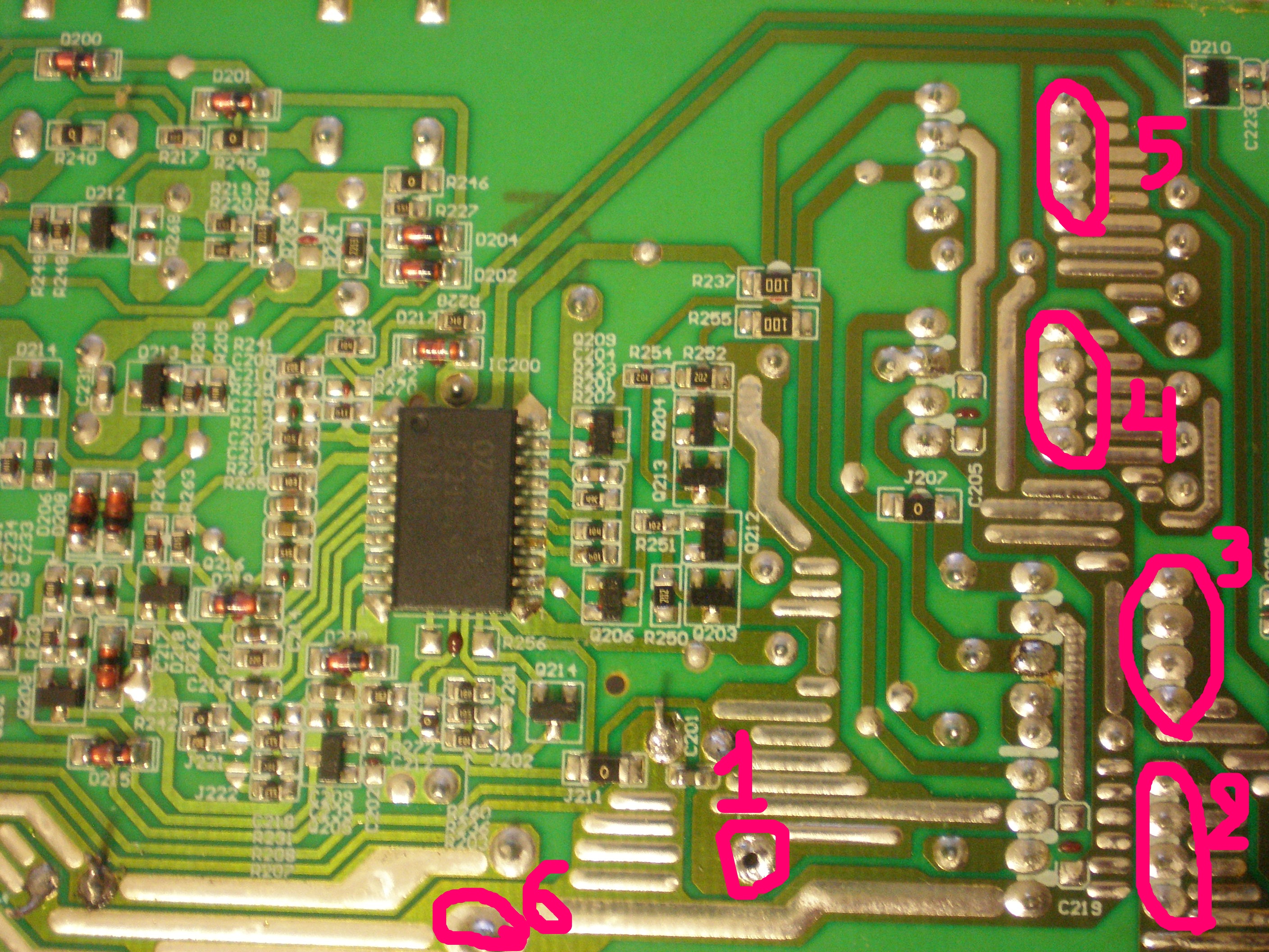

    OK, that means the problem is in the inverter circuit that we isolate by lifitng the fuse. More likely to have the shorted out MOSFET which is very common problem as the other had suggested.
    So you need to take good resistance reading again using the pin out of the MOSFET spec and my drawing as the guide.

      Re: WestingHouse 19" 19w4 LCD monitor- DAC-12M030
      Here are the resistance test points
      Meter probe on 1 (color does not matter), then check the reading between
      1 and 2 = ???
      1 and 3 =???
      1 and 4 = ???
      1 and 5 = ???
      Meter probe on 6 (color does not matter), then check the reading between
      6 and 2 = ???
      6 and 3 = ???
      6 and 4 = ???
      6 and 5 = ???
      Make sure to tell us if it shows as Ohm, K Ohm, M Ohm.

        Okay, so the number 2-5, you want me to test each pin on said numbers right? For example, 1 and 2, Black will be on 1 and then I'll test each pin on 2 (which is 4) with red, correct?
        ^ That above is assuming you want me to follow the picture you've attached.
        Also, my meter only reads in OHM... :/

          Black probe on 1 and red probe on for example the one I mark as #2 will be any one of those 4 pins since all those 4 pins in the circle are connected together. As you can see, the 4 pins on the right side of the MOSFETs are tied together.

              Okay, here are my readings. Using the same meter I've posted and using the green numbers on the meter.
              The setting were set to x1K ohms
              1 and 2 = 15
              1 and 3 =15
              1 and 4 = 6
              1 and 5 = 6
              6 and 2 = 2.5
              6 and 3 = 2.5
              6 and 4 = .6
              6 and 5 = .6
                #47
                They do look bad, but I forget to tell you to use x100 Ohms scale for checking, sorry about that. Can you test it again? Also try reversing the leads of the meter so you will report 4 set of readings.

                  Okay, the setting is set to x100 Ohms.
                  Meter probe on 1 (Black), then check the reading between
                  1 and 2 = 45
                  1 and 3 =48
                  1 and 4 = 26
                  1 and 5 = 26
                  Meter probe on 6 (Black), then check the reading between
                  6 and 2 = 2.8
                  6 and 3 = 2.8
                  6 and 4 = .6 *No Change
                  6 and 5 = .6 *No Change
                  Meter probe on 1 (Red), then check the reading between
                  1 and 2 = 2.9
                  1 and 3 =2.9
                  1 and 4 = 2.79
                  1 and 5 = 2.79
                  Meter probe on 6 (Red), then check the reading between
                  6 and 2 = 45
                  6 and 3 = 45
                    #49
                    Not sure how you read the scale to be the same as 1K range to get 0.6 on x100 scale, the 0.6 = 60 Ohms, 2.8 = 28 Ohms.
                    At this points I would suggest to replace ALL 4 MOSFETs.
