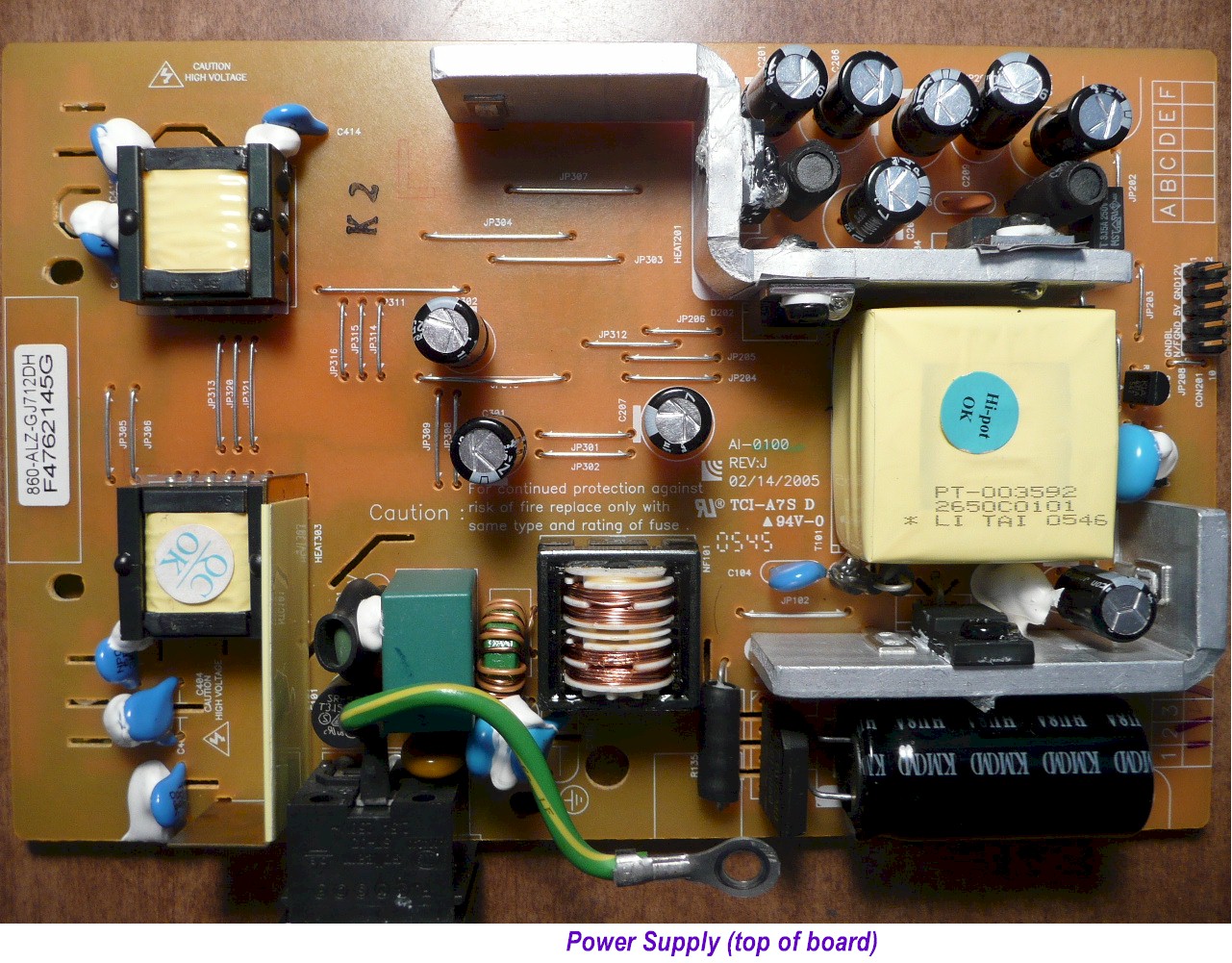

    At first, the monitor did not come on at all so I Replaced 10 caps on the power supply board (all but 100mf 450v). Now the blue power light comes on but the LCD screen is all white. I read on some of the various badcap threads that this may be due to a blown fuse on the t-cont board. Where is this board located? The shielded metal box on the back of the LCD panel just has two boards - the power supply and a logic board that the vga cable from the PC plugs into. Do I have to take the back off of the LCD panel to get to the t-con board?

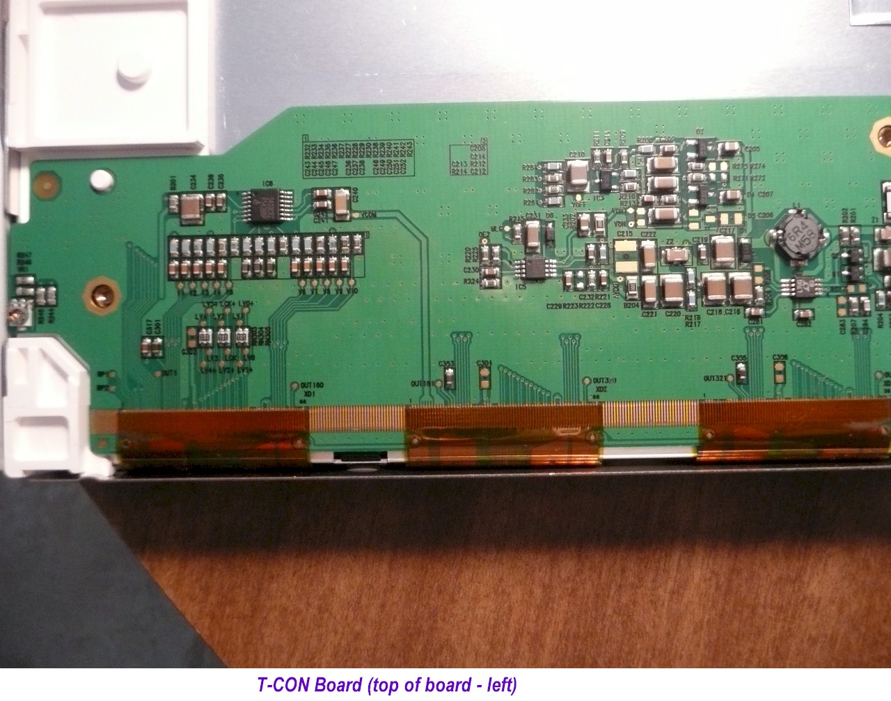

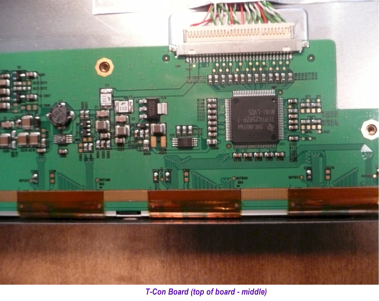

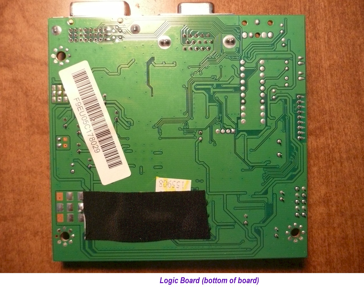

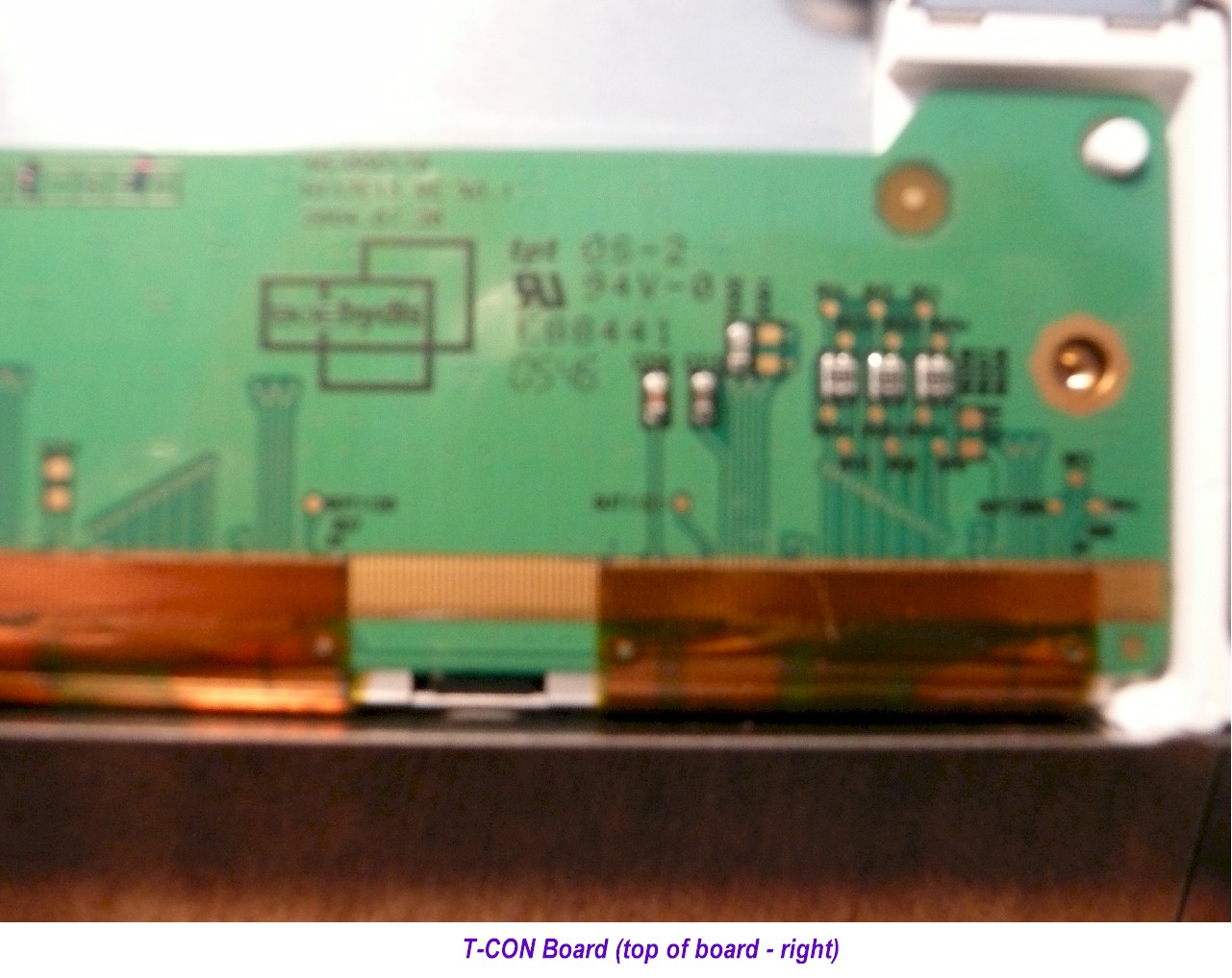

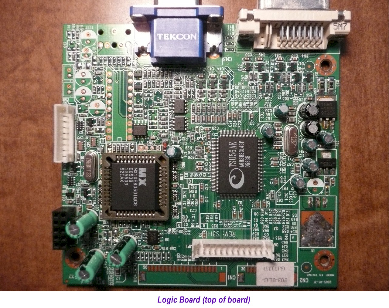

                      I am attaching pictures of the 3 boards in my Gateway FPD1760 LCD monitor.
                        Re: Gateway FPD1760 LCD Monitor
                        There's also another 3-pin voltage regulator above the first one you checked. It's marked 1084-18PE. You should read 1.8v at the output.

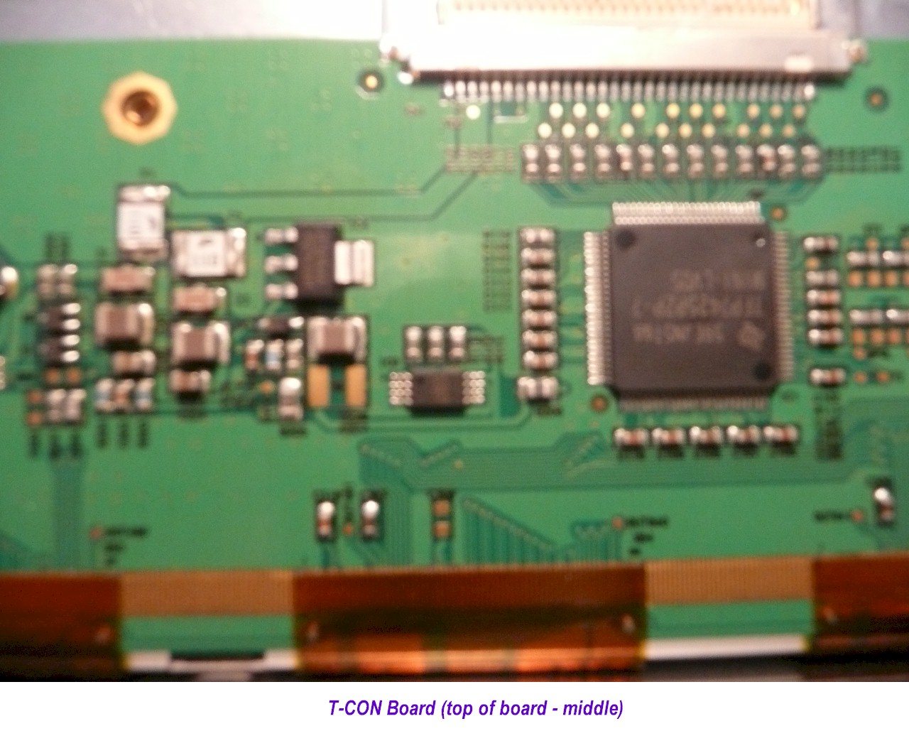

                                    You can see the switching power supply done by the round black surface mounted inductor in pic #5 post 11. Can you see any test point pads with voltage labeling next to them?
                                      I am including a better focused picture of the center section of my T-CON board so you can see the area around the surface mounted inductor you referred to. I don't see the test point pads with voltage labels but maybe you can since you know what to look for. Also, do you know if there are any service manuals available for this monitor on the Internet? Or, if it was made by Samsung for Gateway, is there an equivalent Samsung model that may have a schematic on the Internet? Thanks.
                                        Looks like an obselete TI Tcon I.C there. And from the picture, there seems to be a stepdown DC-to-DC converter or regulator there as well, possibly for Tcon I.C? Some Tcon I.Cs from TI have internal pattern generator for panel self test. Don't have the datasheet for the I.C in your image, but do check any voltage going to that I.C (possibly around 1.8V to 3.3V)...
