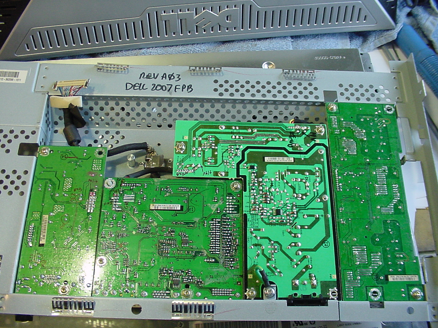

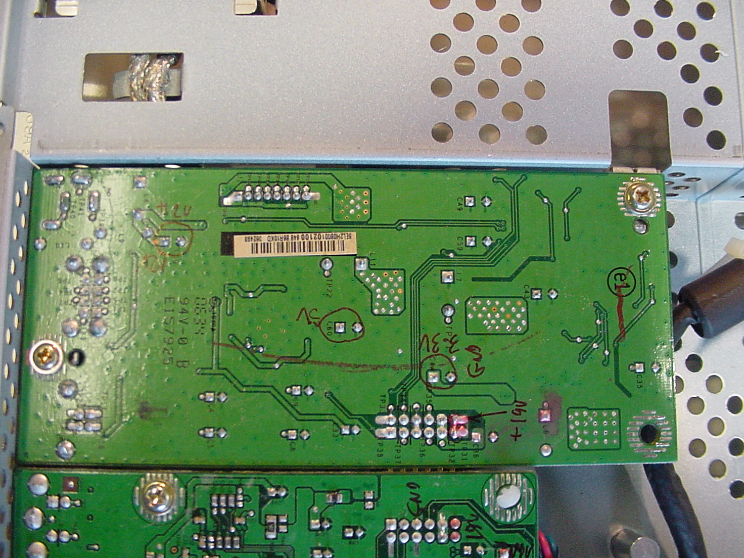

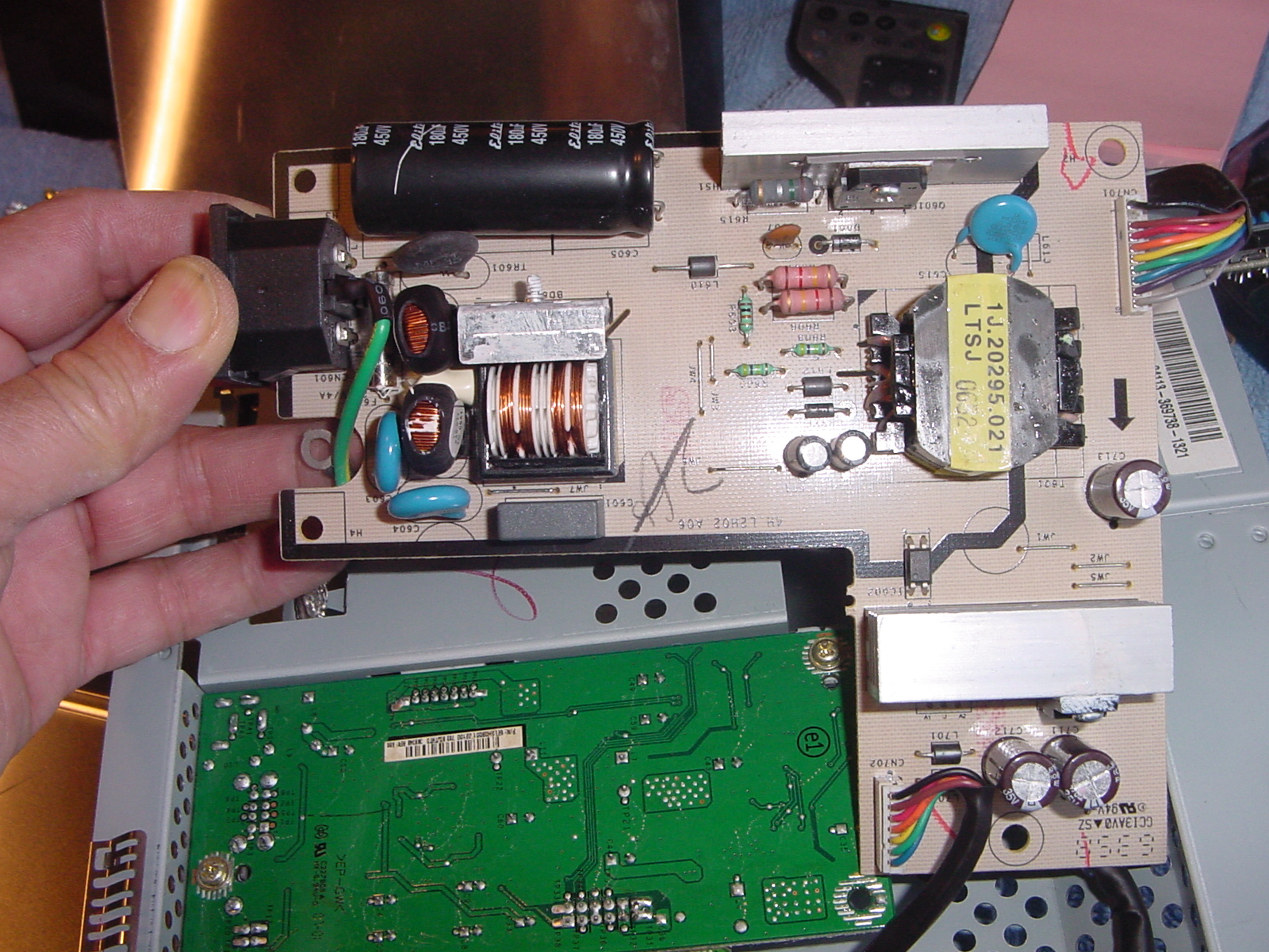

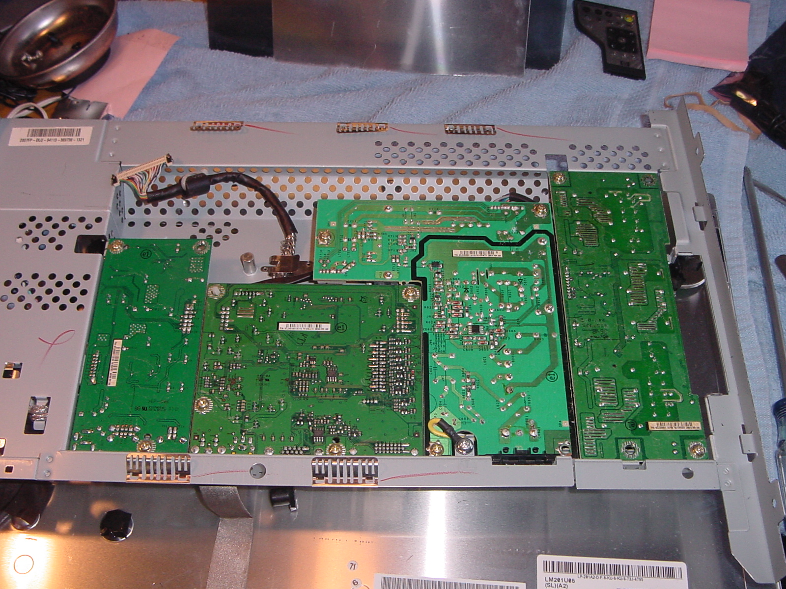

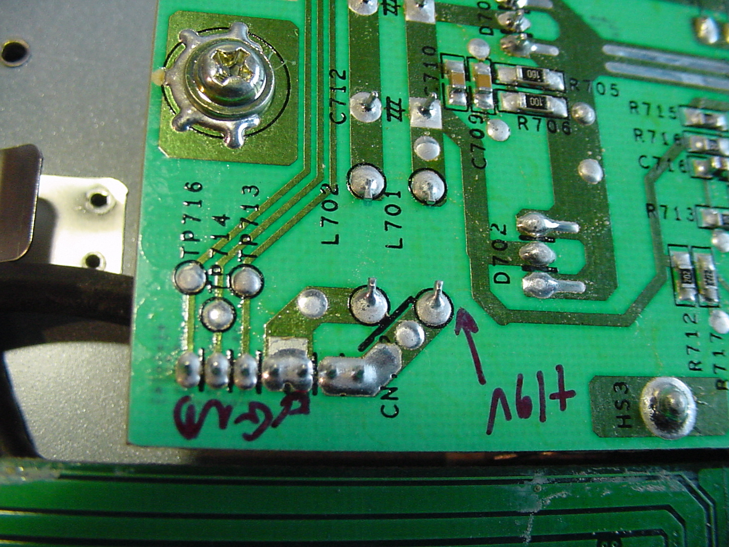

      There are 2 test points at the bottom side of the board, TP711 (+), and TP712 (-).
      just put your DC meter probes on those two points. Just do not touch anything in the hot side of the board (heat sink, traces, etc.)
      budm,
      I have posted in another thread regarding the inverter board that may have been lost due to a short on my FPb. I'm looking at keeping the screen/case and power/supply for parts. I have replaced all the caps on the PS including the large one. I'm wanting to make sure that the PS is working correctly. It appears to be. I have tested TP712 and TP711 like you have shown. Do I also need to test near CN702. If so what pins? Your above diagram was very helpful but I have not found one for the backside of CN702.
      Very noob here.
      TP712 & TP711 = 19.12 volts
      The very large capacitor = 167.2 volts
      Thanks.
        #43
        Re: Dell 2007FPb - No power at all
        You do have correct voltage output of the main power supply board. You will need to check and see if the 3.3v, 5v, 12v is working or not (you do not need to have the inverter board connected).

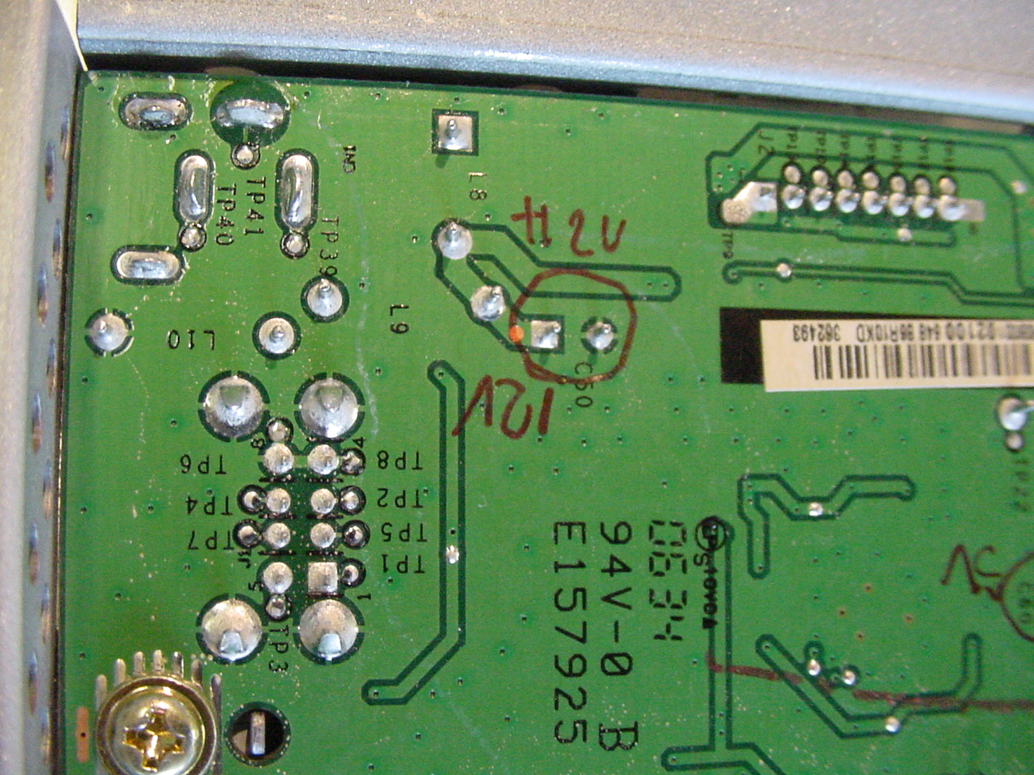

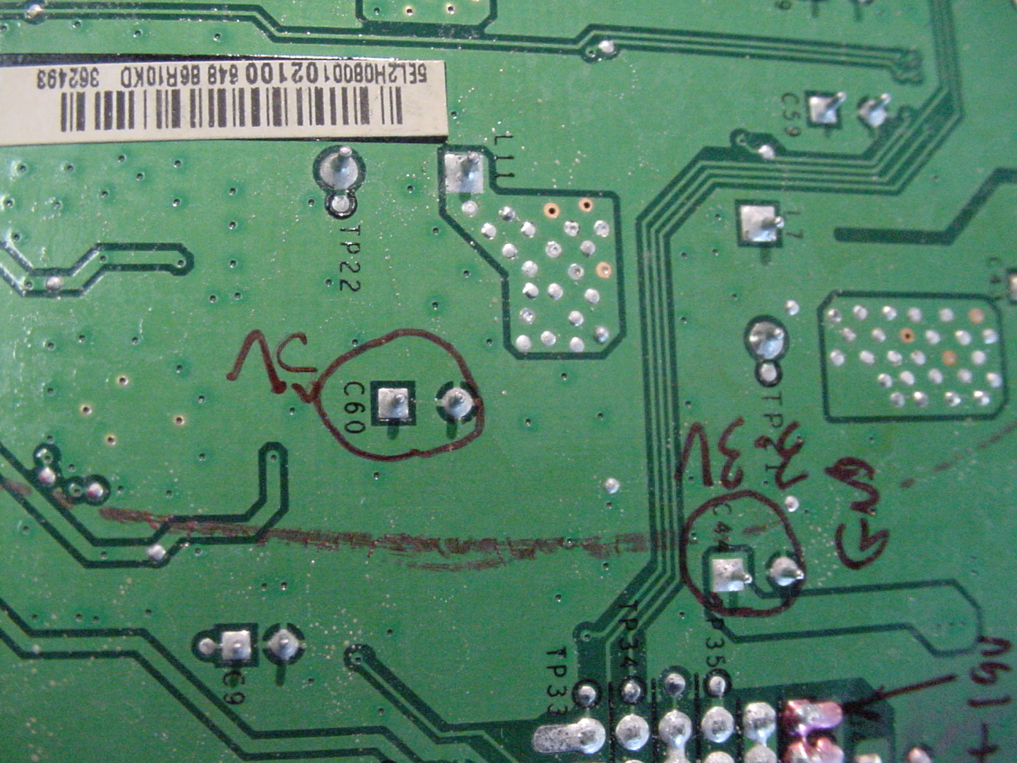

          Here are the results.
          12v = 0
          5v = 5.18v
          3.3v = 3.37
          19v = 19.11v on the main pc board
          I was not sure what the photo meant for the 19v on the USB/Soundstick. Do you mean going to the ground/from the main power plug? I see the one point to connect the meter to. I dont want to short anything.

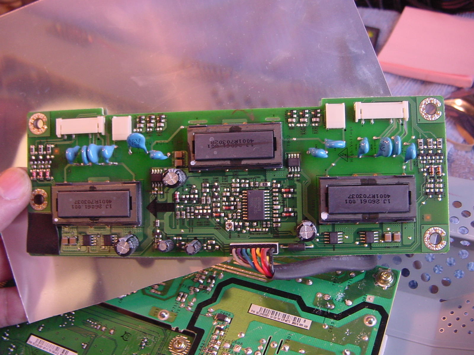

          I forgot to add that when I got another (working) monitor this weekend I took out the inverter and used it in the non-working one. The non-working monitor powered up. I could access the menus change color setting etc. When I used a DVD with s-video the picture was what I would call digital colored lines going across the screen that changed with what was probably playing on the DVD. Unfortunately I did not get a picture and don't know if it is the DVD or the monitor that was causing the lines.

            As long as you get the 19V, the main power supply is working, you are also getting the 3.3 and the 5v. Not sure about the 12v, but this 12v is used for the DC output jack for the Dell external sound bar powered speakers.

                  Yep, I'm really just hoping to save the screen, case and power supply. The inverter board is toast. It burnt right through the traces. I'm guessing that this got hit with a pretty good power surge.

                      Glad to see there has been some activity here, I got side tracked with other issues. I have not made any progress, but picking up from post #43 above, I get
                      19v = 19v
                      12v = 0v
                      5v = 0v
                      3.3v=0v
                      Any new thoughts?

                          Your main USB board is not working properly, you likely have one of a few problems there:
                          Blown fuse (there is one big fuse on it, white ceramic with gold ends labelled 3A)
                          Bad diodes (FD7, FD8, etc.)
                          Bad resistors feeding the switch mode power supply controller (probably the ones entombed in silicone near the top of the board)
                          This board turns 19V into 3.3/5/12V for the rest of the monitor. To have the power buttons work you need the 3.3V to be on, and for the panel to work you need the 12V supply. As far as I can tell the 5V is just for USB stuff and won't affect the monitor (I'm running a pair of 2007wfpb monitors with no 5V right now)
                          These things have been covered in the other dell 2007 threads on this forum - I think they have been linked in here already but I might be confusing this thread with another

                              See post 2: pictures of the diagram
                              https://www.badcaps.net/forum/showth...highlight=2007
                                #55
                                Thanks, have seen those pics/diagrams before, just not sure what to do.
                                I followed budm's link to photobucket pics for the 2007FPb pics and tried to measure the violated written on the circuit board. As for the diagram two if those points correlate to the labels written on the circuit board (C44 and C60), but I cannot find a C58.
                                Putting multimeter to the fuse, I get 0 ohms. I assume that means it is okay.
