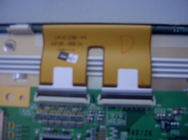

              Re: Dell 2000FP Vertical greenish lines on screen
              If you have pixel sized lines on the screen, the damage is between the glass and the driver, really small pressure connections,from factory.
              These are so delicate that the slightest tug and they are done and any moisture will also create the lines. I don't know of a repair technique for these?

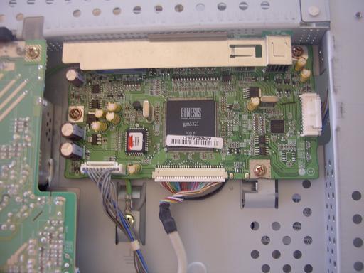

                These are the orange ribbons that kc8 was telling you to reseat, yours will probably be different but you get the idea.
                These lead down under to the actual display and those connections are the ones I say I cannot repair. I'm not going that deep on this because the screen is badly scratched, otherwise I would have repaired this.
                The other picture is the problem with this monitor and I believe it's common.
                The logic board is hot and failed, I found the board for $49 but remember the screen scratches.

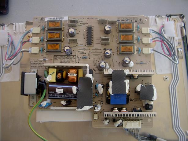

                I post the third power supply w/six tube ccfl inverter in case anyone needs this. Since the machine is parted out I'm offering this up, all the voltages are there and those are capxon caps.
                I disassembled it just now again and wanted to mention the front bezel has to come off, buttons removed and then the rear frame and back cover just comes away.
