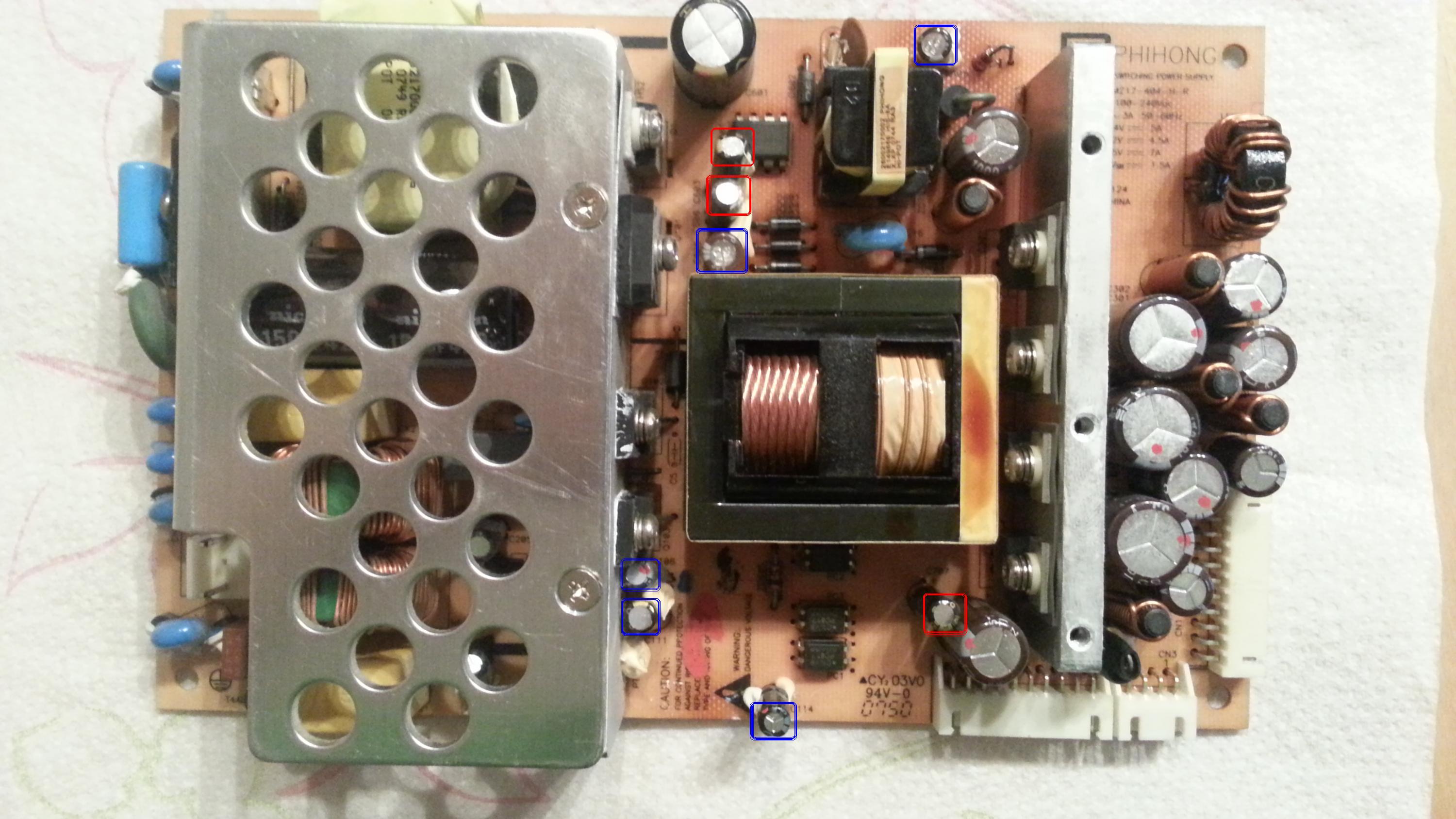

    I just wanted to let you folks know that I successfully repaired my Viewsonic vx2835wm monitor.
    The original thread with photos is here (https://www.badcaps.net/forum/showthread.php?t=23342) for those that may come across this thread in the future.
    I couldn't get my head round how to do the actual board testing and I didn't want to blow myself up so I ended up just going for a recap session. I recapped the ones as highlighted in the pictures by Lumberjack777 In the original thread reply (https://www.badcaps.net/forum/showthread.php?t=23342) on the power board and from the main board I replaced C124, C126, C176, C198 as they were all bulging.
    I did have one issue which was I lifted some of the solder pads on the power board. I blame this on too hot an iron (60 watt) and my own technique (held it there for too long) I switched from my 60W chisel tip to my 40w pointed tip and had no further problems. So perhaps for the ham fisted solder holder beginners you should look at the lowest wattage iron that will do the job.
    I ended up finding some guides on how to glue down the pads again but unfortunately one of the pads did brake just along into the trace.
    More trawling of the internet and I found a guide which basically involved finding the thinnest piece of plain wire you could get your hands on and wrapping it around the leg of the cap after it had come through the hole and solder it for good measure so it doesn't move. I had already cleaned what trace was left with a sharp detailing/hobby knife and tinned it as best I could with some solder. I then lined up the wire which was attached to the cap (again I had already lined it up prior to this and pre-tinned the area to be attached to the trace) along with my tinned trace and applied very quick heat to melt both solders and provide suitable connection for the cap. It definitely wasn't pretty but I held well and the connection was made.
    Result? Well all has been running well for about 6 weeks now picture looks really clear and crisp, no smoke, blue lights or bangs !
    I just wanted to thank all those who chimed in with some advice. I would never had imagined I could have fixed this when it first went south but there you go we do surprise ourselves at times.

        I am from New York City and currently in the south east. I have had the same problem with my beloved VX2835wm for the past year (blue power lights, then orange lights, and finally to no lights/ power at all). I want to revive this monitor to it's former glory as you guys have done easily. I have minimal experience in soldering and electronics tinkering but I will try my best to get the job done. With all your help, I think I can do it!
        To Scottstrength, can you please provide a list of caps (or other components) for both the video board (vx2835-wm r3.1) and the Power supply (Phihong PSM217-4-4-h-r). Any suggestions for substitutes or best components to get would be greatly appreciated. Getting parts in this part of the world is not that easy, plus my great unfamiliarity with components, I would need all the options in getting all parts.

          Welcome to badcaps
          Lets start with the power board and get it running, and if you have any picture troubles later we can go from there.
          Does this look like you power board?
          If so. You need to replace the caps circled in red. And also the caps circled in blue.
          If you can order from Digikey in the USA you just get the uF rating (microfarad) and the voltage off each capacitor. 470uF 50v is an example.
          Try to get panasonic FM series if possible. You measure the height, diameter, and lead spacing.
