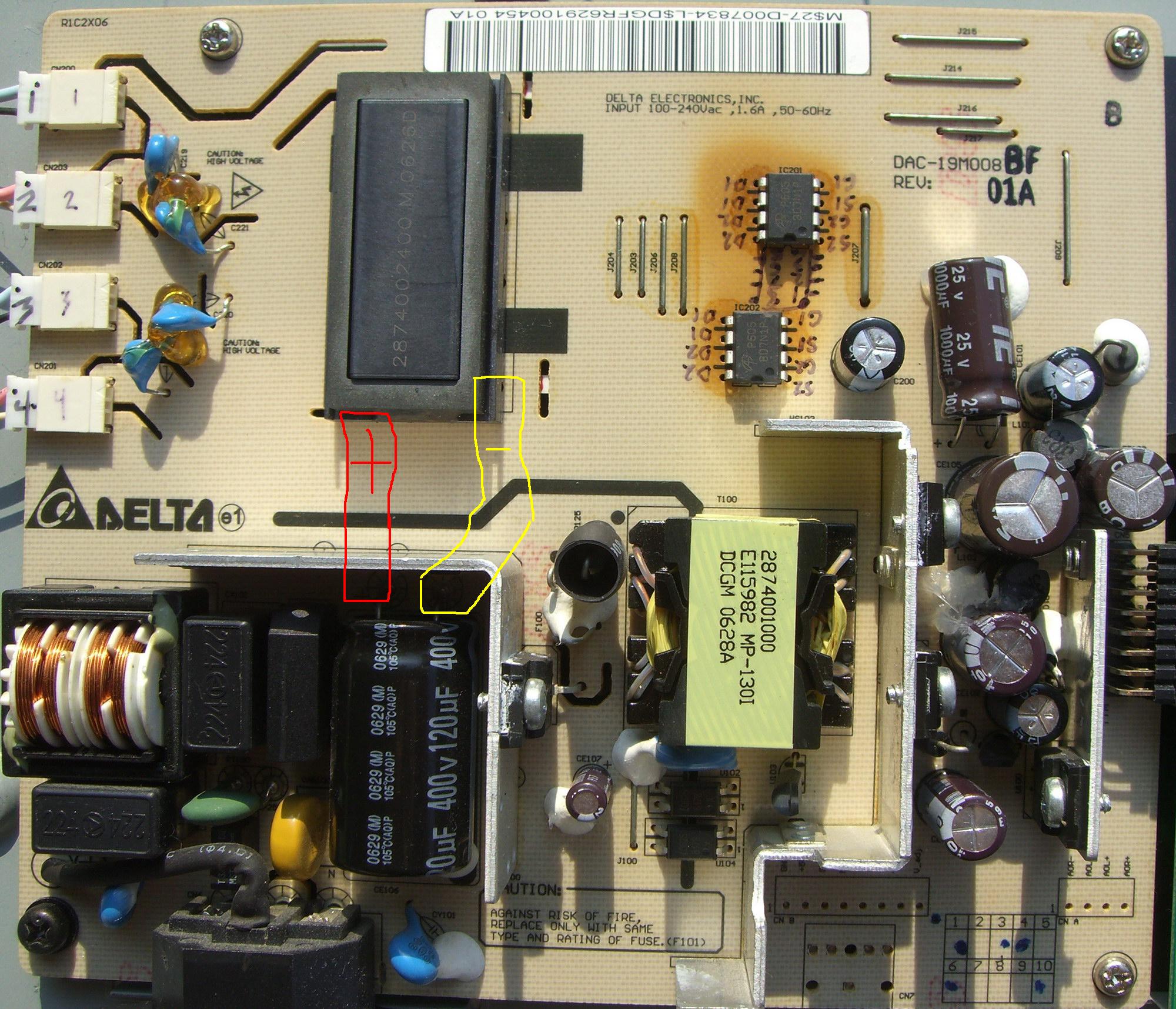

    I found this site while searching for troubleshooting tips for a Viewsonic VA1912wb3 monitor with a DAC 19M008 power supply, that doesn't seem to power up; no green power light and no picture. I have replaced some bulging Capxon caps on the power supply board, 3 of the 220uf/25v and 2 of the 1000uf/25v. I found and removed a solder blob shorting two of the leads of one of the 8 pin DIP ICs. I also resoldered the connections to the two transformers, they looked a bit gray.
    Are there any other parts that I should replace?

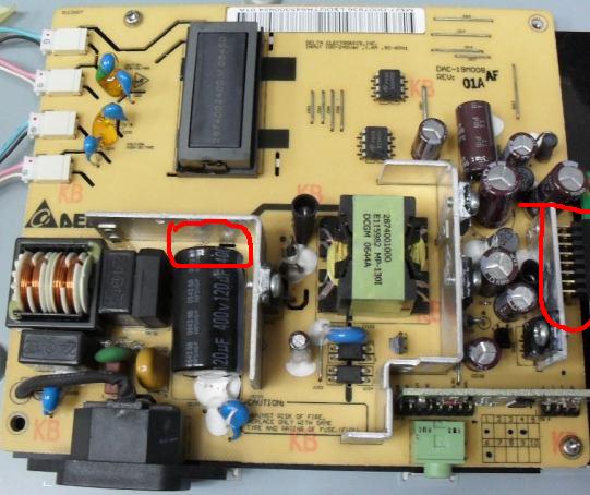

    First check that you have power at the main cap (the 400v 120uf) set to DC and report voltage .
    Then check the output pins on the board also report findings if you have not already checked these

      If you are not getting correct voltages at the secondary output
      Check fuses on the back of the power board F102 and F200 (pic 1)

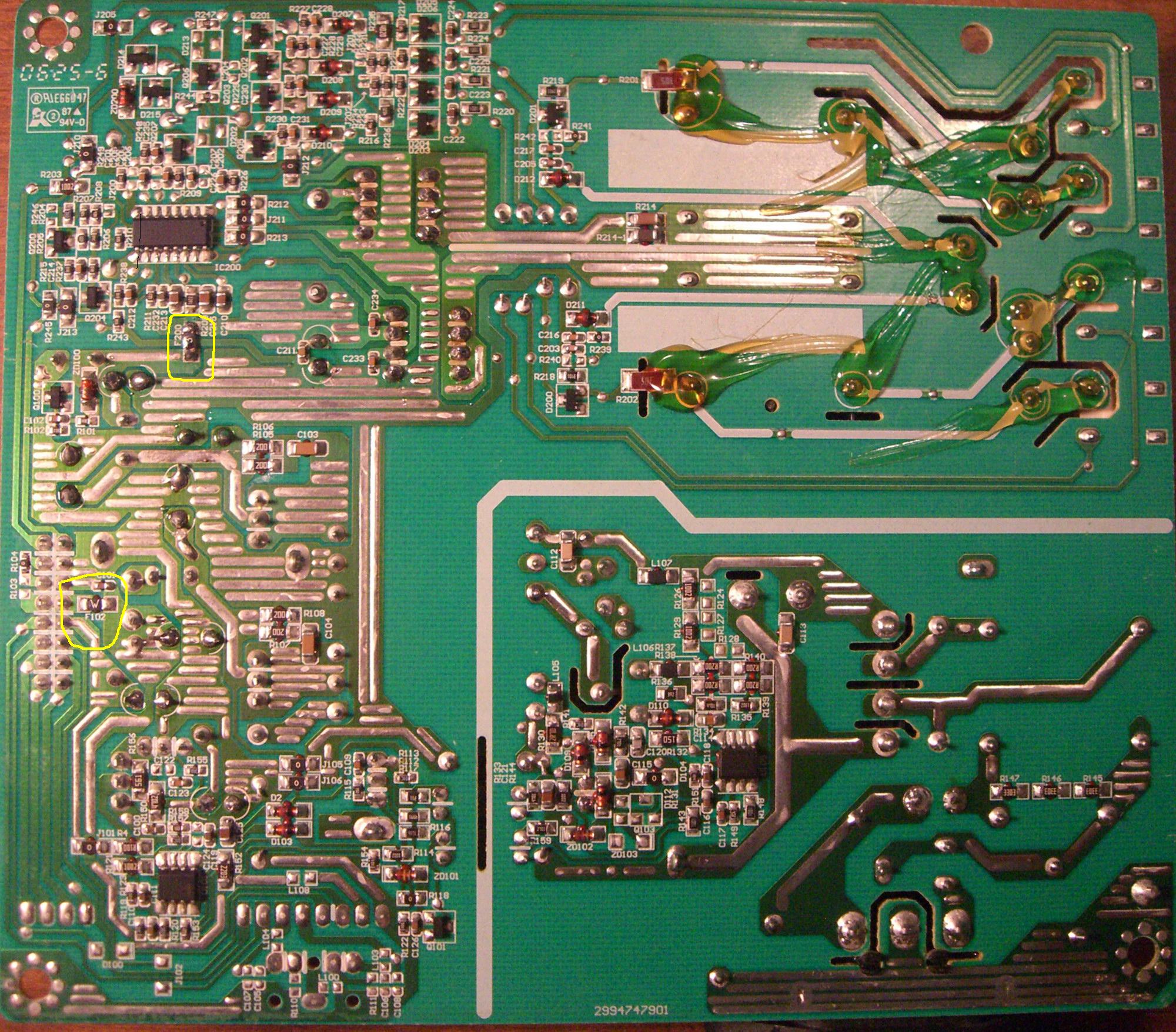

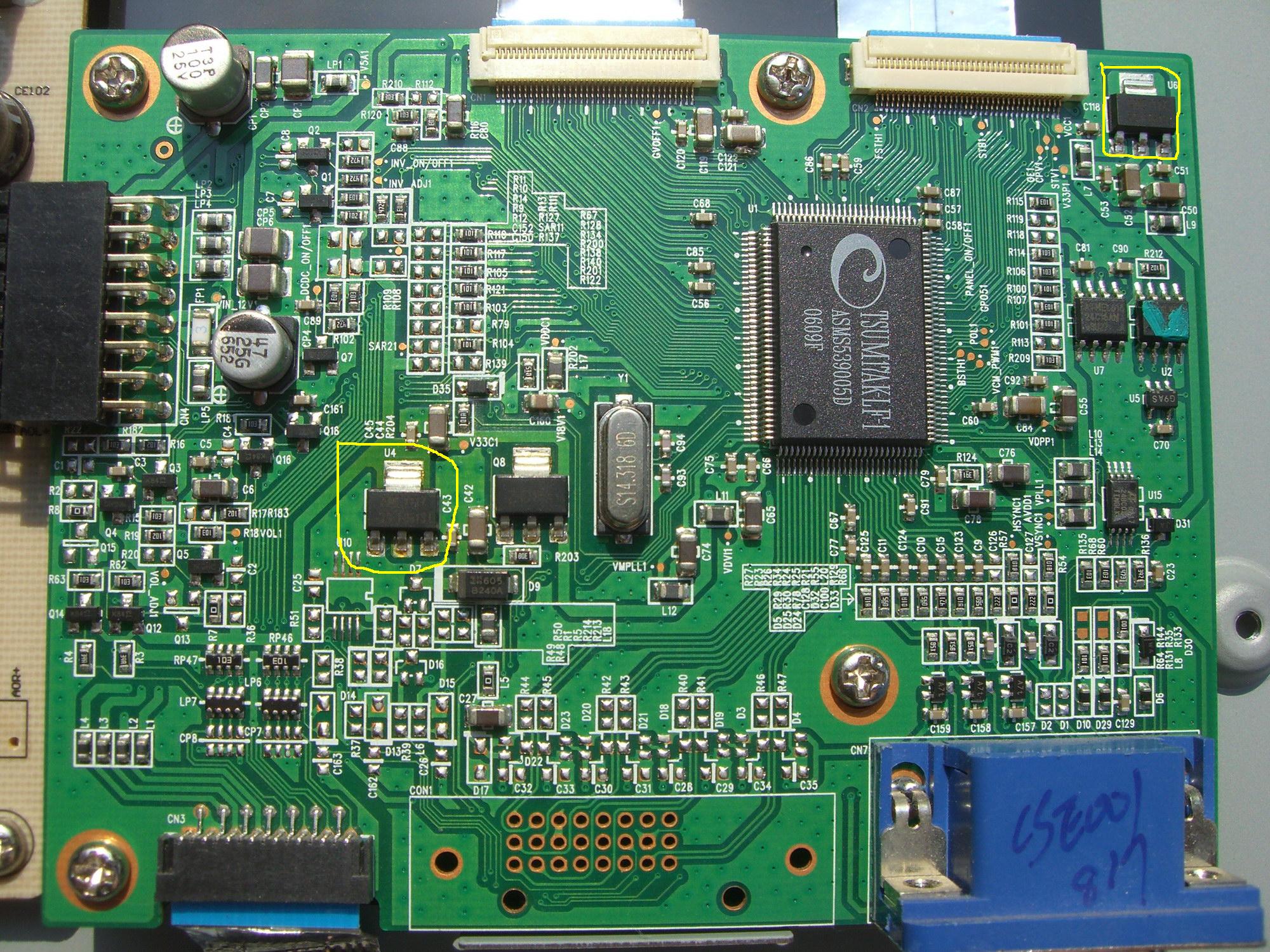

      If you have correct voltages chsck voltage regulators on the video board (pic 2)
      I have posted pics as a guide your boards may be diffrent we need pictures really

            You will have to apply mains power to the board ,
            Set your meter to DC depending on what the increments are it must be set above 400v (ie 600-750-1000).
            Place red probe on the positive leg and black on the negative leg (marked with white stripe)
            Careful high voltage report reading .
            This is not to test the cap itself but to check that it is getting the correct voltage to run the board and the result will help others help you where to test next
