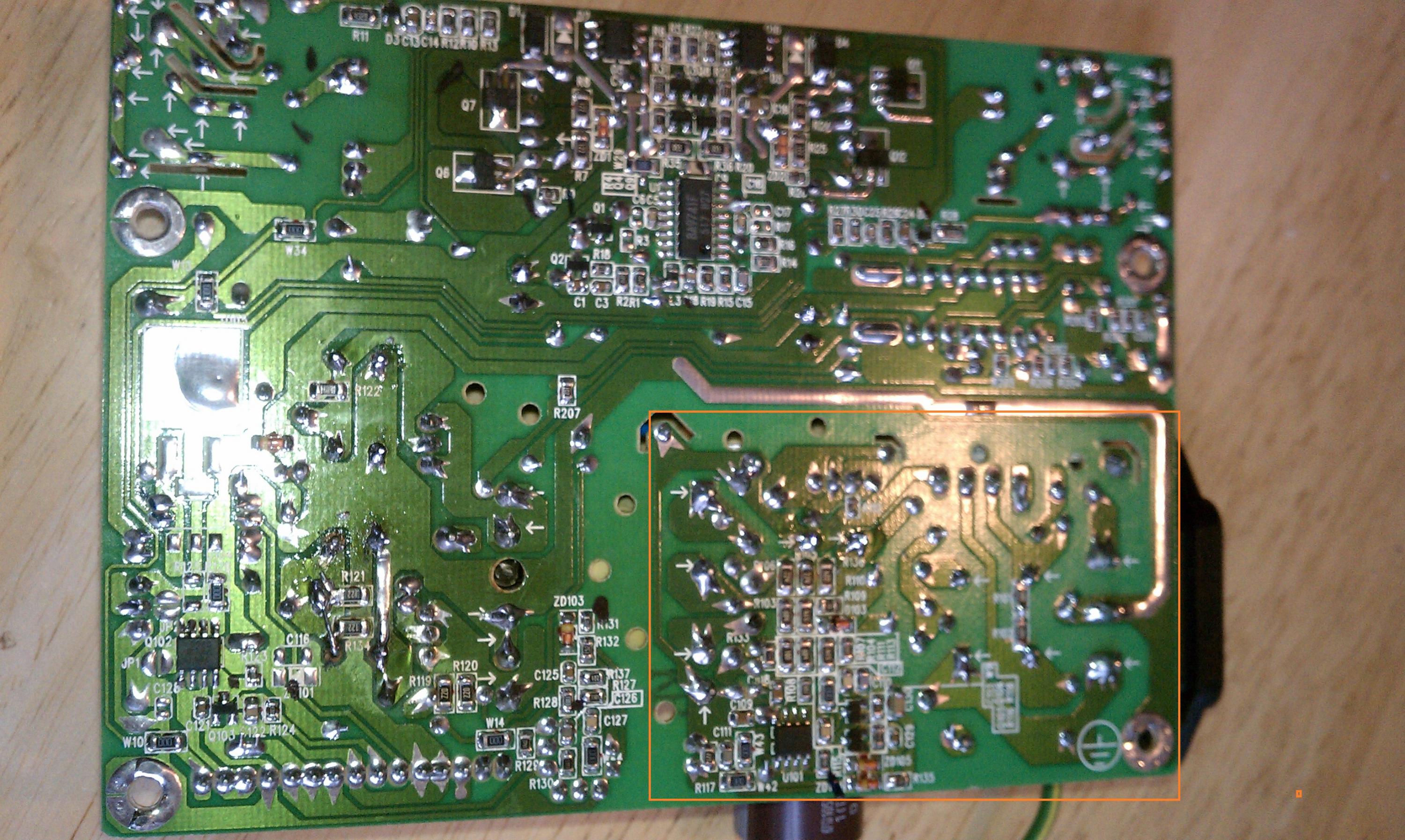

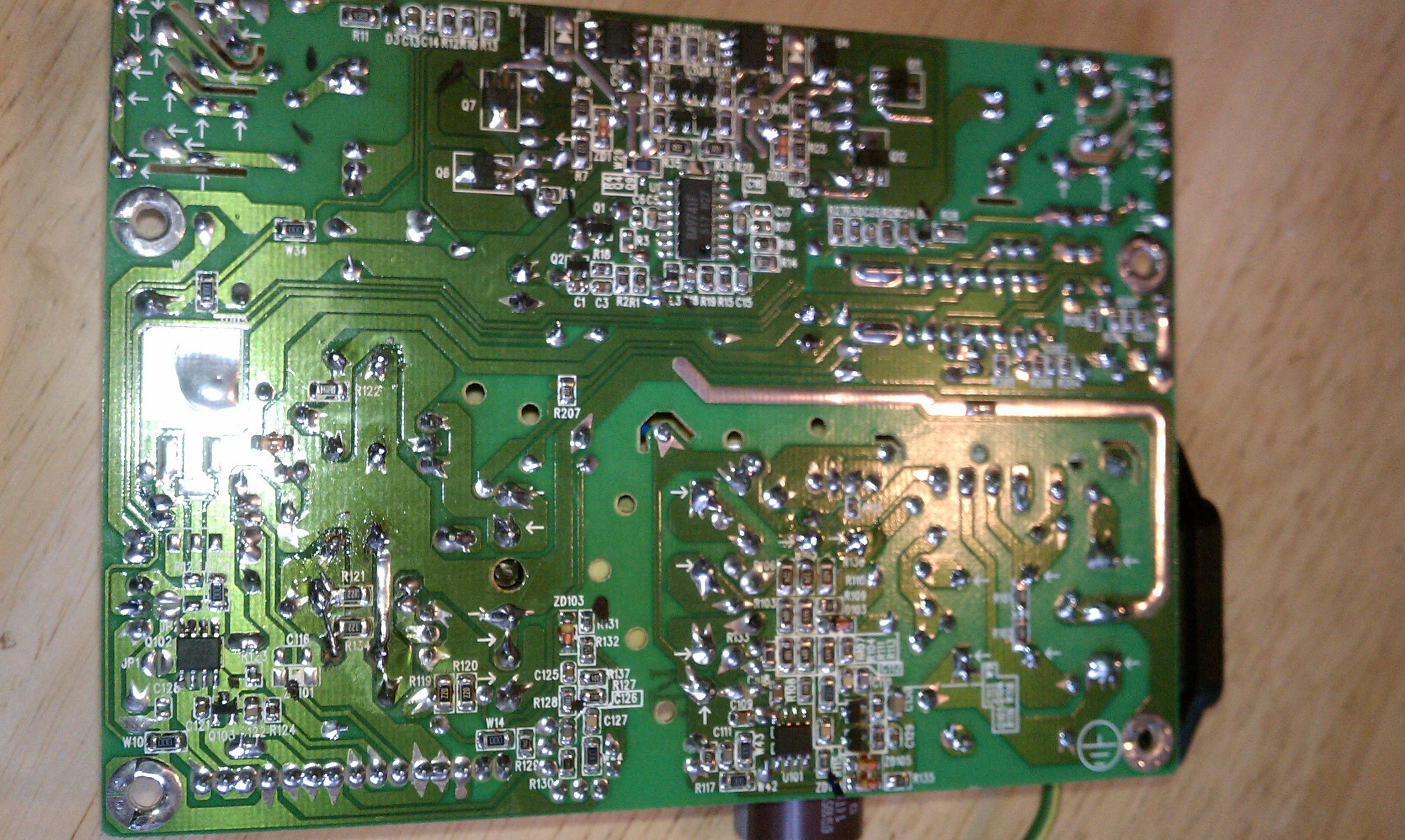

    I have a Tatung LCD monitor that does nothing at all. No LED on power button nothing at all. It had some bad caps which I replaced and that did nothing. I hooked the back lights to a different brand power supply and the display itself works fine. With power plugged in I have voltage on the large yellow transformer on the plug side nearest the big filter cap. Around 60v. I would think that mean the bridge rectifier is fine as well as filter on the output side of the transformer I have nothing. No voltage at all. I checked the resistance on the output and it is roughly 1 ohm. Would that indicate the transformer is dead? It does not seem to have been hot. There is no writing on the transformer to determine a proper replacement. Am I on the right track? Are these transformers some what universal? Any idea what I could replace it with? I would be tempted to buy a board but I can't seem to locate one. It is a LM004 Rev 3.

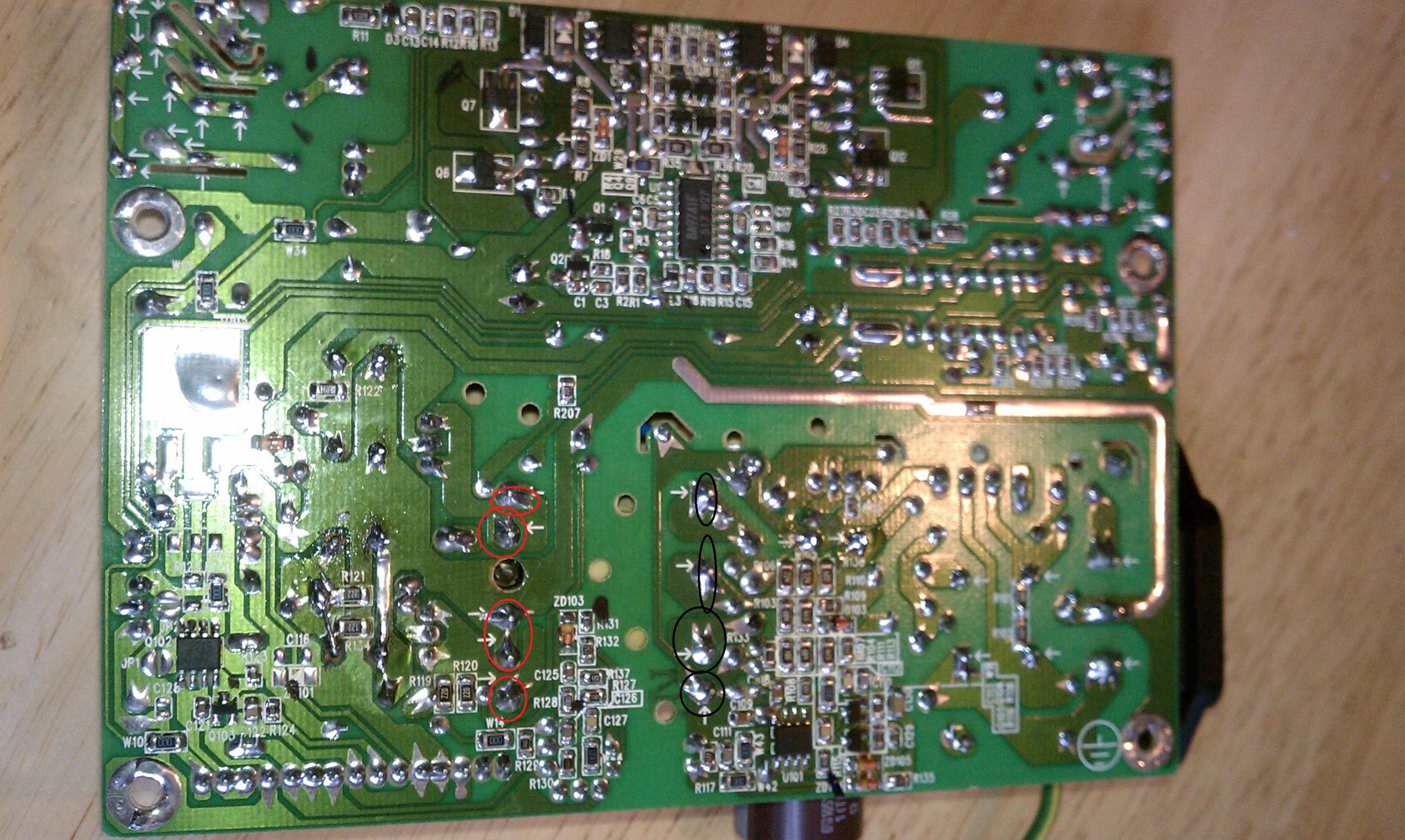

      • jbshocks
        • Jan 2013
        • 20
        Re: Help with Tatung TLM-1905 LCD no power at all
        Where circled in black I got voltage. Red circles, nothing.

                on 200v DC tested ground to each side of F1. Nothing. 0. Also tested ground to each pin connector. All 0. Ground screw to input side of transformer 63 v. I will try to get better pictures and read the guide.

                    it is c109 and it has 64.5 on each leg to ground.
                    Also testing with meter on 200 vdc the area in orange is the only area of the board with any power at all.

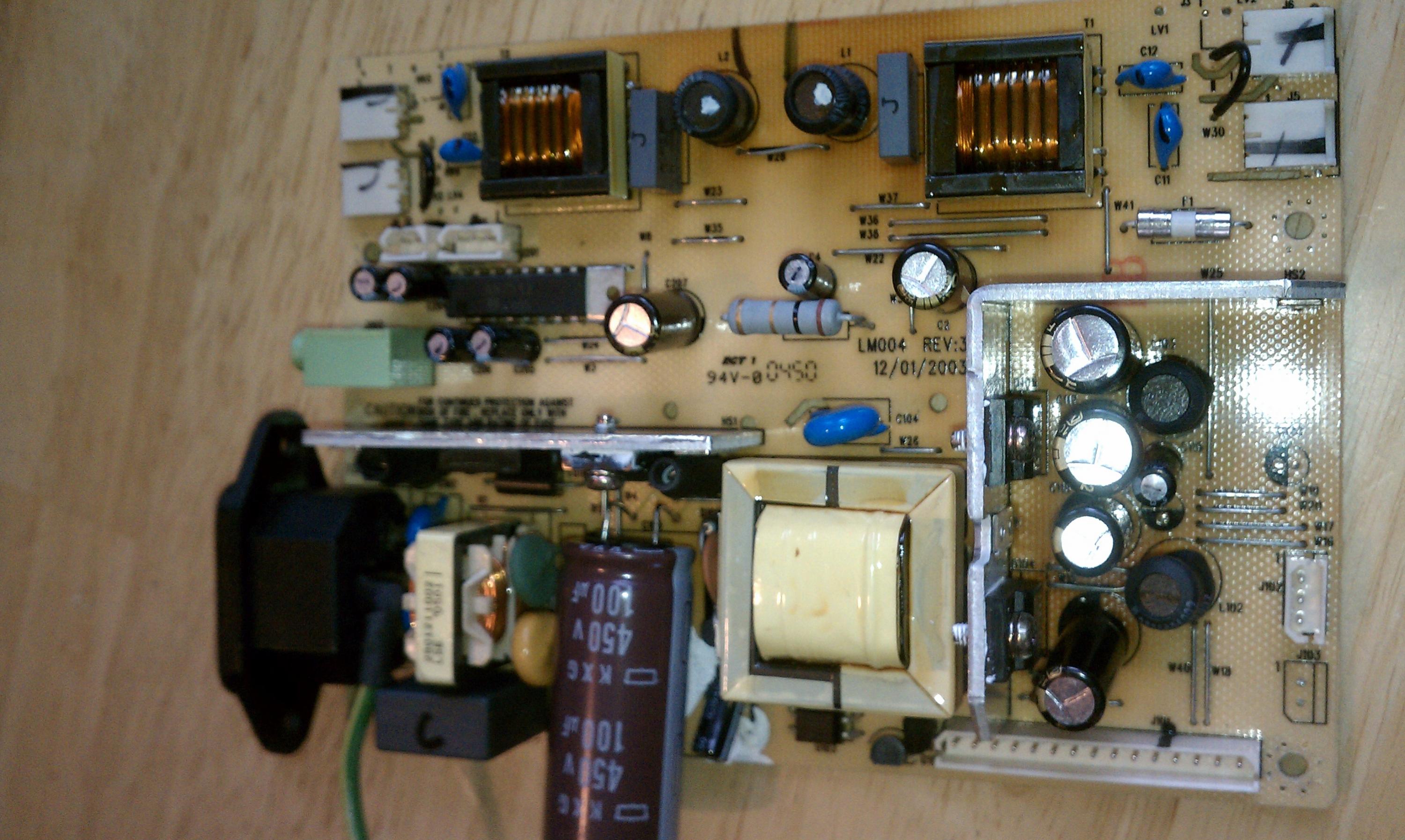

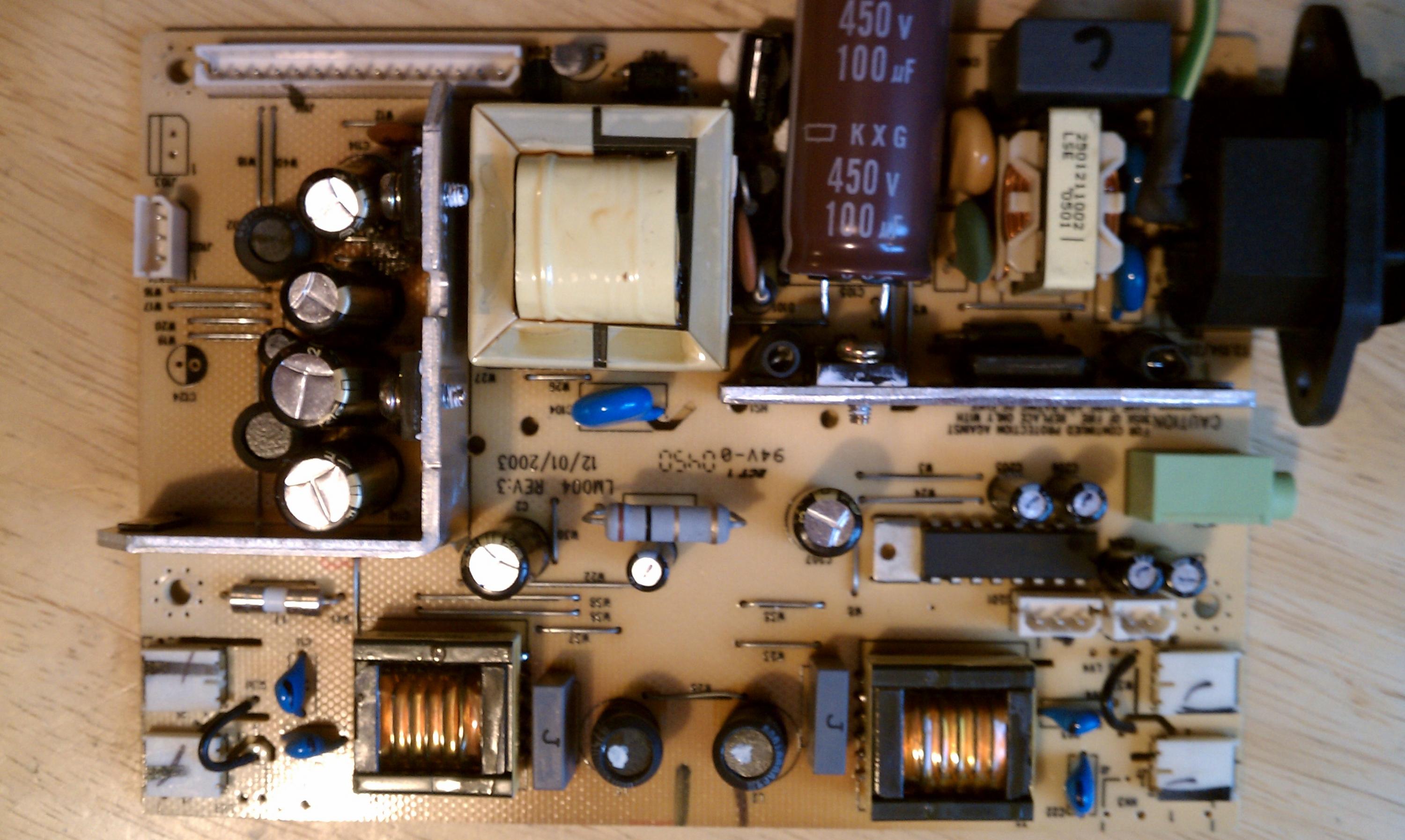

                            across the big cap is 169 v DC. Here is a little better picture. I don't have a very good camera.

                              Provided that is the Start up cap !! then you need to identify the part code written on U101,on the bottom of the board, as this looks to be the SMPS chip,you then need to find the datasheet for that,see what pin that cap goes to etc.Also there should be a diode connected to the positive side of that cap,the other side of the diode going to the transformer ??

                                chip says sg3842gs. I can see on the board it goes to pin 7, verified with an ohm meter.

                                    At first look at the datasheet, then 15V DC needed between 5 and 7,which is the same as across the cap,and you have nothing.You need to check the diode connected to the +ve side of the cap, undo one end and check either with resistance or diode test on the meter...POWER OFF for this.You can replace the cap and try that as well, otherwise as these transformers do not usually fail...I have never seen one fail..you would need to replace the chip I suspect.

                                      diode reads 500 one direction and nothing in the other in diode test mode. This is out of circuit. I could easily change out the chip. My concern is that I have no voltage on the chip vcc

                                        The required start-up current is typically only 5uA. This
                                        ultra-low start-up current allows designers to supply the
                                        start-up power required by the SG384xG using a
                                        high-resistance and a low-wattage start-up resistor.Thats from the datasheet,so on initial switch on some current is drawn from the Rectifier Bridge to the VCC Pin to start
                                        off the sequence to get the chip running.If the chip is faulty then you could get exactly the symptoms you have.
