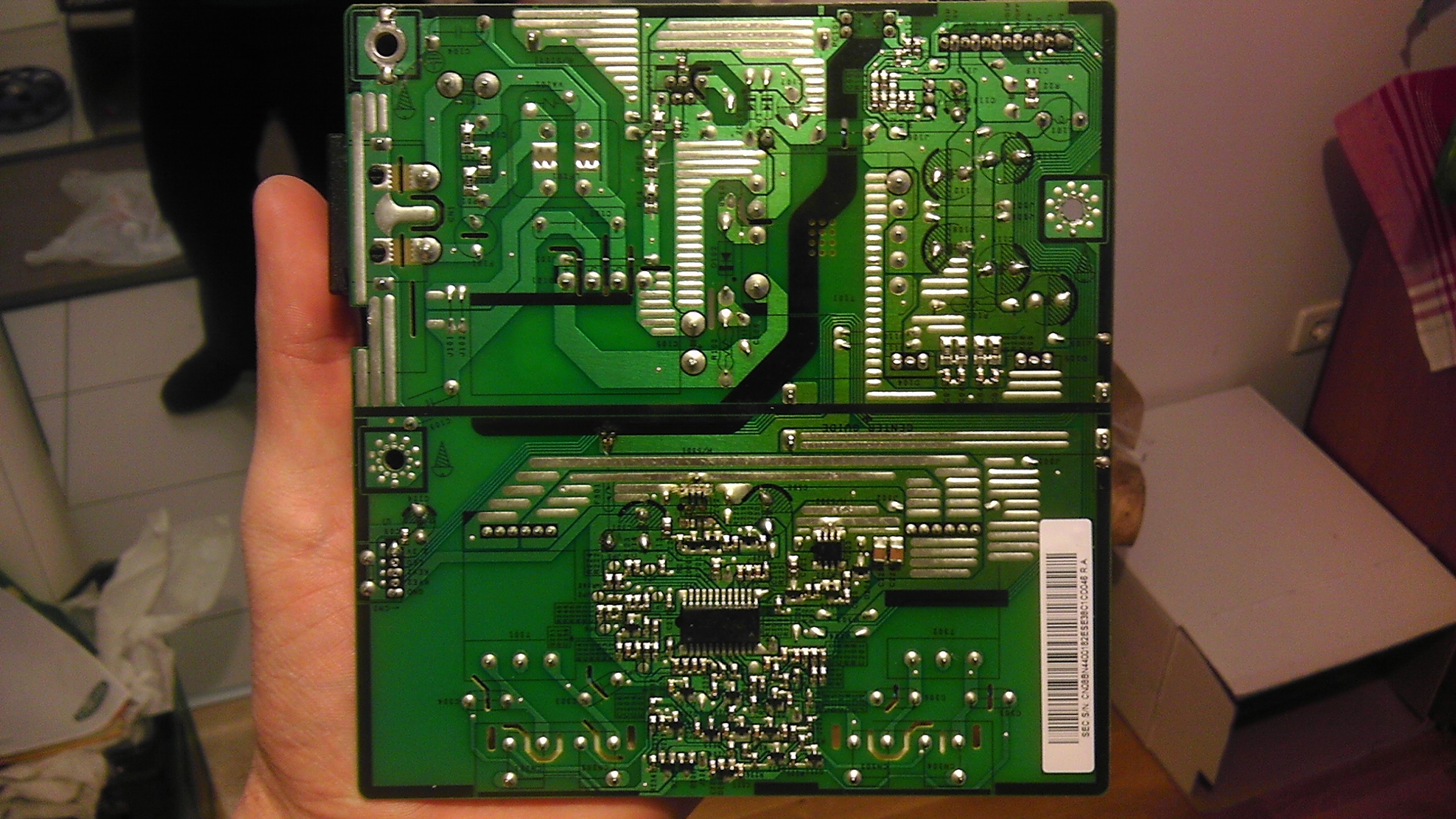

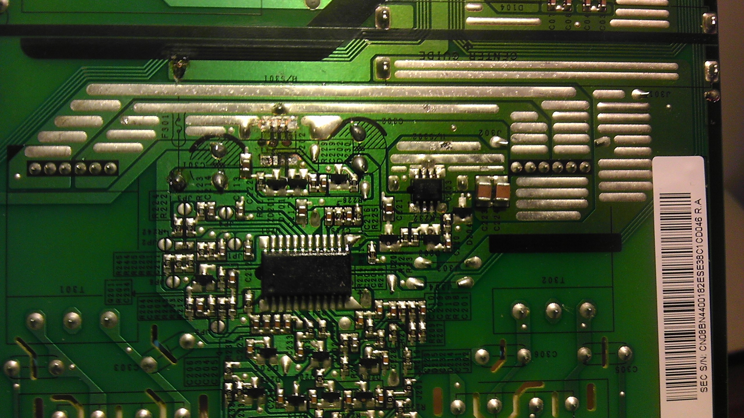

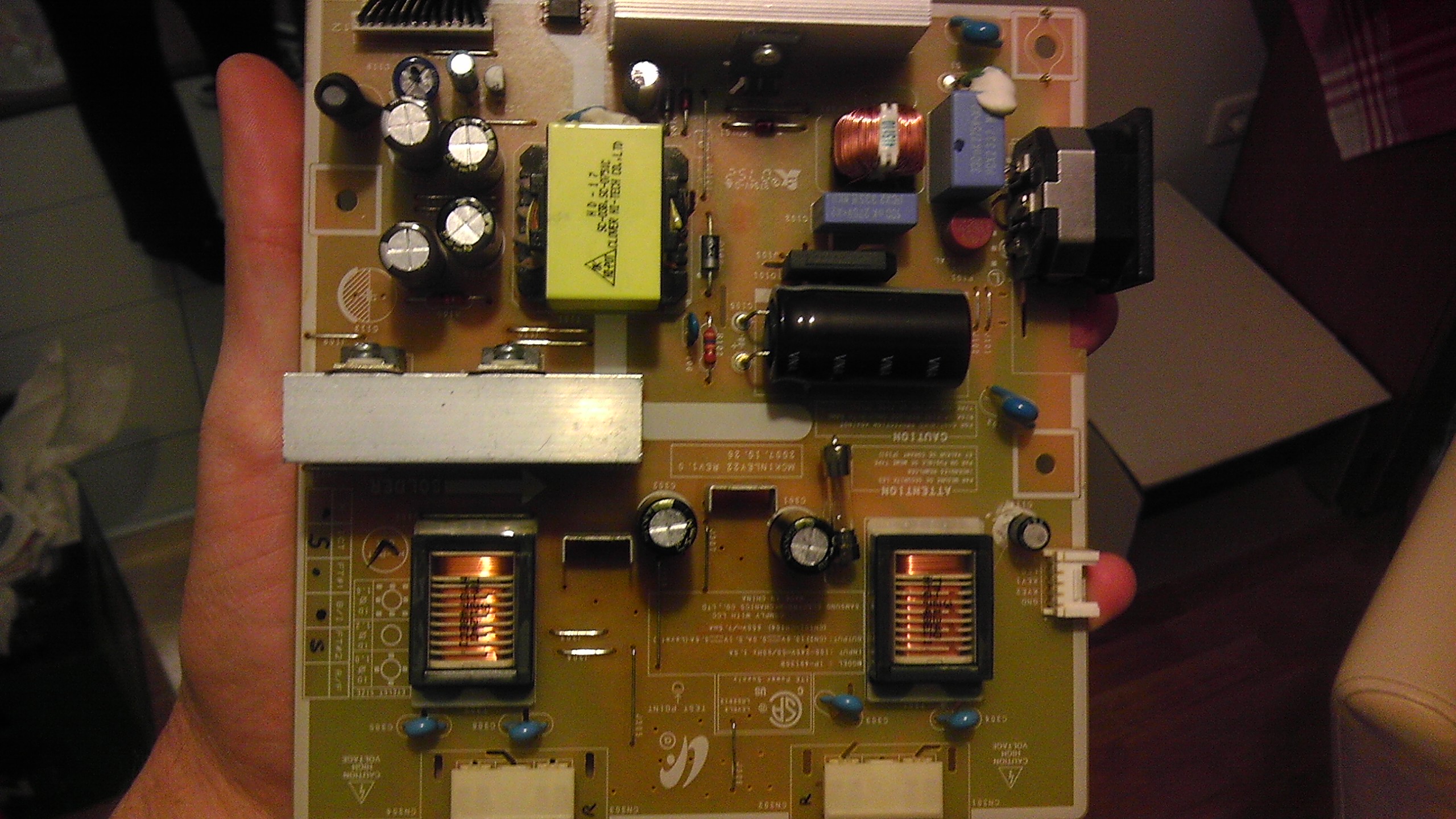

                                Re: bad caps samsung 2253bw
                                Can we see good clear pictures of the board? It may be time to get new board.
                                • Daci
                                  • Jan 2013
                                  • 12
                                  • Croatia
                                  this is best that I can do...
                                  I only replaced caps and pico fuse is replaced with glass fuse...there isn't any burn mark on the board or on the any component
                                    Reason: edit: sorry for the big pics
                                    Well why not remove them and add using manage attachments
                                    EDIT - That is a lot better thanks
                                    • Daci
                                      • Jan 2013
                                      • 12
                                      • Croatia
                                      Is this good enough ?
