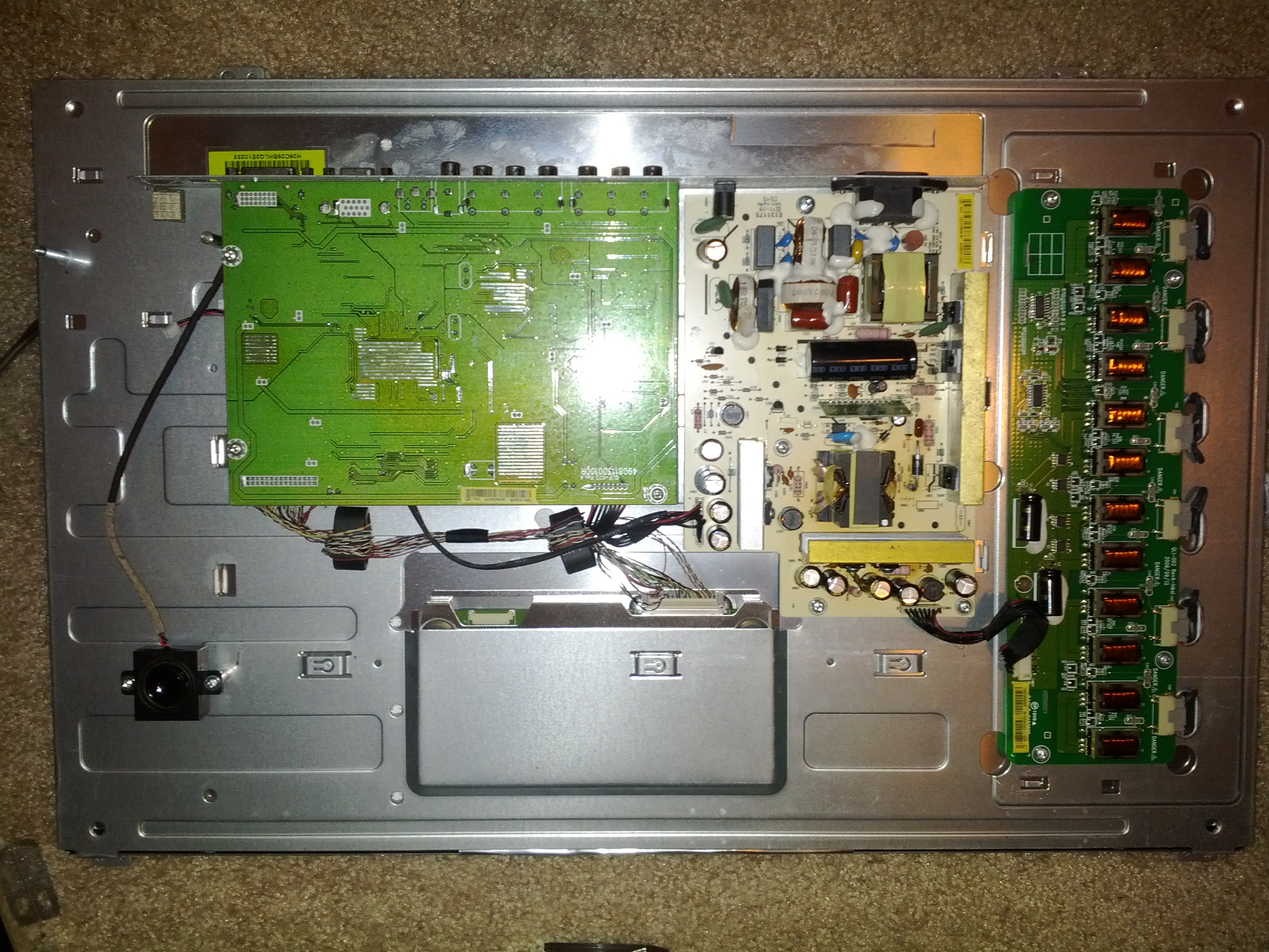

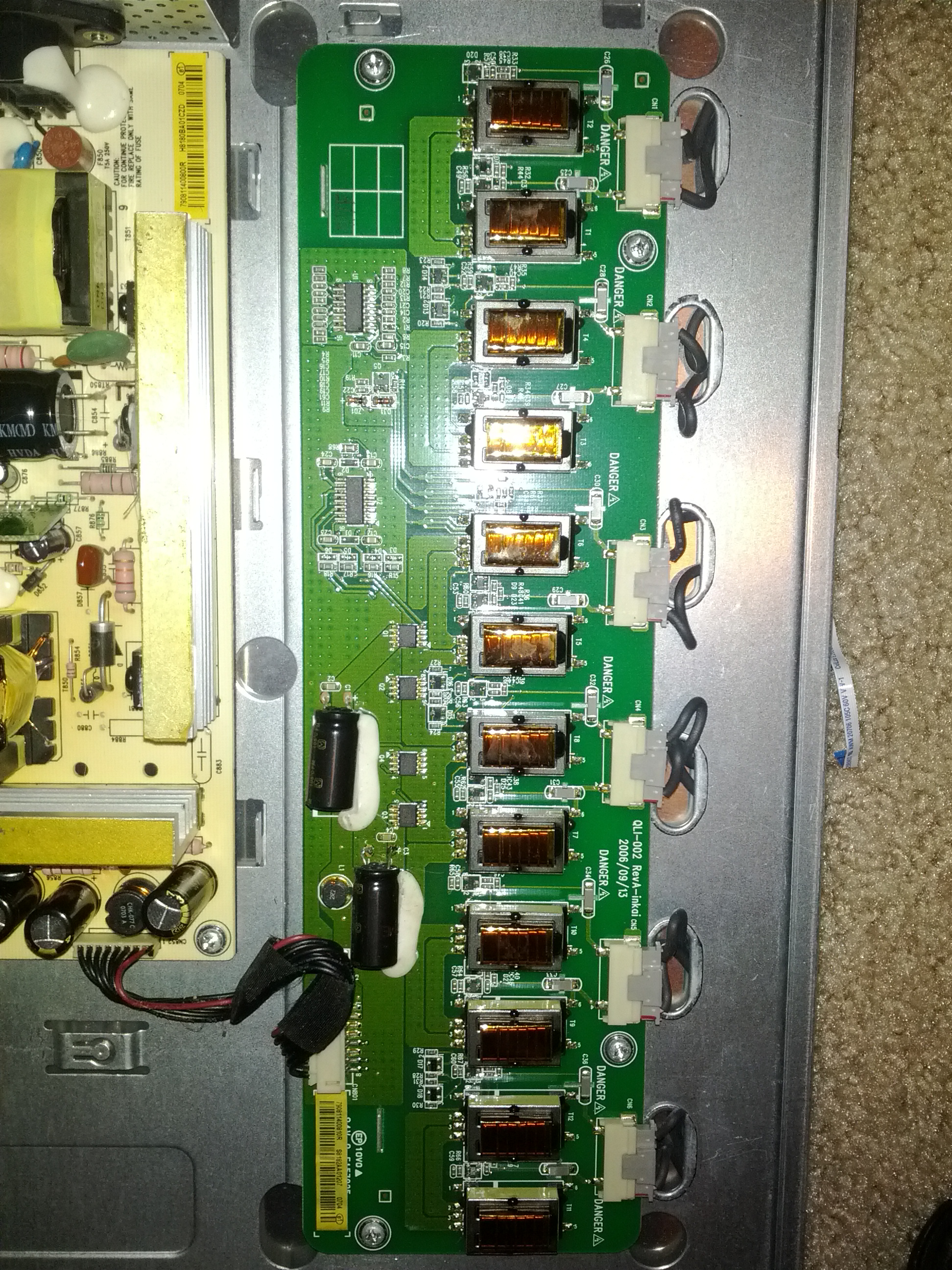

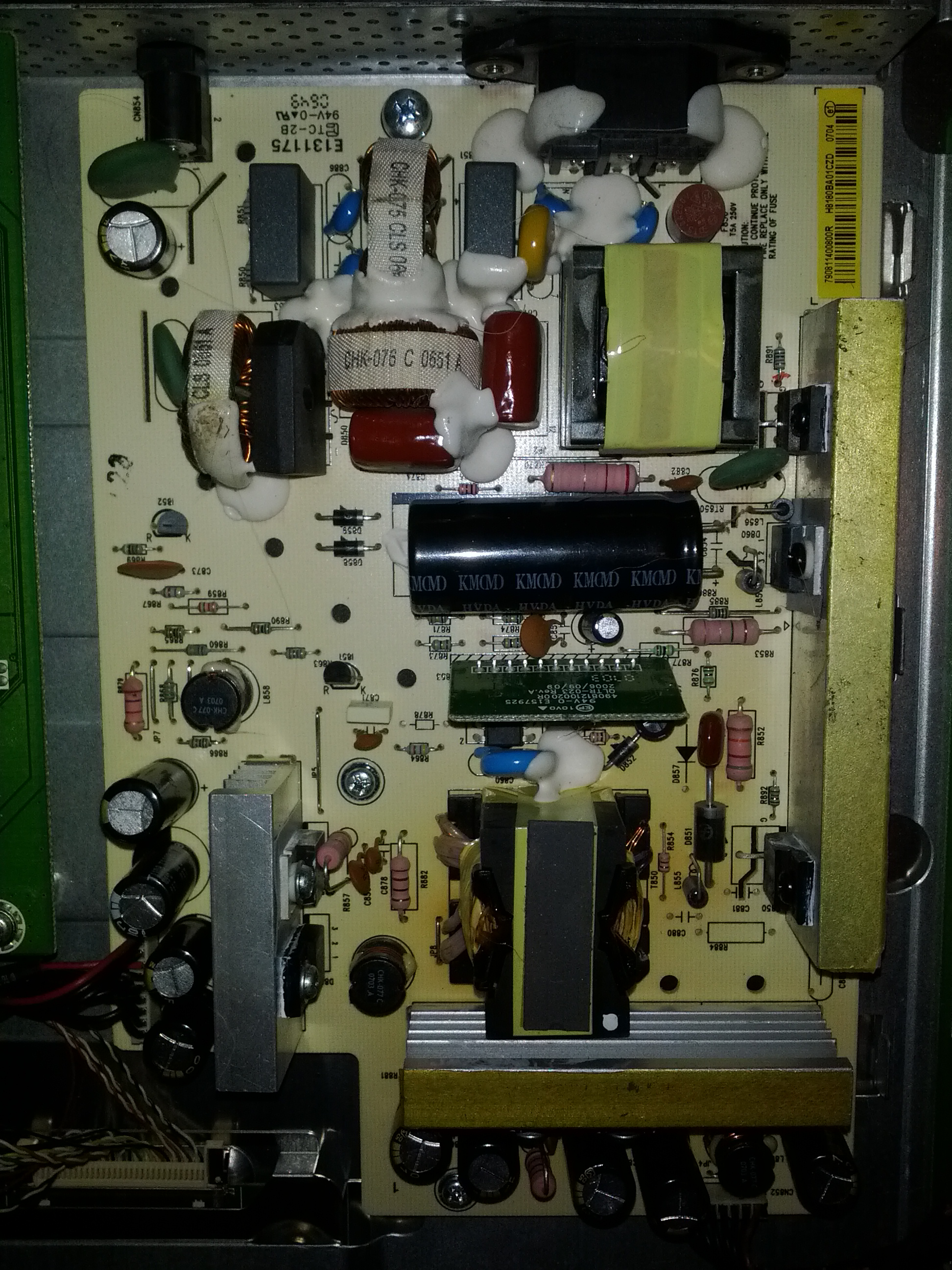

    That means you may still have problem with the backlights inverter board. Please upload good clear pictures of the whole chassis and each board so we can see what has on this revision of your monitor, make sure to use attachment for uploading the pictures.

      Re: FPD2485W - Replaced Capacitors and still not backlight
      which board is the backlights inverter board?
        Here are the pictures of the chassis and boards.
          Please edit your post and use GO ADVANCED to upload the pictures, use the attachment function. posting in line takes a long time to load the page.
          The inverter board in the one on the right with a bunch of small high voltage transformers.

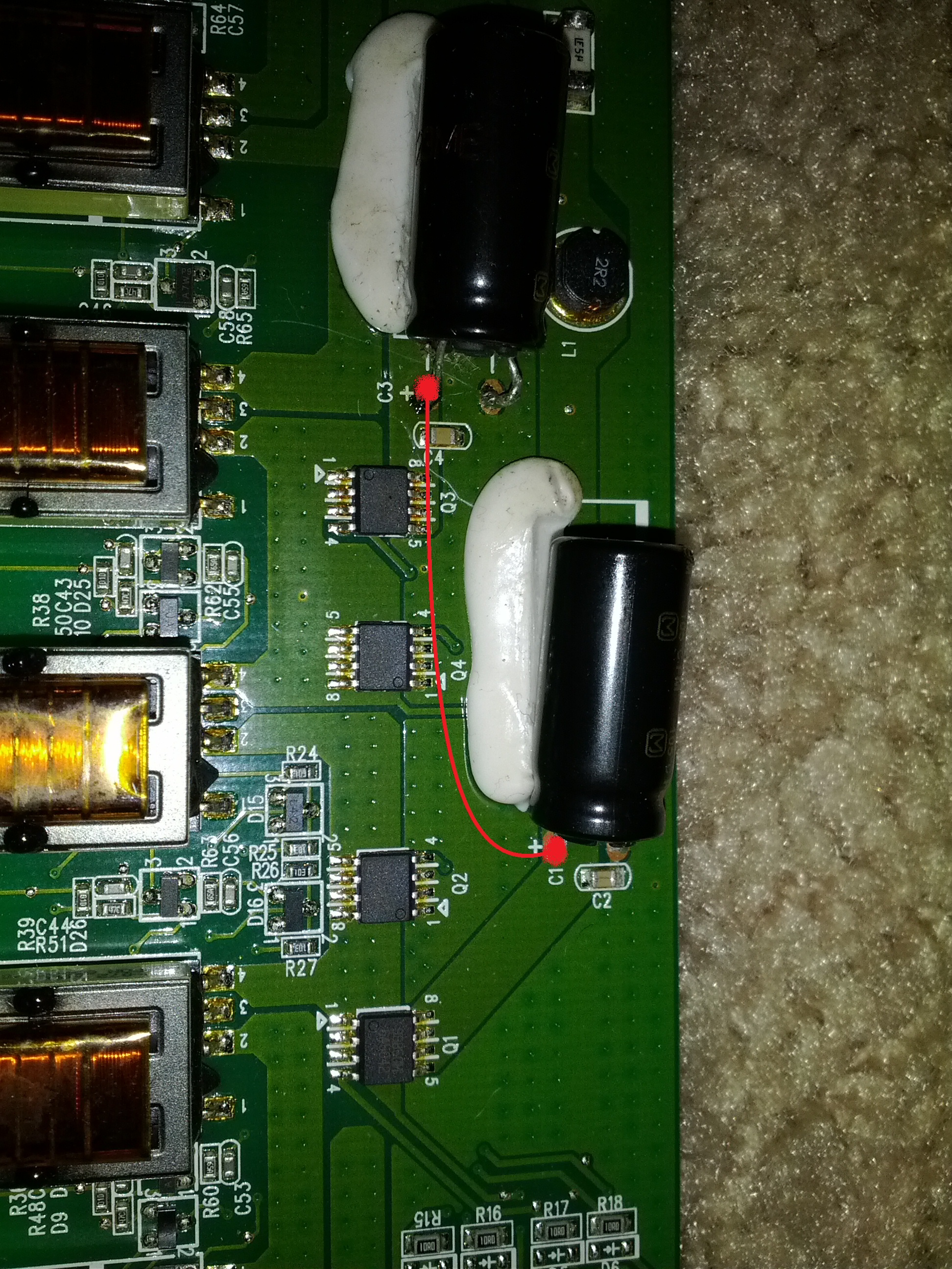

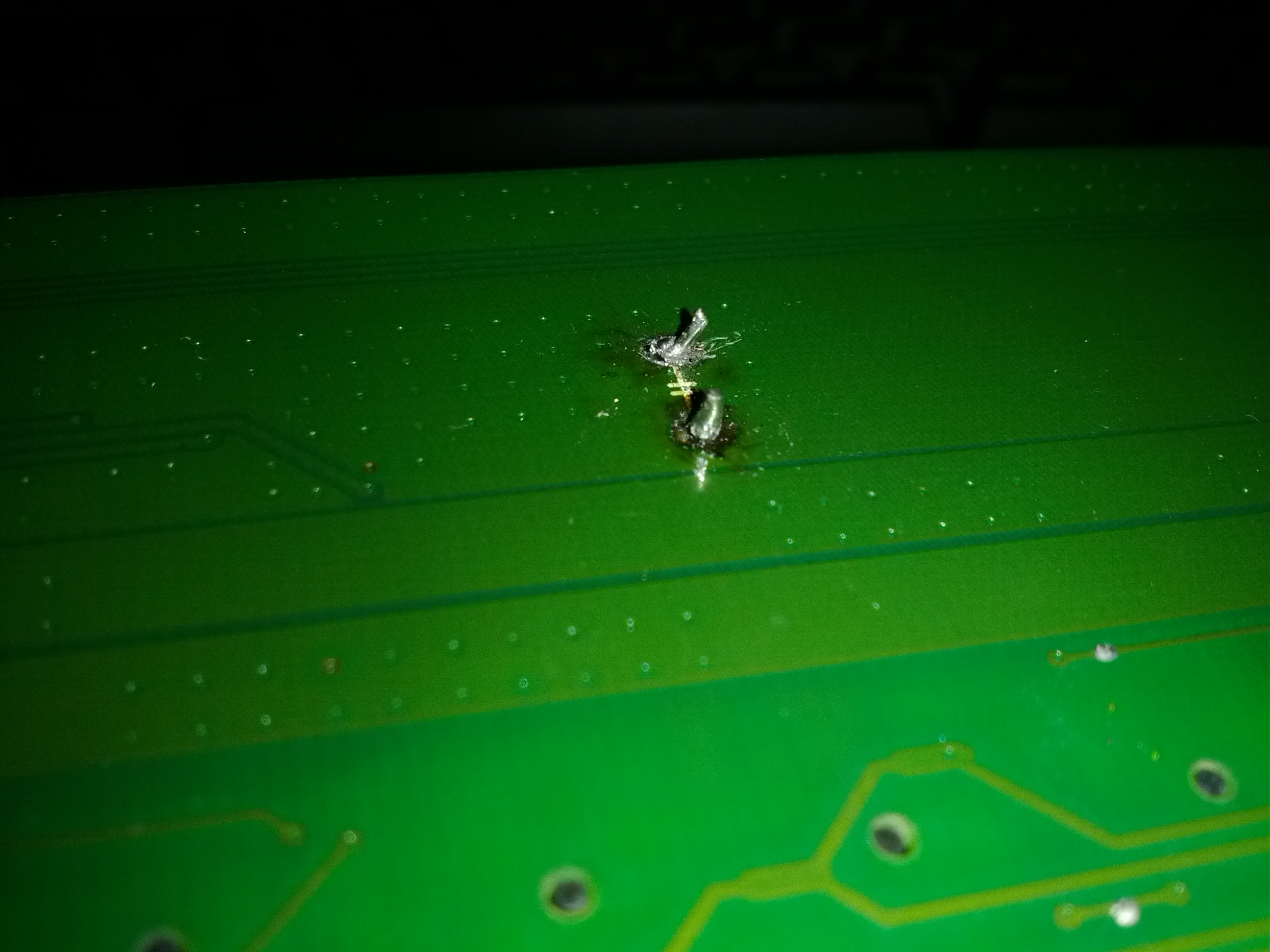

            I think i found the culprit but i am not sure. I did this fix about a year ago and now i cannot remember how this happened. Any way to test and see if this solder joint is ok?
              Is there any way to fix that solder job? the pad seems like a burnt it off.
                Use your multimeter and see what has continuity to those capacitor legs and then run an insulated jumper wire to it.

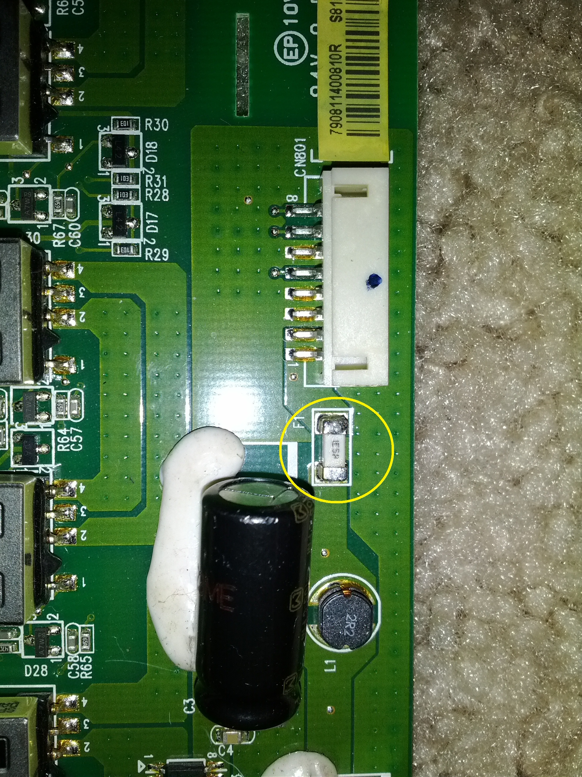

                  Is the white component in this picture (circled in red) a fuse? i am not getting continuity across it.
                  I tested and i am getting continuity from the messed up diode to a leg of the other diode. could i just add a wire like shown in the second picture.
                    1 Yes its a fuse
                    2 No idea what you are talking about "Diode"?

                      Sorry i meant capacitor. Is there more than one fuse on the board? There seems to be 2 for each harness on the inverter board. Or is there only one fuse?
                        You are in the best position to check? That one is labelled "F1" if there are others they will be labelled F2 F3 and so on.
                        Are you sure that cap needs wiring, that leg MAY go through the board
                        to a trace on the other side? You will need to take the board off or at least
                        take the screws out and tilt it to check.
                        Your connection looks much the same as this one
                          I asked if there was more than one fuse because i tested everything i thought could be a fuse and did not have continuity through any of them. I'm not sure what you mean by the second part of your post? there are pictures of both sides of that solder joint on the capacitor leg up above.

                            Just some updates.
                            I figured out fuse F1 was blown. when i had the monitor apart, everything worked perfectly. I put everything back togeather and to my dismay nothing worked, no power, no lights, nothing.
                            It turned out to be that the leads from the two capacitors that i replaced on the inverter board were too long and shorting to the case, i trimmed them up and now everything works perfect.
