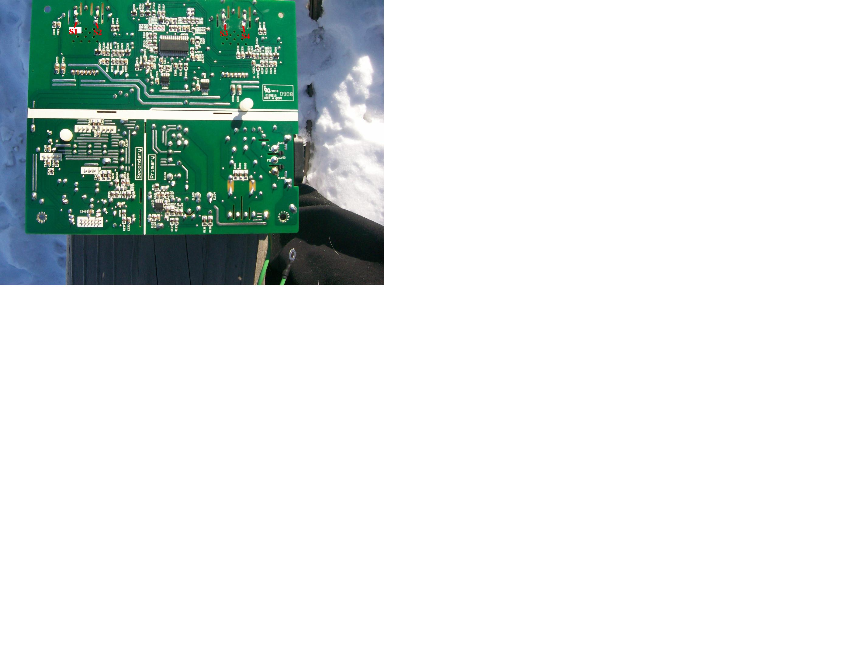

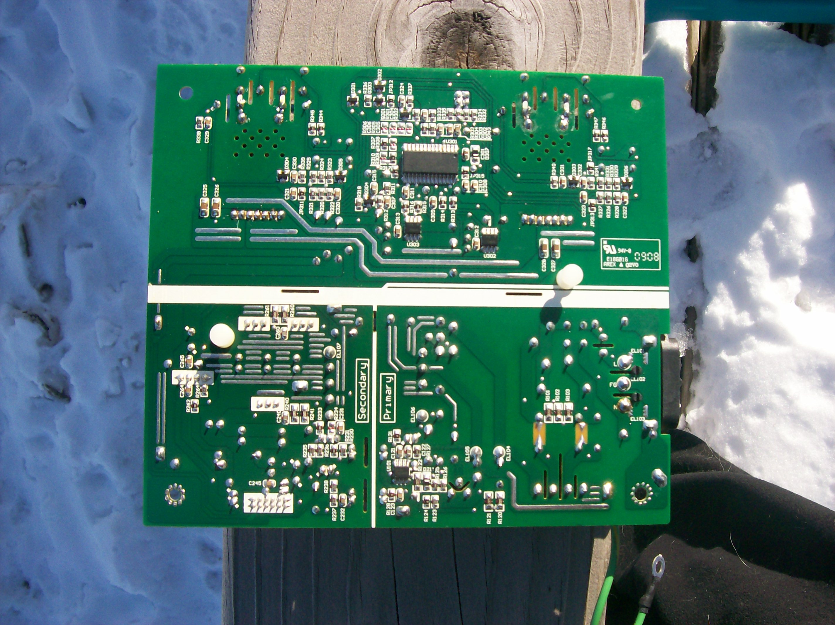

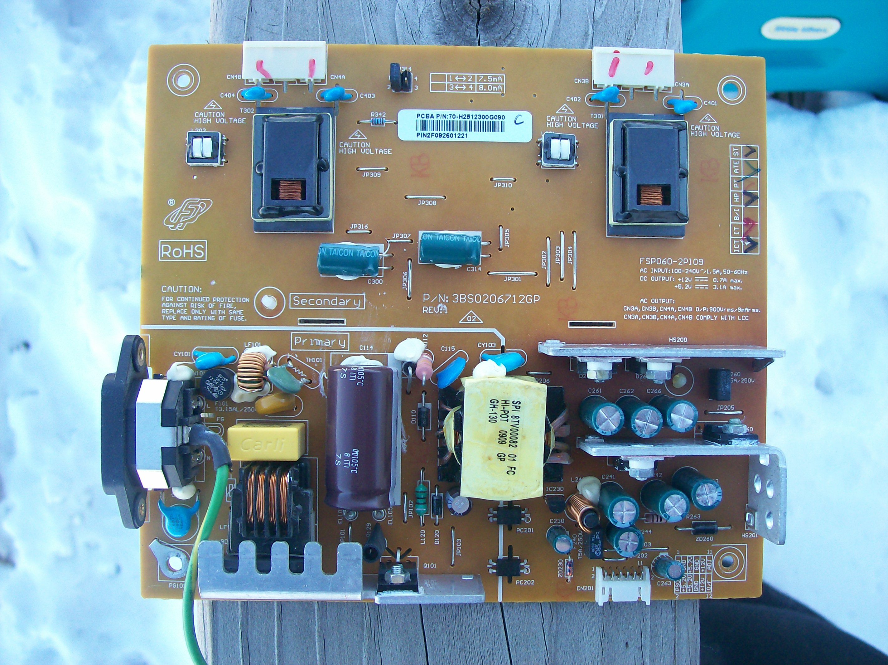

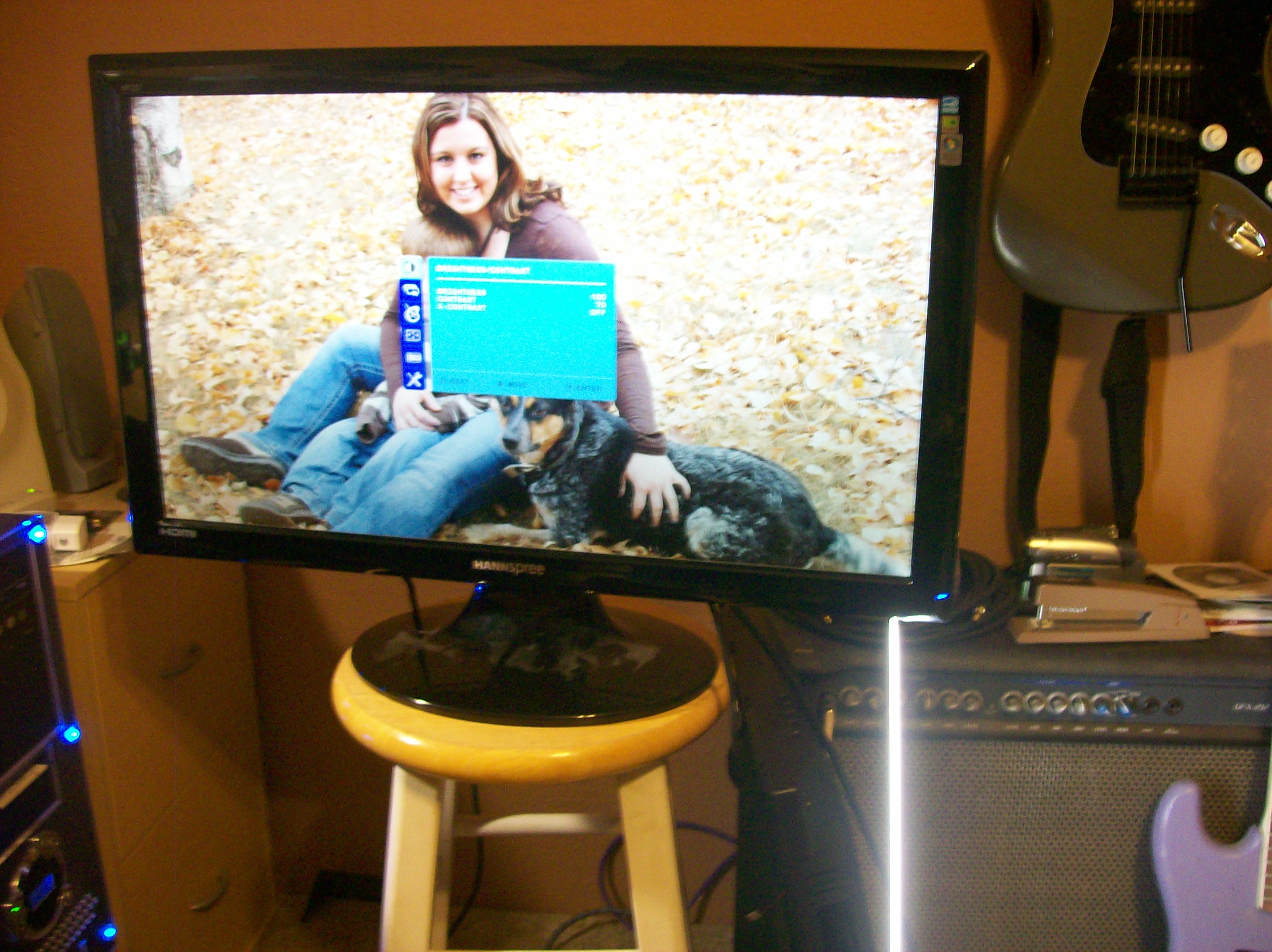

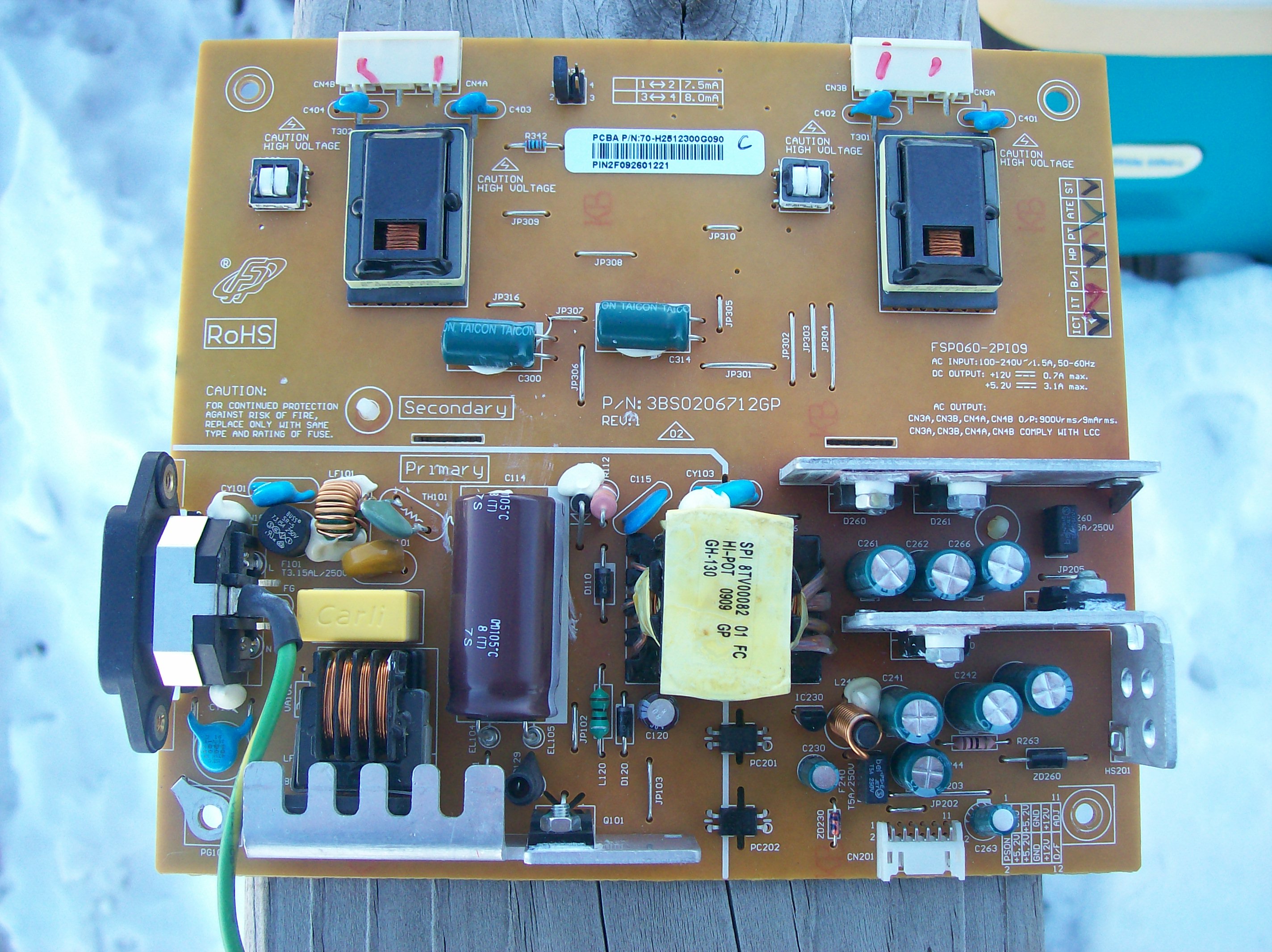

    I have a Hannspree HF257 (25") and about a month ago had the bottom left side of the screen start doing a weird flickering and turning the monitor off and on seemed to fix it only to to it again the next day an turning it off and back on fixed it again. A few days later after not having any issues at all the screen just went black all together and turning it off then back on it would light up for about 2-5 seconds then black again so I brought it to a friends that said he would test some items and said he had an ESR tester for the caps. Later that day he said that I had some bad caps and a bad mosfet and had found a complete replacement board on ebay so I ordered it and when I put it in, it worked worse then the one I took out. The replacement one now would come on for 2 seconds and go out and this one has a very faint click and then an audible hum as soon as the CCFL tubes go out but turning off and back on it is quiet until the back light goes out again then the humming again. Turning the brightness down saw no changes.
    So at this point I decided to put the original board back in and try turning the brightness down on the monitor and was able to get it to stay on as long as the brightness was below 23. About 25 it would go out again, 24 it would stay on for a good time and then go out, 23 it was on for a few hours before I turned it off.
    Well, Now I have told this friend I am just going to replace all the caps and go from there and now he is saying they all tested good (None of them are puffed up or broke open that I can see) so I am not 100% sure now so going to do that in the next day or so.

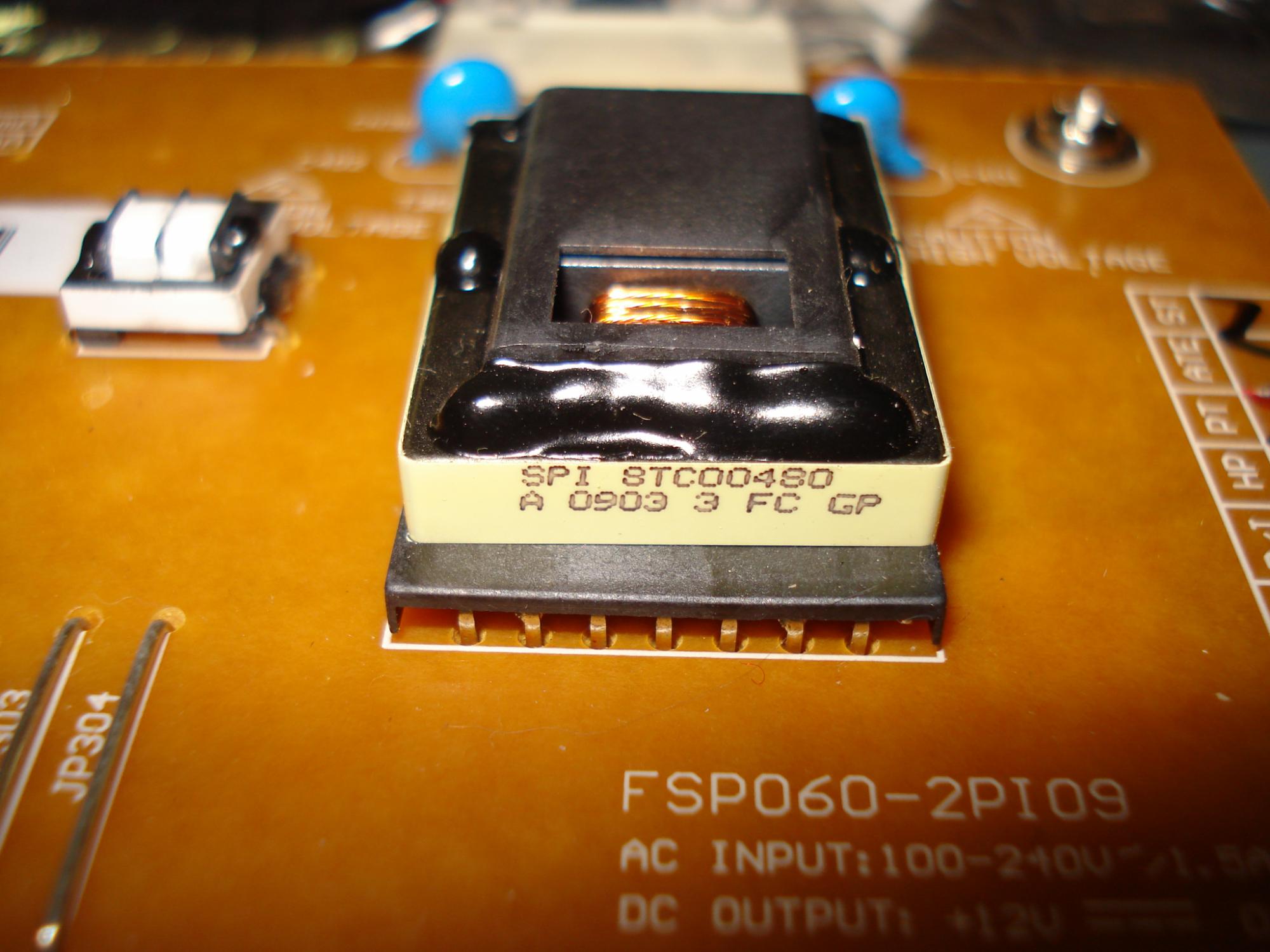

    Now I have been trying to find a replacement inverter transformer in hopes that that might be the issue but have had zero luck finding anything with the same part number and then in this post (https://www.badcaps.net/forum/showpo...24&postcount=1) I do notice them saying that the TDK XAD819AR has the same inverter and have found someone online with a few of them but I can not confirm that yet. I am waiting for them to get back to me. But I was wondering, what would be the best way to test this inverter and would anyone know of replacement that would work?
    Also, I was leaning towards a CCFL tube being the culprit possibly but not sure of a really good way to test as I dont have another monitor or spare tubes to use to test with. Also, How much of a job is it to replace a tube if that is the case? I have never personally done one and my friend is saying its not worth it and way to big of a job but to me from what I have been looking at on youtube and stuff it doesnt really seem like it would be to tough. Anything to really watch out for when changing them?
    Thanks for any help and here are some pictures. The first one is the inverter transformer with the part number, the next 2 are some pictures of the identical board that I had that are nice and clear. and the last picture is my actual board. Mine is missing the white silicone on the back side like the other photo. Looks to never have been on there at all. It is the best picture I could get with the camera I have.

      Test the Inverter transformers by checking the secondary wiring resistance.
      POWER OFF, meter on ohms 2000 test S1>S2 and S3>S4 and post the results.
      You might also want to resolder these connections.

          S1>S2 = 997 consistent
          S3>S4 = between 1004 and 1007
          S3>S4 will not fluctuate while being tested but if I test once, wait a min or so, test again it will give a different reading. To me even the 997 sounds kind of high but I could be wrong for those inverter transformers as I do not have any kind of data sheet or any kind of info on them.

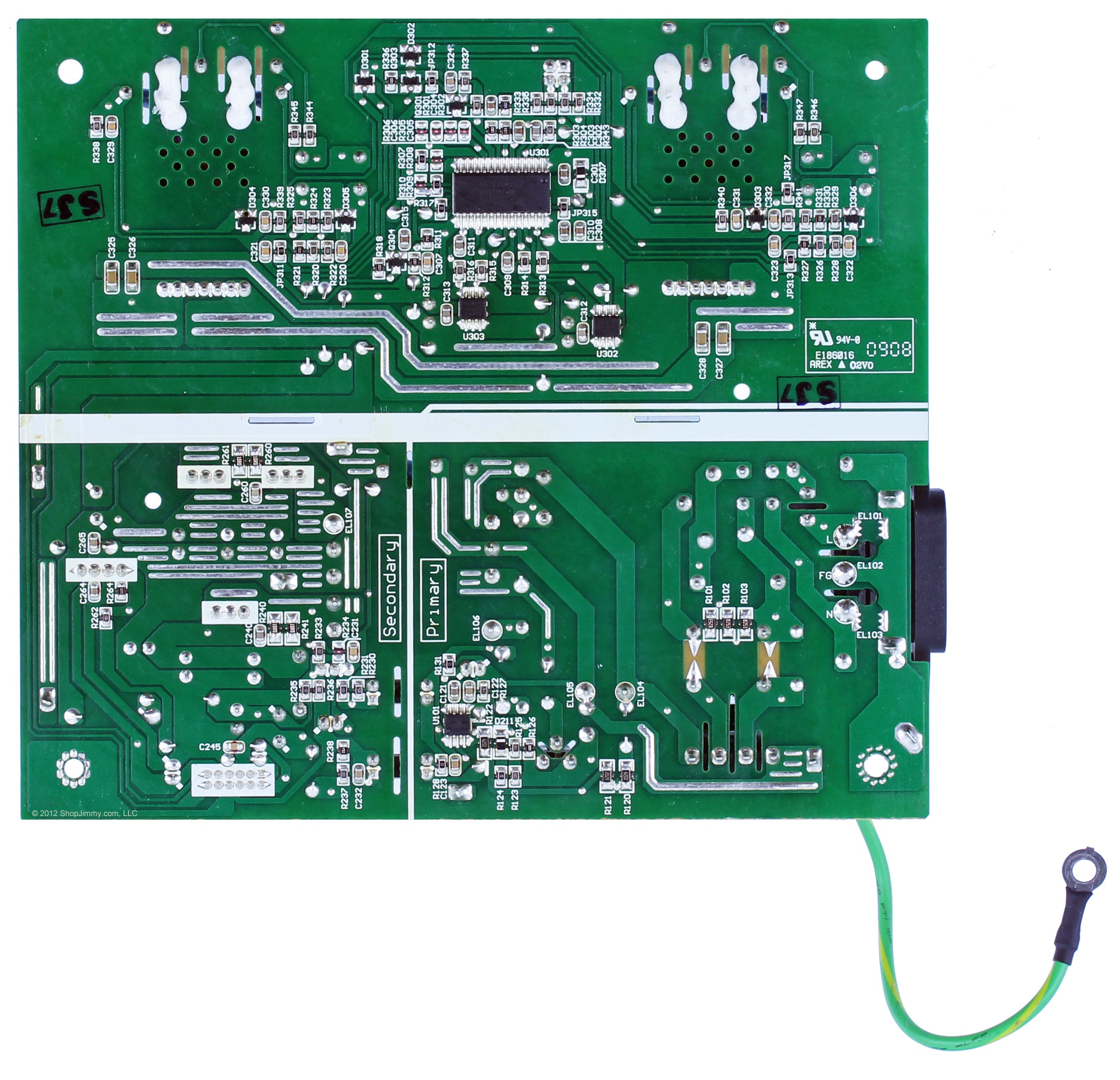

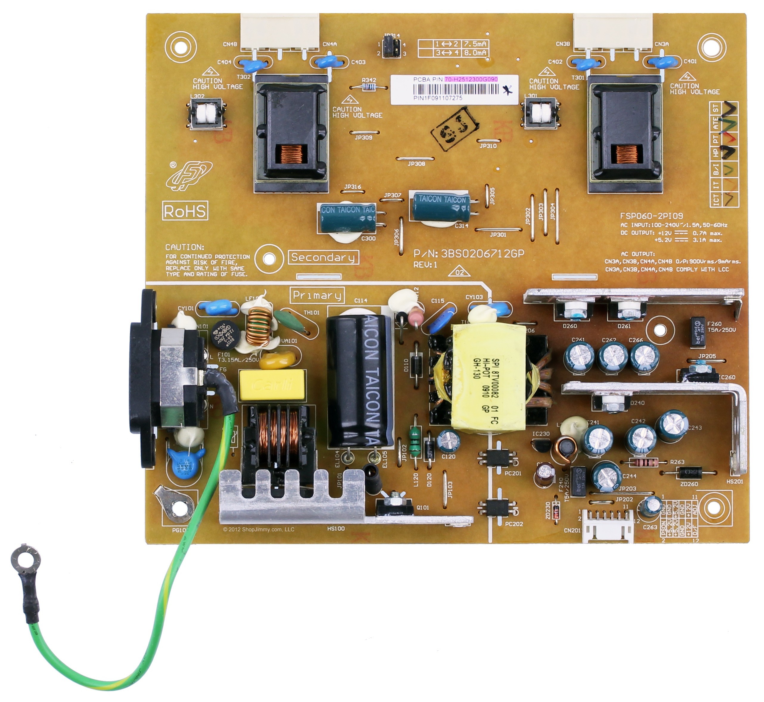

            Is C314 slightly bulged,or just the photo makes it look like it is ???
            • jetadm123
              • 2169
              Re: Hannspree HF257 2-3 seconds black
              Doesn't matter, since he using a stock photo from shopjimmy.
                Yes, Sorry about that. I was just using it for a reference as my cheap camera was not getting a good picture at all. I grabbed my mothers camera and got a better picture of my actual board.
                  They appear to be ok - we usually reckon they should be within 3% of each other - so you are well within that.
                  I think budm testlamp is the way to go - It is only a test though just try it for a minute or 2
                  to see if you can spot a weak bulb ( It may just be the wiring)

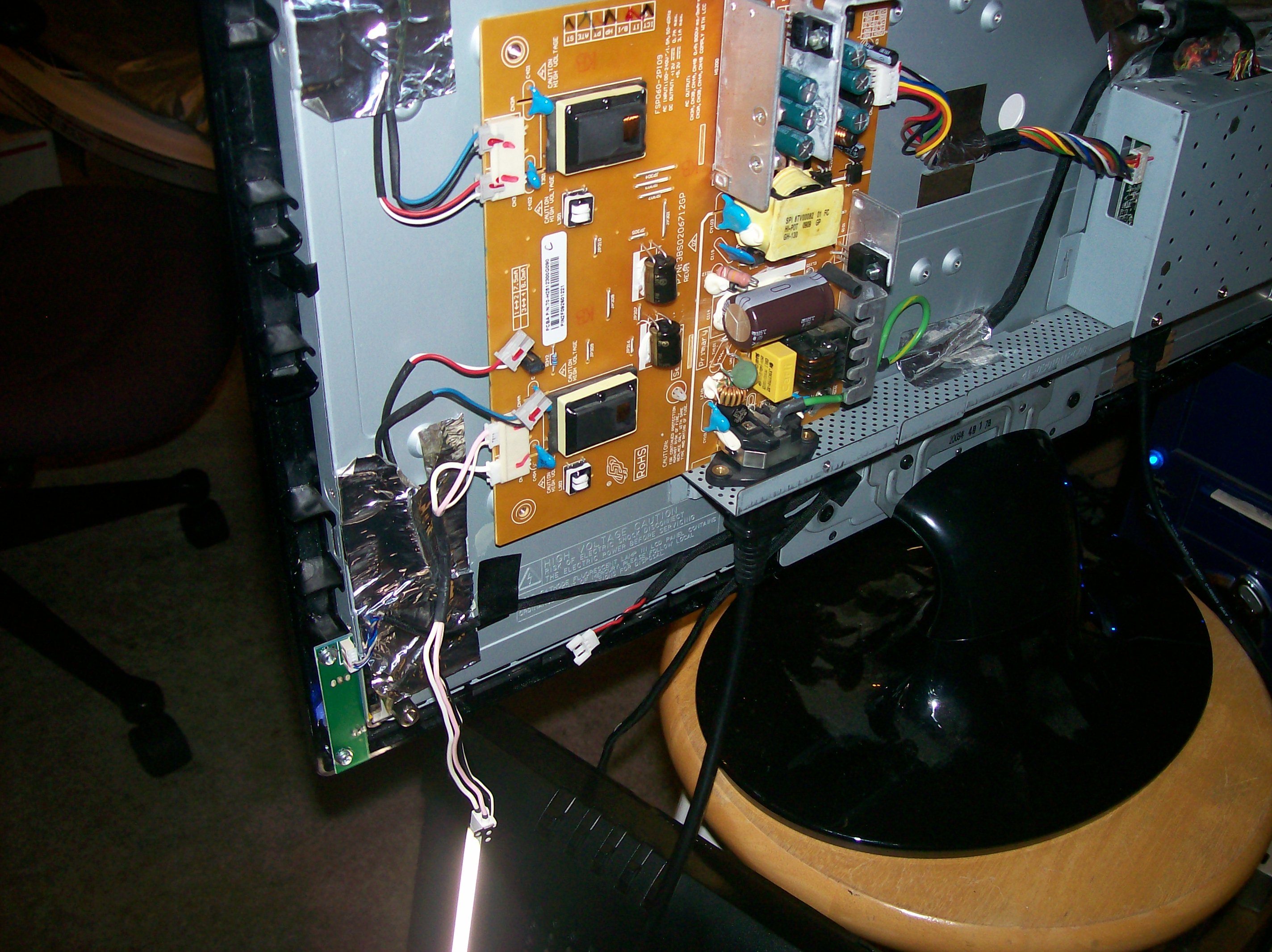

                        Well, after further inspection, looks like changing the CCFL tubes will be a piece of cake if I have too. Looks like I just have to pull the metal frame off enough on one end and they slide right out the side. No need to take it to far apart. I hope....
                        And it looks like ccflwarehouse.com has a relamp kit on sale for $30 right now.
                        I do wonder if it isnt a CCFL tube though cause I did have the flickering in the bottom left side of the screen and it was flickering for a good 10 seconds before I shut it off and turned it back on and then did it again for a few seconds and turning the monitor off and back on fixed it again for about 10 min then screen went back and thats when all this started.
                        I turned out the lights in my office and again fired up the monitor with the brightness turned way down and the lower portion of the screen does seem dimmer and there is an ever so faint flickering to it that I didnt notice when the lights were on in the room.
                        Just thinking out loud again.
                        Oh yeah, I did order all the caps from digikey. Plus my cousin works there so I was able to get her big discount on my $7 in parts. Saved like .25 cents. Plus living in MN and digikey being about 3 hours away from me, I dont think it will take long to get them.
                        Really stuck at a crossroads here with the ccfl tubes. Will report back once I recap it.

                            Well, further inspection I can not just slide the CCFL tubes out so I am going to getting some tubes from a friend to hook up and see if if hooking up a good tube works and if so, then I will know if it is a tube of not. Really leaning that way. I did re-cap the entire board and I dont know if the new caps cause this but now I cant turn the brightness up past 11 or it will go out as where before I swapped the caps I could turn it up to about 17 without it going black. I did triple check all of my solder connections and they are all seem to be good.
                            The bottom portion of my screen does seem dimmer then the top. I will report back hopefully tomorrow when I get the spare CCFL tubes to test the inverter side of the board. If all test good, I will attempt to change out all 4 CCFL tubes. Hope its not that tough. lol

                                Well, I have officially figured it the problem and was really hoping this wasnt it but it is. I hooked up a good pair of ccfl tubes to the board and its been on 100% brightness for about a half hour now. Good news it the power supply/inverter board has all brand new FM series caps on it. I can solder really good and change caps and other stuff like that but this taking the display apart has me a bit nervous but im going to give it a go. Dont really have anything to loose.
