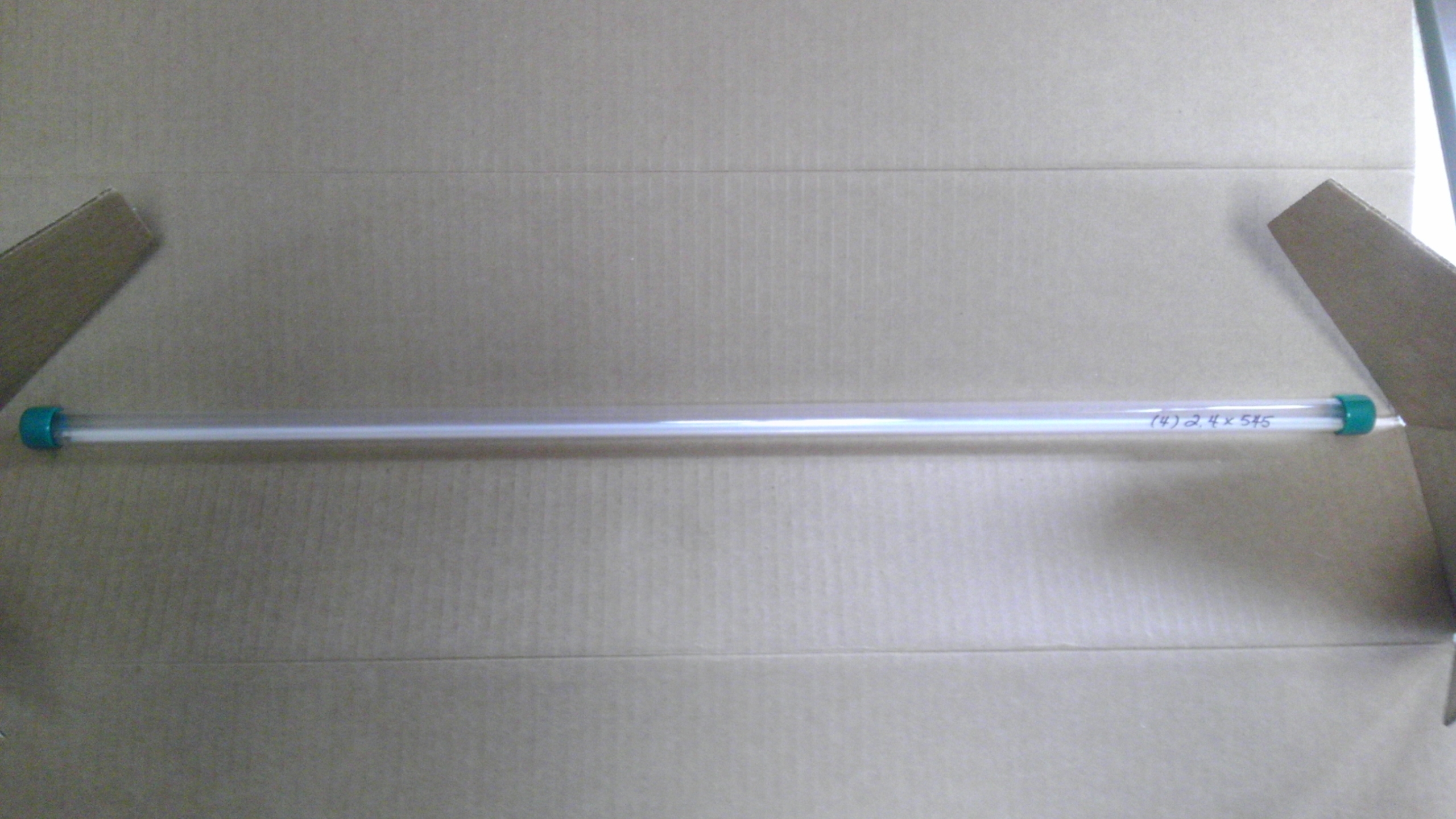

      Re: Hannspree HF257 2-3 seconds black
      Well, got my replacment lamps today. That was fast considering I ordered them Wed afternoon and Thursday morning they were shipped out and I paid for the cheapest shipping from USPS.
      I will tackle this later today or tonight. Depends if this kiddo of mine takes a nap today or not. Im not going to attempt it with the chance of my 3 1/2 year old distracting me. He did good watching me recap the inverter board but thats nothing I havent done before.
      I will also try to either get video or plenty of pictures but thinking video will be best so I dont have to stop and take pictures all the time and end of forgetting something.

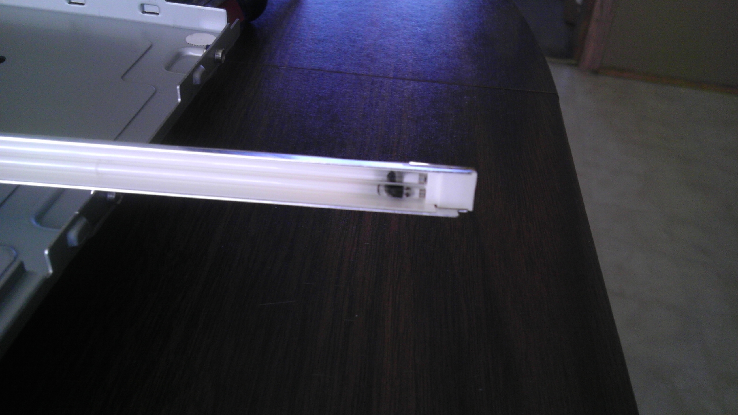

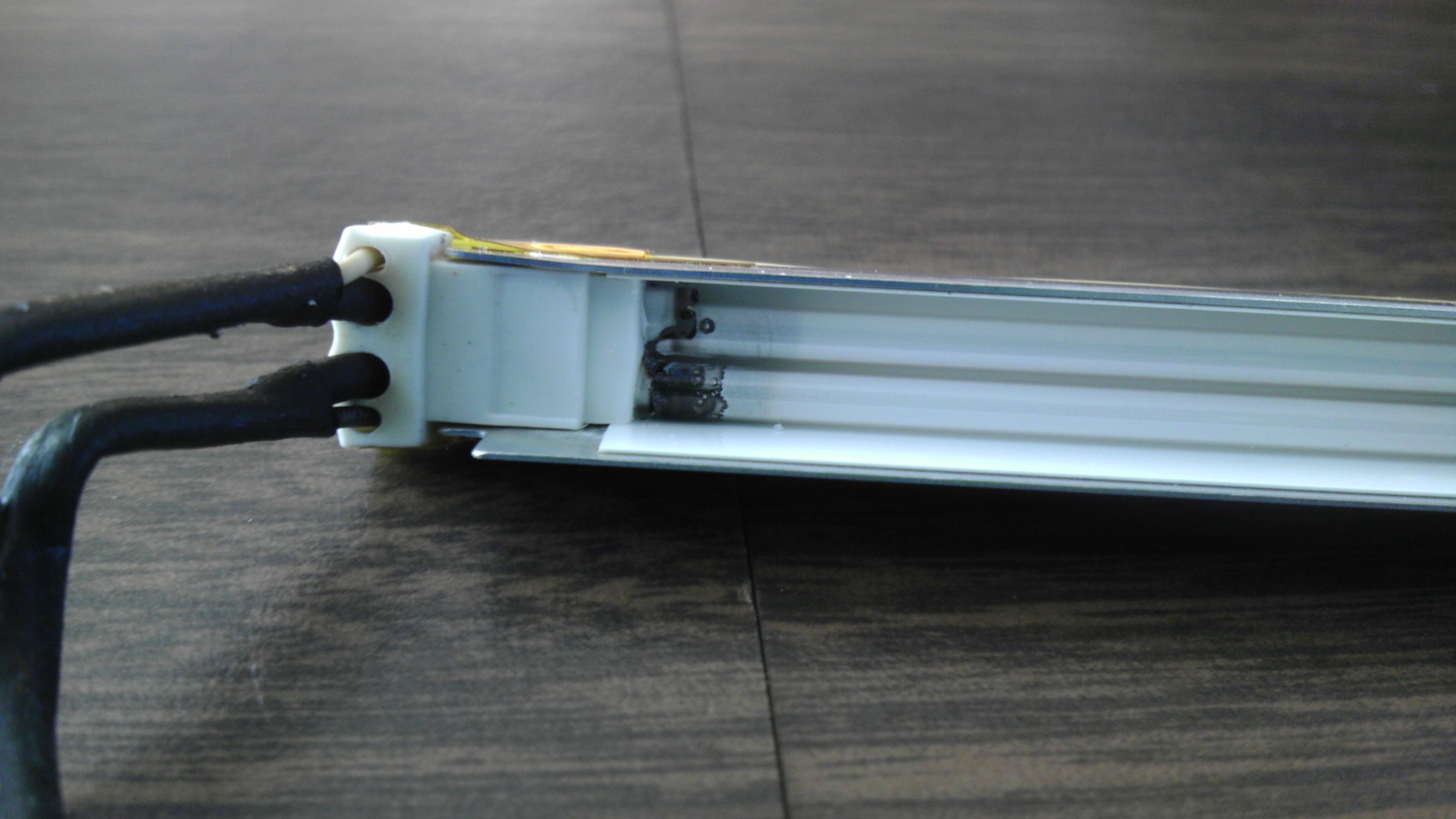

          Well, got it apart and actually was very simple to get them out but as you can see on the bottom 2 bulbs...
          Yes, the are both broke on the one end with the wires showing.
          I didnt take any pictures of the top 2 but the one has some blacking on both ends but not near this bad and the other one looks fine. I will see how changing out these 2 go and then see how ambitious I feel about doing the other two.

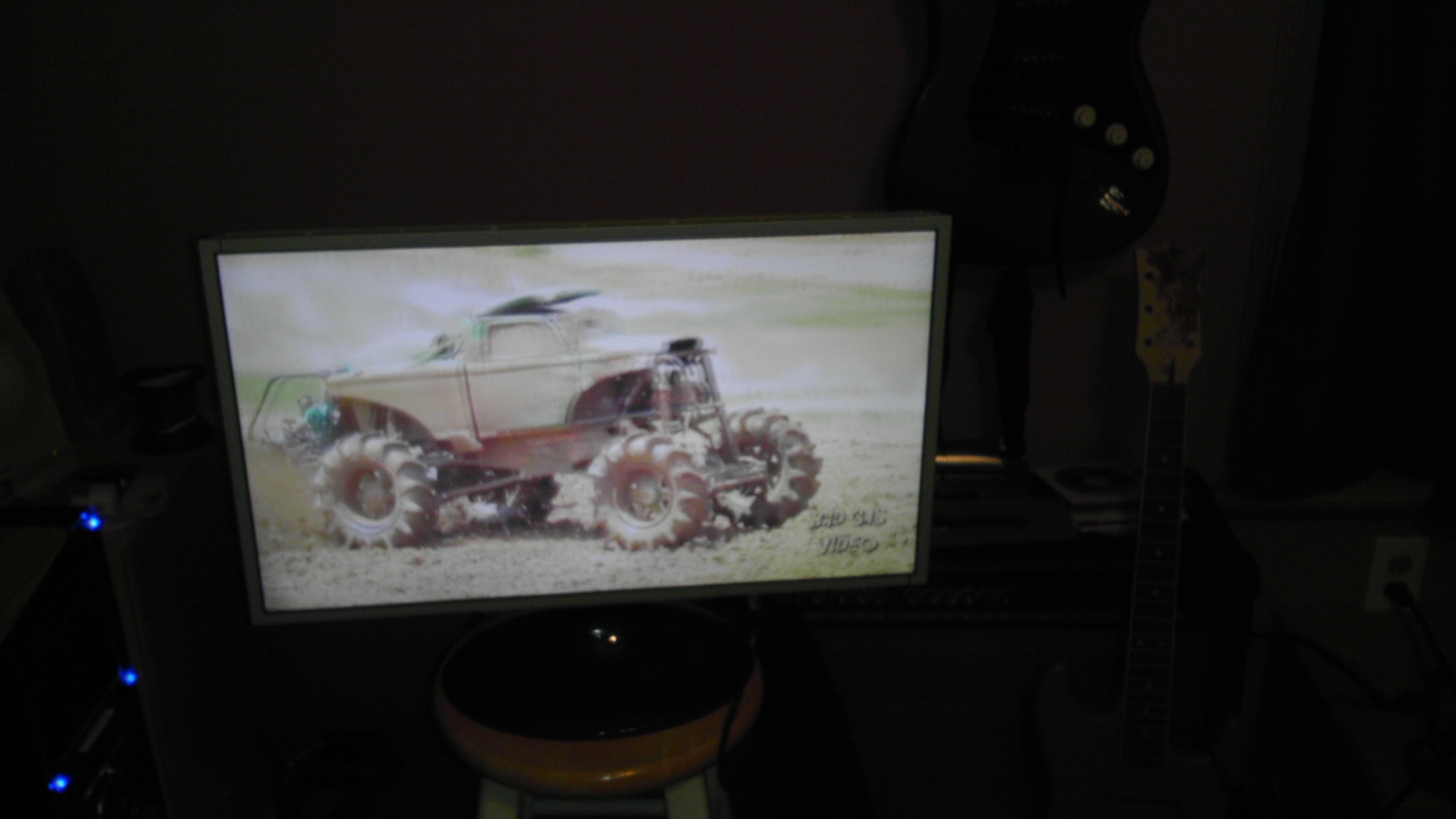

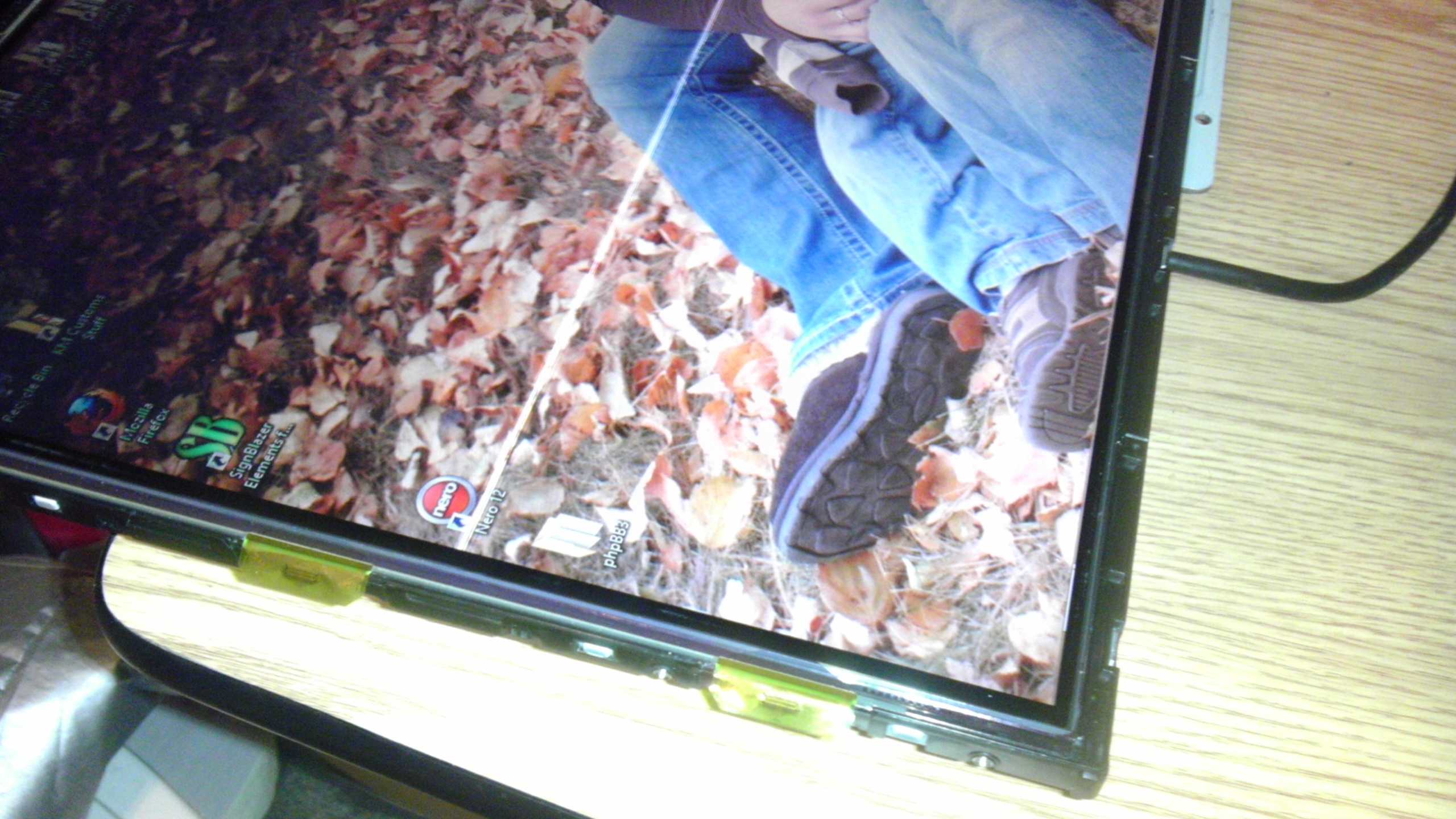

            Just great! Got the bulbs fixed, put it somewhat back together and when putting it back together the metal frame holding the LCD panel in seemed to be a little tight but I didnt think anything of it and took it and fired it up and it worked beautiful for about an hour with no problems so I decided to put it back in the case and snapped everything back together and the frame seemed a tiny bit tough to snap together but seeing its tough to take apart I just figured that was that and put it on the desk only to now see these wonderful lines in the display. So I would barley push on the sides of the screen and they would kind of flicker so I decided to take it all back apart and there is 3 parts of the LCD that or sticking out the side bend over the edge (only 2 visible here) and well, I must have somehow missed it but the top one in the picture was folded up under the LCD display. All this work and now this... Kind of want to cry. And I dont know that it can be fixed. I was able to kind of wiggle that tab and get some of the lines to flicker and at one point almost had them gone but they came back once I moved anything again.
            Me - 0
            Monitor - 3
            Its bad enough I wont use it cause it drive me nuts. lol The other picture with the mud truck on it is before I put it back in the case and zero lines in the display.
