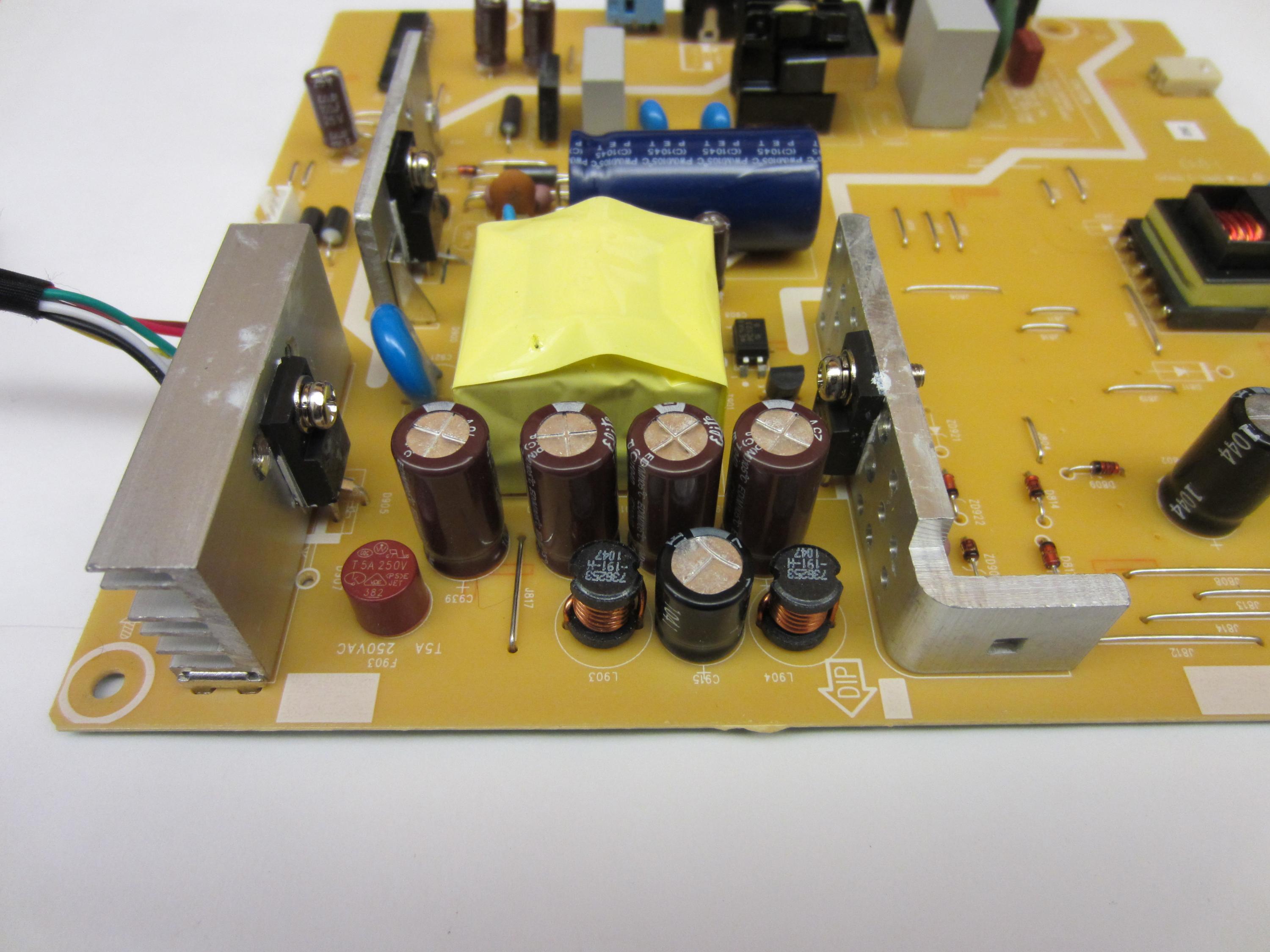

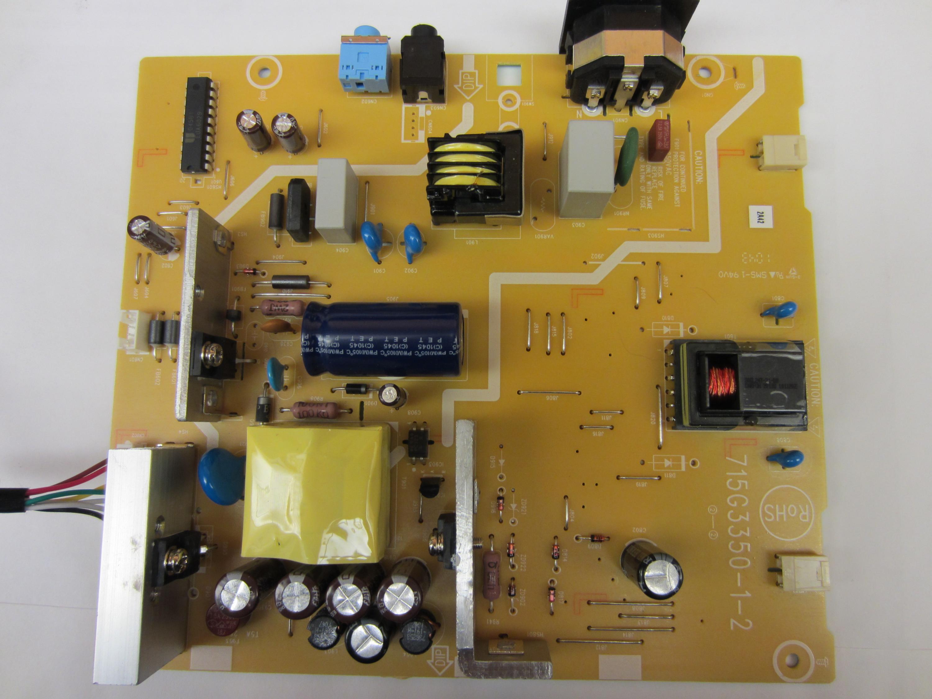

    I have an Acer V223w that just started acting strangely. It works fine for a while, then just shuts off. No display, no power light, but the PC still detects it as connected. If I disconnect the power cable for 5 minutes or so, then plug it back in, it will work just fine for a while, then it shuts off again. I was really hoping to find an obviously bad cap when I opened it up, but no such luck. Attached are pictures of the boards.
  • DerStrom8
    Techie
    • Dec 2012
    • 76
    Re: Acer V223w
    Perhaps it's overheating? It may have an automatic thermal shutoff when the temperature exceeds a certain point. Have you noticed it shut down any sooner on warm days, or later on cool ones? Does the monitor feel warm or hot to the touch before shutting down?
    EDIT: I just did a little research and learned that the issue is often caused by an unstable DC input, which is caused by problematic DC filter caps. You may not be able to see the problem, but it is most likely the reason for the issue. You may be better off to just replace the filter caps, even though you don't see the problem.

      Re: Acer V223w
      A cap doesn't have to be bulged or swollen to be bad. You didn't say how long the monitor stays on. If it's longer than a few minutes, try heating the board with a hair dryer to accelerate the shutdown process. This will help isolate the area that may be causing the problem.
      • wcoyote
        • Dec 2012
        • 14
        Re: Acer V223w
        Sorry I didn't give enough detail. The monitor was purchased as a refurb - as-is, no warranty. It worked fine for the first few months. It's no warmer than the other monitor that it is sitting next to. When it is working, it stays on for anywhere from 5 minutes to 30 minutes. The longer the power is disconnected, the longer it will work when it is plugged back in.
        Any suggestions as to which specific caps to replace? It may be a few days before I can try the hair dryer trick on it.

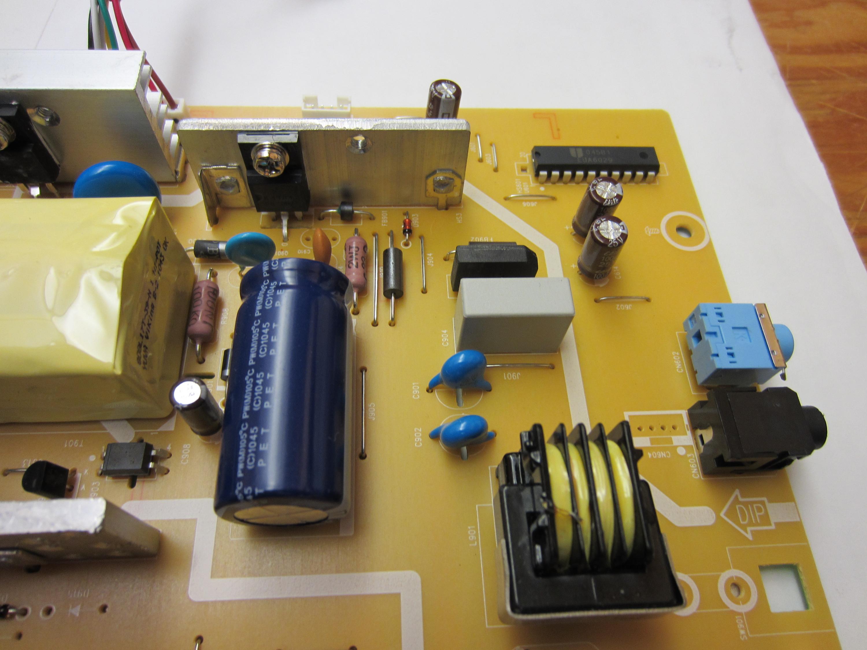

          Re: Acer V223w
          You might get away with the 4 elite caps- we would generally recommend replacing all
          except the Big cap BUT what make are caps with 1041 and 1044 on - the ends look like panasonic?? and if replaced when refurbished should be good.
          The idea of the hairdryer is partly to locate failing caps.
          • wcoyote
            • Dec 2012
            • 14
            Re: Acer V223w
            The 1041 and 1044 caps are HERMEI. All the other caps are Elite, except for the 22uf next to the big cap - it looks to be KY.

              Re: Acer V223w
              Hermei are not great either - replace as well.
              And the ky
              Replace all except the big one will give a good start to any repair.
              You should use good quality caps like Panasonic FM or FR
              Rubycon or nichicon
              • wcoyote
                • Dec 2012
                • 14
                Re: Acer V223w
                Thanks for helping a girl out. I finally got the replacement caps from mouser and installed them today. The monitor has been working great ever since.

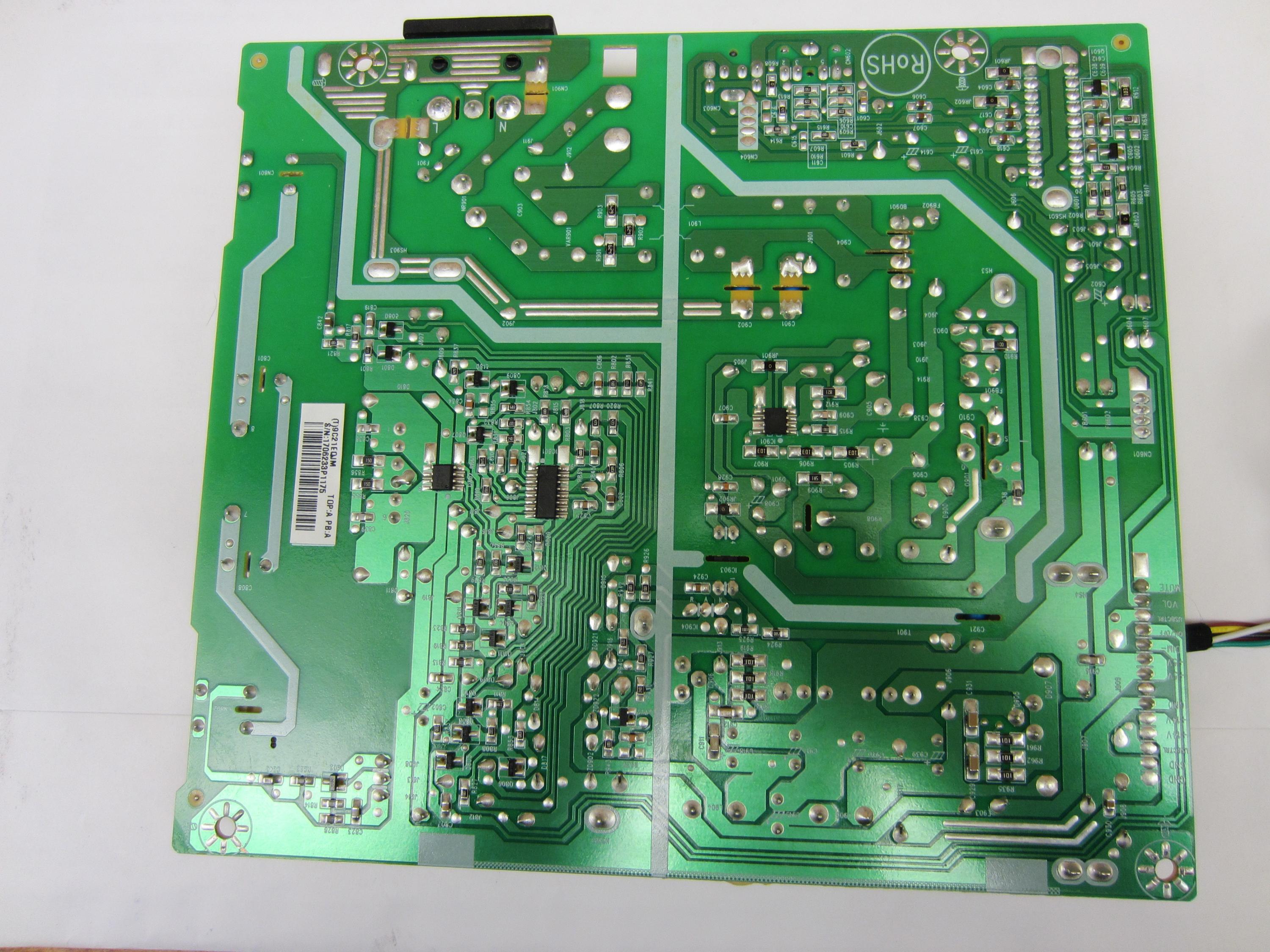

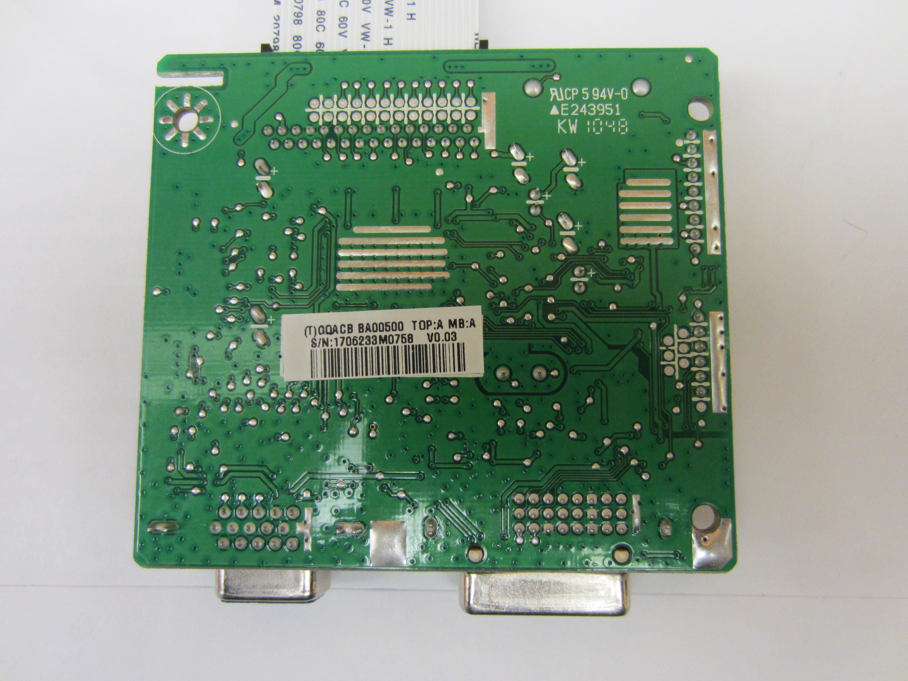

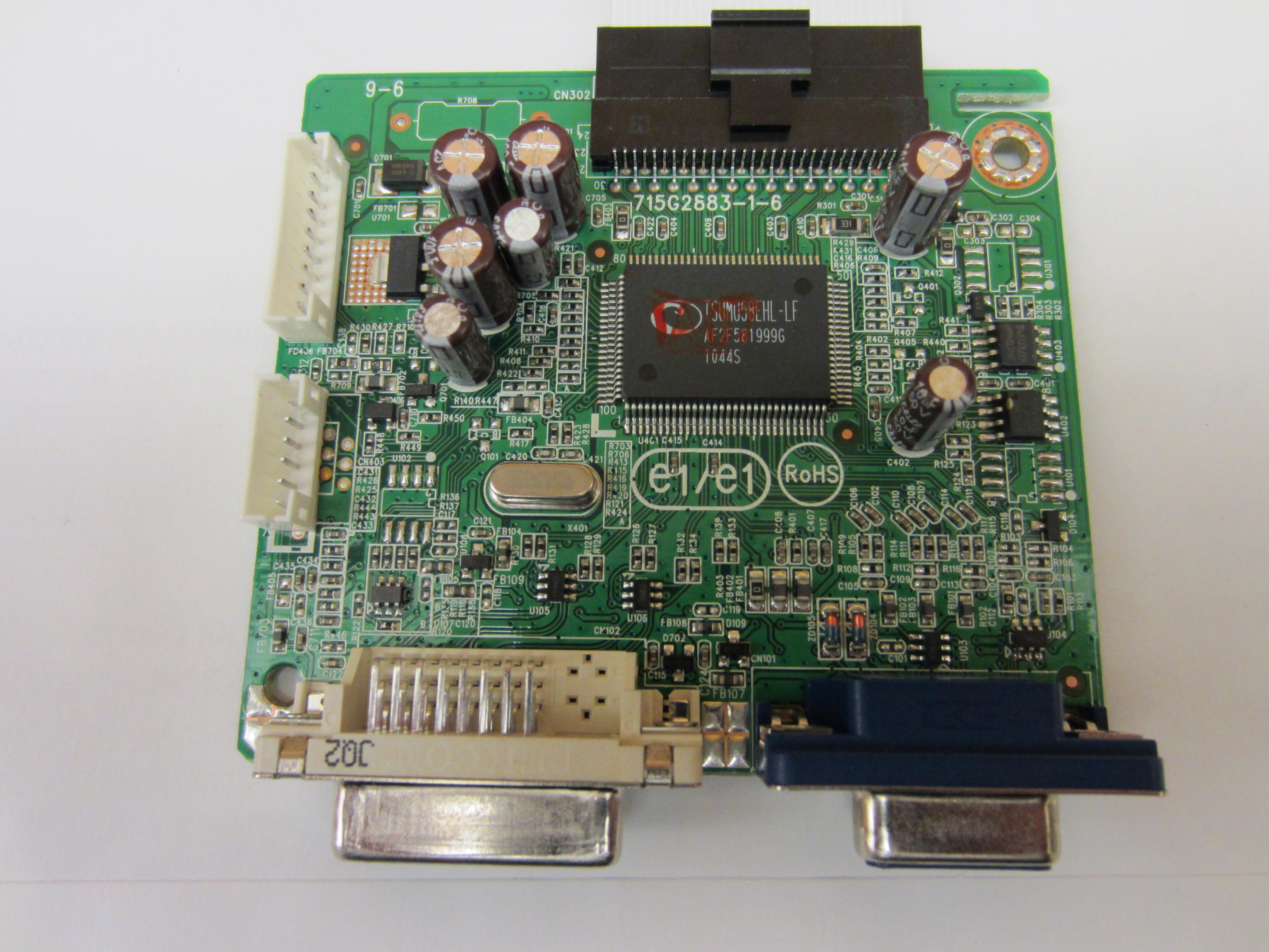

                      Hi - Yes please repost straight on front and back pictures.
                      please post good clearpictures of each board, front and back (in the same orientation) and close up of connectors, (max resolution 2000x2000 and 2MB) using the manage attachments button, which is found by clicking "go advanced" under quick reply.
                      Examples of what is needed
                      https://www.badcaps.net/forum/attach...7&d=1280167246
                      https://www.badcaps.net/forum/attach...6&d=1280167246
                      https://www.badcaps.net/forum/attach...4&d=1280167246

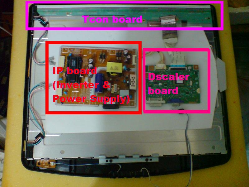

                                what is panel/t-con board...........i assume this is not the power supply board......is this the logic board?
                                • lexwalker
                                  • Feb 2011
                                  • 307
                                  • Malaysia
                                  Re: Acer V223w
                                  See attachment...
