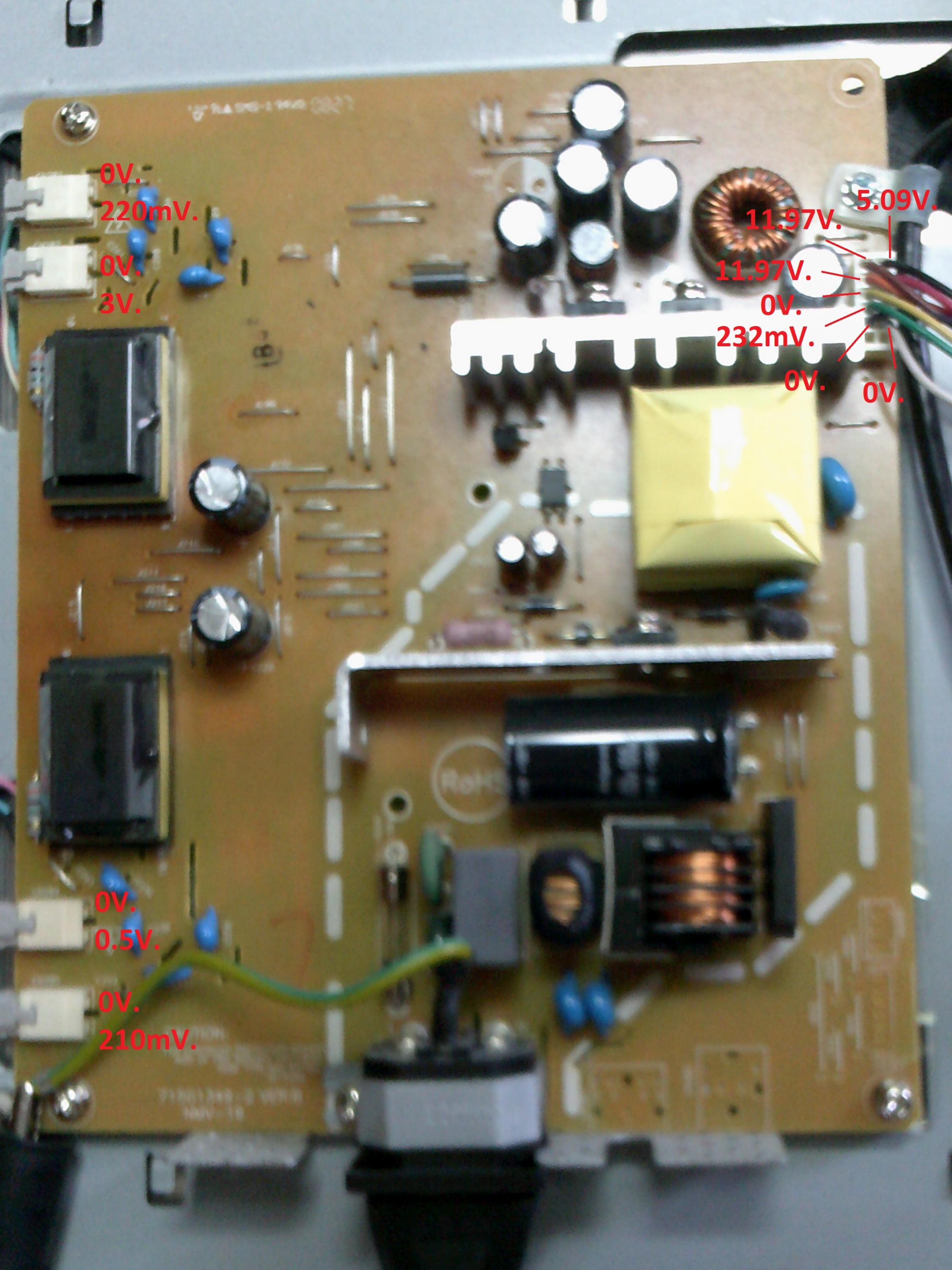

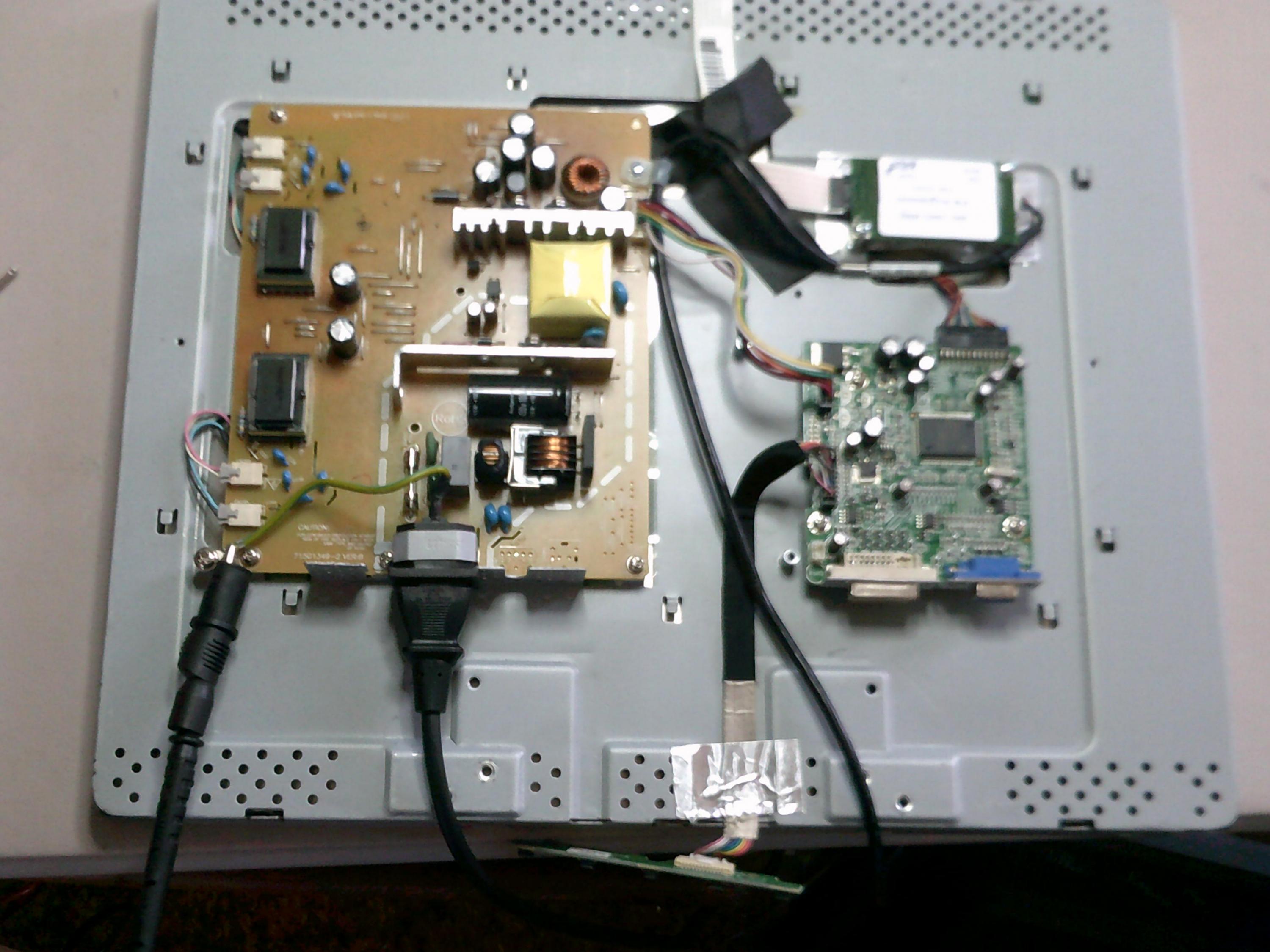

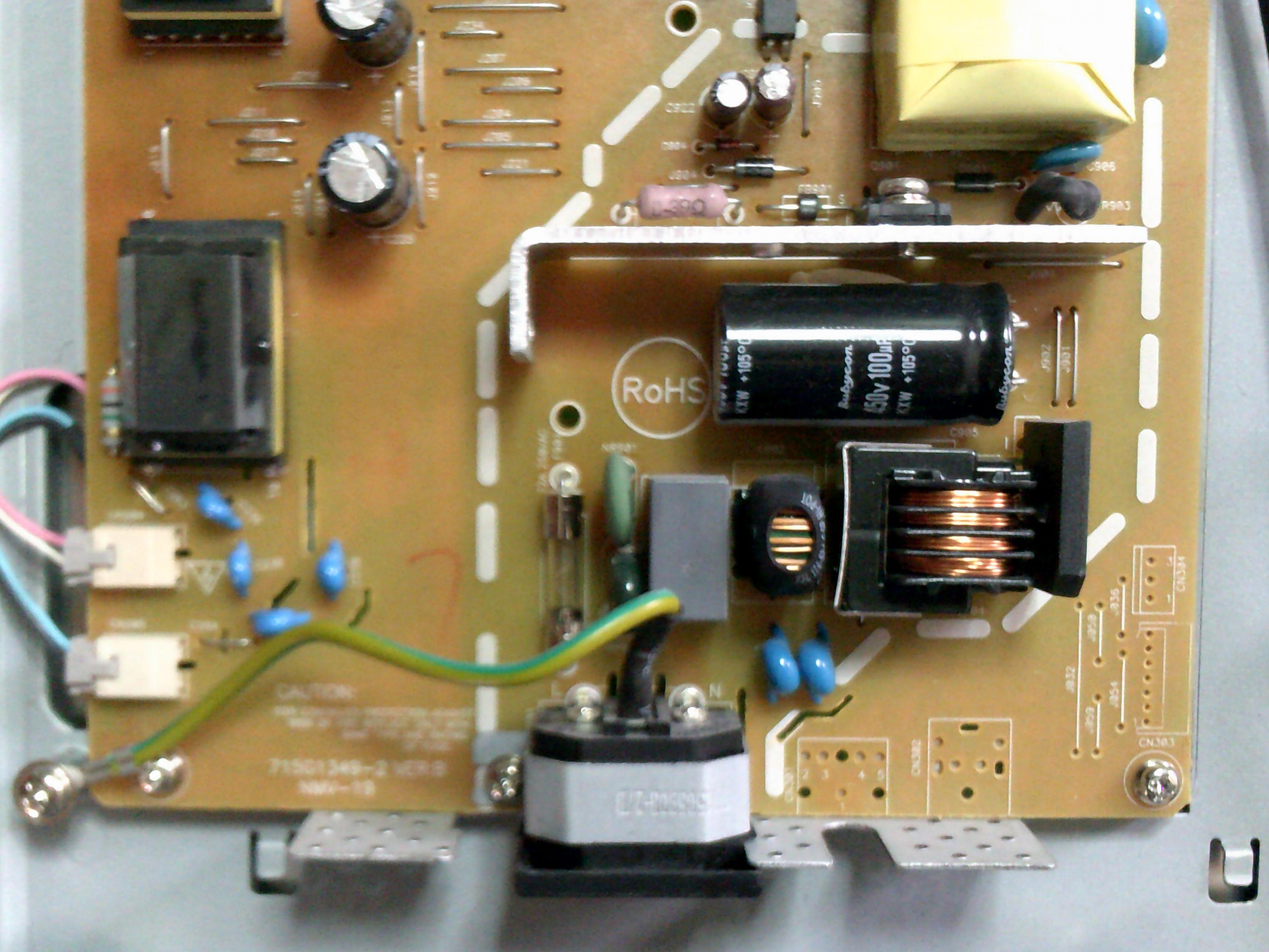

    I don't have a service manual and cant find any info on this monitor.
    I want to determine if this is a power board issue, backlight, or panel.
    This touchscreen monitor has standby.
    After pressing power on, the led stays green about 5sec. then turns solid orange and stays on.
    I dont see backlights or any display at all, not even a flash.
    I took some volt readings from power board.(results on pic)
    When I hold probed on the left side of board the voltage I read drops.
    I tried unplugging the 4 connectors on left side and powering on and I get the same resopnse from led(green for 5sec. then orange) except after a minute or so the solid orange goes off.

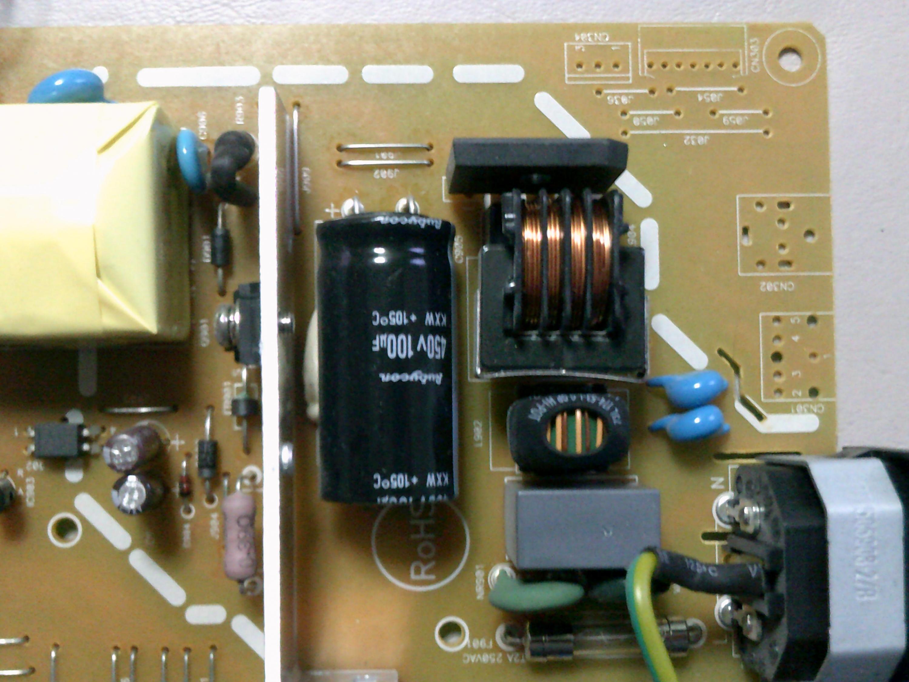

    Pictures fall into the same category as capxon caps.
      Re: Nec lcd195vx+bk

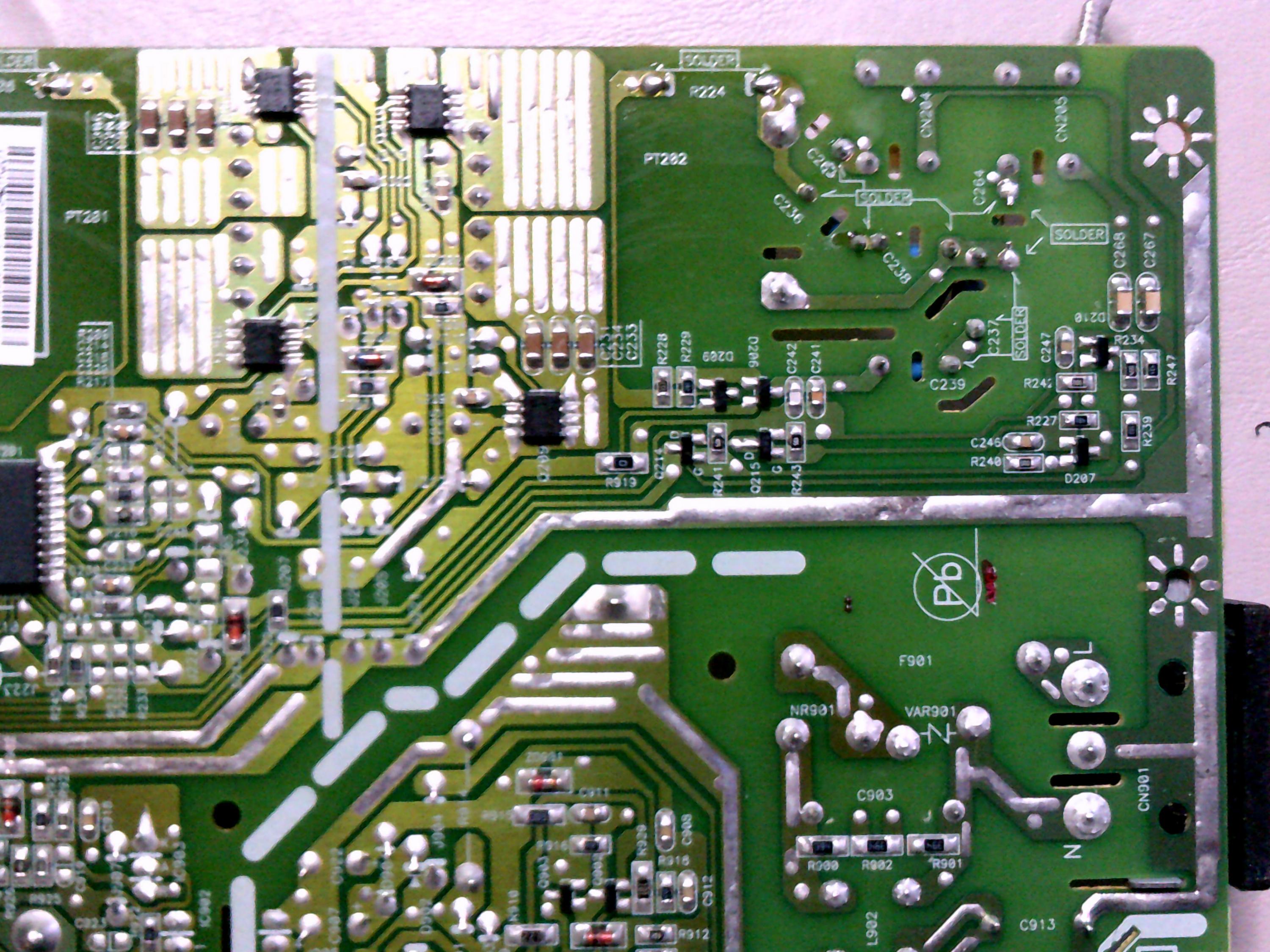

      Ok hopefully these are better. If you want to see something up close I can get better pics.
      when I take pictures on whole boards im in that range where macro doesnt work any better.
      Plus Im useing a cheap $40 camera but it is 12mp.

        Next time, don't even try to measure the voltage on those white connectors. You have 700-1400v and you may break your multimeter.
        5 seconds is a bit long of a time, it's most likely just the monitor going into standby as it detects no signal.
        Make sure you have some signal on the vga or dvi, turn the monitor on and see if it shows anything on screen.
        If you don't, try again but point a flashlight at the screen at an angle and see if you see some picture.

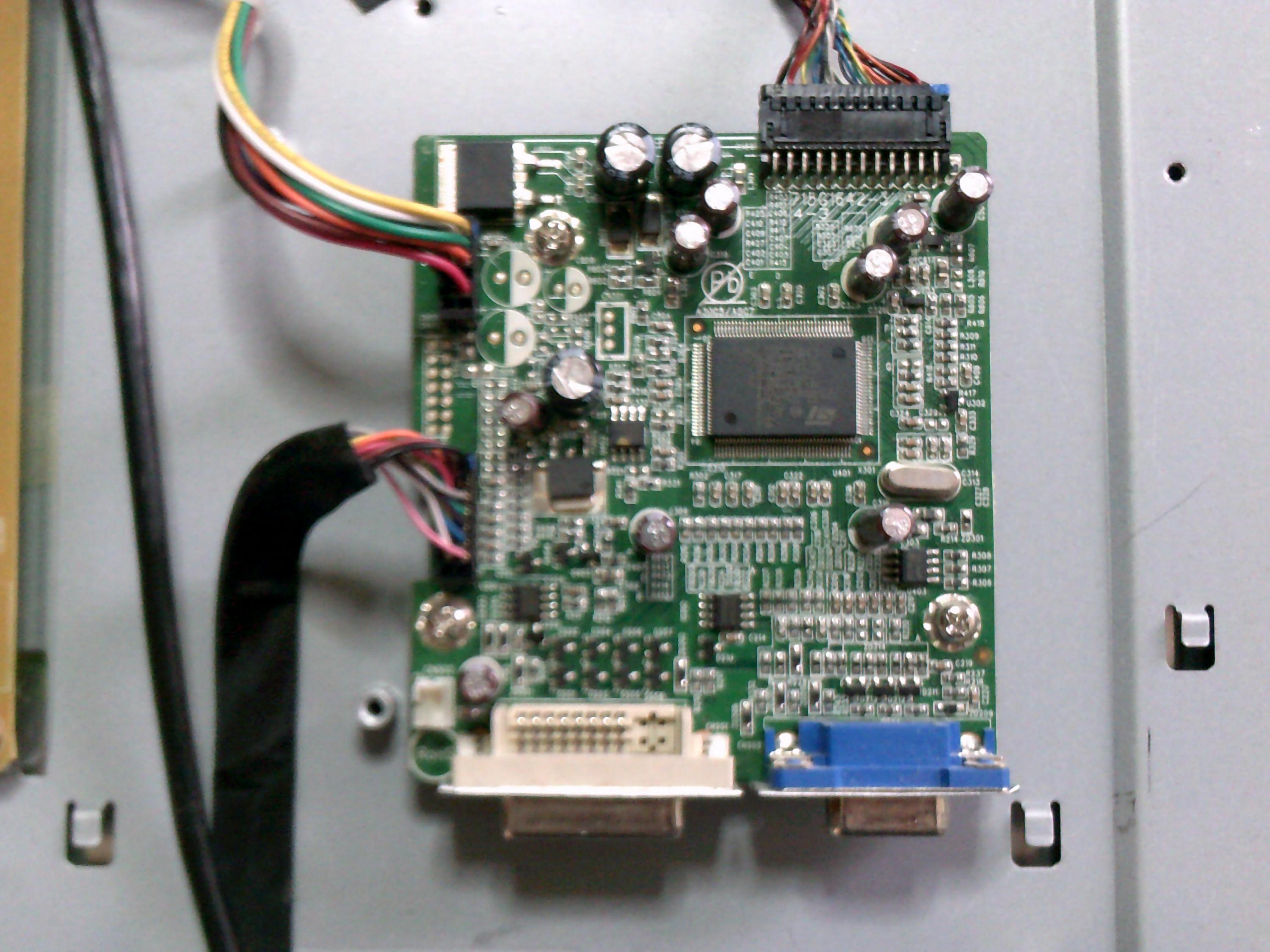

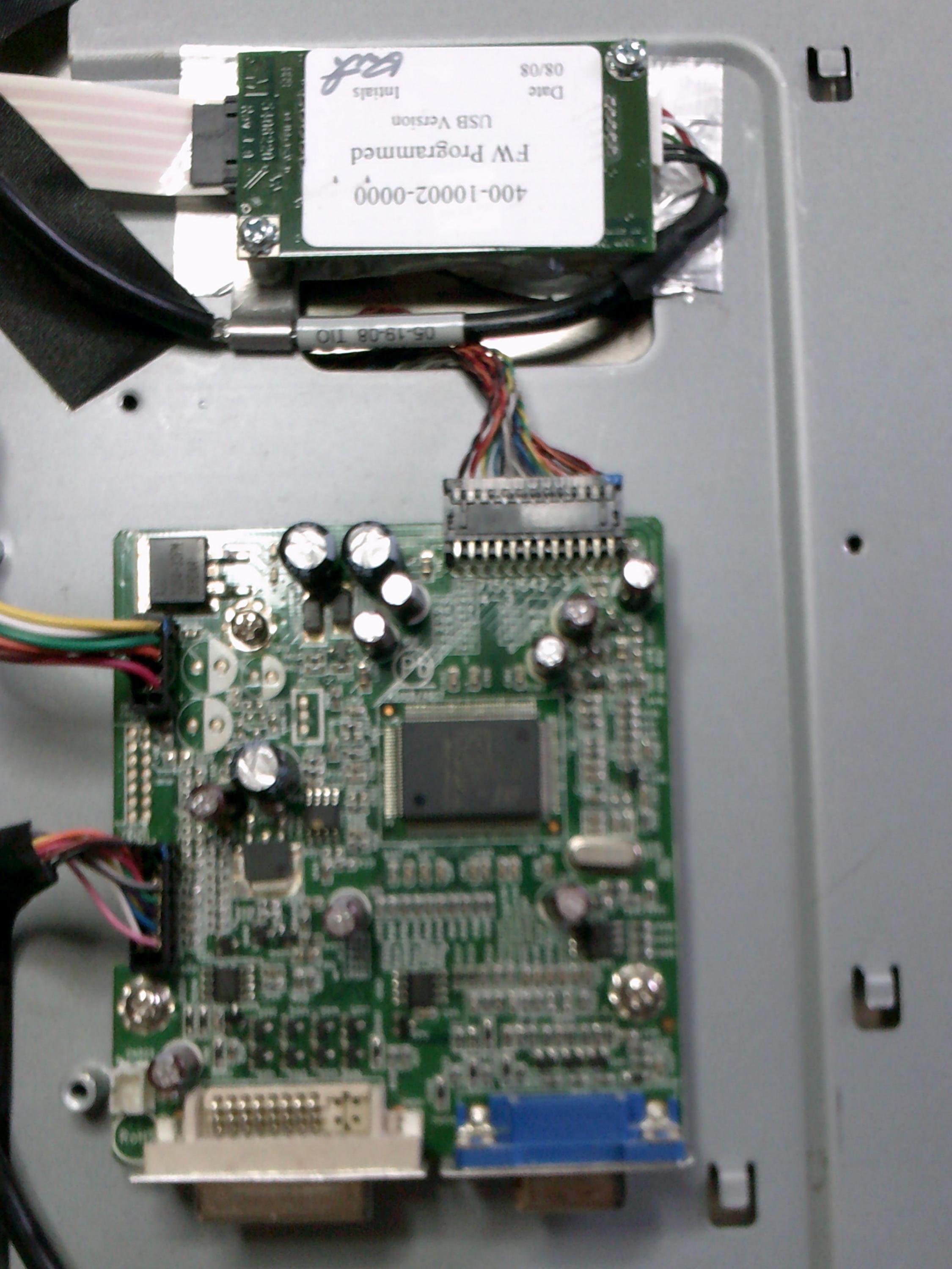

        In the last picture you have the display board. Check the voltages on the pins of two ICs, the ones with two pins soldered and a large tab soldered... one is on top left, above that yellow wire, one is below the two capacitors that are about in the middle of the board, between the two cables.
        Check the voltages when the led is green AND when it's orange.

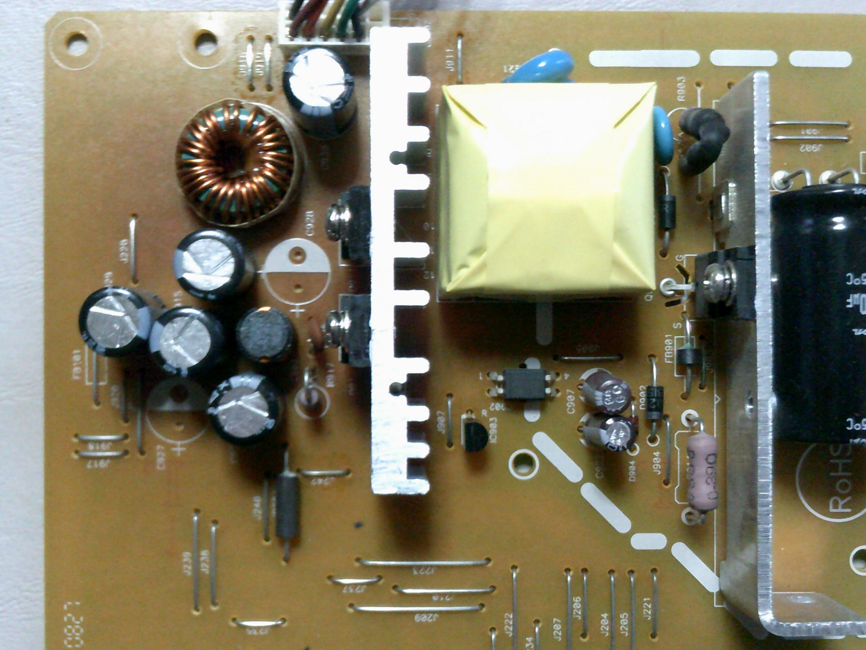

          not a lot - perhaps a samwha.

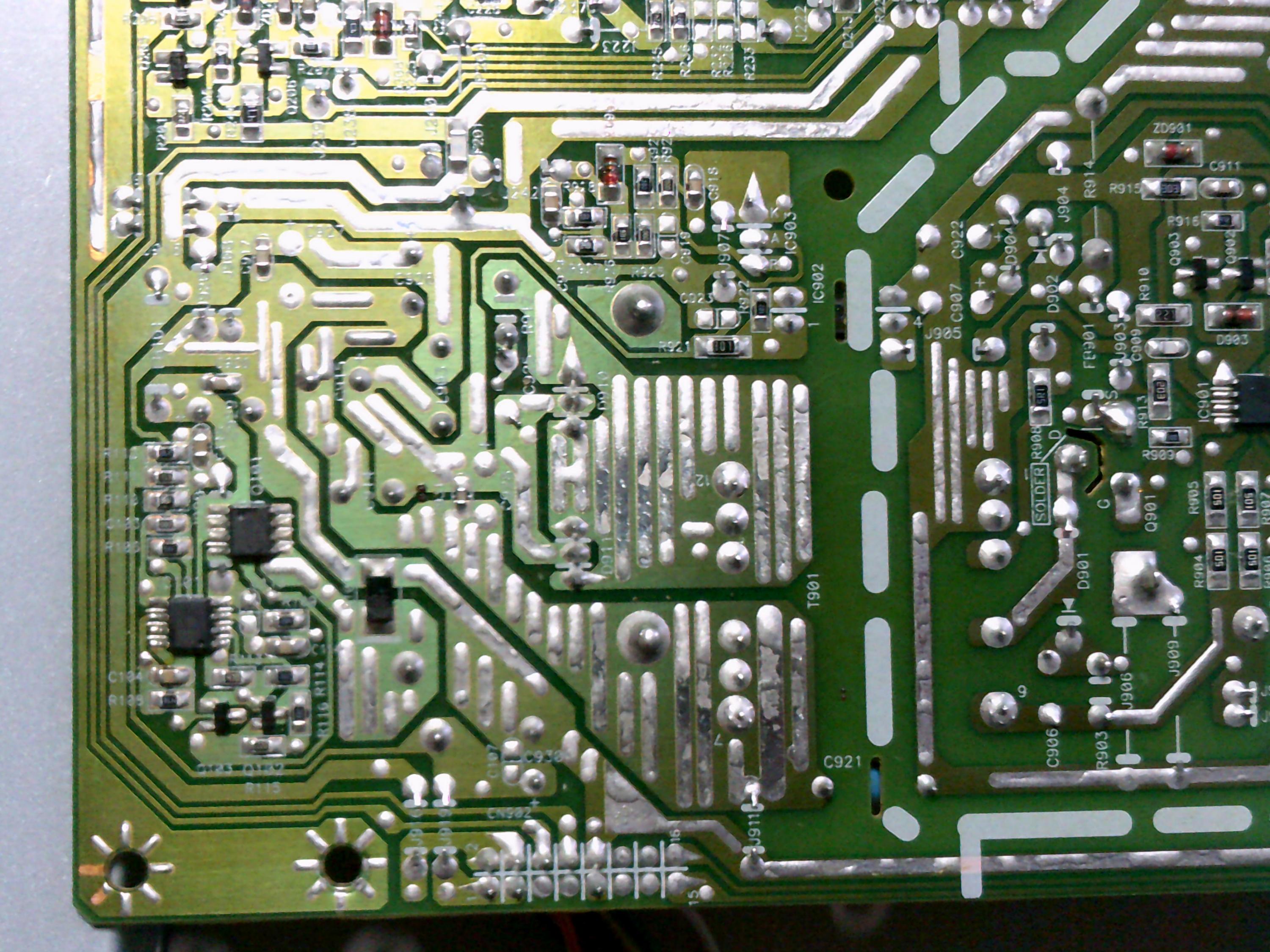

          The top of the power board looks like its been quite hot- we are going to need a panasonic grade picture of the back of the board. read this
          https://www.badcaps.net/forum/showthread.php?t=24612.
          Also what numbers are on the top of the inverter transformers.Big Black rectangular with yellow stripe

            Ok, first off I did get ahead of myself a bit.
            I hooked up to pc through vga, USB, and installed drivers on pc.
            Now screen comes on for 1 second and looks perfect.
            I can see VIDEO INPUT 1D-SUB on screen.
            front led stays green after screen shutsdown.
            the IC(AIC 1084-33PM) on upper left tested:
            -green led
            P1-0.0V.
            P2-5.06V.
            Lg tab-3.326V.
            -Orange Led
            P1-0.0V.
            P2-5.09V.
            Lg tab-3.325V.
            Left Center IC(AZ11170-1.8EI I think):
            -green led
            P1-0.0V.
            P2-3.565V.
            Lg tab-1.804V.
            -orange led
            P1-0.0V.
            P2-3.692V.
            Lg tab-1.803V.

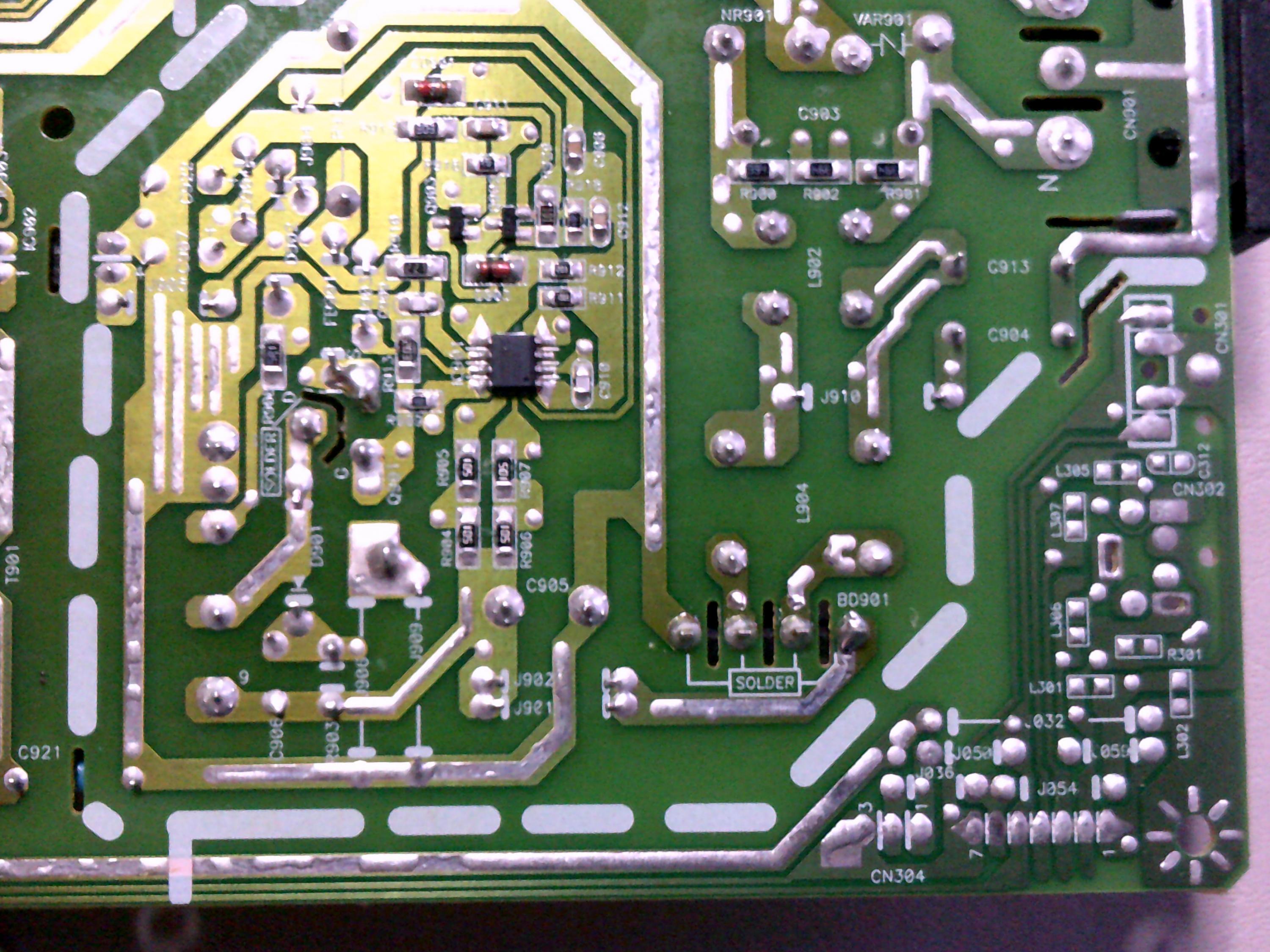

            Sorry I forgot to rotate pics.
            pic DSCF0005 goes with DSCF0009
            DSCF0006 and 10
            7 and 11
            8 and 12

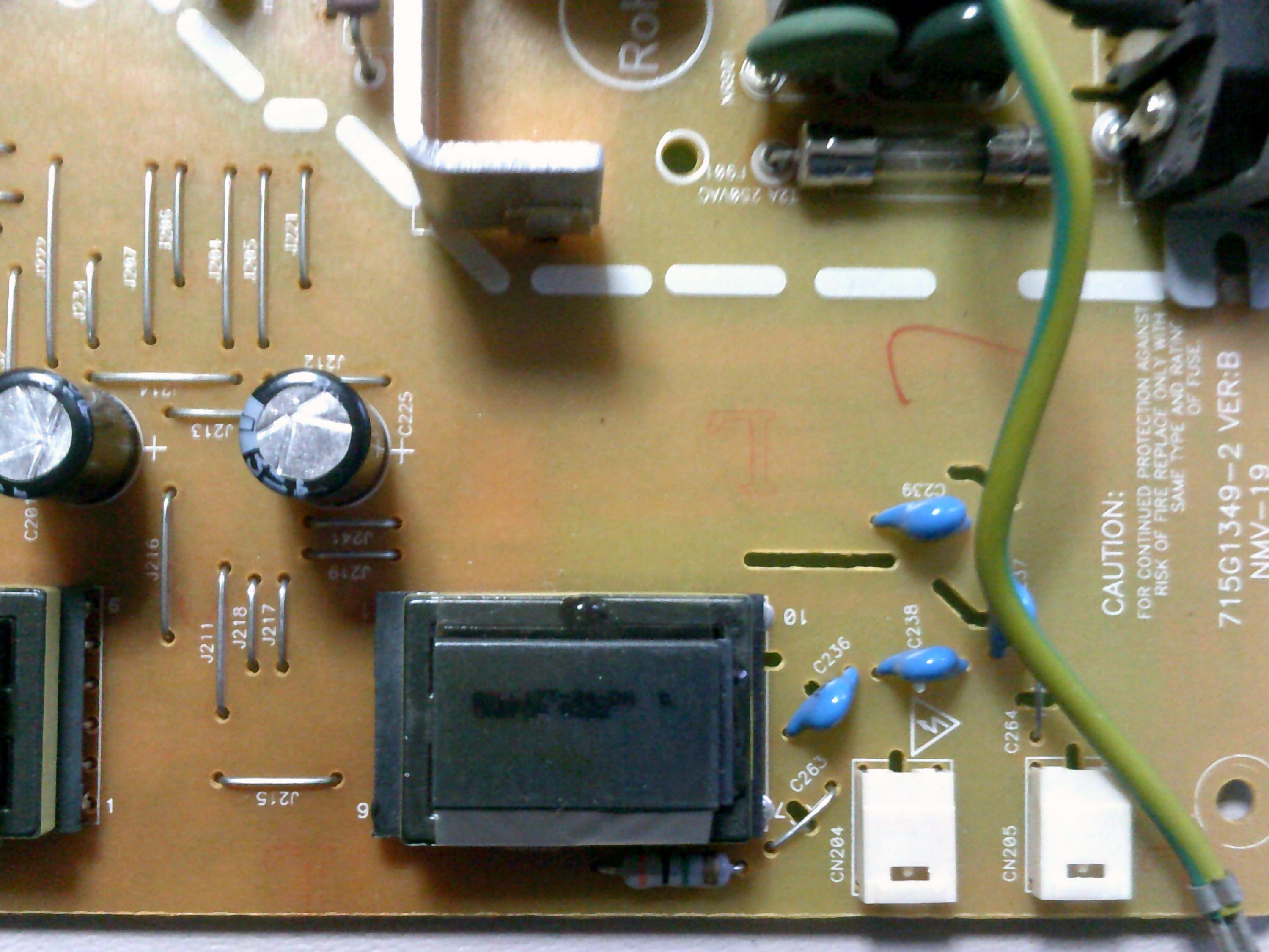

            Inverter transformer #
            80LL17T-24-DN G
            Darfon 8292
            I hope these pics pass Panasonic quality control.
              Re: Nec lcd195vx+bk
              They may now be good but I cant read the number on the transformer - that is why I asked for it.
              Anyway I have marked on the attached what I think should be the secondary windings
              on one of the transformers - I would have marked both if they had been in the same pic.
              POWER OFF Meter on ohms 2000 measure s1>s2 then find the same points on the other transformer and measure across those and post the results
                Re: Nec lcd195vx+bk
                I had to edit post above and add transformer #
                80LL17T-24-DN G
                Darfon 8292

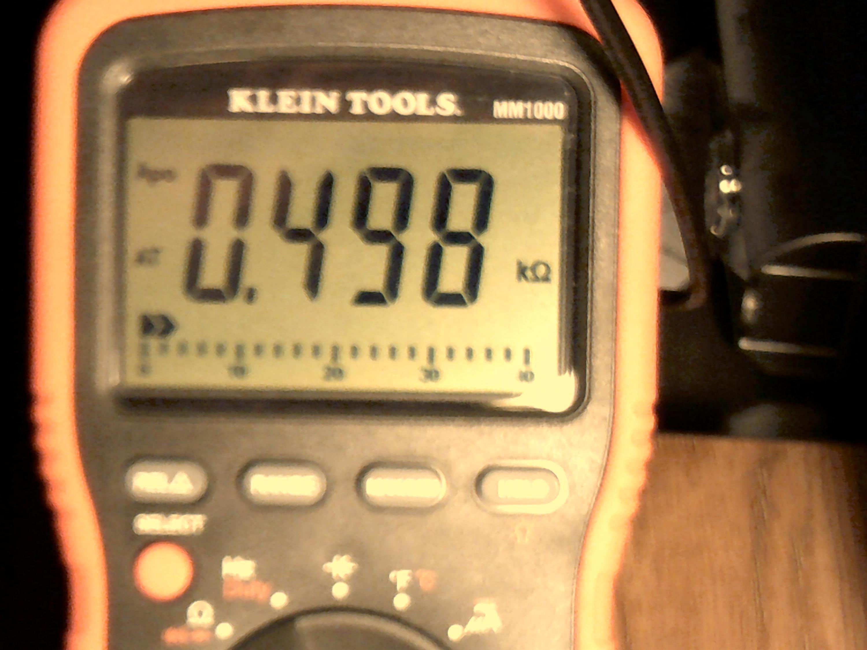

                I have to use autorange on my DMM but both tested .498kohm with board pulled.

                  Good but bad - they look good so we have to look elsewhere.

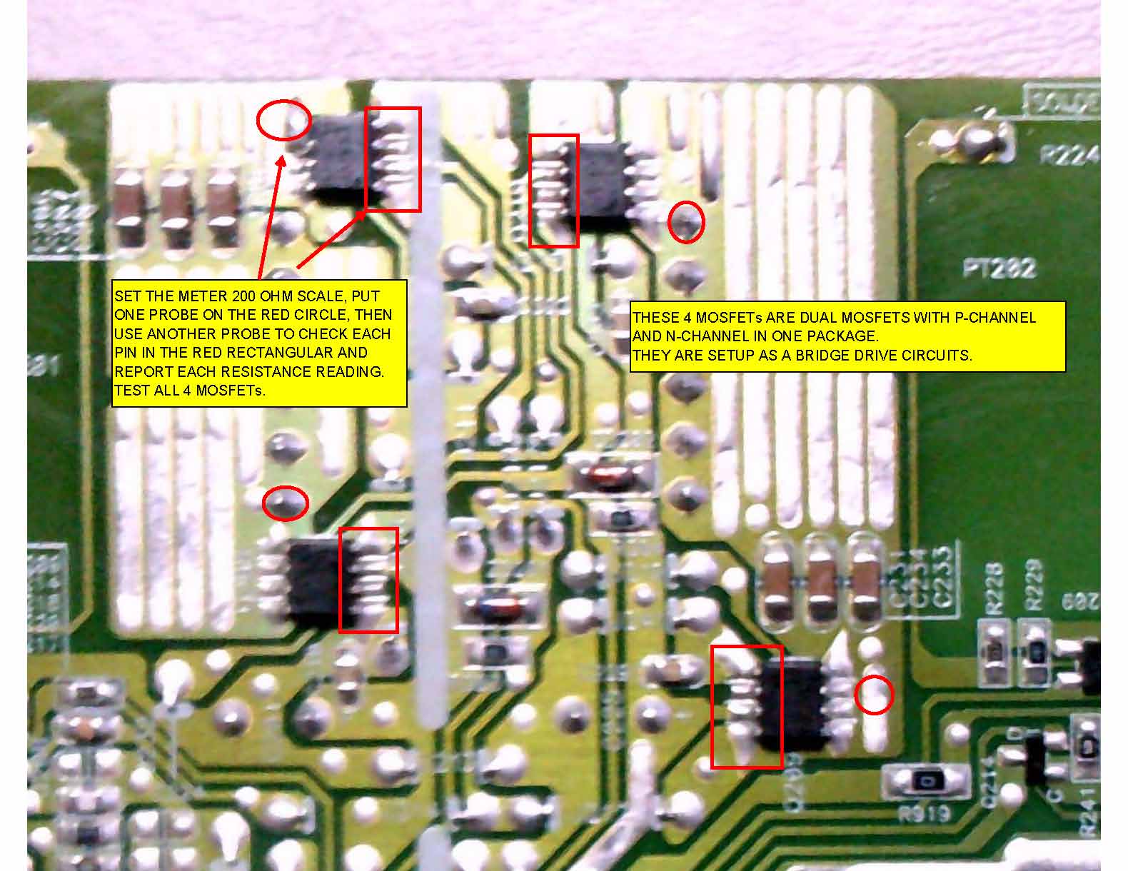

                  At the top of the picture there are 4 components 3 between the two transformers and one a bit lower. Can you get the number off them, search for a data sheet and test them. Tests should be in retiredcaps guide which you need to read if you have not already :https://www.badcaps.net/forum/showthread.php?t=10419.
                  Your earlier "led " voltage regulators? tests look ok - v at middle pin is quoted in part number.

                    Re: Nec lcd195vx+bk
                    the components you said to check are all the same part:
                    4512C
                    AA7YAJ
                    all the datasheets I find are something like AF4512C.
                    Im not sure if that will do.
                    If I cant find the right one can I just do resistance and check pin by pin?
                      I could really use suggestions for a better meter and Im looking for a decent in circuit esr capacitance meter
                      I'm not sure what you mean by "I have to use autorange on my DMM".
                      The Klein MM1000 is an autoranging meter by default. To measure resistance, you just set it to the ohms and it is done.
                      The Range button on the multimeter switches it from auto ranging mode to manual mode.
                      As suggestions for a better meter, what is wrong with the MM1000 and what do you want in a new one? What is your budget?
                        Nothing is wrong with it except I get asked to set it to 200ohm range The decimal point moves when I cycle through manual but I don't know which is equal to 200ohm range. My budget is under $80.

                            Please check these 4 MOSFETs.
                            The lamps or lamp's wiring can be the cause of the problem also, you will need test lamp to verify.
                              Re: Nec lcd195vx+bk
                              Ignore the set your multimeter to xyz ohm/volt range instructions.
                              They are for people with manual range multimeters. Your multimeter autoranges.
                              In post #7, selldoor assumes you have a manual range meter and asks you to set it to the 2000 ohm range. Since your multimeter auto ranges, it will properly give you a reading of 498 ohms without you having to switch to manual mode. Trust me, most of my multimeters at home are auto ranging and I never use manual mode.

                                        I tested mosfets and posted results on pic.
