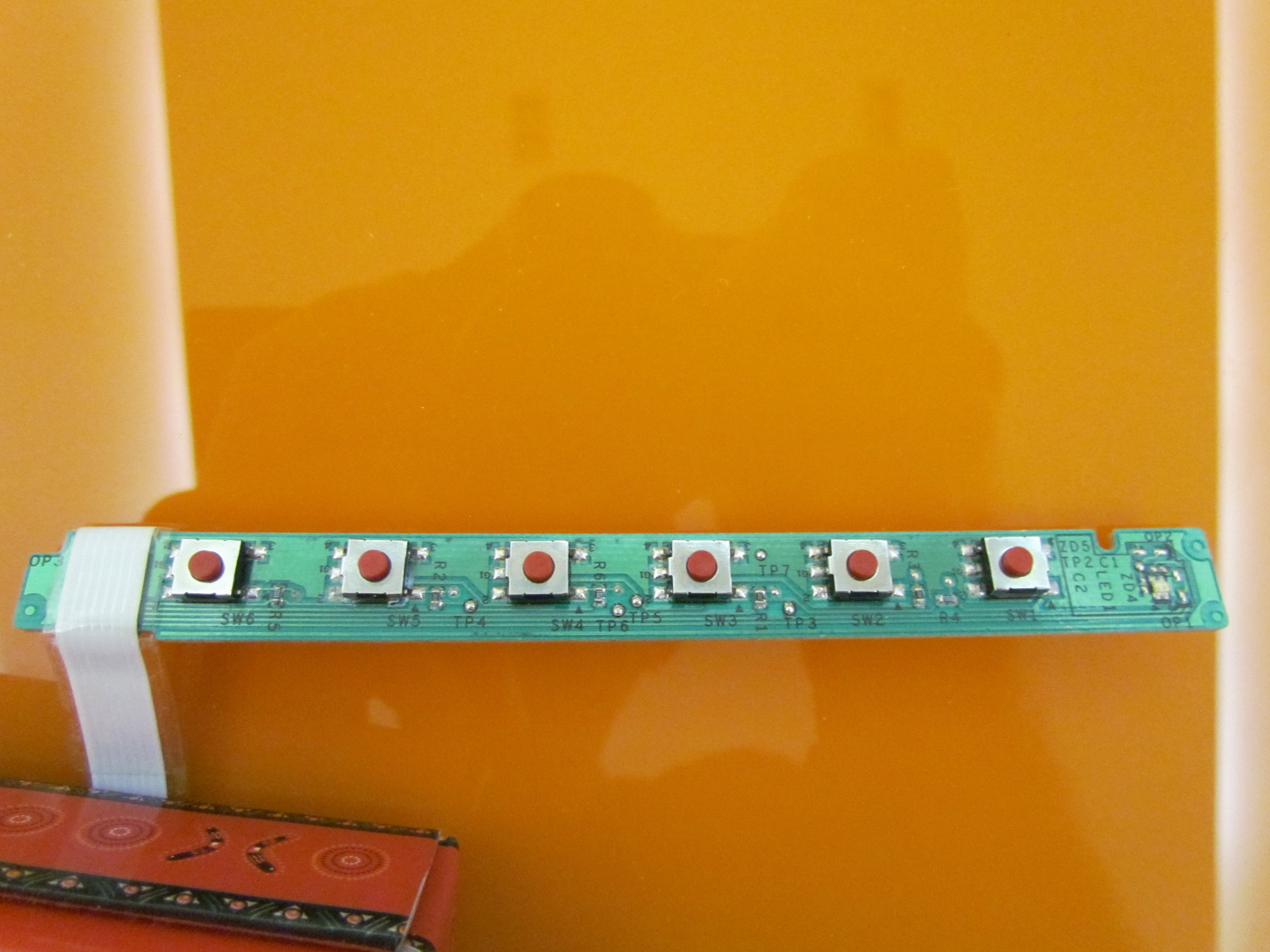

                    On another tack have you tested what I think is the buttonboard cable a flat ribbon 7 connectors on the main board- Clean the connection - make sure it is in the right way and check the traces for continuity - also find which pin/s are the on/off and perhaps a pic of the button board?

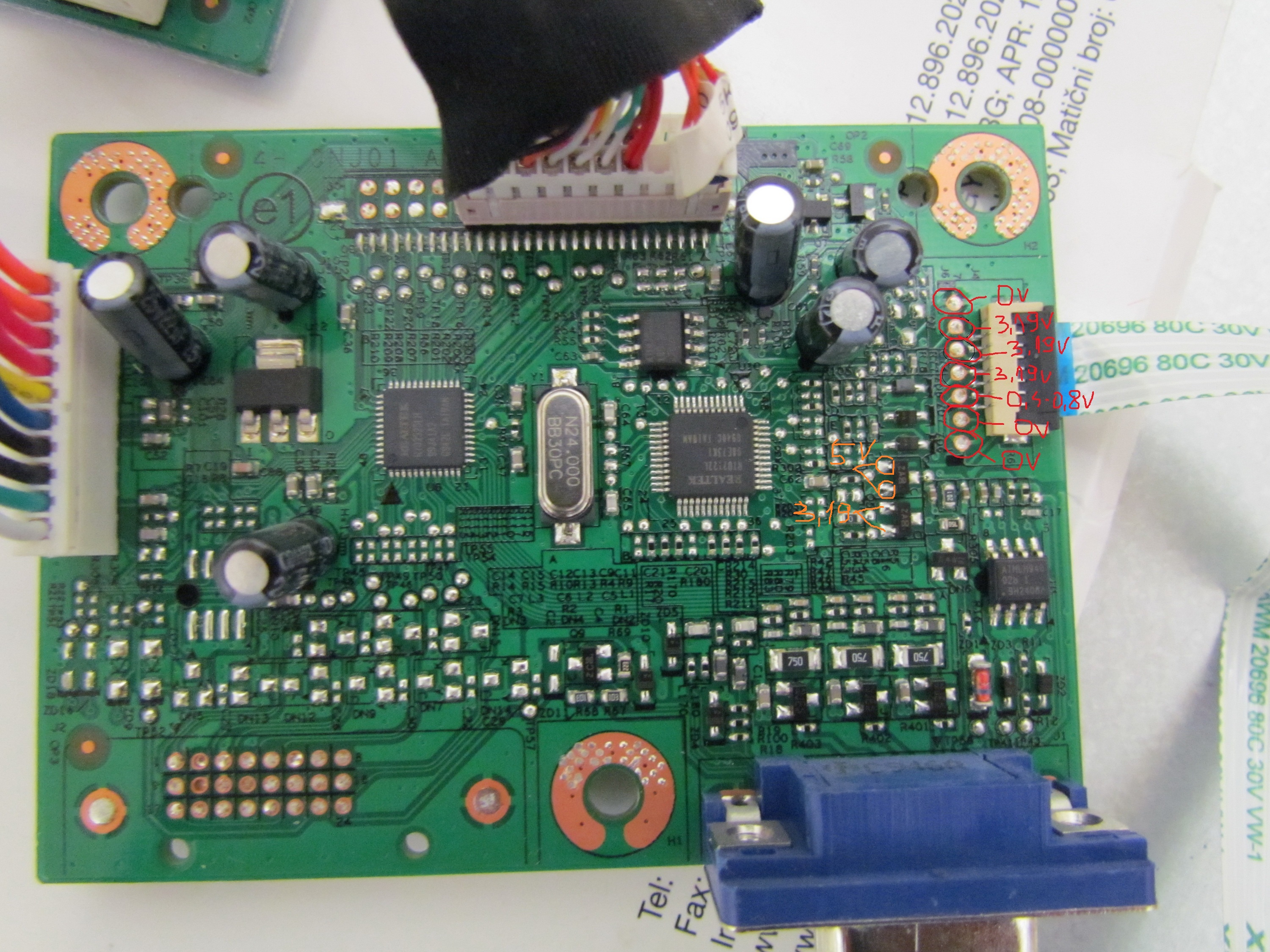

                      I checked cable for continuity and connectors are clean and on right way on their place.
                      Also power button looks fine. I checked it with beep sound and there was beep when I pres the button.
                      All resistors has good values on button board.
                      On picture of logic board I wrote values of voltages.
                      On third pin there is variation of voltage from 0.4-0.8V.
                      I assume that is on/off pin. Are those variations normal?
                      It looks like that pin is connected to transistor below that pin.
                      On other two pins is stable 5V.
                      Are those two transistors maybe start-up transistors and could one of them be bad?

                        Re: No power Benq G922HDAL
                        I was pushing all the buttons and something strange happened.
                        After pressing 'menu' button monitor powered up!?
                        There was a message 'no cable connected'. After connecting vga cable there was a message 'no signal'.
                        After that monitor goes to sleep mode. I can awake it with enter, auto and menu button.
                        On pin with variable voltage after powering up there is 1.2V and pin below on picture there is 2V.
                        In sleep mode is vice versa, only 1.2V is now 0.8V.
                        I want to mention that is still 9 ohm between 3.3V and gnd.
                        Backlight is working.
                        Any ideas?
