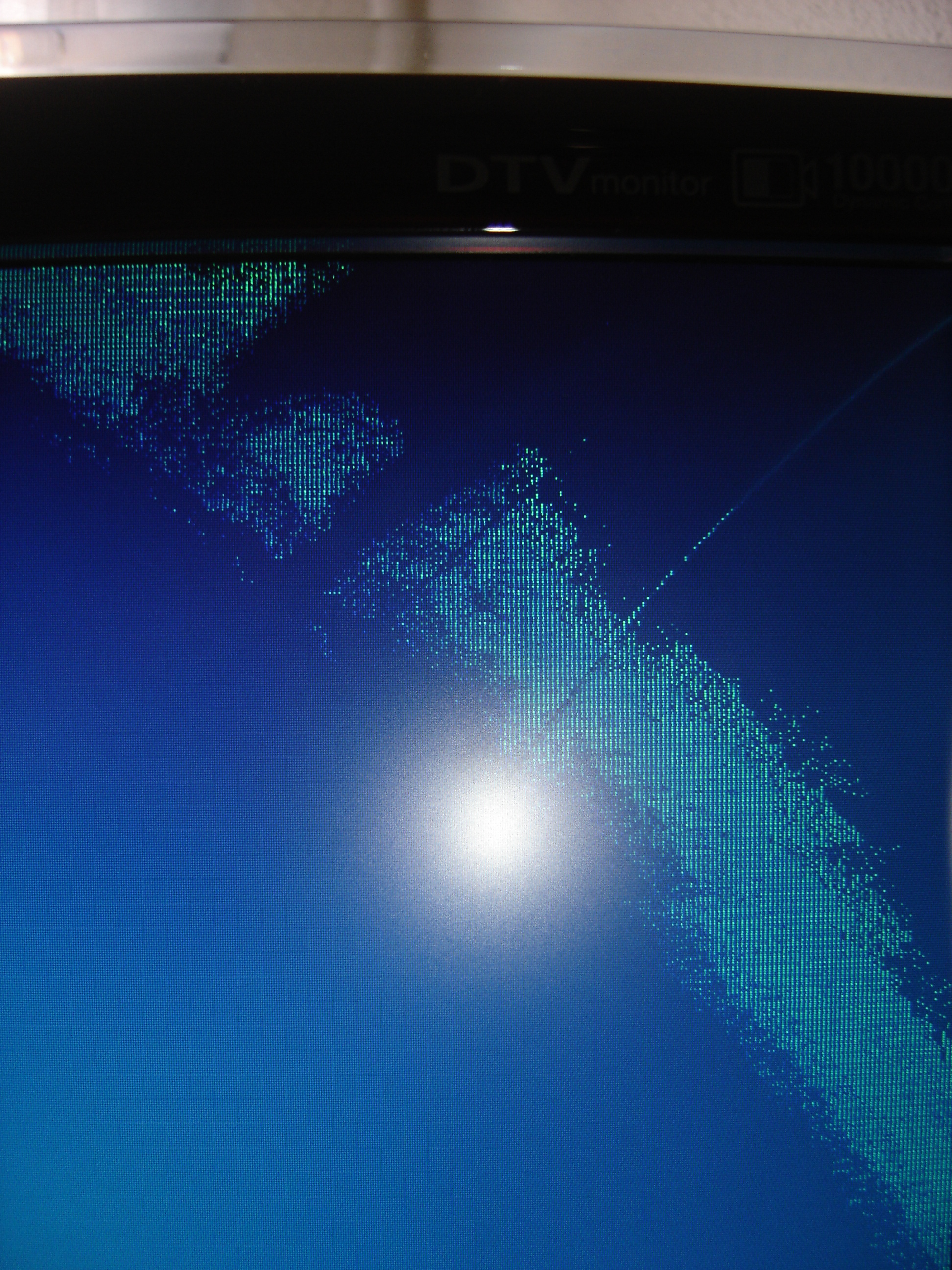

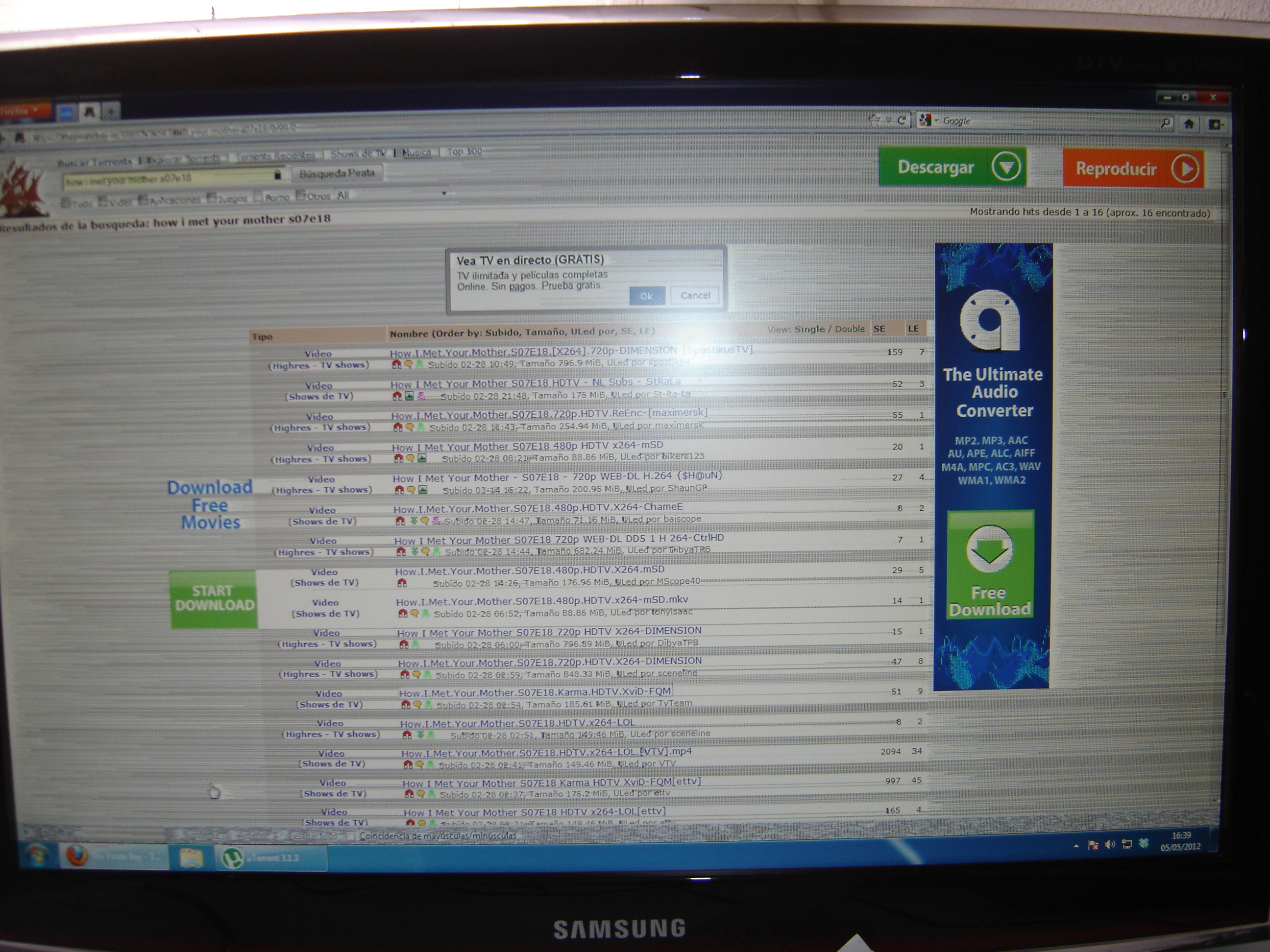

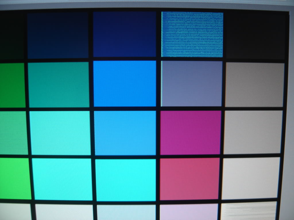

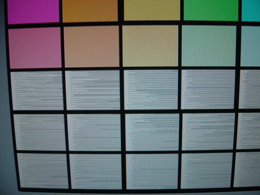

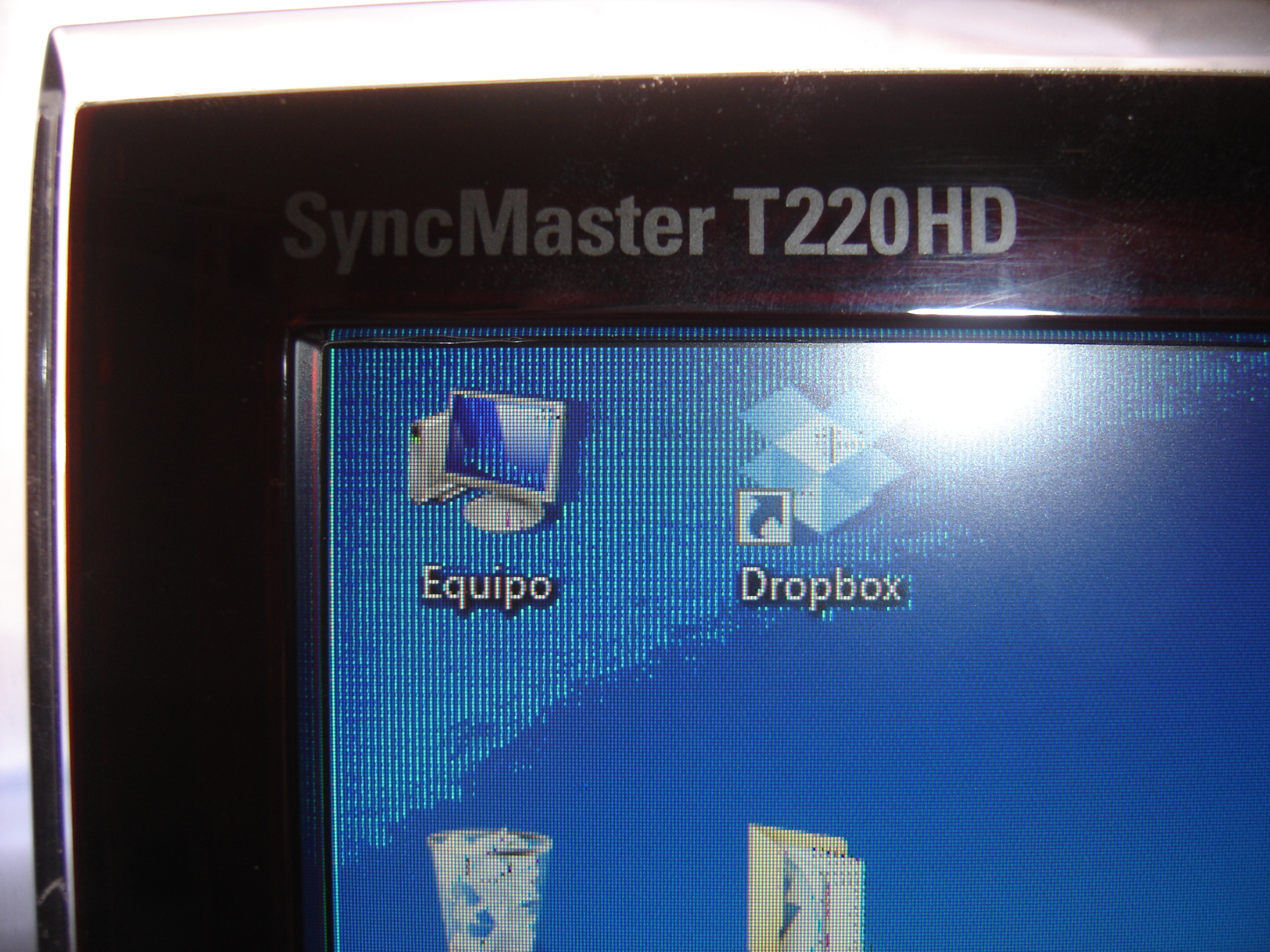

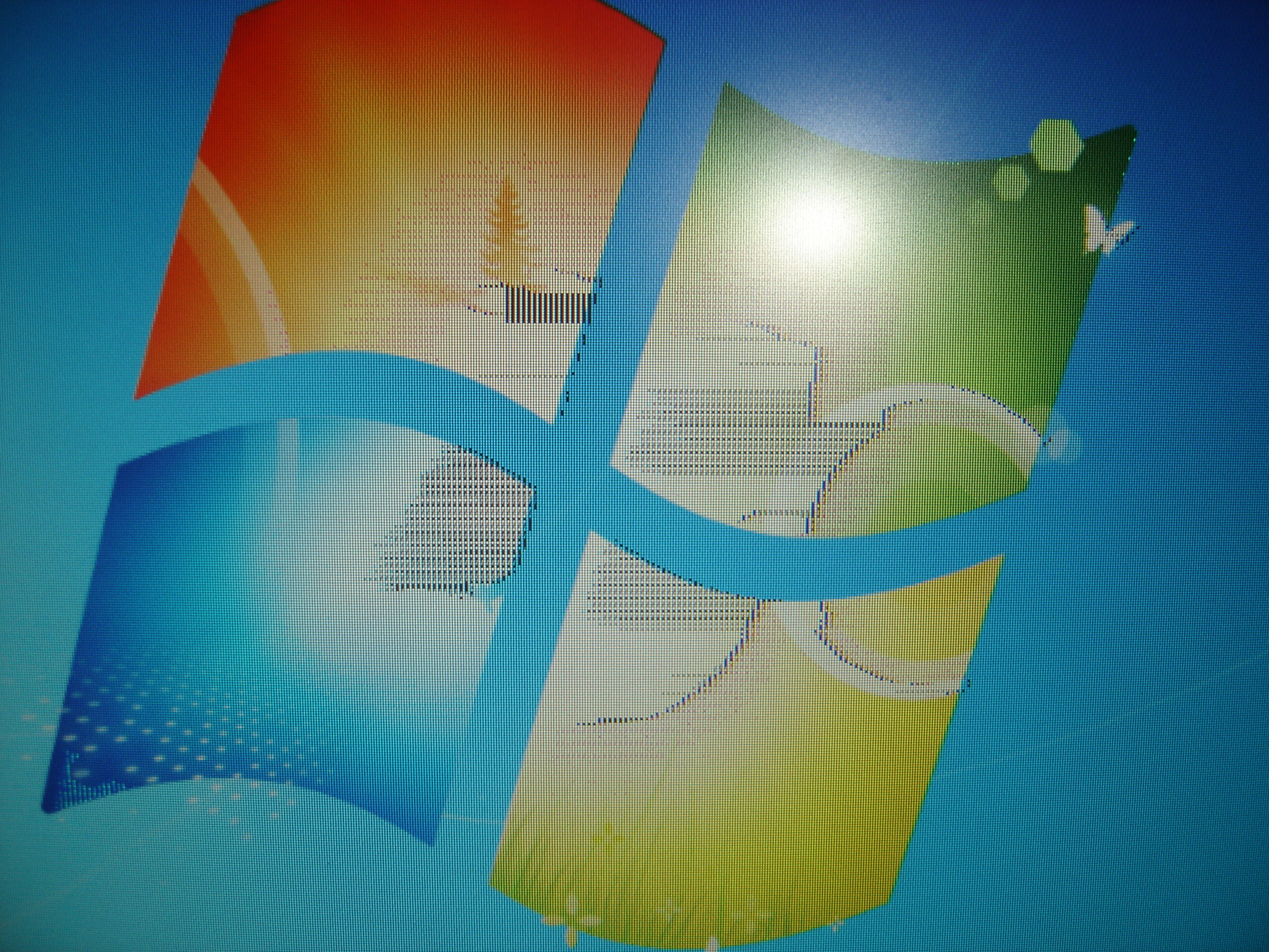

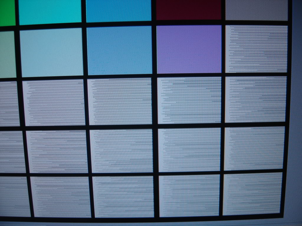

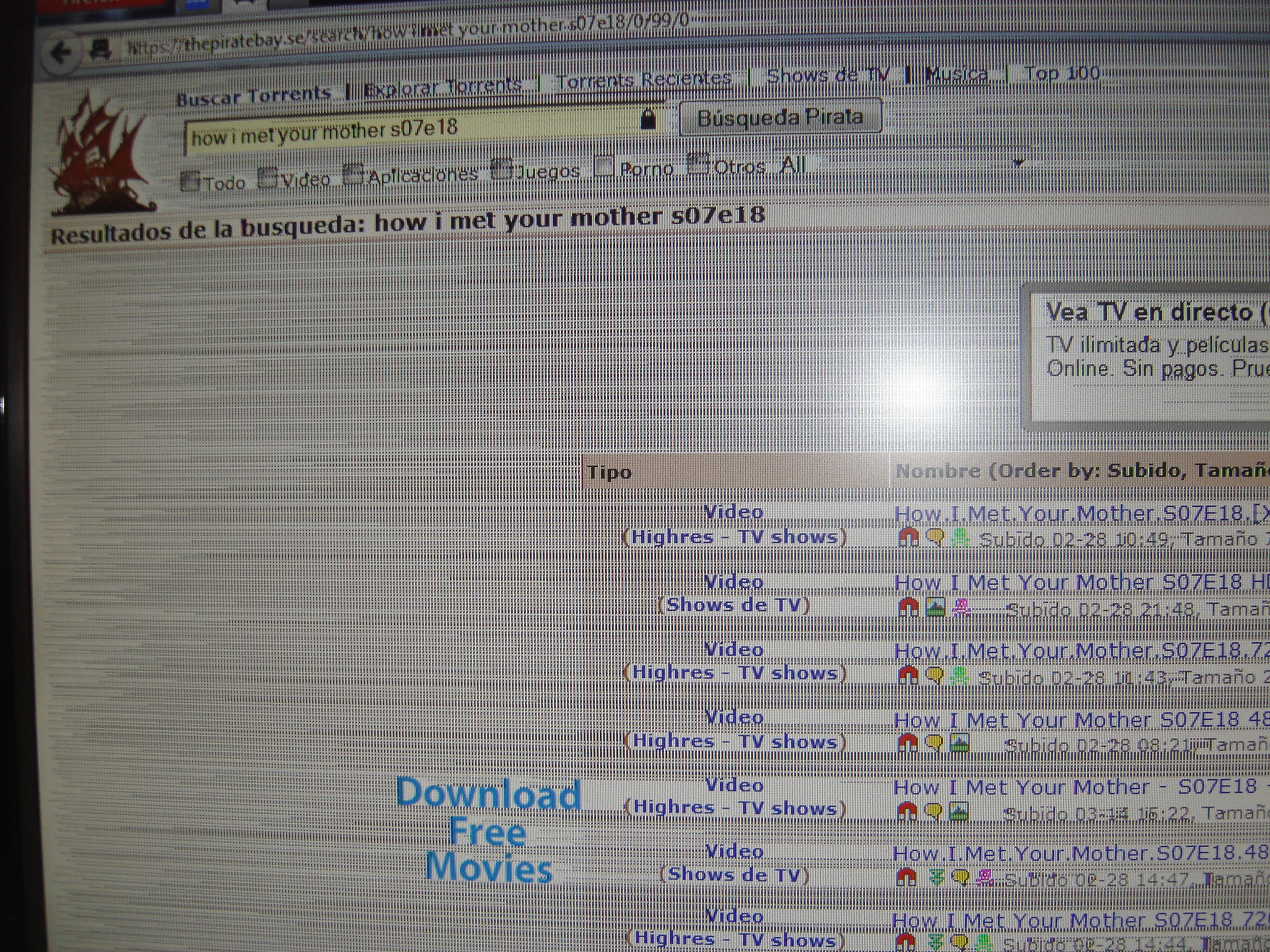

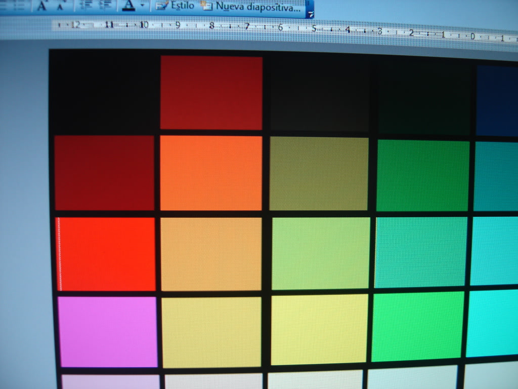

    Like a year ago my T220HD monitor started to display some noise horizontal bars at the display (hdmi, vga, dvi, YCrCb, TV, etc) on bright colours with clearly noticeable ones on whites, like the ones you can see at my gallery at photobucket:

    At the beginning, they appeared time to time and then oftenly till every time I turn on the monitor, they appeared. So, I thought that it has to be an issue with the main board, because I've inspected the power supply board without any leakage on the 'Sam Young' capacitors (as some users around the net reported but without image (black screen) or another issues). I haven't checked the voltages 'cos I wasn't sure of what values expect as an ok reading (or at least, between the margins).

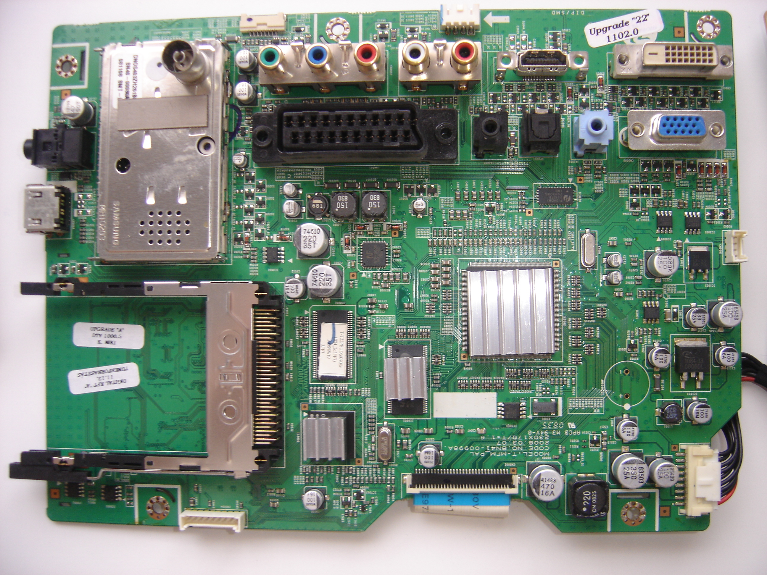

    Last week, 'cos we thought to get a chance into replacing the main board to fix the monitor in order to use it, I've ordered an indentical main board from SJS TV Services (one week delivery from UK to Spain, everything ok) and it arrived today. I've switched the main boards obtaining the same result.
    So, I've decided to make some readings about the voltages attacking the screen (because I suppose that the ones attacking the main board were ok, the one bunch of black + 1 red cable) and I've read ~7V AC and a little offset ~200mV DC at CN304 and CN303. Also, I have the service manuals which I upload you to my dropbox in case any reader would need them (no profit or advertisement intended):

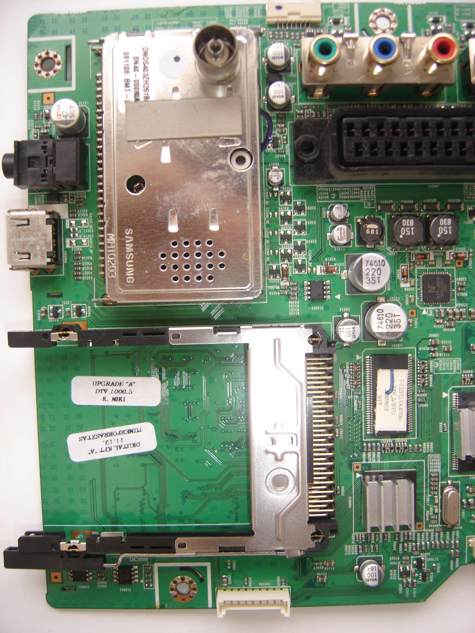

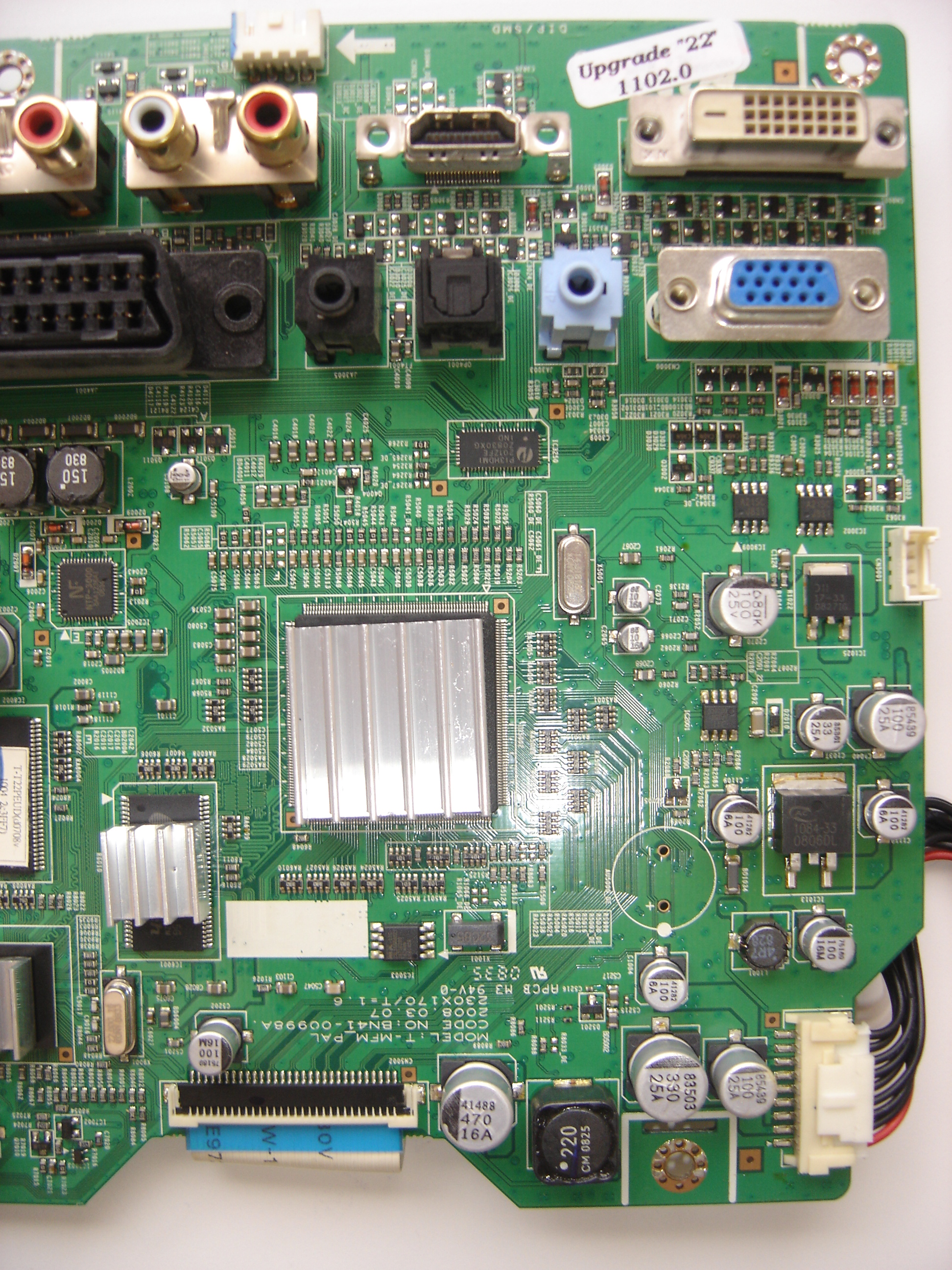

      With the malfunctioning mainboard, I've tried to reseat the cables 1st (plug & unplug). Then after the history of the previous post, I've done the same thing. How am I sure that I am connecting the cables correctly? Well, the main board has a connector like this one (I can tell you the name in Spanish but not in English), so believe me is just imposible to go wrong putting it out and in. Also, it has another three connections: one for the current & voltage provided by the power supply (the bunch of black ones + a red one), another for the speakers and the last one for the IR (infrared, denoted as IR1, IR, Vcc and gnd as ussually on the lil' pcb) circuit.
      All these connectors are showed on these pics I've just taken few minutes ago (IMG2191 and IMG2190)
      http://s934.beta.photobucket.com/use..._2191.jpg.html
      Any further ideas?

        Re: Noise-like problems on Samsung T220HD
        Hi we do not really like pictures posted off site - there are a number of reason one is I cannot enlarge it and I can only copy by screen grab. Please post any other using Manage attachments which is found in Go advanced under the Quick Reply box.
        In fact perhaps you could repost your pictures using that.

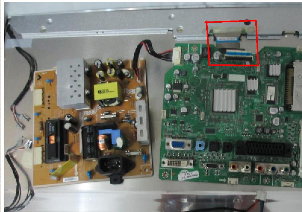

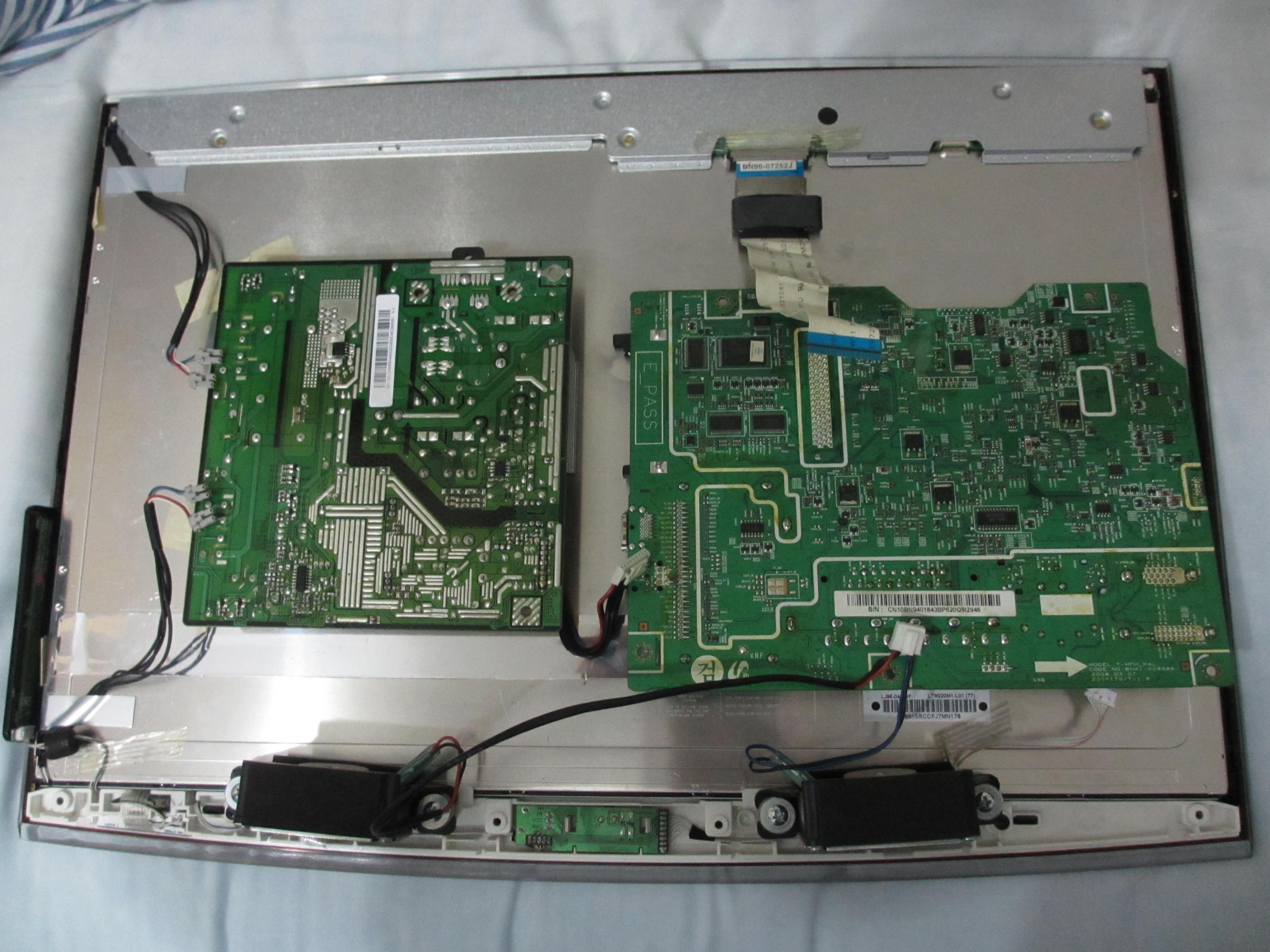

        Anyway I have marked the cable Tom refers to - you need to het to where it attaches to the panel and assuming it can be unplugged , unplug, clean and re plug.

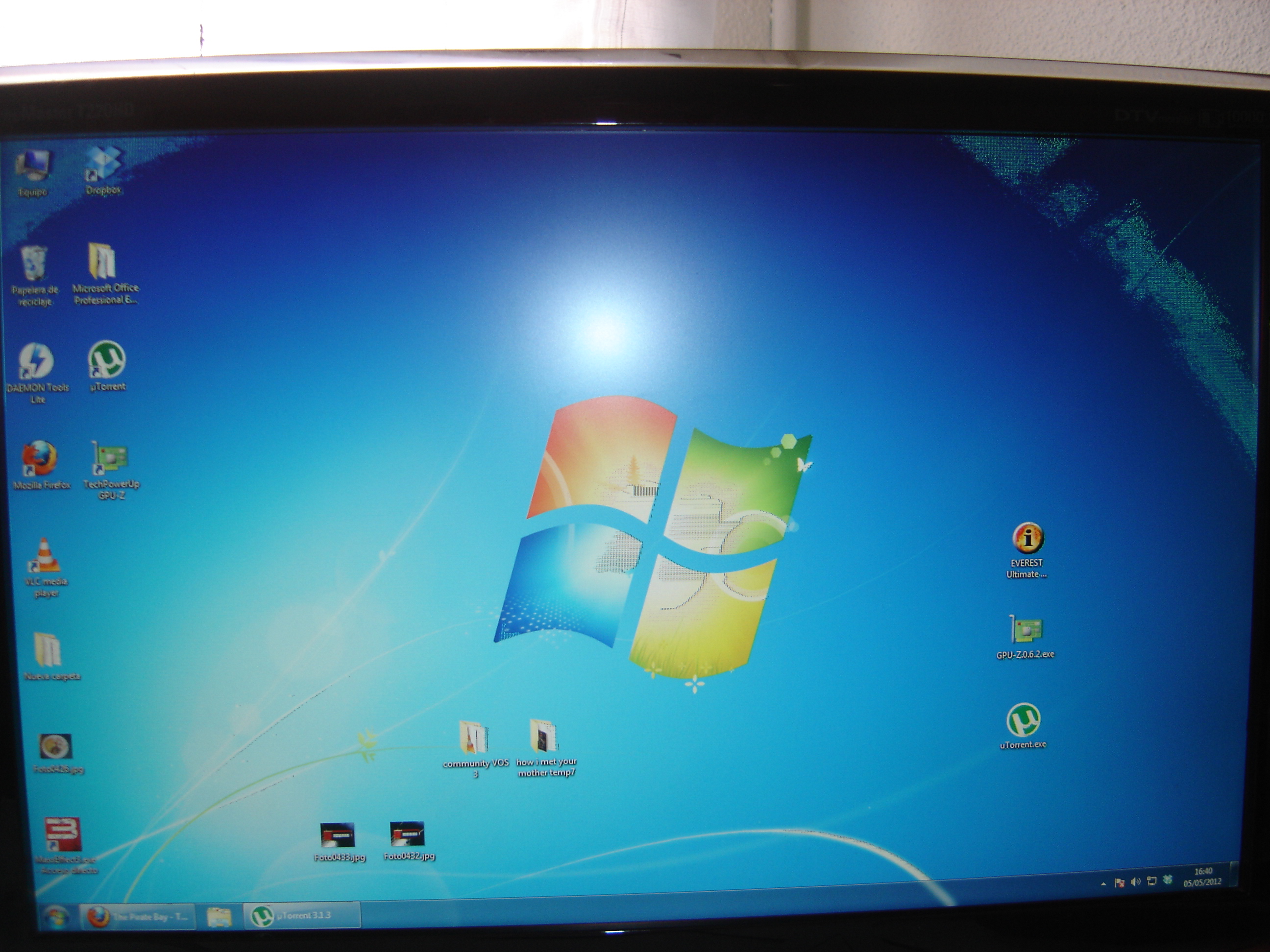

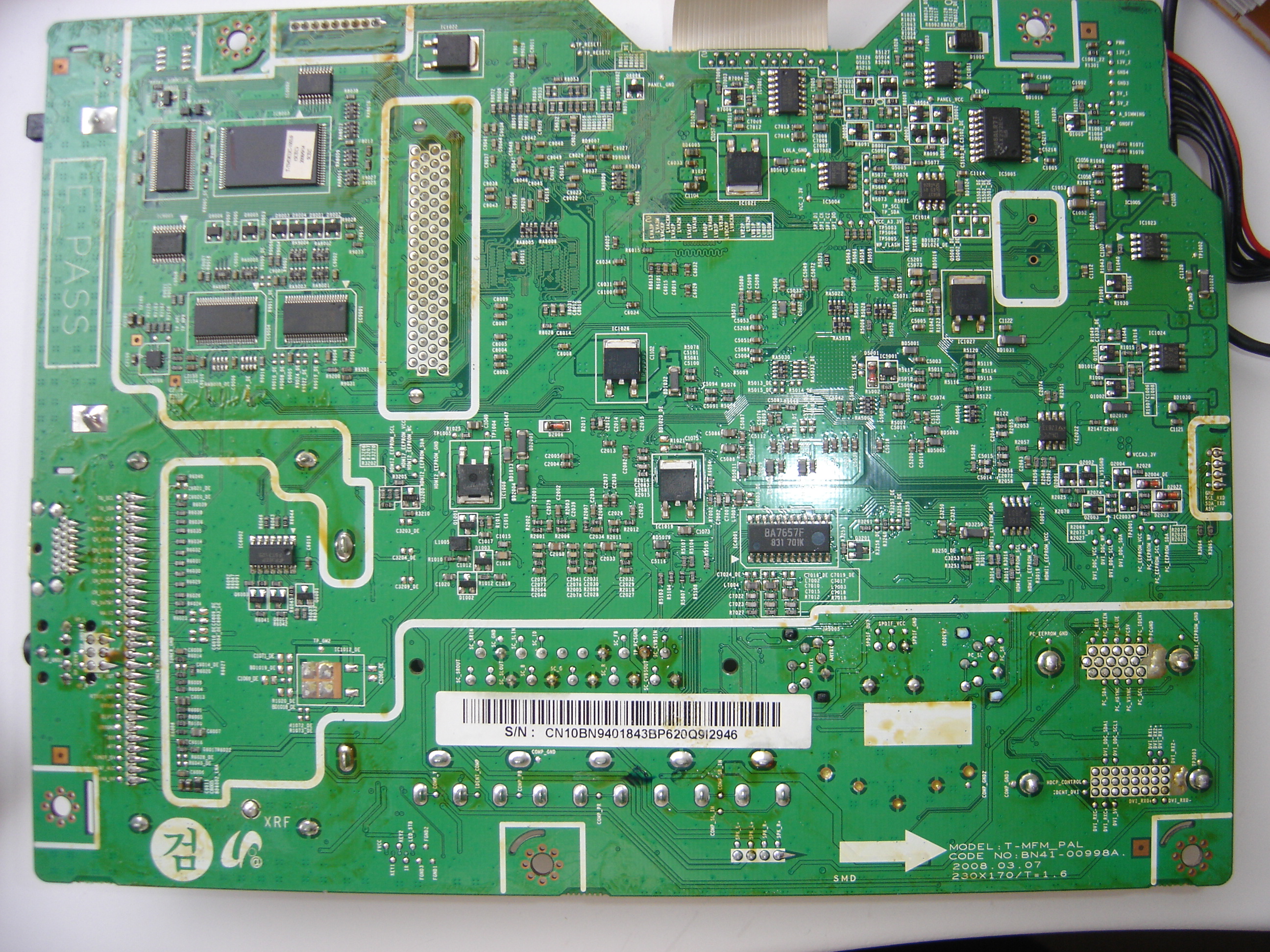

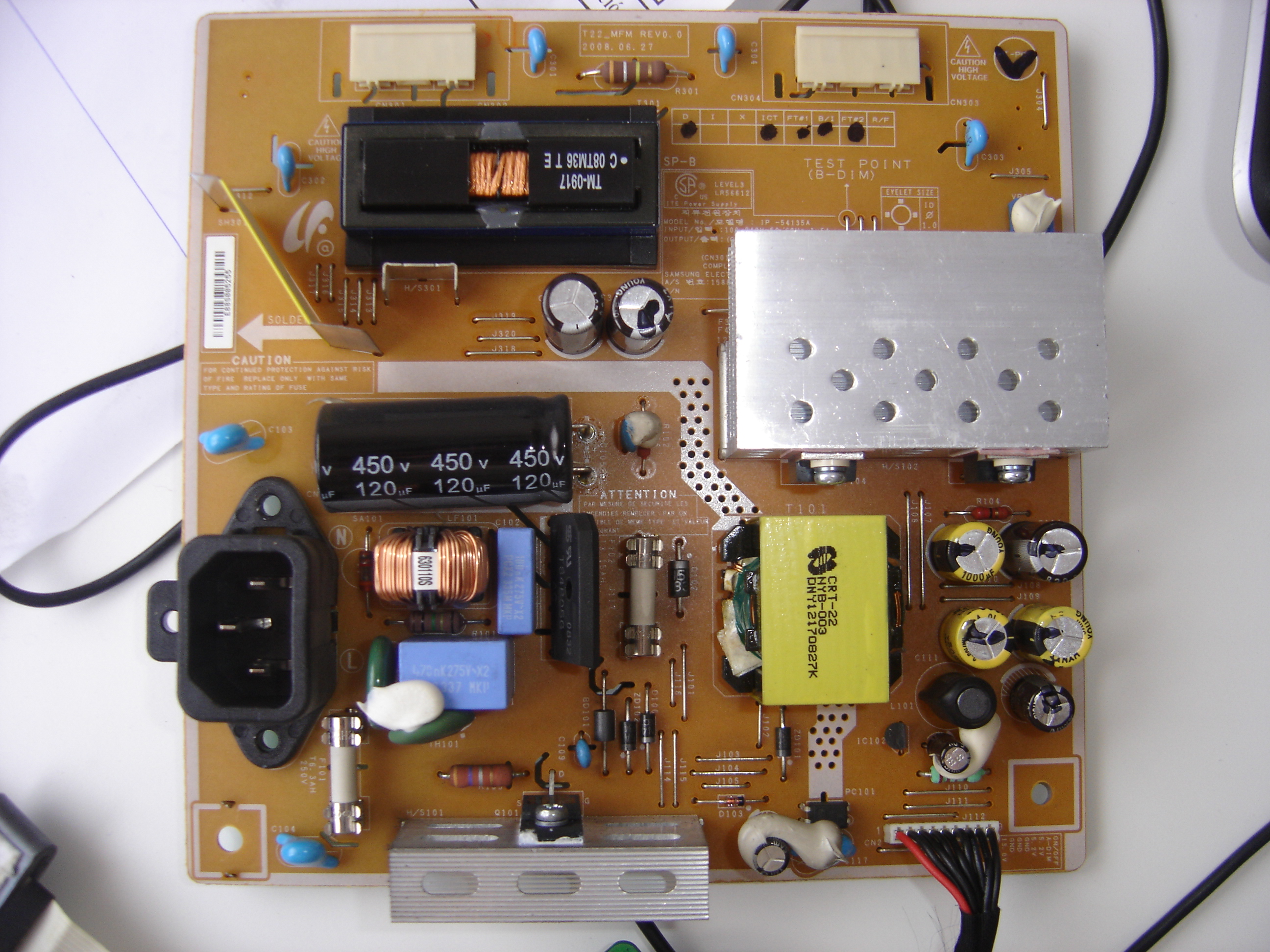

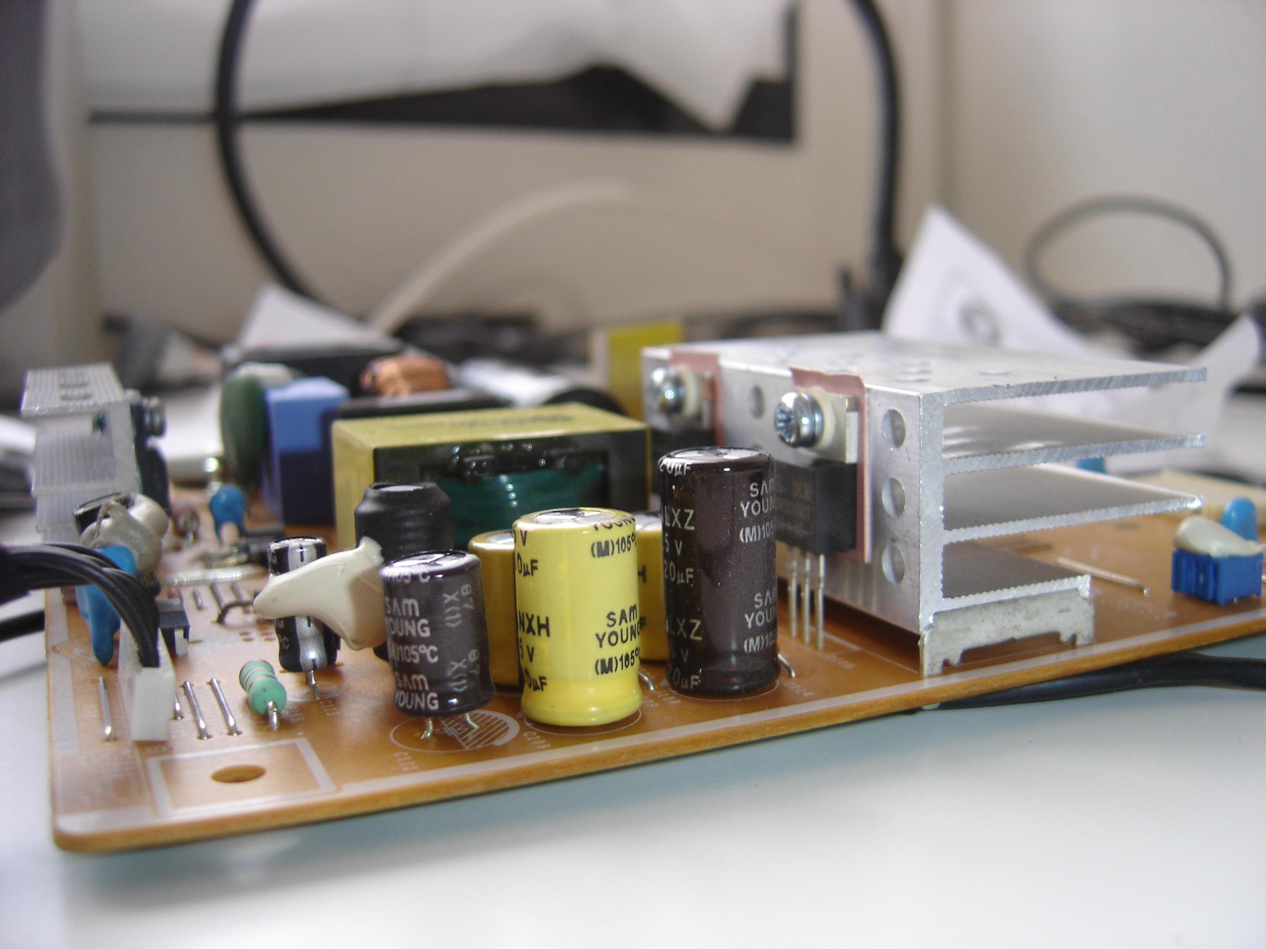

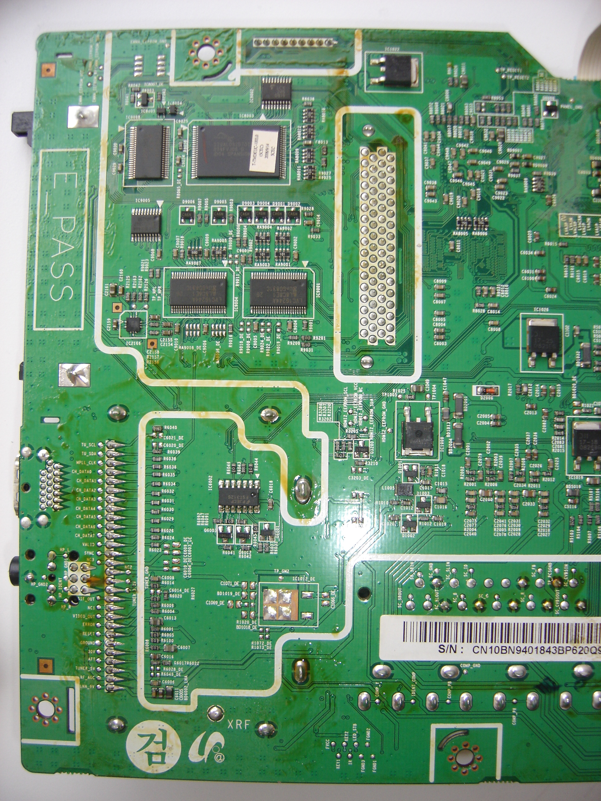

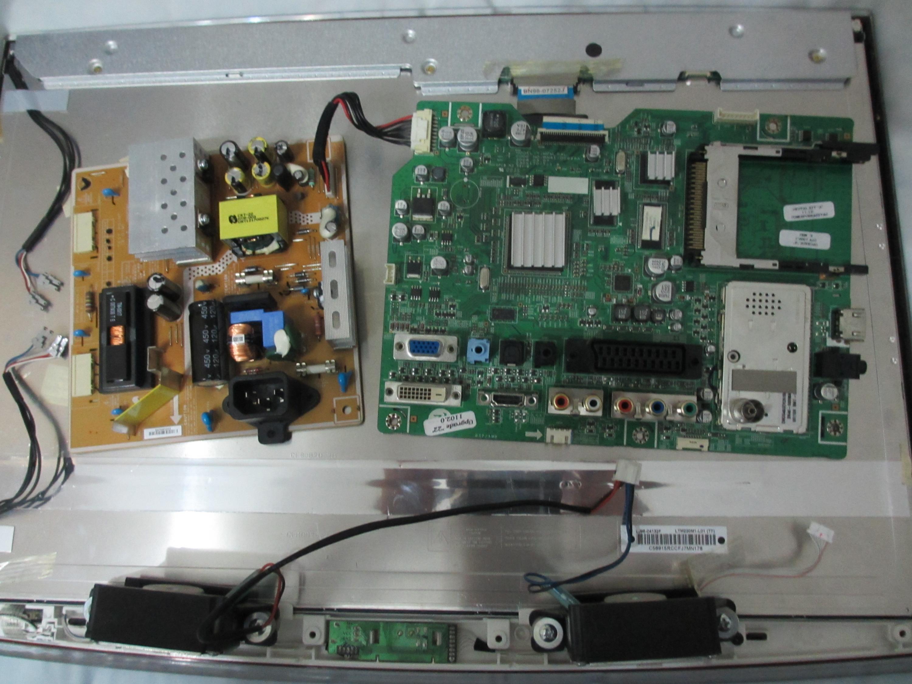

          PS: Hm.... it doesn't allow me to edit mi 1st and 2nd post, so I'll try to upload over this post all the photos The photos at this post correspond to the 1st time I've dissasembled the monitor with the problem appearing everytime I turn the monitor on. I'll make another post to attach the recent photos with the new mainboard
            Second post with the new photos I've taken yesterday showing the position of the boards (power supply -left- and main board -right).

              Dose the fault always appear in the same position or is it random.
              Does it appear straight away or after some time. - Trying to decide if it is a faulty panel.

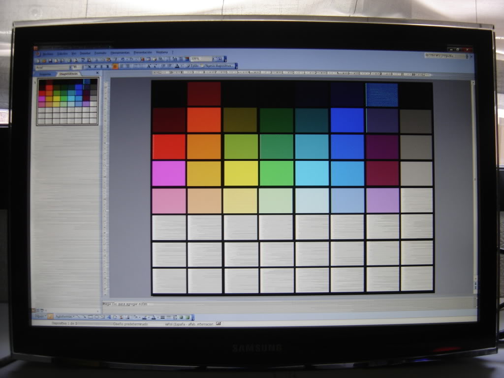

                The position is random as it is showed on the photos with the different standard colours that power point may offer (at that time, I wasn't eager to make a vector o colours, just test why there were noise on very bright colours and white ones), no stuck pixels. As I've said on my first post, the first time these 'noise lines' appeared were for a short time and vanished. The next times appeared for a little bit more time (turning on/off the monitor did not fix the problem) and finnally, the lines appeared always on the monitor (with more heat in it -summer- with less heat -winter- for a long period of time the did not dissapeared, switching the monitor on/off several times also did not fix it, the lines were stuck were a bright colour or white appeared indepently of the video input). I've just upload also these photos I mention about power point.
                So, is it a faulty panel then? As said previously, I've ever seen a faulty panel (I've own 1 LCD 4:3 for a looooong time that I quit to use when I bought T220HD). Also, I don't remember if I've mentioned it, but the problem appeared when the monitor was used for ~3 years (not always 24/7, like maybe 2-3 hours per day on).

                  Doesnt look like the panel then if the fault moves.

                    The first thing I've done before dissasembling for the first time the monitor T220HD was to switch my GPU (ati 5770 to a nVidia 8400GS) and the monitor presented the same problem. Then, I've disconnected all the inputs to the monitor, having only the DVI input from the Pc and the AC power cord to turn the monitor on (with just this power cord plugged to the wall). Same problem. Then I had tried disconnecting all except the power cord (obviously) to watch only TV: same problem (although on TV was lesser noticeable as on TV they are usually images in movement). Then I've tried to see a film at the Pc with the two GPUs (one each at each time) and the same problem (although there was a dynamic image, on white or bright images, they were the noise lines). Afterwards, I've tried to connect the PS2 through SCART and through YCbCR and the same problem....So yes, I've tested all the inputs in every single way trying to aisle the problem, if the problem was caused for a faulty or unsynced frame rate from the transmisor module (generator of images). My conclusion was that neither of my transmissor modules were the problem (two pcs -also I've tried my netbook through VGA- and a PS2 wouldn't be wrong generating images).
                    [edit] Also I've tried a new monitor (22" 16:9 LG cheapo one, my old 4:3 LCD) and also my recently buyed monitor (HP ZR2440w) and there is no problem! (as said, the problem doesn't come from the source of the image)
                    So, as I've said previously, my conclusion was that the main board for any reason, was faulty. Hence, I've ordered a new main board to switch it.
                    So, as a new main board doesn't solve the problem, I continue in the process of searching errors through the transmissor of the images (source) to the receptor of the images (destination), as the LCD is. Then, at my first post I was asking the community the voltages of the power supply (although there are no bad caps apparently -I haven't measured it's C by desoldering them (otherwise you can't tell) ), because the power supply provides energy to the LCD, mainboard and IR circuit.
                    Usually, if a chips tends to fail in some way, you could think it's broken but, maybe the chip isn't doing what it's designed to because of its Vcc (power voltage) which has a lot of noise, isn't enough, is to much, etc. As the two main boards are presenting the same problem (and the one I've purchaes is suppossed to be ok), the focus moves to maybe the power supply or just the circuits in charge of control the colour of the LCD panel (which I don't know if they are inside the LCD package or if you can dissasemble them by a standard way).

                      The only thing we have not looked at is the panel board - post picture of that and perhaps we can think of something else.
