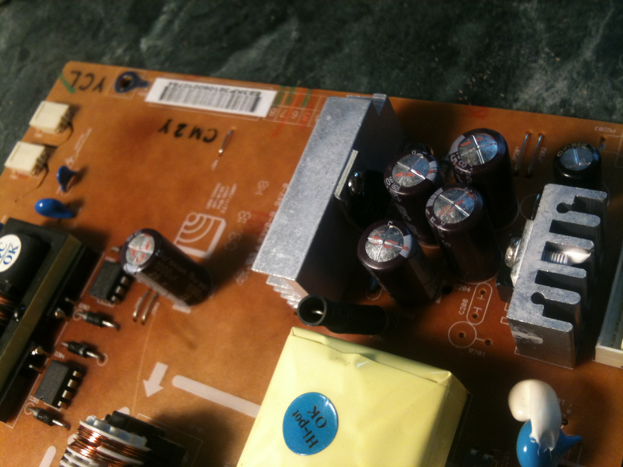

    I am looking at replacing the caps on the power board that existing Caps are Su'scon (3) 1000uf 25v & (2) 680uf 25v. What would be good replacements for these?

        So i am looking at 680uf 25v
        EEU-FR1E681LB
        and 1000uf 25v
        EEU-FR1E102
        They are Mouser numbers, what do you think?
        Bruce

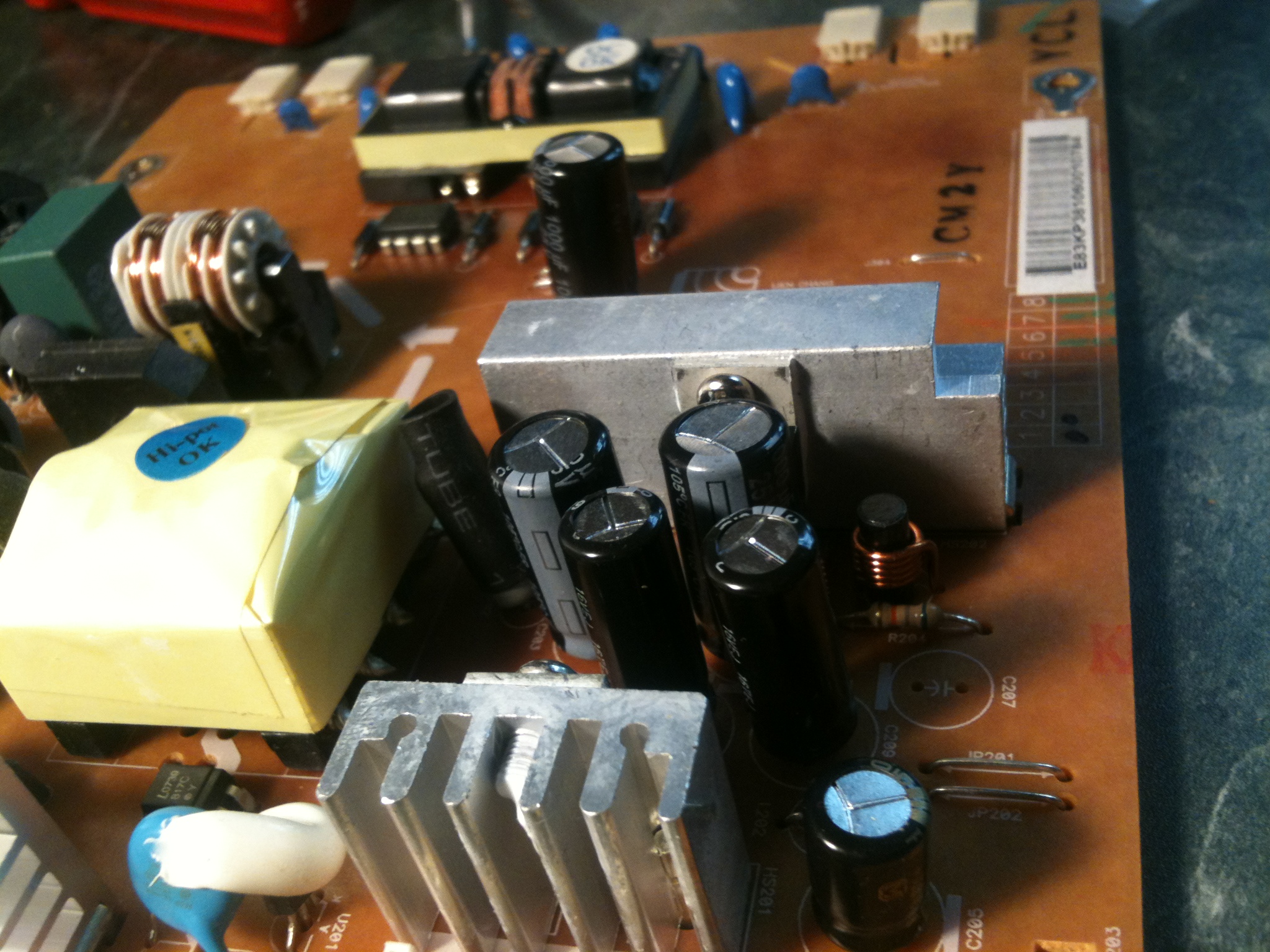

          Here is the board with the bad caps.

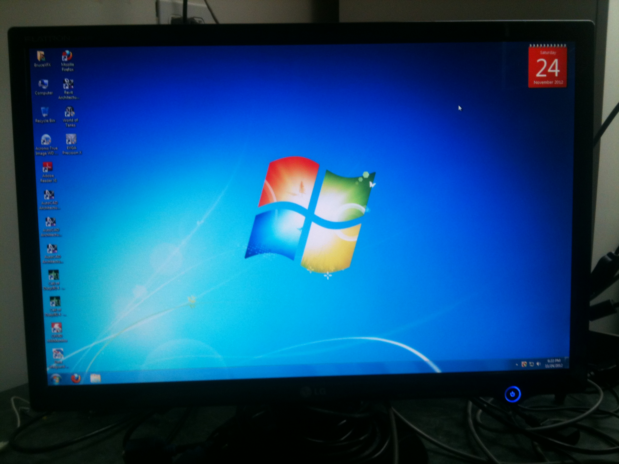

          I replaced all 5 caps with the ones listed above (here is the replaced caps pic)
          and the final product.
