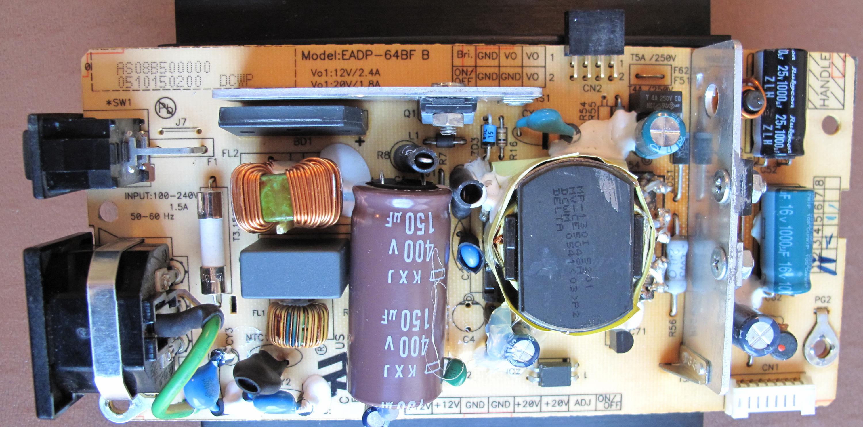

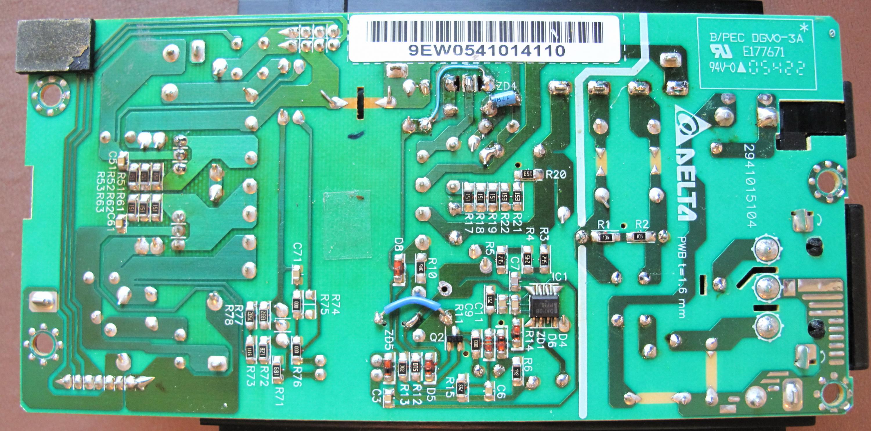

                  Chris,We are at the 'show us some photos' stage.Submit via the 'Go Advanced',shown below and then 'manage attachments.Good clear,focused ones of both top and bottom.
                  • chrisuk
                    • Oct 2012
                    • 13
                    • England
                    Re: VP2030b Power Supply Problem
                    Hi RTech. I've attached two pics top and bottom as requested. I should point out that I repositioned one of the capacitors when I tried to fit a replacement 400V 150mf capacitor which wouldn't fit in the end so I bought the correct size but left the re-positioned capacitor in its new position. There is also a track repair under the MOSFET area (the other wire link is for the repositioned capacitor. If you could tell me what to check with the board on the bench, I do have test equipment if it helps. Thanks.

                      The DC Voltage acorss the big cap, should be 330V approx ?? if that is correct then we need to look at IC 1,but cannot find a datasheet at the moment !!
                      • chrisuk
                        • Oct 2012
                        • 13
                        • England
                        Yes, 330V across the big cap confirmed.

                              As this datasheet seems to be impossible to find ! then suggest you Measure resistance on it.The negative lead of your meter to the negative leg of the big cap,and resistance then to each of the pins,POWER OFF of course.One pin should be gnd,Pin 7 looks like its not connected(which is normal on some of these).Also on the Top of the board just above one of the markings saying +20v,is an optocoupler,and a Cap,and purely from its location,I suspect that is the start up Cap,and attached to that usually on the top also, is the negative side of a diode,maybe via a resistor,and the feed comes from the transformer.If the cap is faulty OR the diode leaky then IC 1 will not get a Vcc voltage to allow it to start up.
                              • jetadm123
                                • 2169

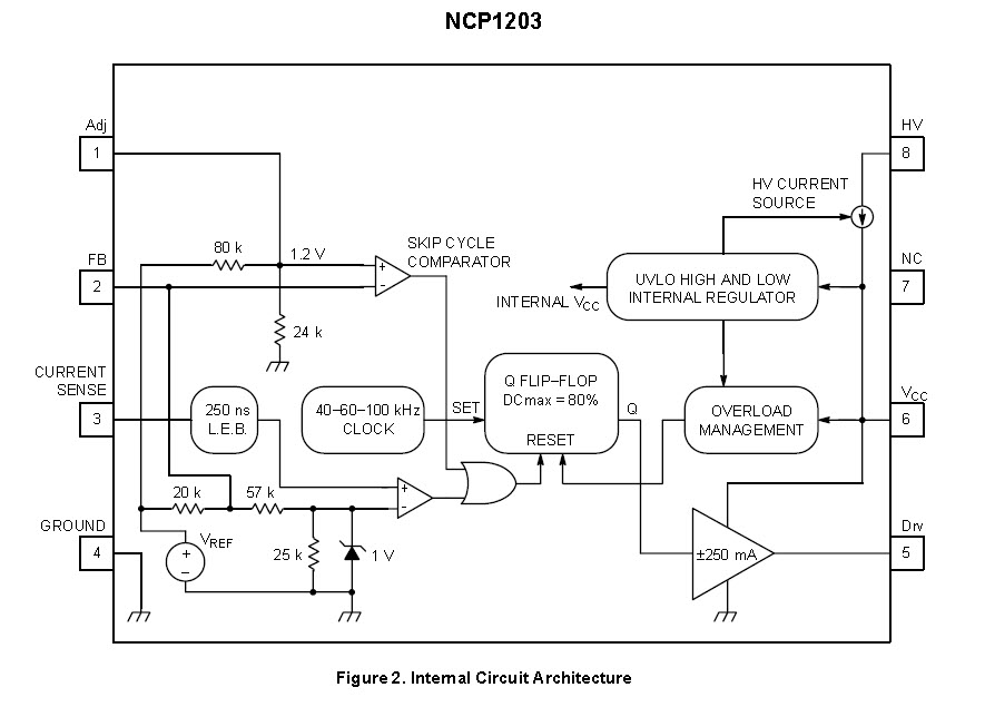

                                I believe the DAP08 is a NCP1203d6 controller. You can download the datasheet to see if the pins match up.
                                • chrisuk
                                  • Oct 2012
                                  • 13
                                  • England
                                  Looks like you may be right Jetadm123 the pins look right.
                                  Rtech, I've checked the components you mentioned and they all seem OK. I have diode and capacitance functions on my multimeter (Fluke 185) and the capacitors and diodes checked out OK I think. Also I actually powered up the board and measured 3.6VDC betweens pins 4 (ground) & 6 (VCC) according to the NCP1203 pinout. Any help?
                                  • chrisuk
                                    • Oct 2012
                                    • 13
                                    • England
                                    Here's a pic of the NCP1203 pinout if it helps.
                                    • jetadm123
                                      • 2169
                                      Looks like Vcc has to be at least 12.8VDC for the NCP1203 to turn on. There should be a small startup cap 22uf-47uf 50V connected to Vcc. Has it been changed?
                                      Was the 2SK3569 connected to the NCP1203? When it shorted out, it may have taken the NCP1203 with it.

                                        The 22uf capacitor hasn't been changed but appears to check out OK on the multimeter (it's reading 22uf across the terminals while in circuit). I am starting to think the NCP1203 might be gone. Should I remove it and check to see if I get the 12.8VDC at the pin 6 tab?
