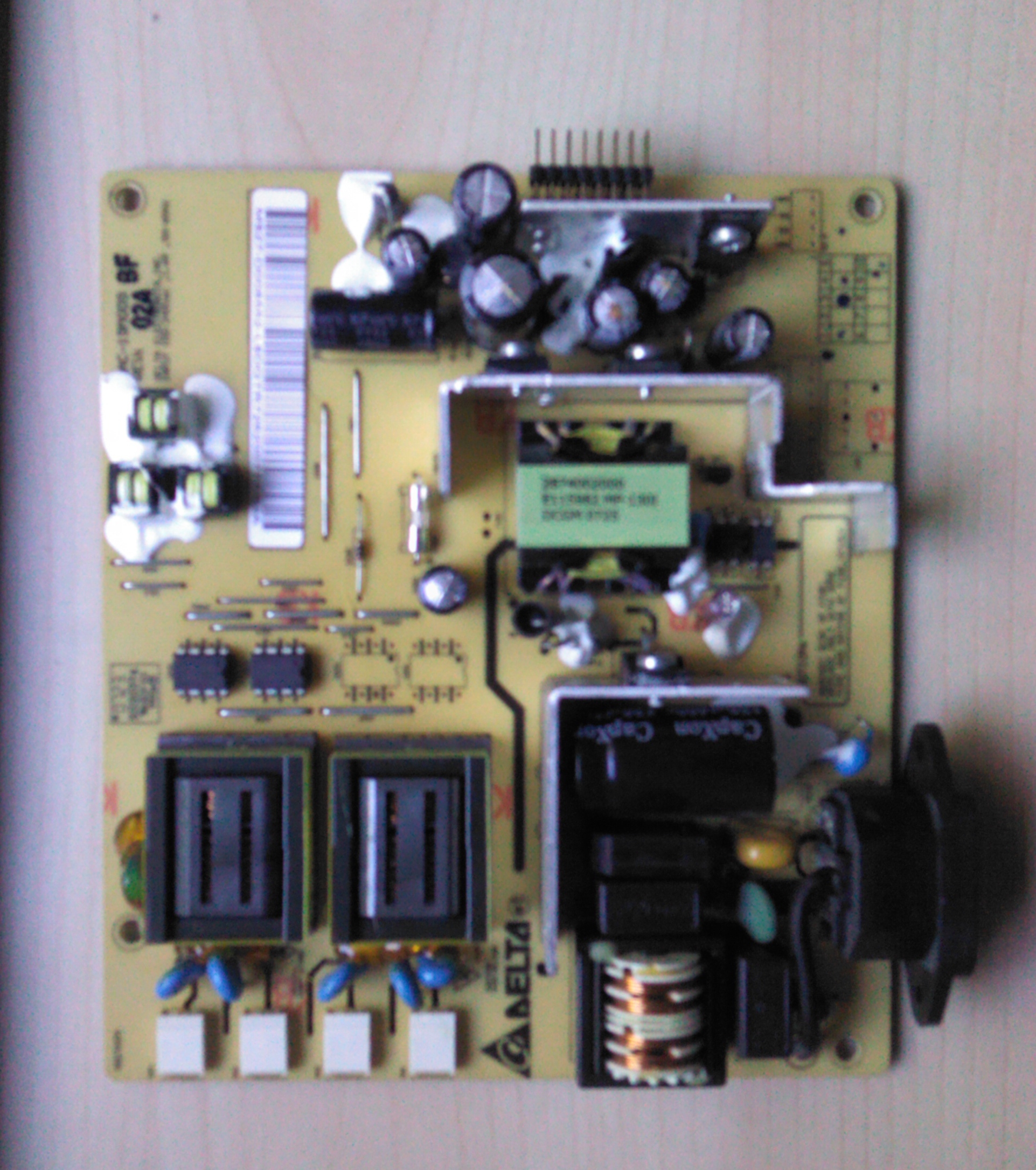

    Some information: got it for free, from somebody who now wants it back because they think it's valuable. So I decided I should at least test it before I ask them if they're sure they want it back.
    Well, it made a horrible squealing noise and didn't work.
    This was going well for me
    Told them it's a goner and I might try to fix.
    Unfortunately I think that they are under the impression I'd be happy to give it back when it's working again.
    Not really. I want this LCD to replace the 3rd monitor I'm using with my two Dell 22-inchers... an Apple LCD at 20" that is a piece of crap. At least this one is the right size and color, even if it's an Acer!
    Iffy thing is, the person also gave me an almost brand new $500 Dell Color laser printer and an Intel iMac. Along with an iMac G5 with bad caps which is another story
    Caps that need replacement:
    -CapXon 220us 25V (3x)
    -CapXon 2200uF 10V
    -CapXon 1000uF 10V

      I count at least 7 capacitors that would need to be replaced.
      Don't think the capacitors that aren't swollen are good, they're also bad.
      There should also be a small starter capacitors somewhere near the transformer, maybe under that white gunk ... 22-47 uF / 35-50v... something like this.
      It's cheap enough to be worth replacing it at the same time.
      If you're gonna order solder from digikey, order the caps at the same time and save on shipping costs.

        A dreaded DAC- board but cannot read which one...good luck, hope its just the caps.

                  Well, given that I couldn't find the rest of my solder and I also couldn't find my soldering iron the project had been suspended.
                  My friend bought me some solder from RadioShack - it's the best solder I ever used! (not kidding)...
                  Anyway, I replaced the big cap with a Rubycon and the other three with SamXon capacitors. I left the 10/1000 bulged as I didn't want to bother trying to unstick it from the white glue and I was too excited at the prospect of a third monitor to wait 10 more minutes.

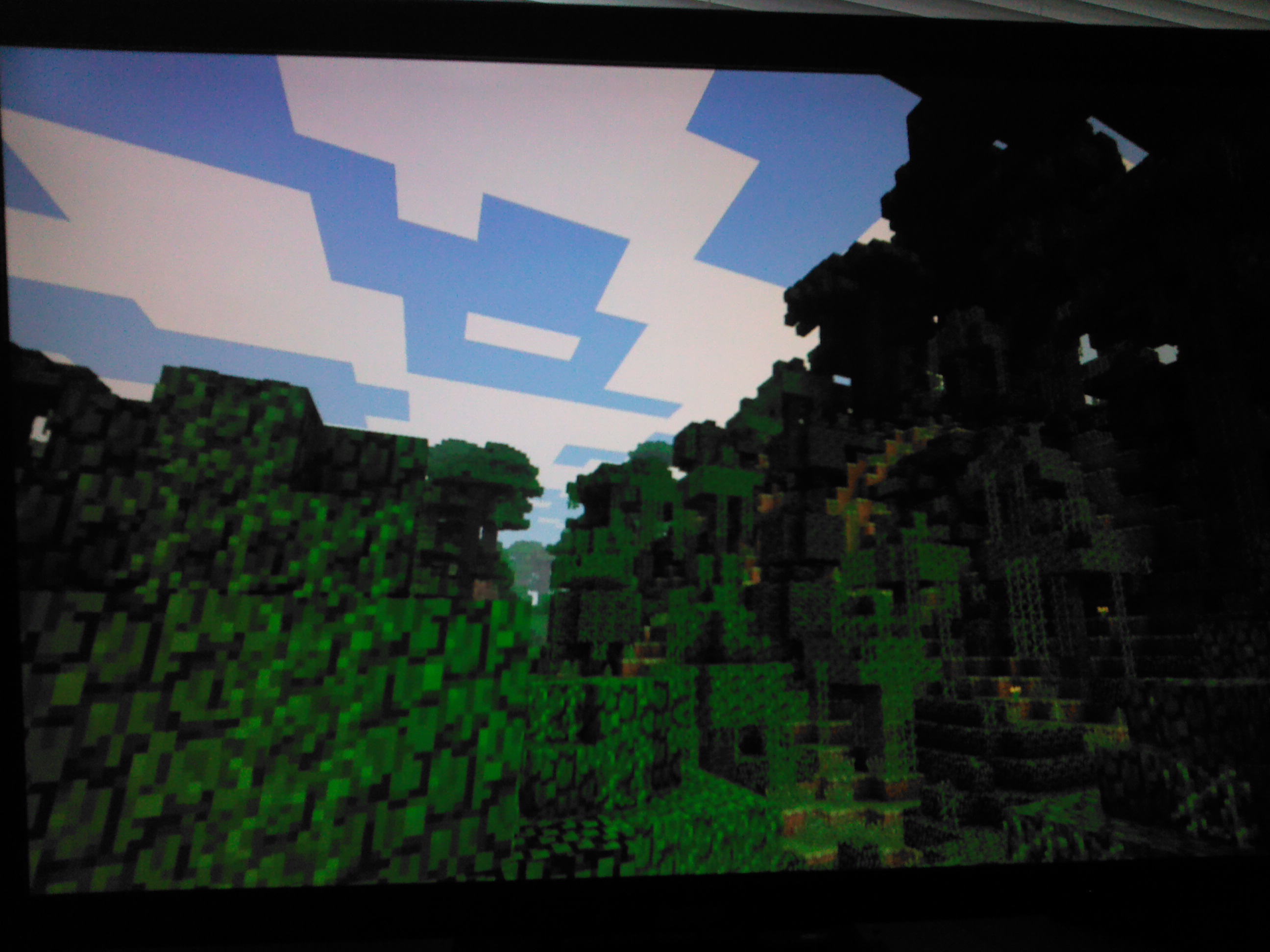

                  Anyway... (sorry about the horrible tablet picture), IT WORKS!!!
