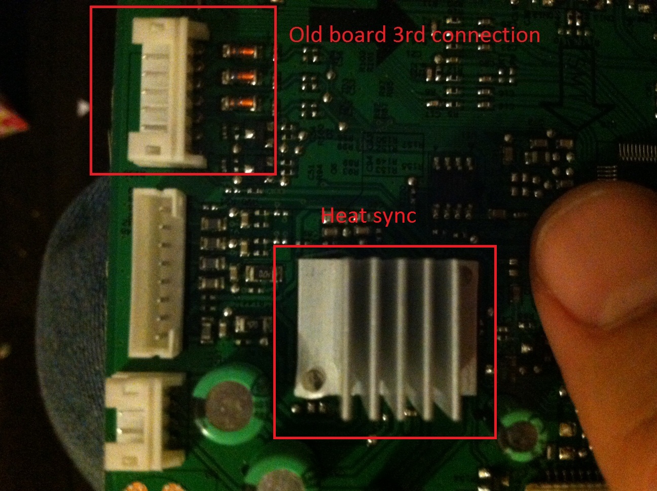

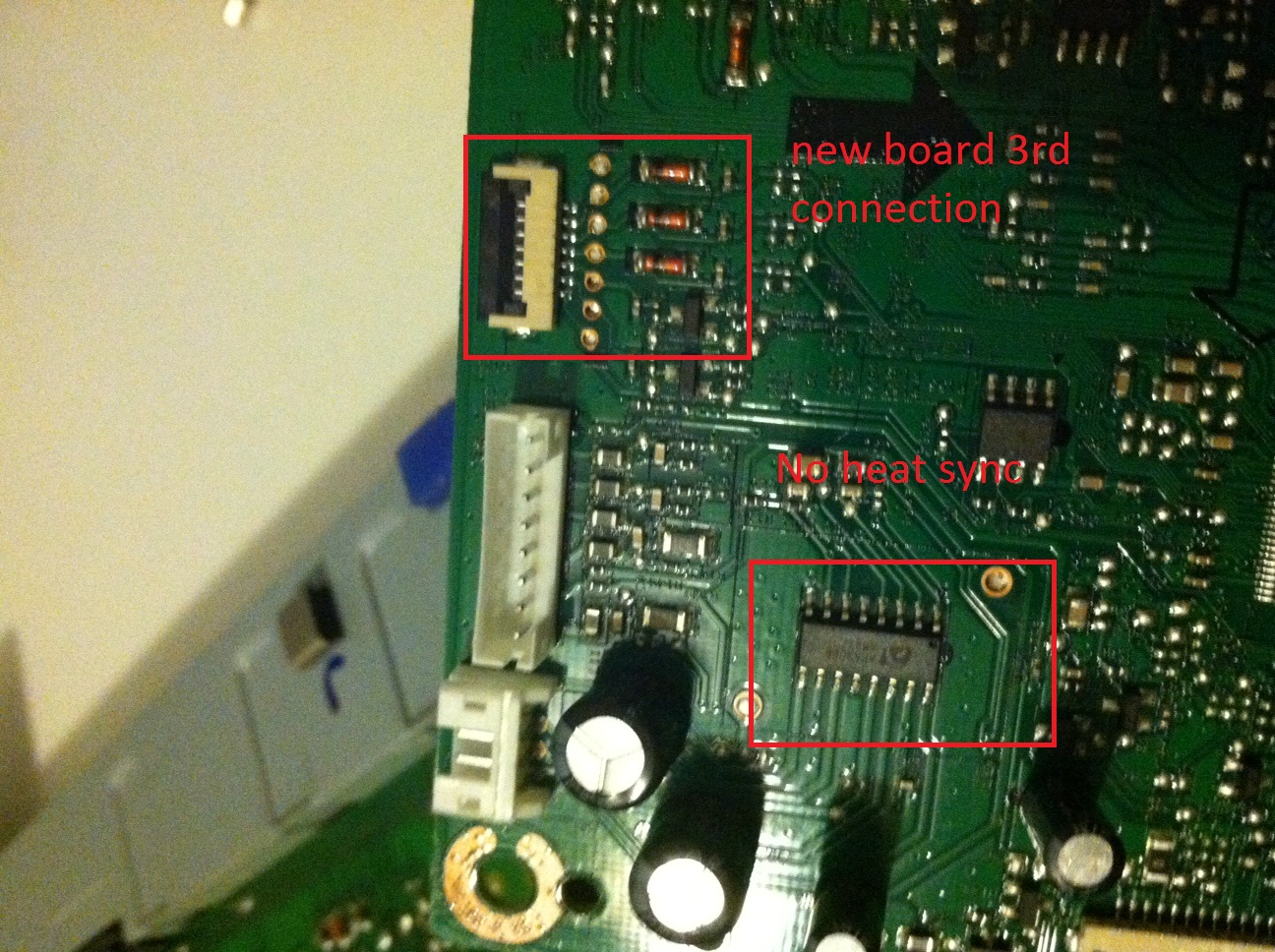

The bottom one the input pin3 (5.053V reading) is an input pin.
The top one in question, if it is typical 1117 LDO, from the picture, the top pin should be an input pin. If it is 2.5V LDO, then that reading of 1.208 is wrong.
I cannot fine anything base on the P/N as printed on the body yet.
