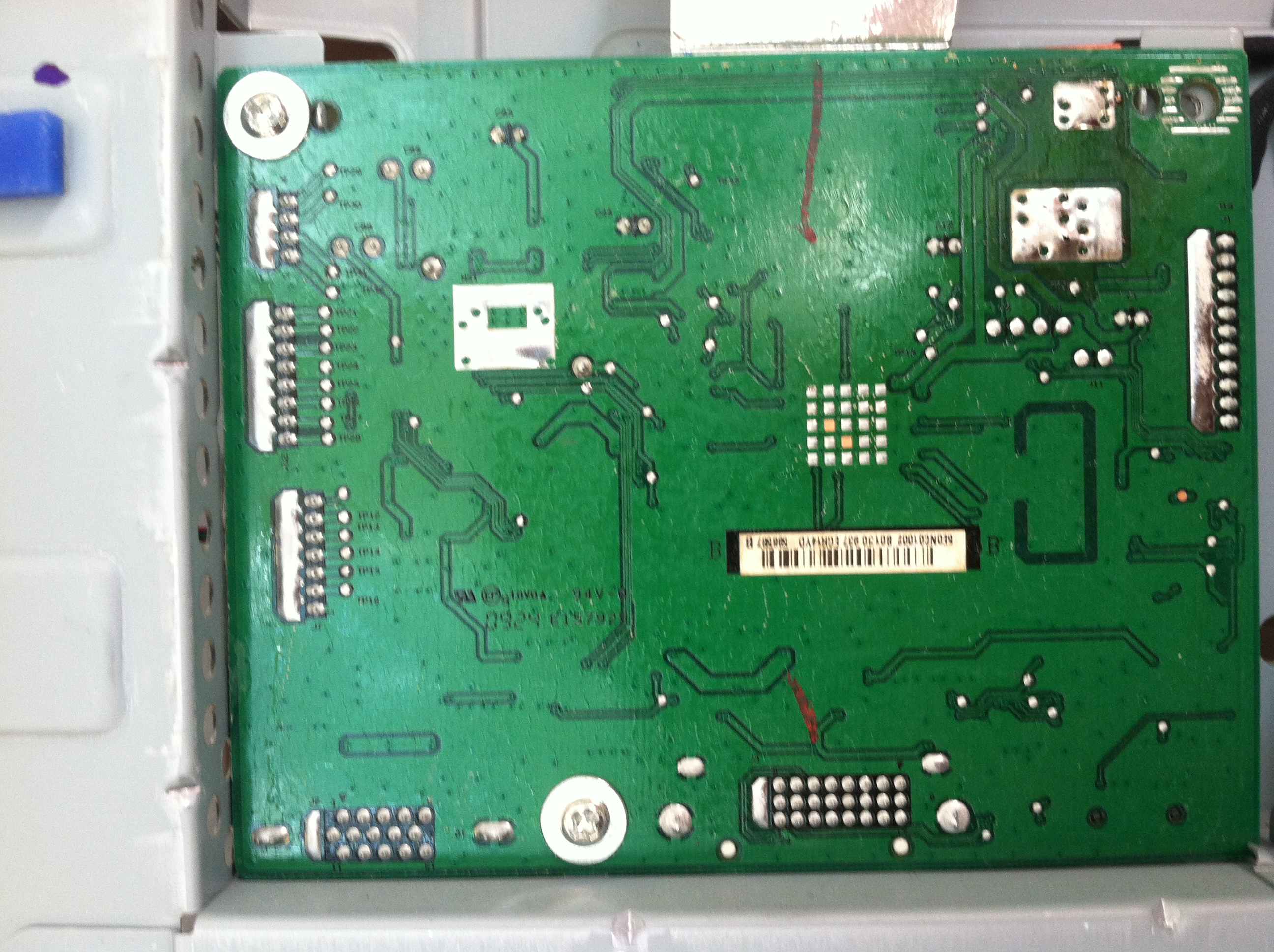

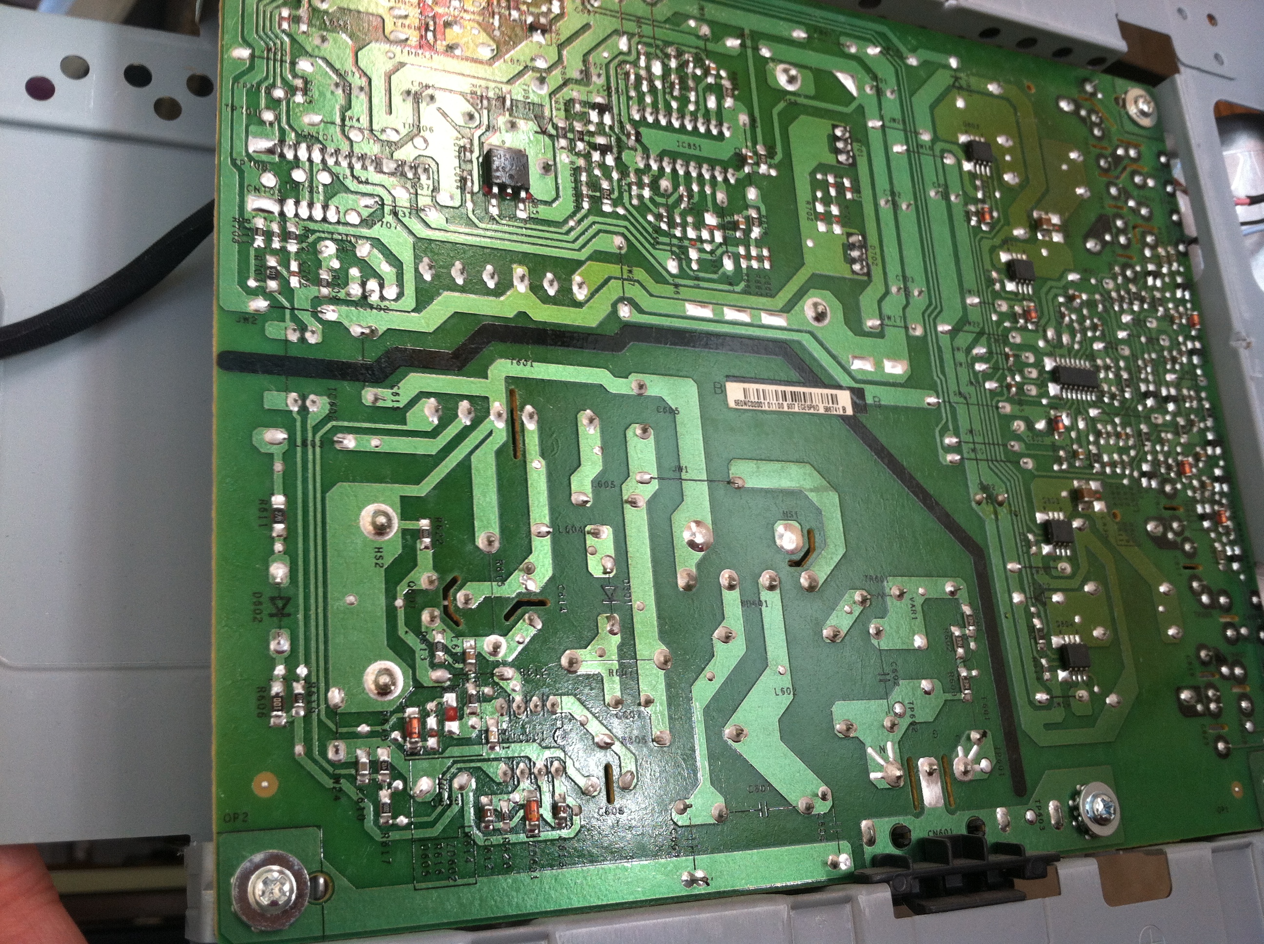

                  Re: ASUS vw246h no video

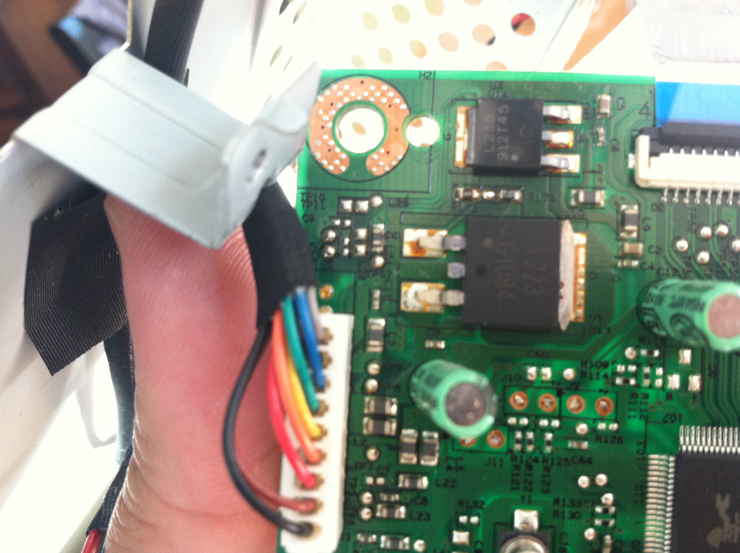

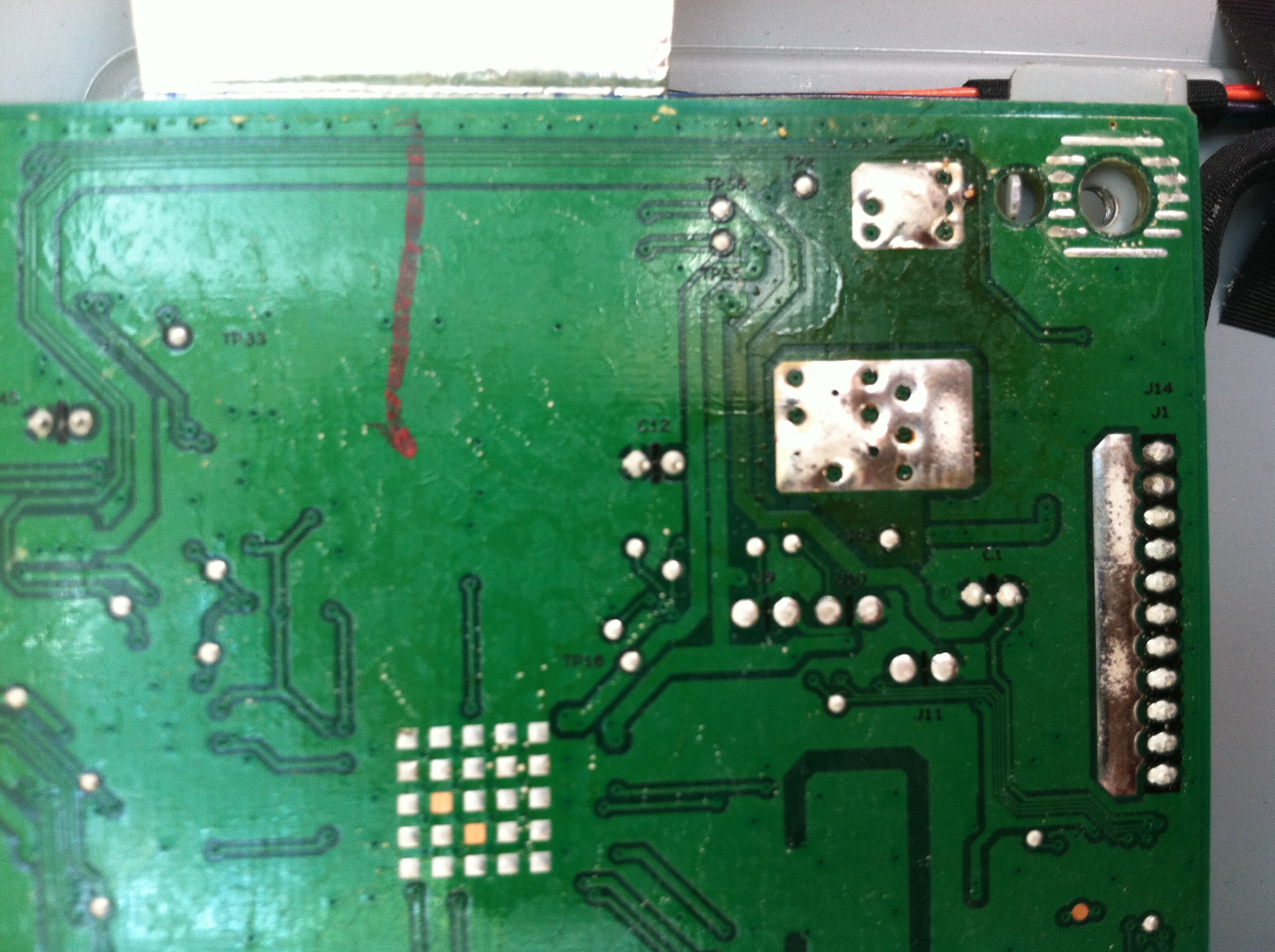

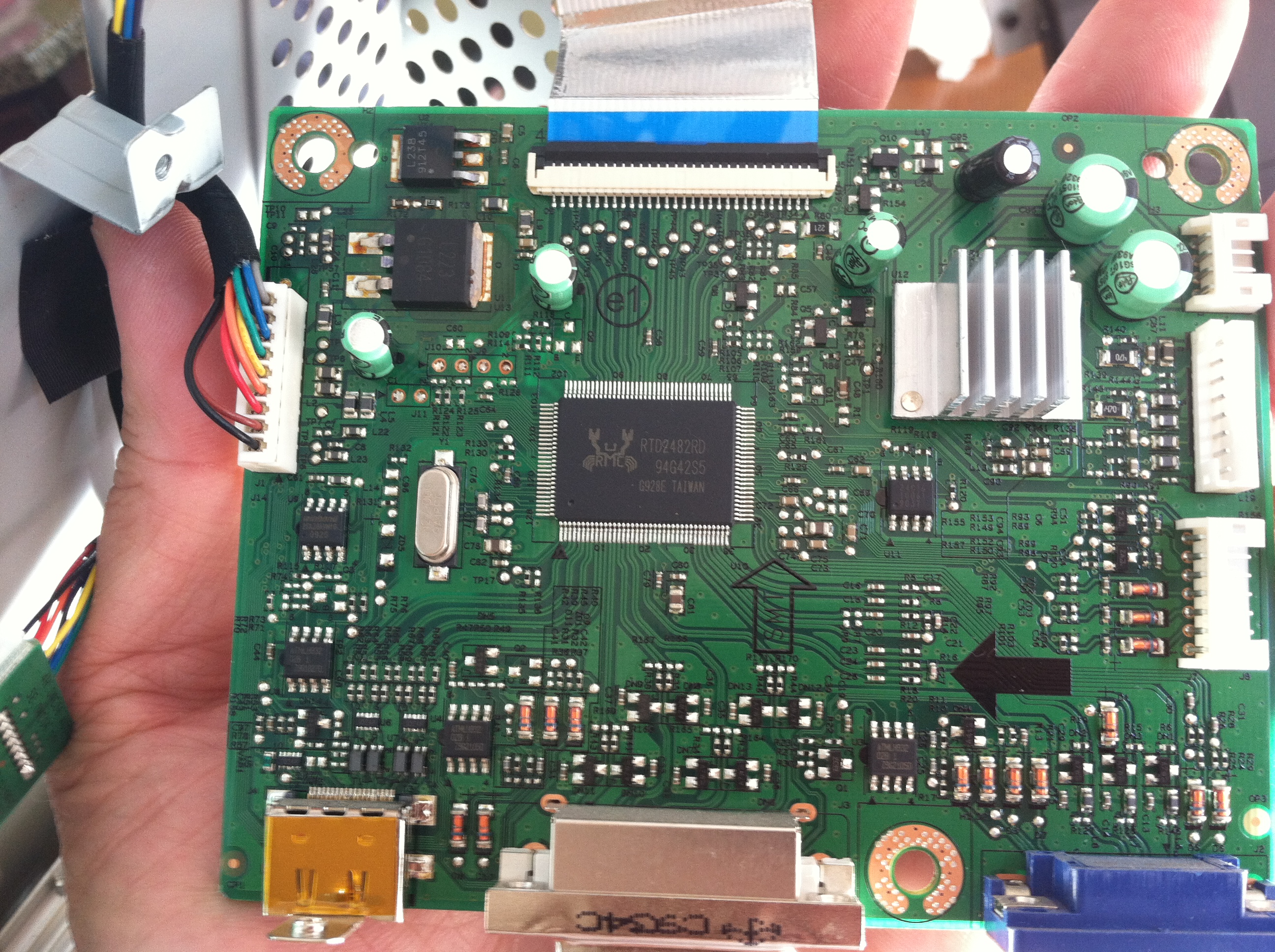

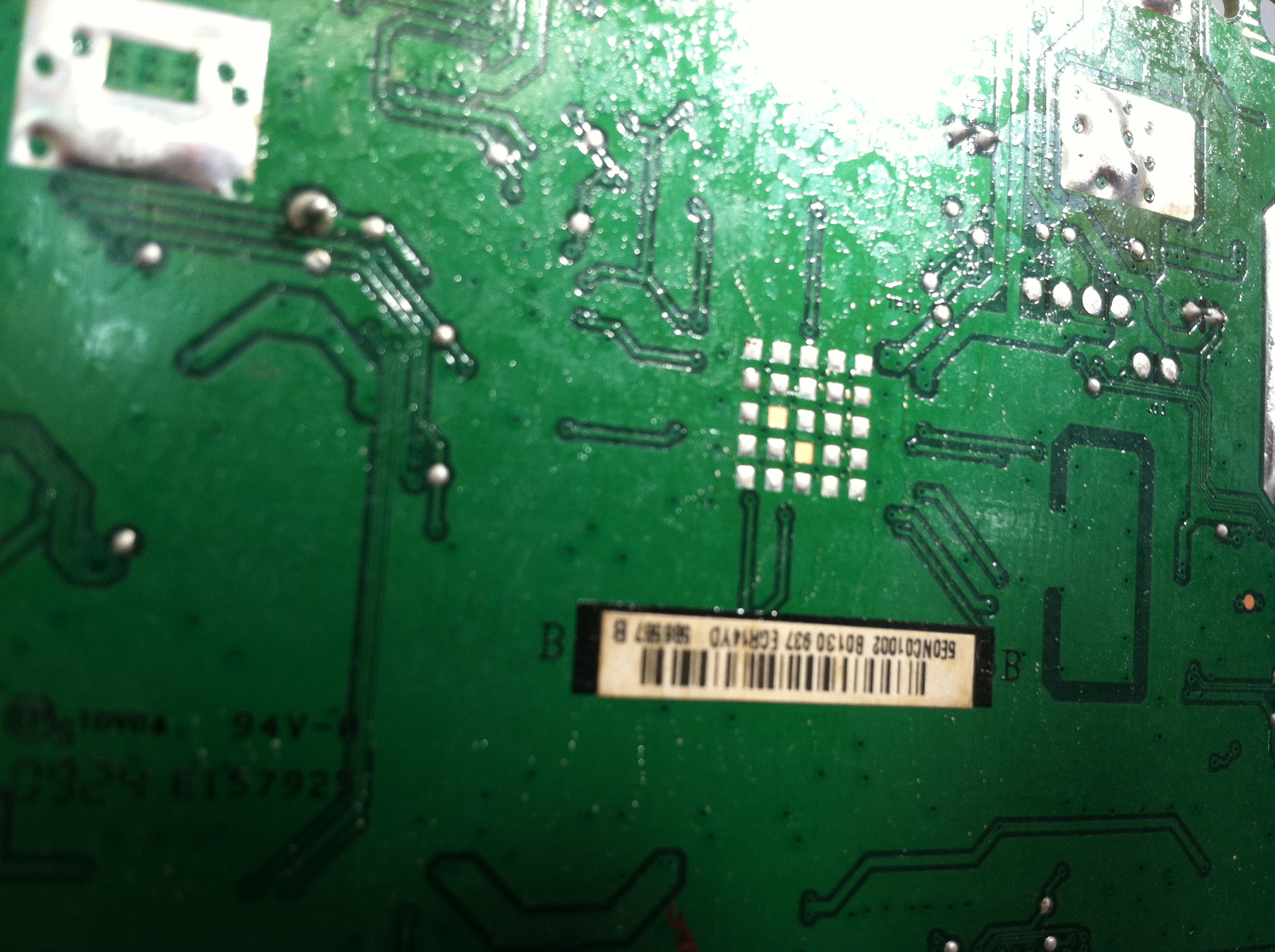

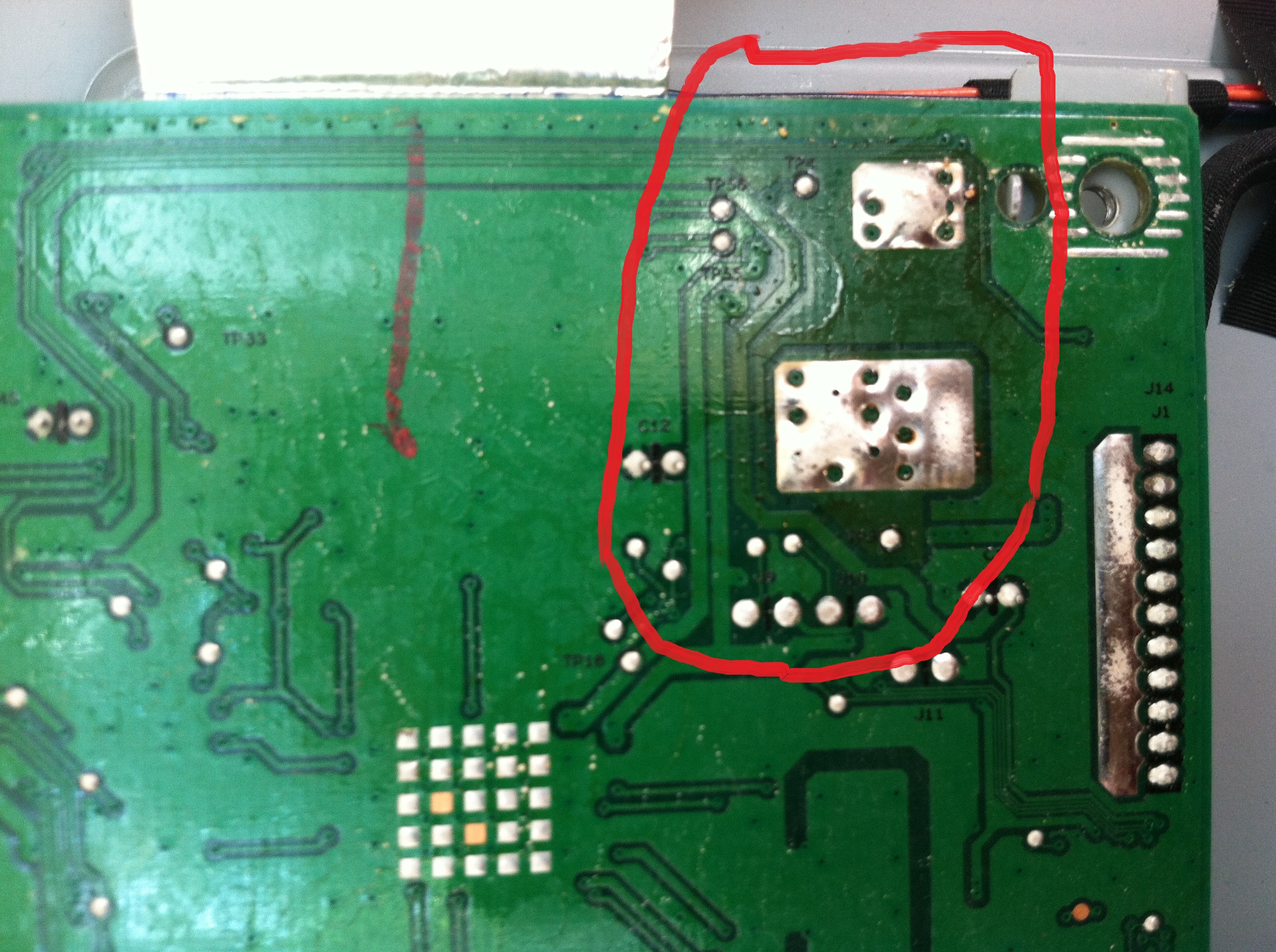

                  OK, so I finally got a chance to open this bad boy up. Took some good (i believe) pictures of the main board. I did see some discoloration on the PCB that I'll highlight in the pics (pics with MU at end are the marked up ones). Any insight would be greatly appreciated.
                    Were these the needed pictures?

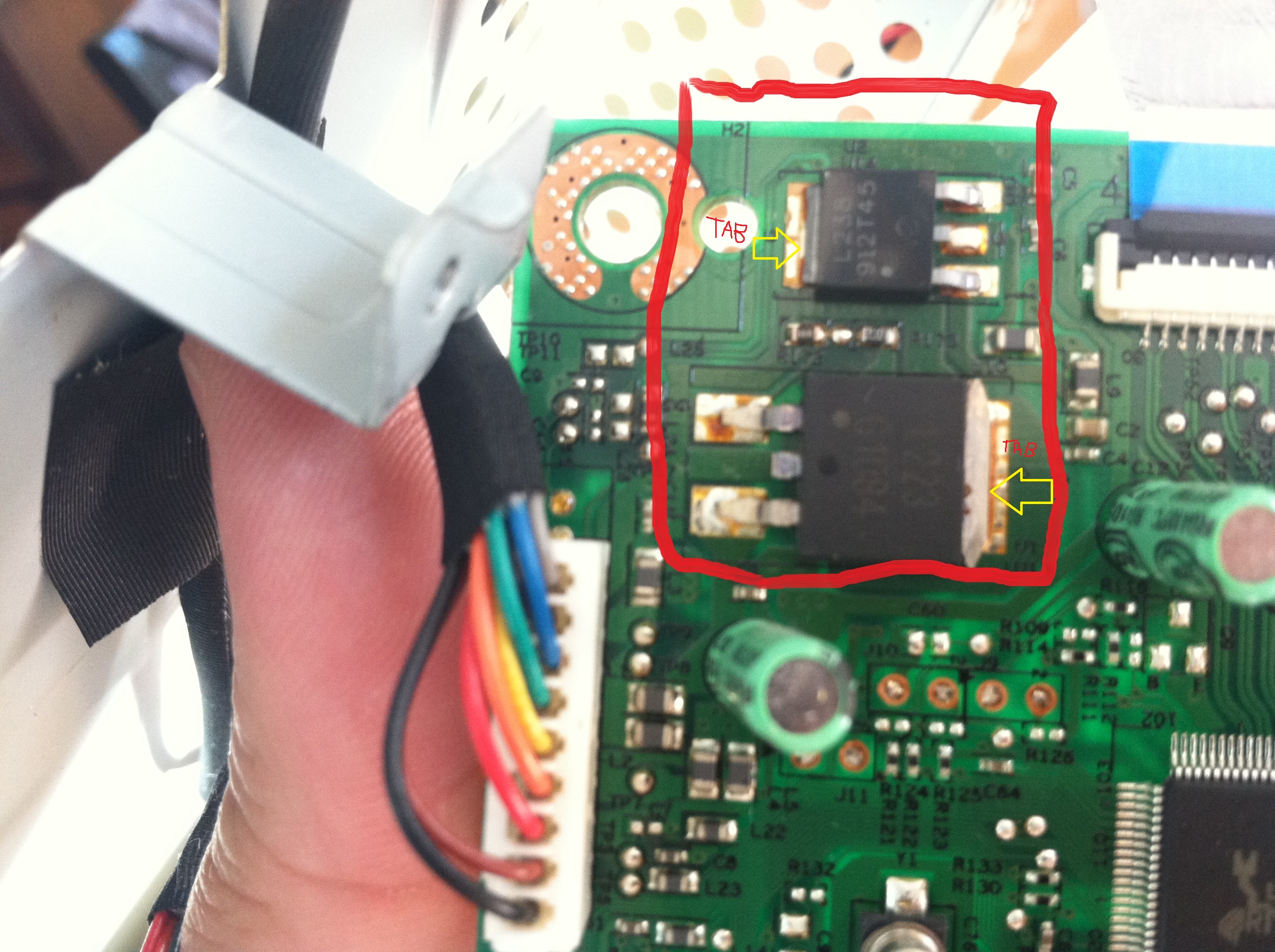

                      Can you please take the DC voltage readings of the two 3-pin voltage regulator IC on the top left corner of the board with reference to ground?

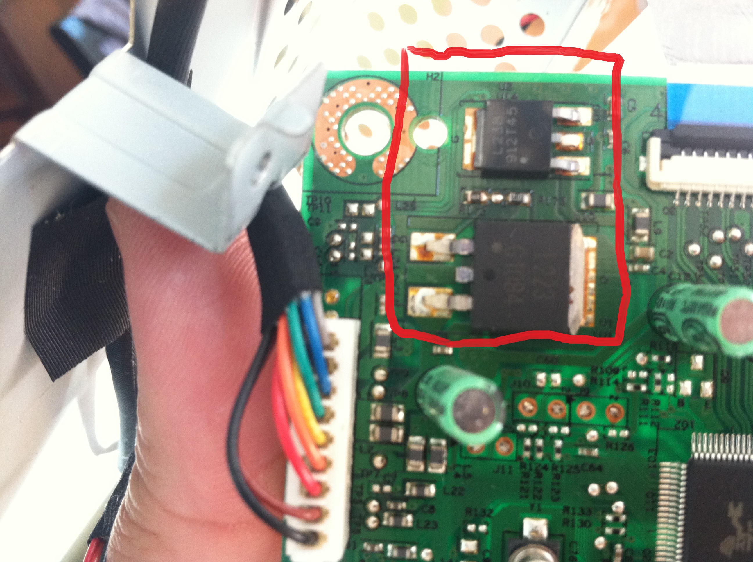

                        Pardon my ignorance, but I'm assuming you are referring to the IC's I have attached and circled on this post? If so, any indication as to which pin I need to check voltage at, and also helpful would be a recommendation as to where to get a good ground reference. Lastly, I'll have to double check that I can get all ribbon and other cables connected (so I can power on for voltage readings) and still have access to the upper side of the IC for these readings. Any suggestions here would be greatly appreciated.
                        Part of me is wondering if the best solution would be to obtain a new main board (http://www.shopjimmy.com/asus-5e-0nc...for-vw246h.htm ...I know they are out of stock), however, I would love to fix this on the cheap if possible.
                          Yes those are the one. Just report the reading on all 3 pins (just make it as 1, 2, 3)
                              I would put your black meter probe on the tab. And then your red probe on each of the other leads and record the readings. If the readings don't work out then reverse the test leads when taking your readings.

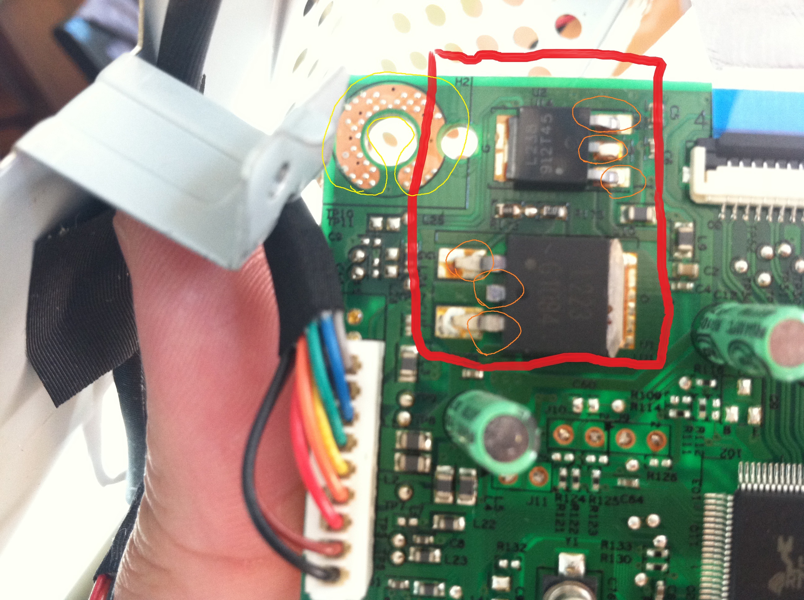

                                Any of the points within the yellow perimeter i've drawn will be tied to ground, place your com probe (black) across a few of those carefully and with your meter on dc voltage take a reading of each of the pins on both ic's, start at the top and record them as...
                                3-
                                2-
                                1-
                                1-
                                2-
                                3
                                  Sorry for the delay, just got a chance to do this. Please see below. From top down:
                                  3- 1.208 v
                                  2- 0v (no visible connection to pcb)
                                  1- 3.317 v
                                  1- 2.068 v
                                  2- 3.317 v (no visible connection to pcb)
                                  3- 5.053
                                  • alexsquared
                                    • Nov 2010
                                    • 40
                                    Do these look ok?
                                      This one needs verification. Is 3 the top pin? What voltage do you get (if 3 is the top pin) when you measure between pin 1 and 2. It looks like 1.2V regulator.
                                      3- 1.208 v
                                      1- 3.317 v
                                      This one shows OK, 1.25V vref + 2.068 = 3.318V
                                      1- 2.068 v
                                      3- 5.053
                                        Those are 2.5v and 3.3v regulators respectively. I'm assuming pin 1 is the input and pin 3 is the out..
