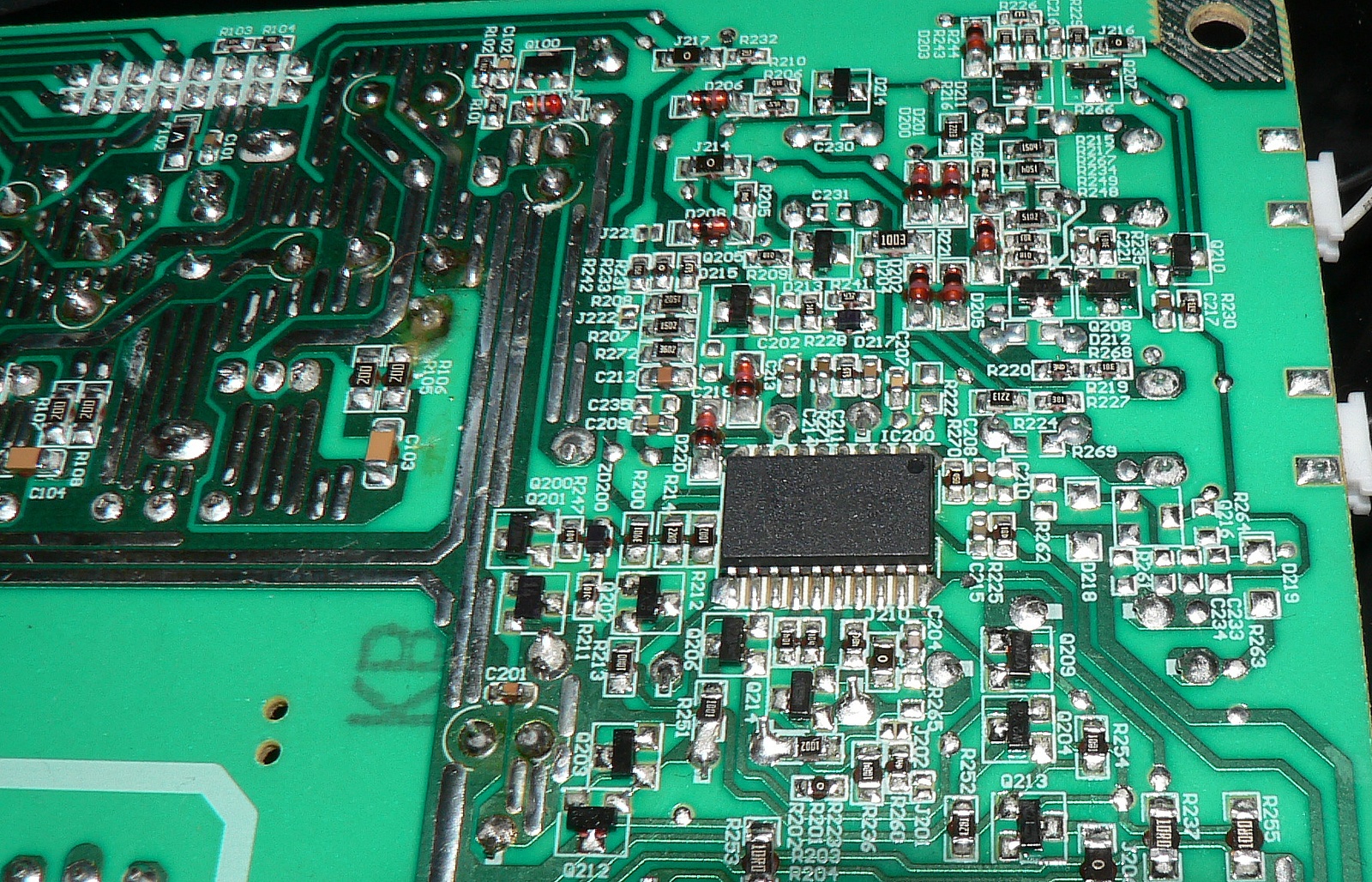

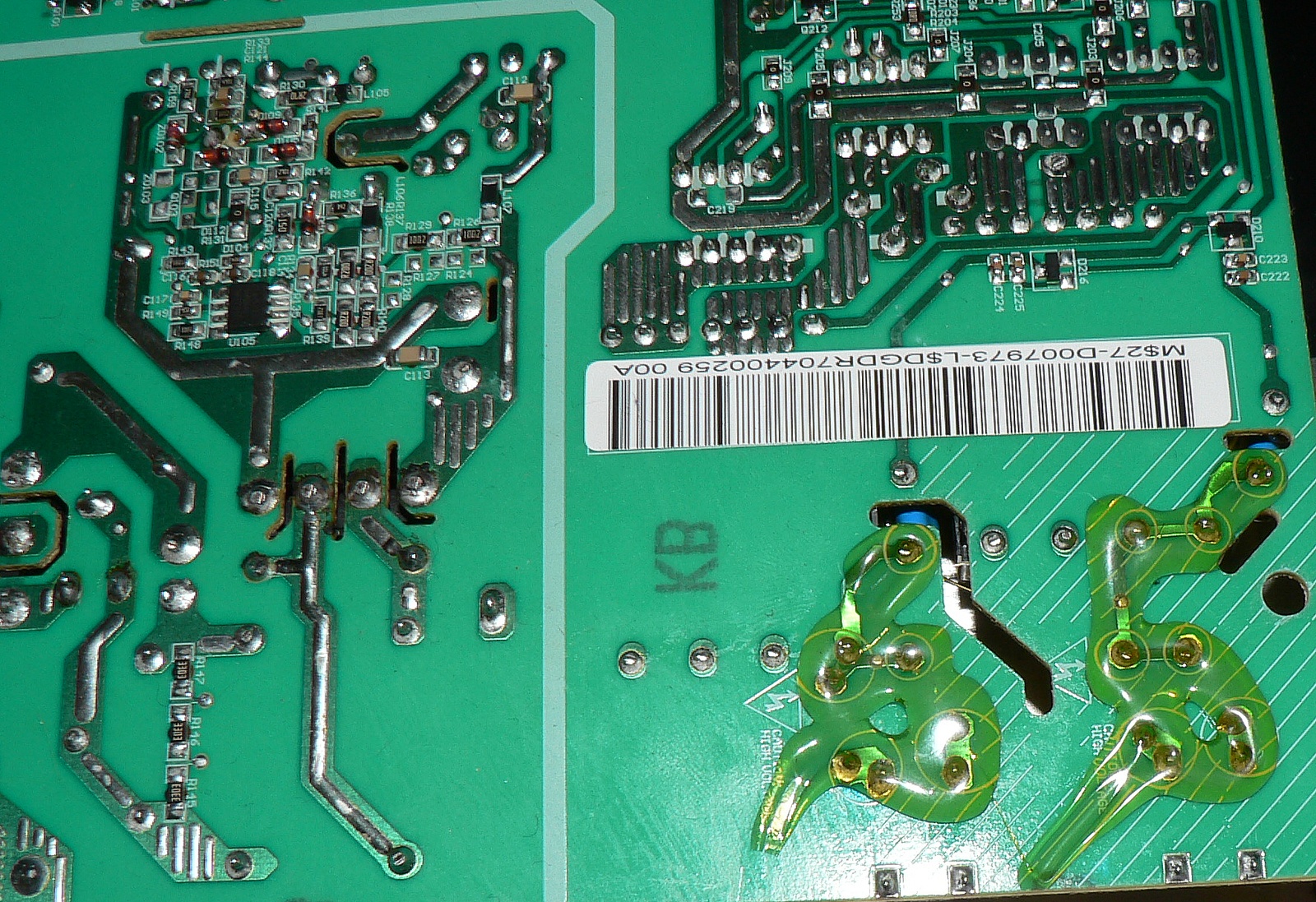

      Here are the images finaly, if you can advice comething from it, would be cool
      ATM, there are some caps recapped, some original as I tried if the problem is not in in too low ESR of replacements and so

              Re: Acer AL1917 restarting
              These boards also have SMD fuses on the bottom. Check the one I circled in red, and any others you might find on the bottom.

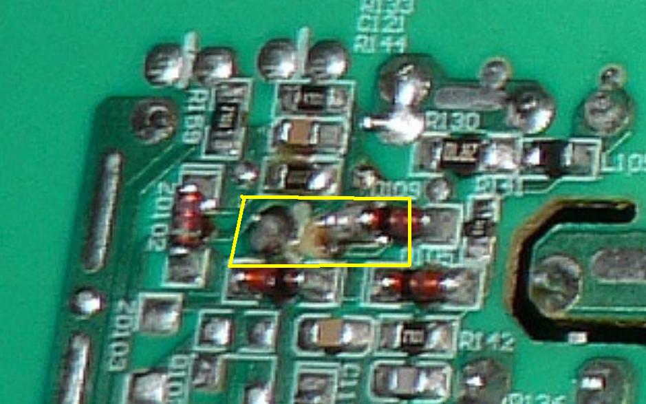

                                I think I have found the problem. When changing one small capacitor, I have burned tiny path near to it. I have connected the cap to one joint of the path but didn't notice it was actually interconenction between two parts of some circuit. After joining it with piece of wire, it behaves more normally. Now I need to get some VGA cable to test it

                                      It's on the picture 4 of 5, bottom left corner with the SSOP-8 chip. You see there is the bad soldering with crystalized dump of solder, several centimeters north from the chip in them iddle between three SMD diodes? That's where I've burned the trace. As the problem was with el'cheapo PCB combined with my 125W soldering pistol, I think it is not usual actually
                                        Thanks for that - just to be sure - you mean the area in the yellow box?
                                        Surprised with a 125W there wasnt a hole right through
                                        Amraks has a similar problem - destroyed the same trace - I think.
                                          both sides are destroyed.
                                          so negative side.
                                          wondering were the negative side leads too.
