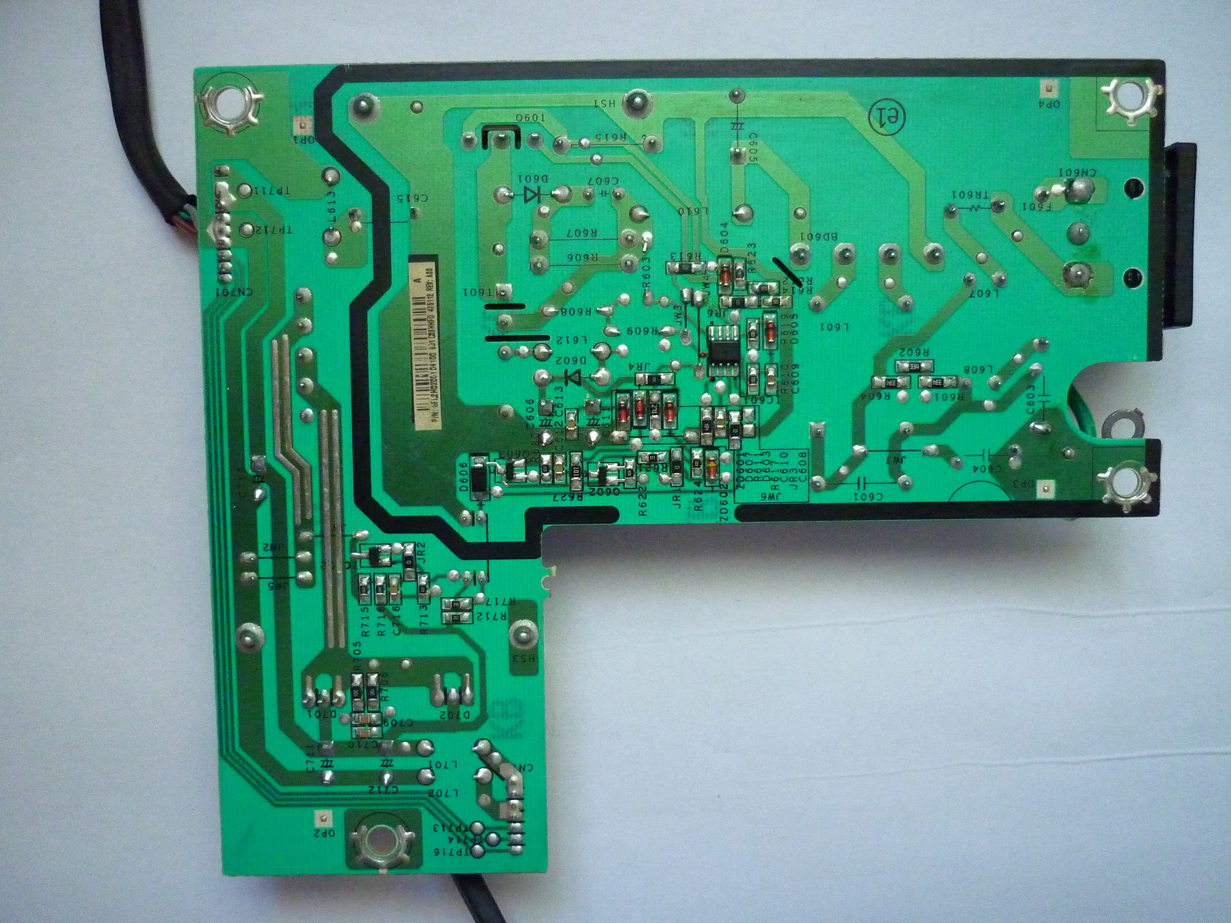

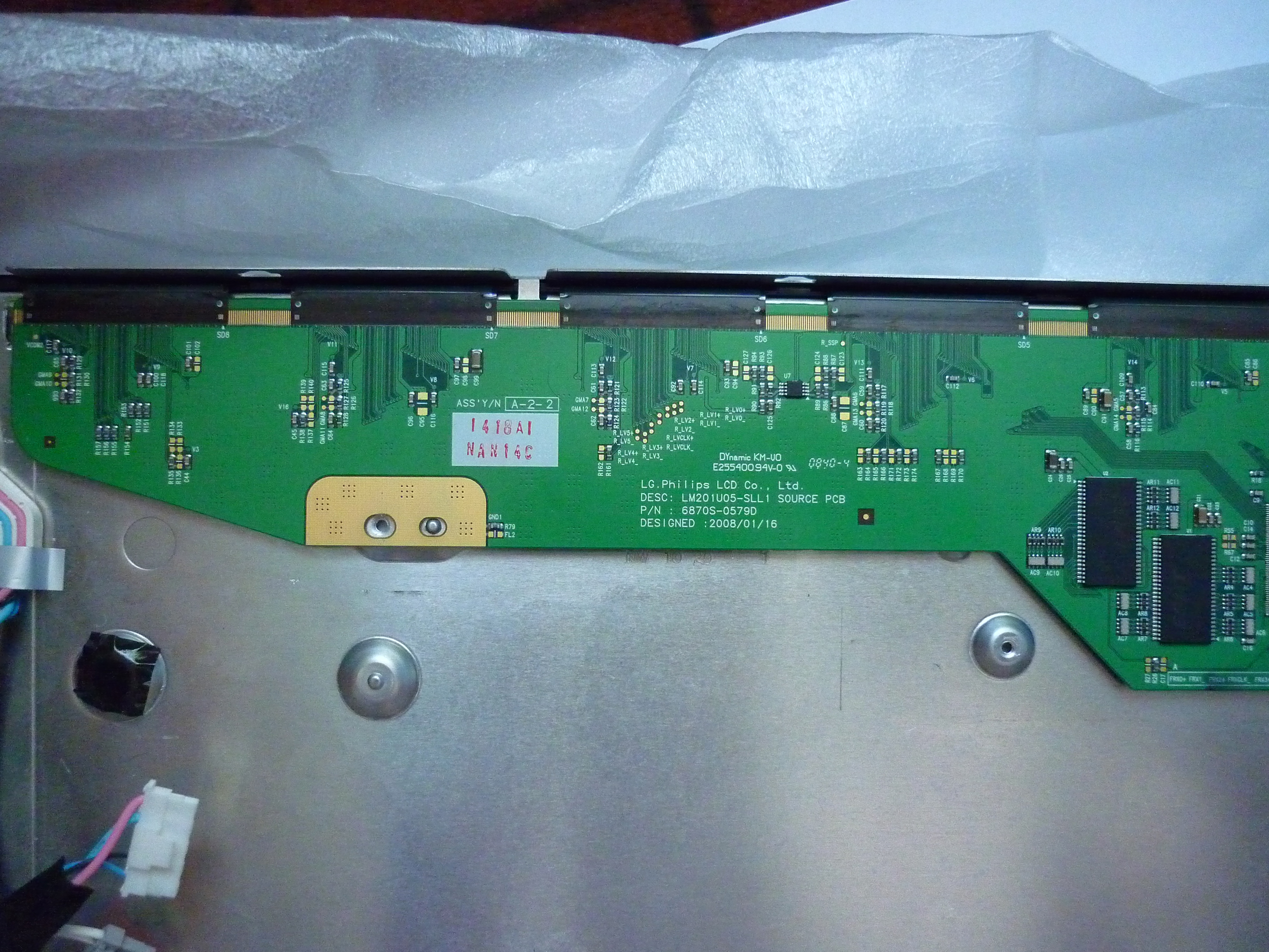

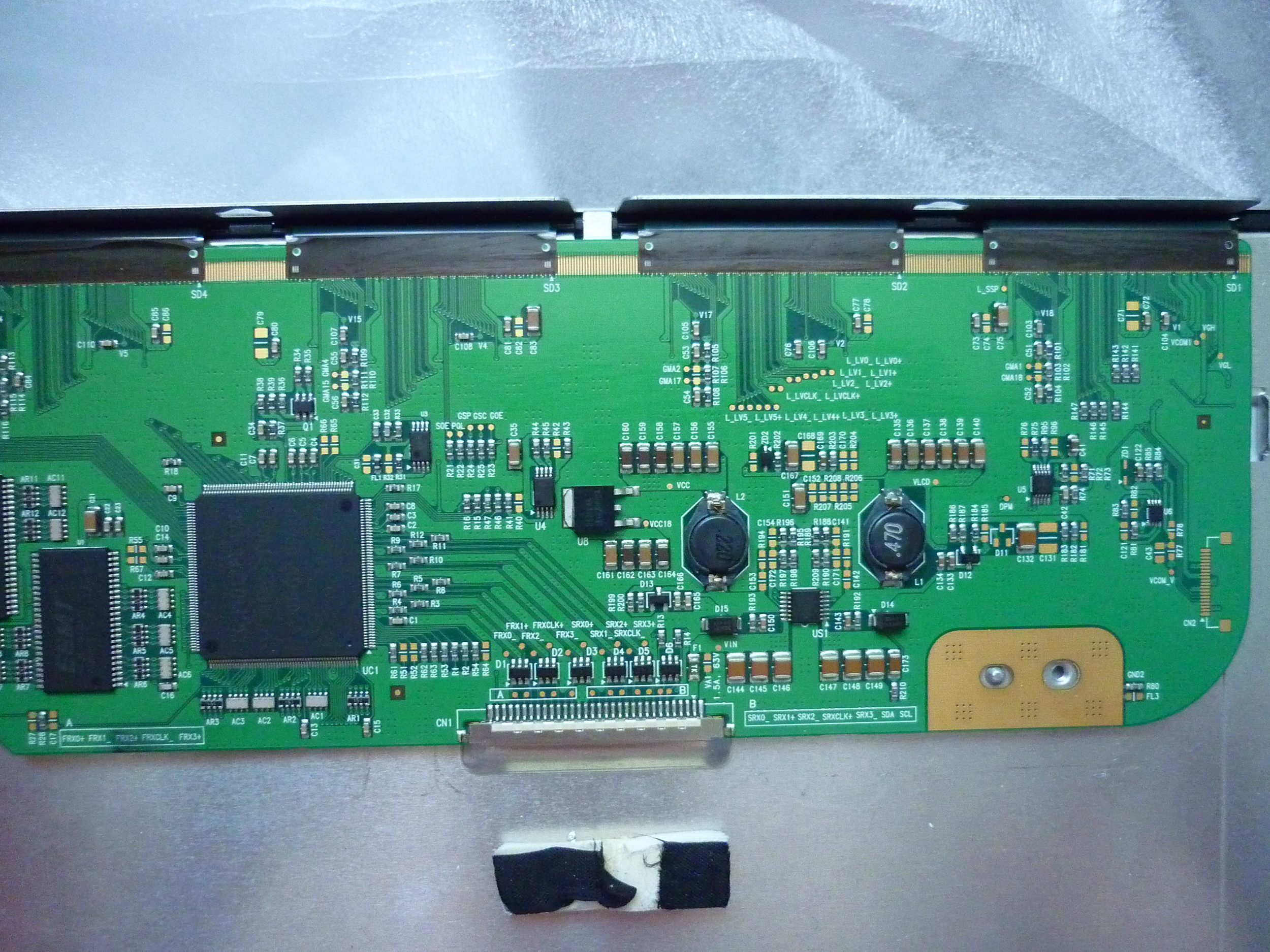

    Hello everyone, i got, a problem with my LCD, suddenly the screen goes black one day and i'ts stay way . The backlight from specific angle is purple/amber ( hard to figure out which colour it is ), the power on diode is green, and everything seems ( i say seems ) to be ok. I just replaced all capacitors to new ones, measure the resistance of the tranformers, and they are like the new ones.
    One thing is strange but in electronic nothing is strange , that from lcd logic board ( the PCB attached to the LCD ), i hear strange noise from L1 ( 470 ) part, like it has some kind of short curcuit/transformer damaged noise. http://obrazki.elektroda.pl/7538632000_1346320971.jpg
    I had also measure voltage of that logic board, and measurements are extremely strange, and i do not know what causes that kind of abnormal readings :
    With power off, with power cable attached :
    VGH - 3,3V
    VGL - 0V
    VGM - ?
    VLCD - 0
    VCC - 0
    VIN - 1,8 and it falls
    With power on with power cable attached :
    VGH - 0,13V
    VGL - 4,1V
    VGM - ?
    VLCD - 4,99V
    VCC - 8,34V
    VIN - 18,37V
    If anyone got some kind of tip to direct me what do i have to chedck and what o have to replace to be able to work in frony of my LCD, i will be appreciated.
    Best regards
    Thomas
    The other photos of inside of that LCD :
    http://obrazki.elektroda.pl/6251092200_1346320973.jpg
    http://obrazki.elektroda.pl/3115375600_1346359505.jpg
    http://obrazki.elektroda.pl/1209913500_1346359507.jpg
    http://obrazki.elektroda.pl/3416521700_1346359509.jpg
    http://obrazki.elektroda.pl/3513090000_1346359511.jpg
    http://obrazki.elektroda.pl/5415896500_1346359513.jpg
    http://obrazki.elektroda.pl/2920540900_1346359515.jpg

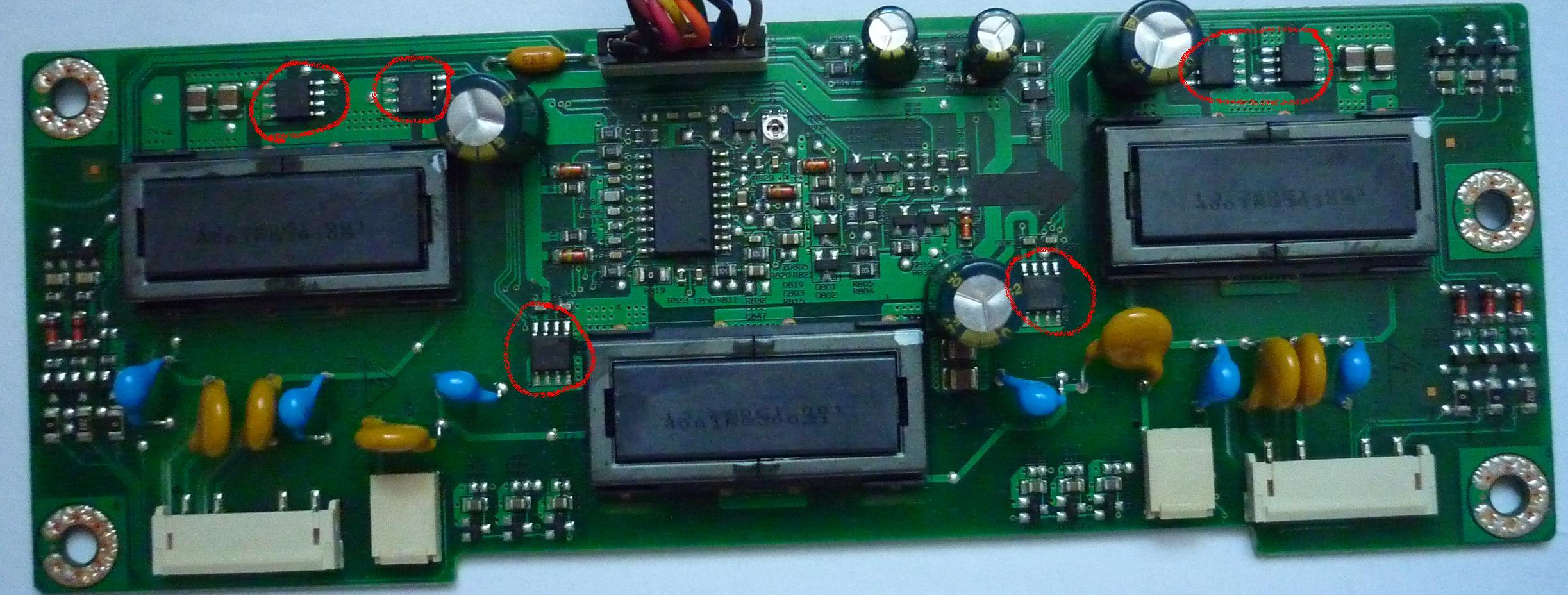

            Okay, if the backlight does not come on at all and the power LED is green, then the problem is likely in the inverter section. I circled 6 mosfets which I believe are SP8M3.
            http://pdf1.alldatasheet.net/datashe...OHM/SP8M3.html
            If correct, test to see if the 6 mosfets are shorted or not following the procedures in my guide (section mosfets)
            https://www.badcaps.net/forum/showpo...4&postcount=19

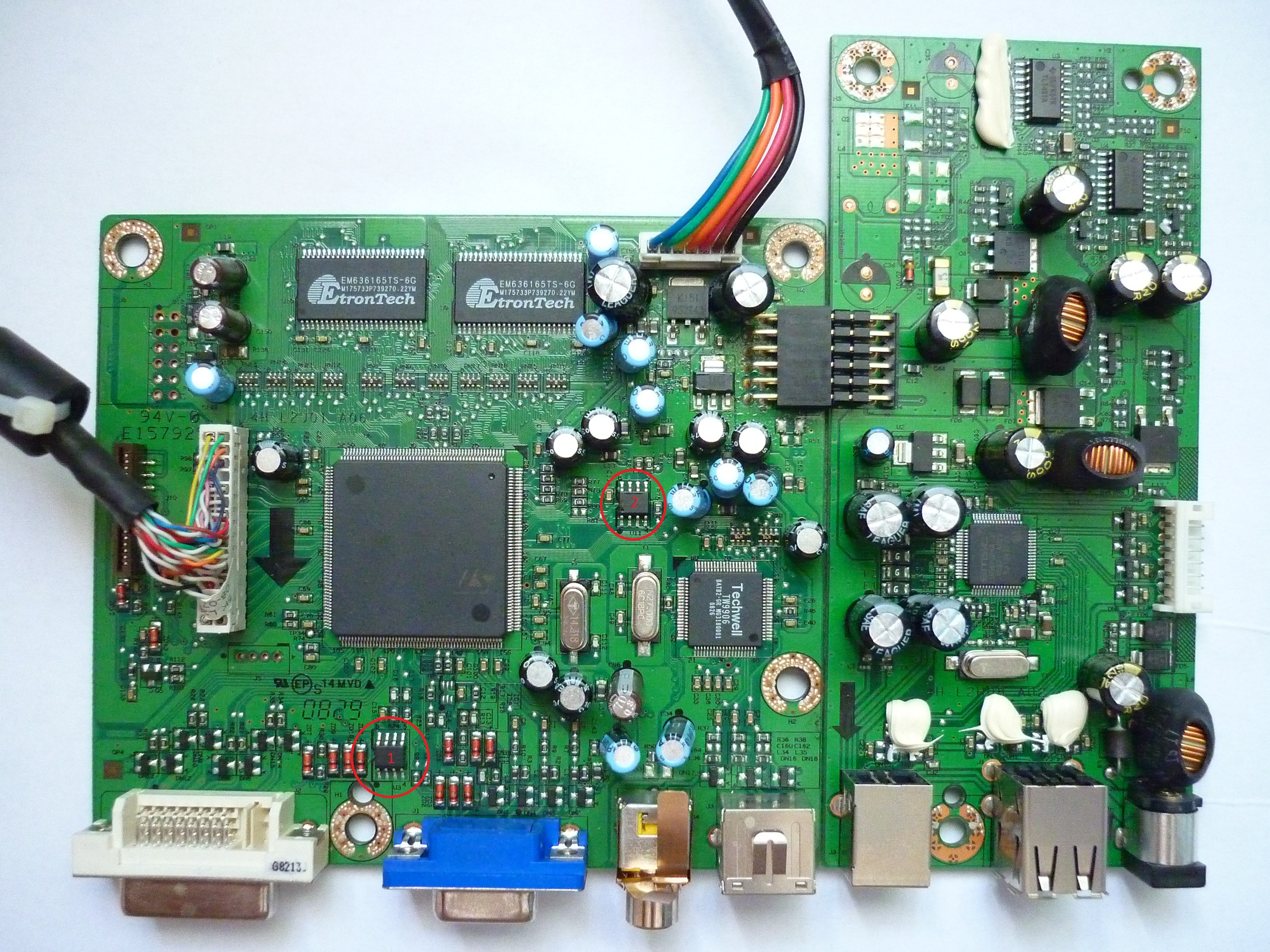

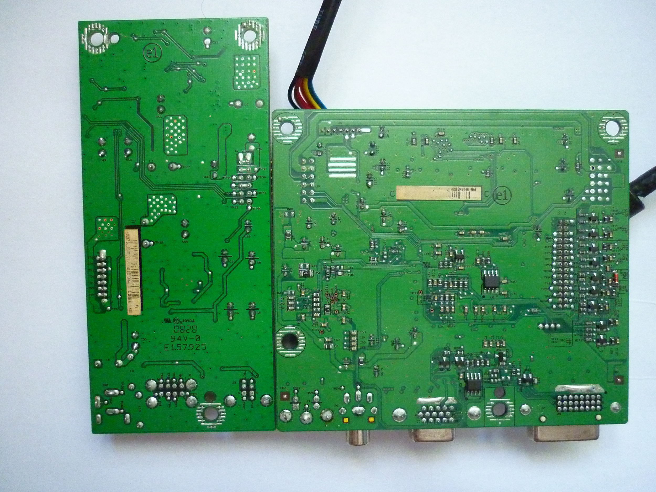

              Re: DELL 2007FPB - black screen - power diode is green - backlight is purple/amber
              Hello, in first i want to thank You for trying to help .
              I am just after measurments of those mosfets, and they do not have shorten pins.
              But what i had notice, after Your tip i measure other parts, and. in picture that i attached i point 2 eeproms.
              The 1 eeprom have a shorted pins 1/2, 1/3, and 2/3, i compare those measurments to the 2nd eeprom that i circled which is i think good.
              Tell me if it is possible that this eeprom chip is really damaged ? And what i have to do to replace it, and because it's an eeprom memory so i have to after replacing it flash it i think but i can be wrong.
              Cheers
              Thomas
              • madfreak
                • Aug 2012
                • 133
                • Poland
                1st one : ST 24C02RP ( in bottom line K823G )
                2nd one : 25x40VN1G ( in bottom line 0821 )
                Cheers
                Thomas
                • retiredcaps
                  • Apr 2010
                  • 9271
                  1) When comparing two totally different part numbers, you cannot assume they have the same pinouts.
                  2) If you look at the datasheets, you will notice that.
                  http://pdf1.alldatasheet.net/datashe...25X40VDAC.html
                  http://pdf1.alldatasheet.net/datashe...4C02RB1TR.html
                  3) For ST 24C02RP, pins 1, 2 and 3 are the chip enable inputs. If you look at figure 1 on the datasheet, it looks like they are supposed to be shorted together.
                  4) Now it is possible that the eeprom is corrupted which is causing your problem, but I have no way of testing that. The one possibilty might be to dump the eeprom and compare it with a known good eeprom, but that is beyond my skills and patience level.

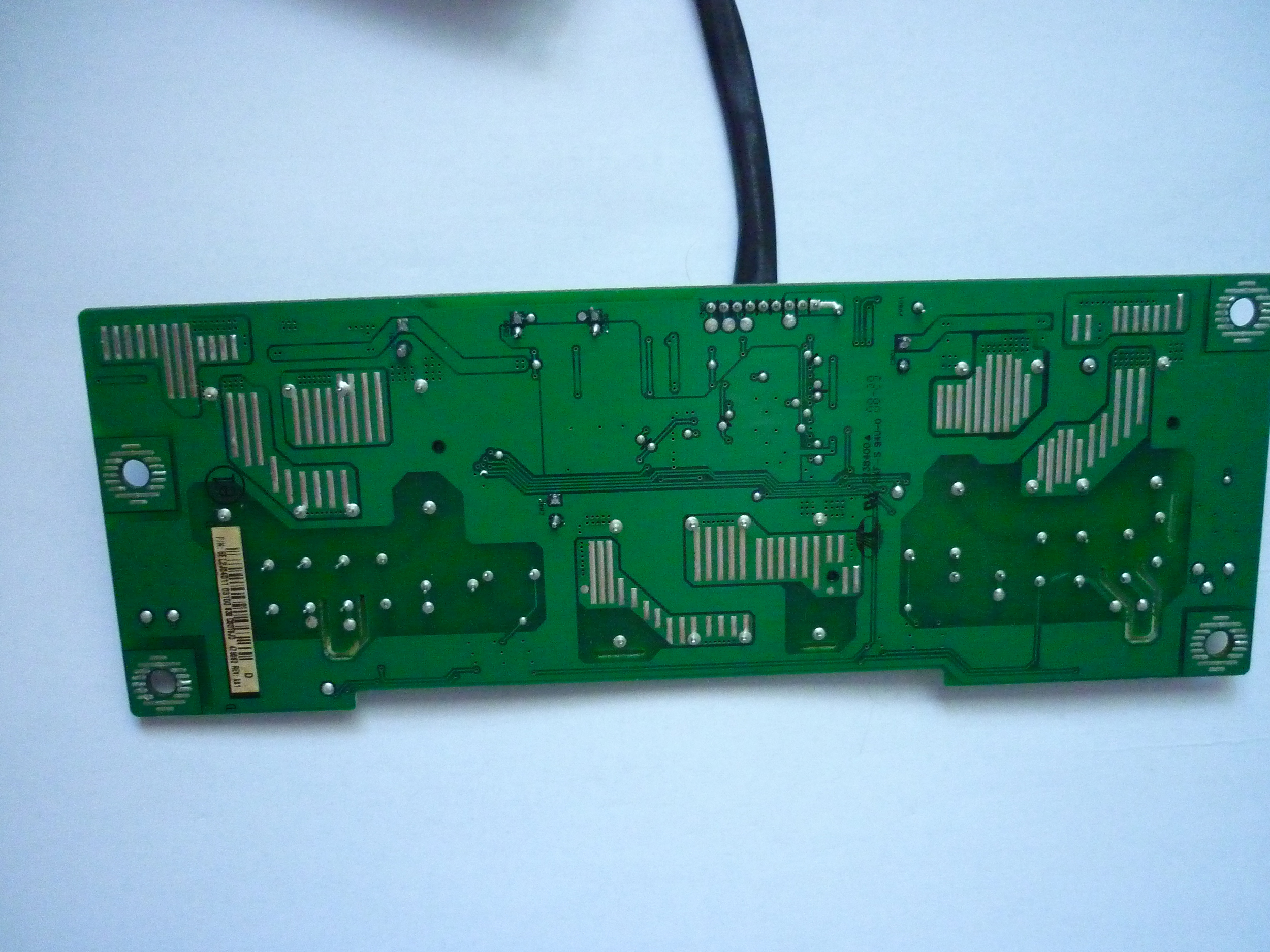

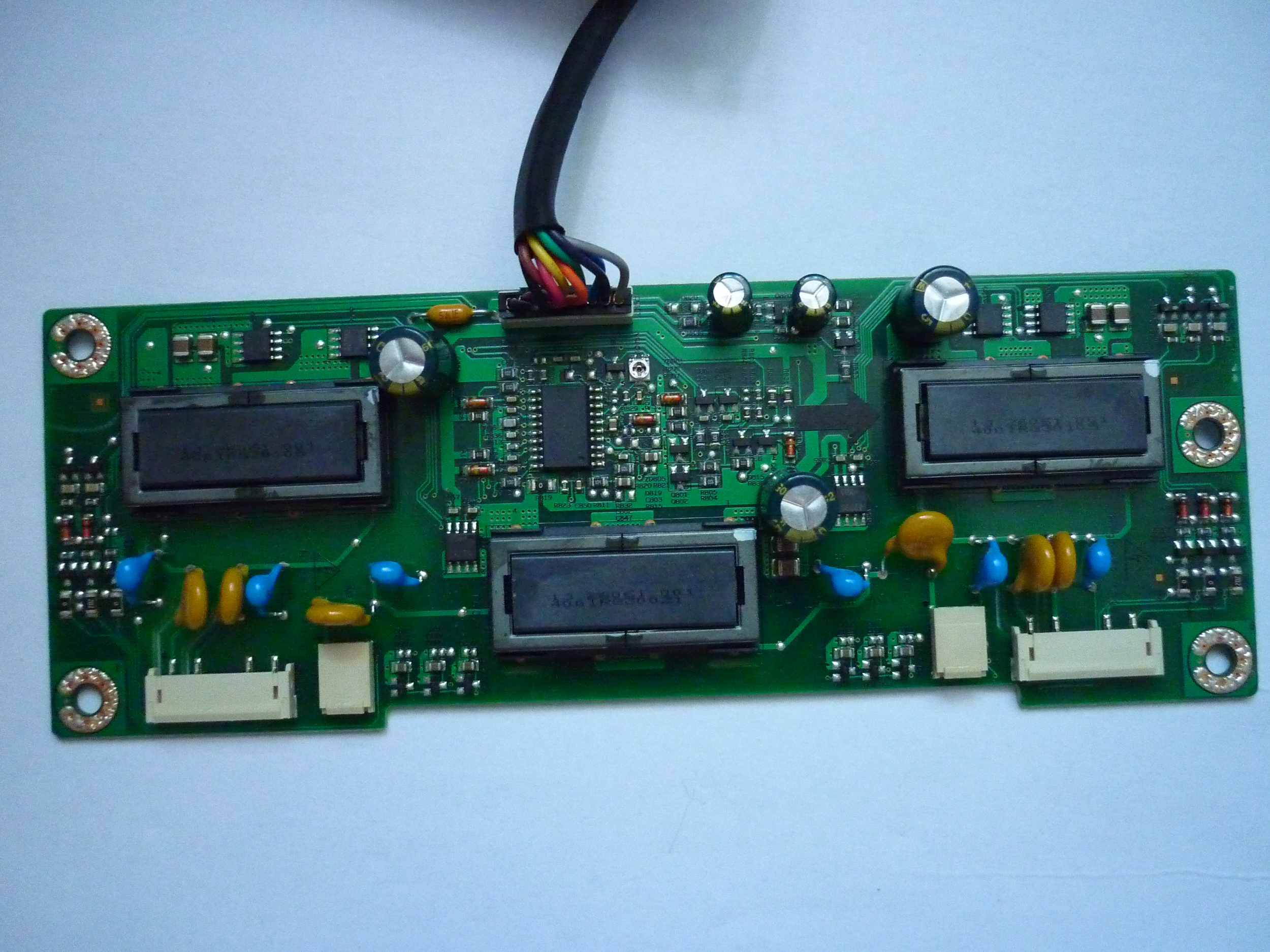

                  • retiredcaps
                    • Apr 2010
                    • 9271
                    1) On the inverter board, the pwm chip is OZ946GN (at least on mine).
                    http://pdf1.alldatasheet.com/datashe...2/OZ964GN.html
                    2) Refer to the datasheet for pinouts.
                    3) Pin 6 is GND.
                    4) What are the DC voltages for the other 19 pins using pin 6 as GND (or a ground screw)? List them all like so
                    pin 1 = 1.234
                    pin 2 = 0.003
                    etc
                    5) You will need steady hands on such a closely packed IC because you don't want to short out the component.

                      • madfreak
                        Ok . After 1,5 h of tries to solder thin wire to 6 PIN, i finally did it . (safety first ).
                        Here are my measurments :
                        PIN 1 - that is strange pin i got different readings, first when i push power on button and connect to that pin multimeter it shows 1.8V and it drops slowly to 1.6V, then after some time ( for ex. 1 minute ), it shows 2.5V and it show it all the time
                        PIN 2 - 0.63V-065V
                        PIN 3 - 2.56V
                        PIN 4 - 4.86V
                        PIN 5 - 5.16V
                        PIN 7 - 3.23V
                        PIN 8 - 0.56V
                        PIN 9 - 1.2V
                        PIN 10 - 1.45V
                        PIN 11 - 2V
                        PIN 12 - 2.63V
                        PIN 13 - 1.5V
                        PIN 14 - 1.39V
                        PIN 15 - 1.15V
                        PIN 16 - 0V
                        PIN 17 - 0V
                        PIN 18 - 0V
                        PIN 19 - 2.61V
                        PIN 20 - 2.02V
                        If that chip is damaged i will be so happy, because it's cheap as hell , but i think that it will not be so easy .
                        Cheers
                        Thomas
                        • madfreak
                          • Aug 2012
                          • 133
                          • Poland
                          I am curious, what do you see on the back and on the front of the panel when look at it in a dark room?
                          I see that the backlight is on because light is coming from back of the lcd, but screen is violet/amber/purple its some kind of combination of those colours ( it's one color but it's hard to figure out which tone )
                          • retiredcaps
                            • Apr 2010
                            • 9271
                            PIN 3 - 2.56V
                            From a quick cursory glance, the pwm chip is working correctly given the voltage readings above. Pin 3 is enable and the pwm chip is "ON" when the voltage is greater than 2V.

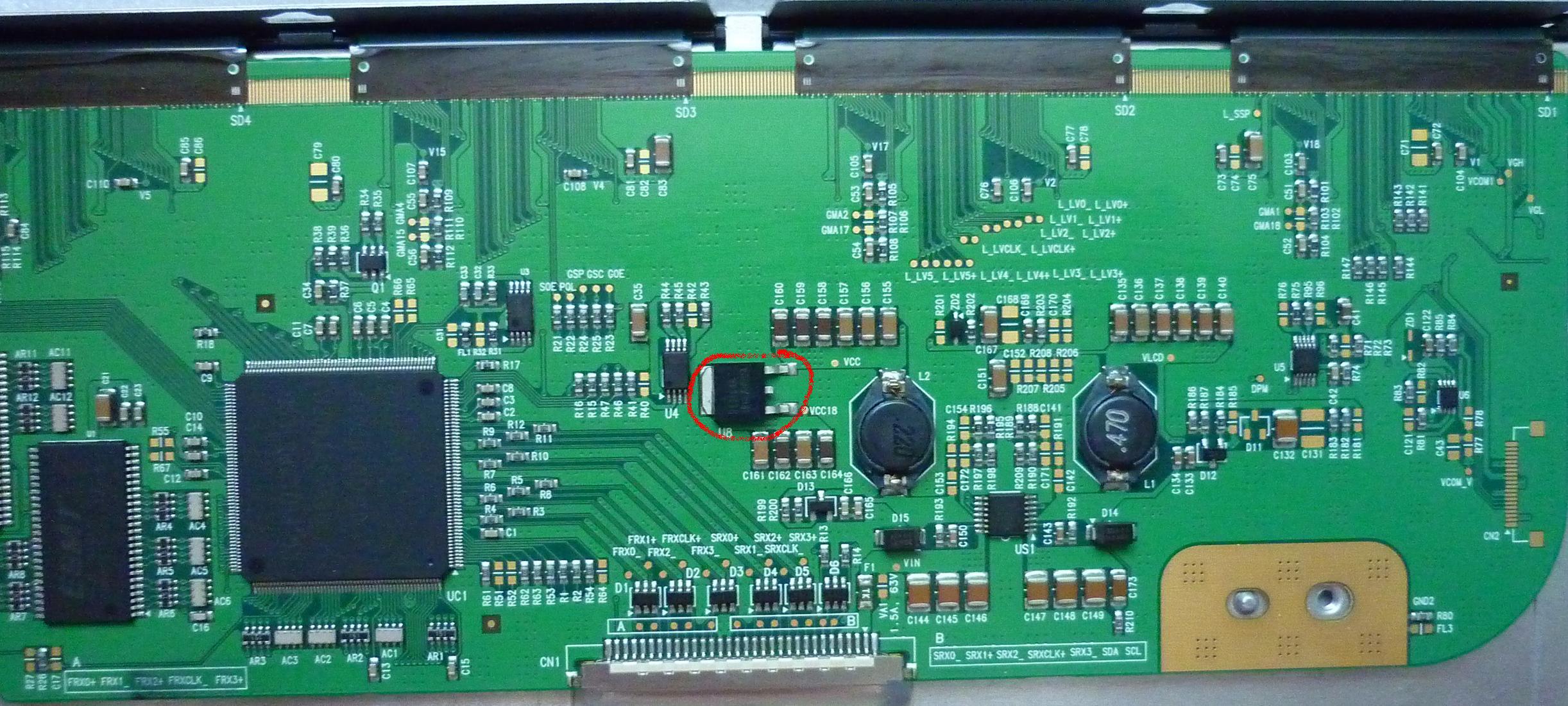

                              • retiredcaps
                                • Apr 2010
                                • 9271
                                U8 is a voltage regulator on the t-con or panel board.
                                Test it and report your results and the part number of it.
                                --- begin sig file ---
                                --- end sig file ---
                                • madfreak
                                  • Aug 2012
                                  • 133
                                  • Poland
                                  I got such a bad eye sight , from those whole years in front of computer. U8 is on back of that board with DVI, VGA etc ports ?
                                  It is 8 PIN. - ATMLH810
                                  • retiredcaps
                                    • Apr 2010
                                    • 9271
                                    See attached picture.
                                    • madfreak
                                      • Aug 2012
                                      • 133
                                      • Poland
                                      Part number RT9164A in bottom line 18GLAHU04
                                      From top to bottom as it is on that picture.
                                      PIN 1 - 0.83V - 0.84V
                                      PIN 2 - 0.67V - 0.68V
                                      PIN 3 - 0V
                                      • madfreak
                                        • Aug 2012
                                        • 133
                                        • Poland
                                        It seems like it is the problem, am i thinking correct ?
                                        It should show me 1.8V not those small measures ?
