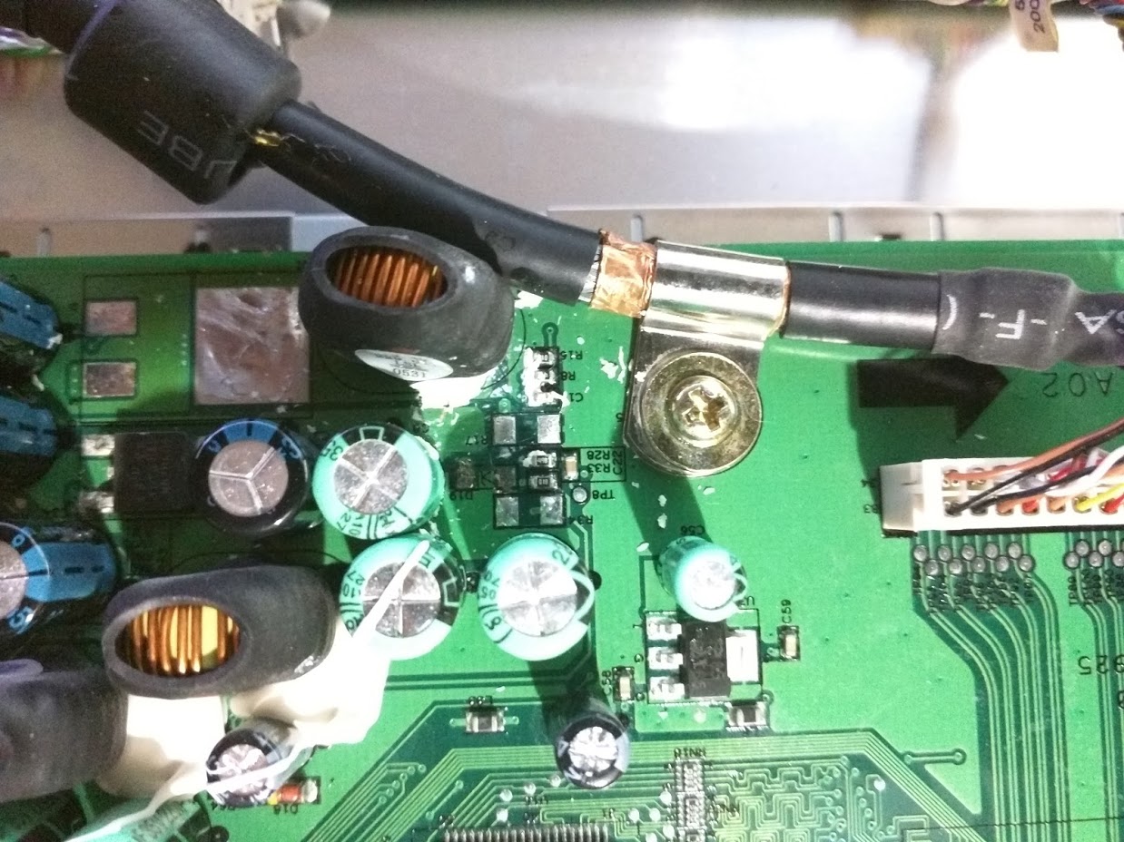

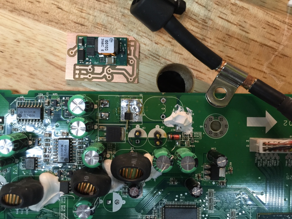

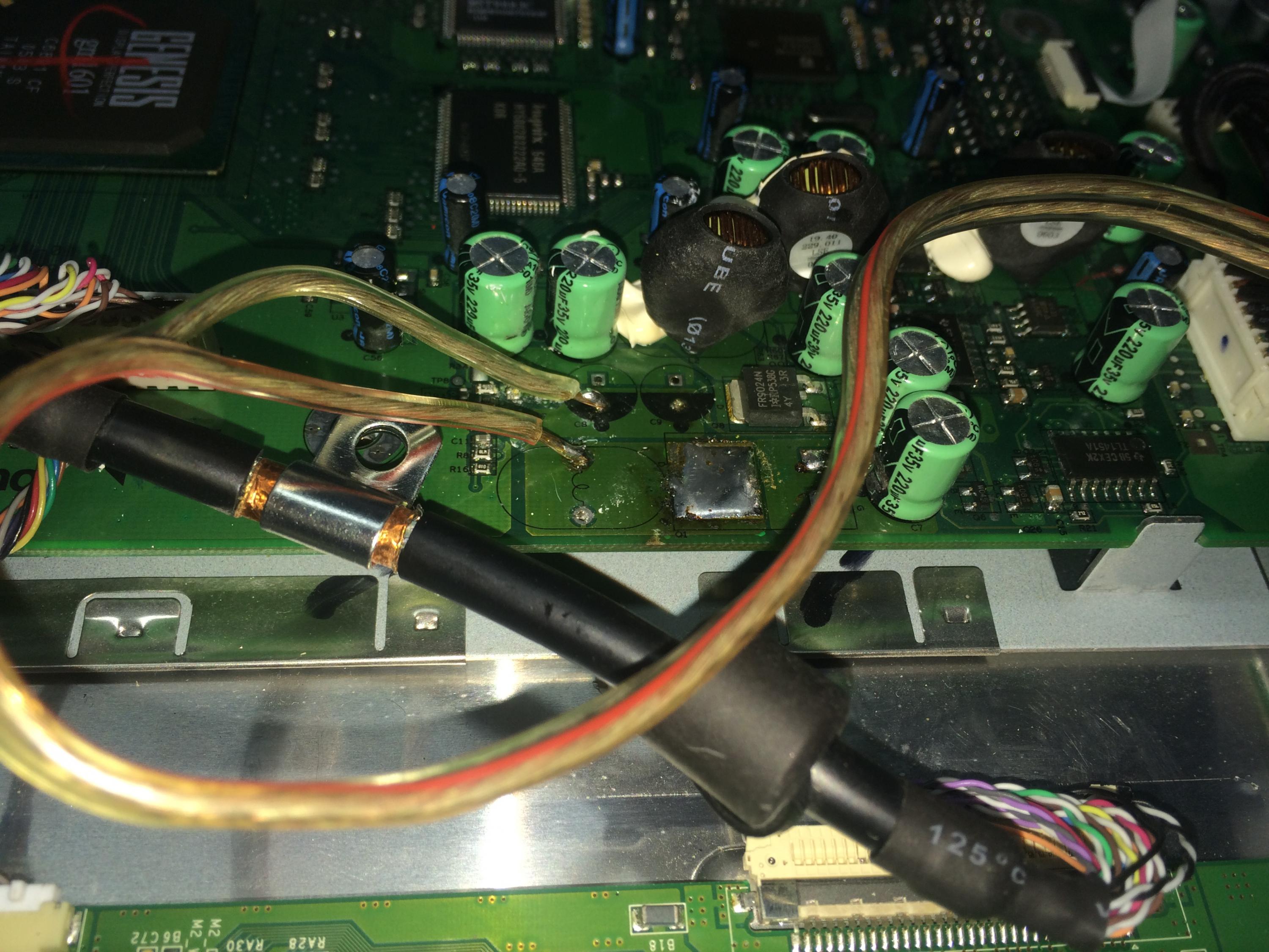

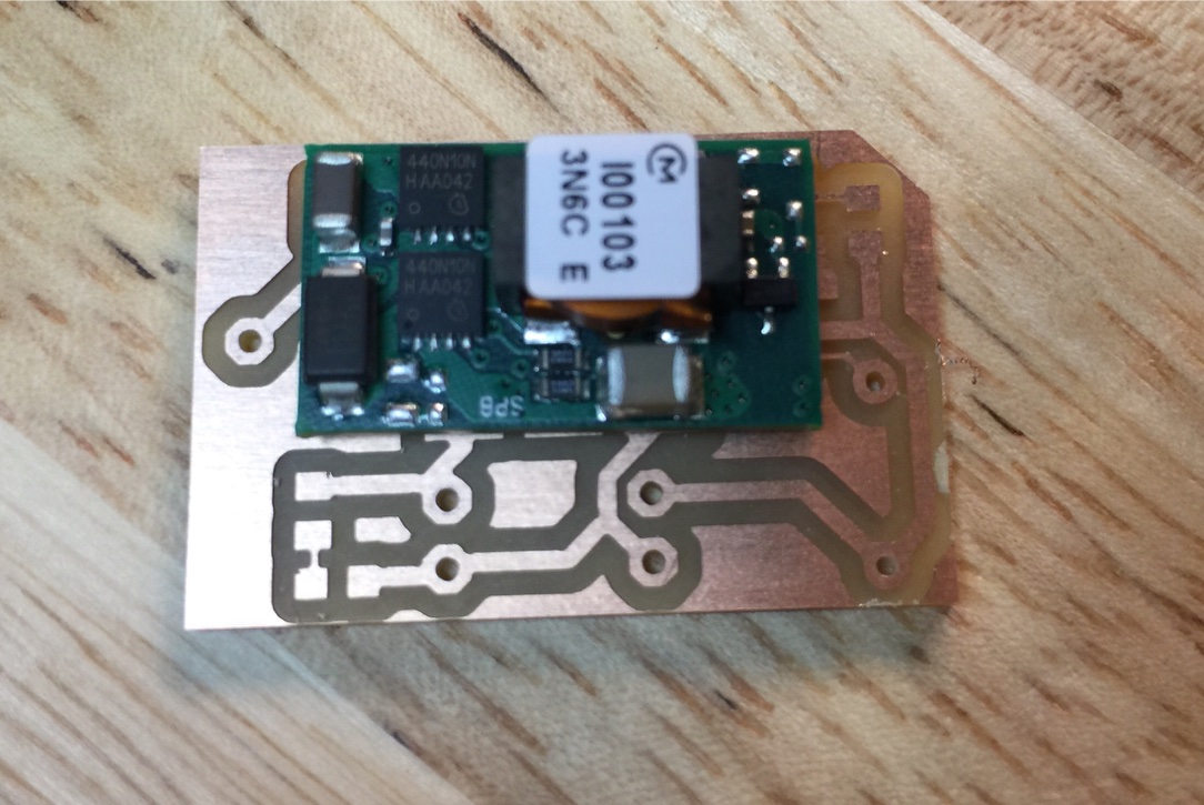

        So with the help of this thread, I've been homing in on the problem with my 2405fpw. I was only getting 1.2V on the drain of the MOSFET, so I went the route of replacing D19, ripping out the MOSFET, caps, and coil, and putting an SMPS module in its stead (same as others have done on this thread).
        Having a fancy Othermill and a DIY reflow oven, I decided to get fancier than tack-soldering in the SMPS. So I designed and milled a board, and then promptly destroyed the SMPS module when I was pulling it out of the reflow oven when it got caught on the temp probe and fell to the bottom of the oven. In case anyone is wondering, a surface-mount module which itself is a surface-mount board will in fact reflow a second time when you reflow it to your main board. And if it hasn't cooled down before it drops 3", the parts will come flying off the module.
        But that was only Stupid Part A. I ordered a replacement (two this time), and successfully reflowed it, tested, then installed onto the monitor's main board. And yes, I had 5V instead of 1.2V. And yes, the monitor came back to life!
        Now, Stupid Part B. Given how long this took, and how big the monitor is, I kept having to set it aside to work on other tasks. At some point (unclear where), I set it down on a surface I thought was safe, but was not. Big long crack in the screen---now it's junk.
        Clever Part A+B+C was to design and assemble my own daughterboard, which was designed to sit on male pins that replace the two caps for the output, and a bent pin to contact the Source pad on the MOSFET. Dimensionally I got the board 100% correct the first time---everything lines up perfectly (with some jiggering of the bent pin).
        Attached are photos of the board, a dry-fit of the 1st SMPS that eventually plummeted to its demise, and a shot of the whole thing in context, including the pins. The trim resistor solders to the holes on the right side of the board, and a surface mount LED and current-limiting resister get reflowed to pads on the lower left.

          To recover some of my mental health and see at least something good come out of all this, I am offering the following:
          • The first one to PM me can have the guts of the monitor for free. Power board, main board, driver board, USB board, CFL board. Take one, take 'em all. It has the daughterboard on there as a repair and seems to work here on my bench, even with a cracked screen.
          • The second one to PM me gets an assembled and tested daughterboard, plus header pins for mounting. I'll also include a surface mount 6.8V zener for D19. Clearing the existing MOSFET/Caps/Coil is an exercise for the reader (hint: it's not as fun as it looks), as is replacing the zener (which is easier than it looks, esp if you have any SMD hand-soldering experience at all).
          That's all I have left. The screen is a loss. The guts seem to work. I milled a spare daughterboard and bought an extra SMPS module which I likely will never use. May as well go someplace where it has a chance of being useful to somebody.

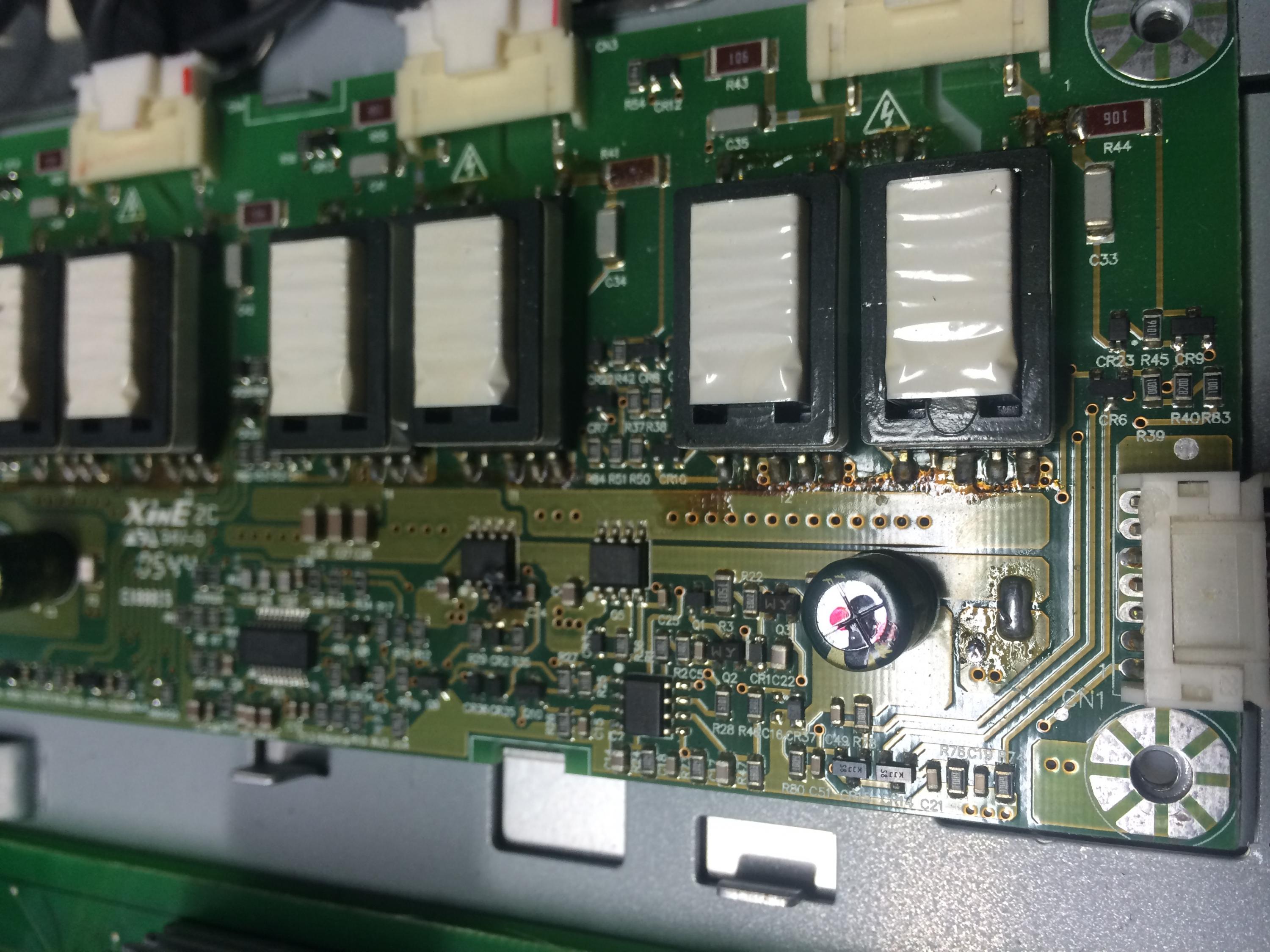

                Reviving an old thread here. Mine was a bit different, well the Q19 zener was shorted, no 5V, and q1 was blown. So i just removed the zener, q1 and 2 caps and injected 5VDC 5A as per https://www.cse.iitb.ac.in/~soumen/S...2405fpwRepair/
                Nothing still. While poking around i found a bad fuse in the inverter area. So i shored it, and i blew a transistor, named 4512C in the inverter, it catched fire. it's at the q4 location.
                I'm not going anywhere with that one, i can't see any display even with a flashlight of the please connect signal or anything. Upon connecting the power, the screen automatically powers on and the front panel buttons work. I see 22V and 7V at the power supply ! Any input would be great.

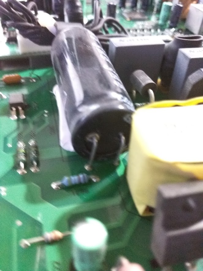

                  I've also come across a dead 2405fpw.
                  F701, Q1, and D19 need replacement. As well, the main cap is oozing, squeals when off, and isn't able to provide a stable voltage (varies between 61v-64v).
                  D19 exploded and took out the solder pads. Looks like the unused R17 is a suitable spot to solder a replacement diode.
                  Before I realized what the situation was, I jumped the blown fuse with an ammeter for less than a second and saw 14A. This caused the buck inductor to smoke up and melt slightly. So that's probably worth replacing as well.
                  Will probably be placing an order with digikey, but I'm wondering why most people have opted to go the custom route instead of replacing these components? Is there something else I'm overlooking, and simply replacing F5305S, the diode, fuse, and inductor (if I've wrecked mine) won't fix?
                  Otherwise, could someone provide the part number for the blown D19 diode, the buck inductor, and the 5a fuse? The fuse is yellow and says 5A LF (littelfuse brand?)
                  As well, I see there's a few variations of the F5305S: http://www.digikey.com/product-searc...eywords=F5305S Any particular one I should get?
                  I have tested by supplying my own 5V directly to the fuse on the tcon board, and the monitor seems to work great. If there are more tests I can do to conclude that these are the only parts I need, I'm good to give it a go. Otherwise, I might just ghetto-rig something so that I can run it with my own 5V (perhaps pulling from my computer psu)
                  I've got Q1 (F5305S) removed, and D19 area cleaned up (R17 ready for the replacement diode)
                  As it is now, with an automotive 5A fuse soldered at F701, I'm seeing voltage at Q1.
                  Thanks everyone
