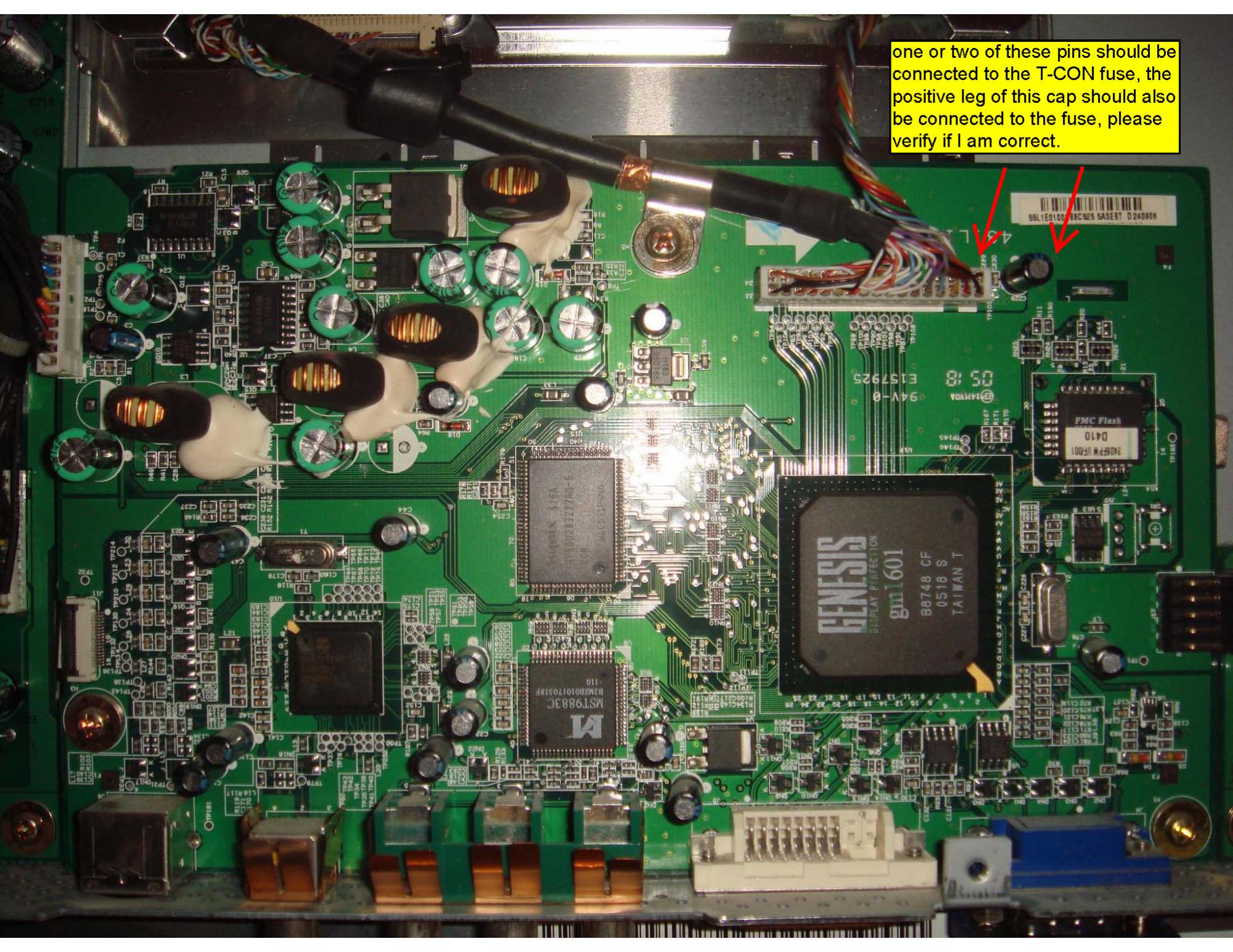

DELL 2405fpw
  • Mirage00
    replied
    Re: DELL 2405fpw
    Ok It seem like most of the green 220u CAPS are tied to the B+ CAP circuit I''m testing. Is that possible?
    Leave a comment:
  • Mirage00
    replied
    Re: DELL 2405fpw
    Is there anyway I could get the schematic for this board? It says a BENQ L1E01 A02
    Leave a comment:
    replied
    Re: DELL 2405fpw
    Well, I do not know what other method you can use to find out where the B+ feeding that point comes.
    Leave a comment:
  • Mirage00
    replied
    Re: DELL 2405fpw
    Originally posted by budm
    Make sure to use the lowest Ohm (200 Ohm scale) setting on your meter, no power to unit.
    Yes to both
    Leave a comment:
    replied
    Re: DELL 2405fpw
    Make sure to use the lowest Ohm (200 Ohm scale) setting on your meter, no power to unit.
    Leave a comment:
  • Mirage00
    replied
    Re: DELL 2405fpw
    Originally posted by budm
    OK, now we have established B+ pin (positive leg of the cap) to be the connection point that supply the B+ to the T-CON, now we just need to find out where it is connected to the other component on the main board. It is not easy but not much we can do since we do not have the diagram for this monitor.
    Ok, I started testing the B+ on the CAP to the outlined components and many of them test 0 when connected. I thought there would only be only one?
    Leave a comment:
  • selldoor
    replied
    Re: DELL 2405fpw
    @retiredcaps - thanks - will watch it tomorrow when the two cells are fresher.
    I didnt mean distracted on the initial recognition - you said later that you
    would have to look up the datasheets. Anyway having got them are his measurements of them within spec?
    Leave a comment:
  • retiredcaps
    replied
    Re: DELL 2405fpw
    Originally posted by selldoor
    Two of the "voltage regulators" are mosfets - think retiredcaps got distracted setting fire to his dinner.
    Since I couldn't read the part numbers, I took a guess based on its packaging.
    I attach the datasheets as despite everyones efforts I still dont know what they mean.
    My fellow Canadian, Afrotechmods, makes excellent easy to understand and short videos.
    http://www.youtube.com/watch?v=Te5YYVZiOKs
    Leave a comment:
    replied
    Re: DELL 2405fpw
    The F, FR: they are MOSFET's
    Leave a comment:
  • selldoor
    replied
    Re: DELL 2405fpw
    Two of the "voltage regulators" are mosfets - think retiredcaps got distracted setting fire to his dinner.
    I attach the datasheets as despite everyones efforts I still dont know what they mean.
    Leave a comment:
    replied
    Re: DELL 2405fpw
    NO , we are looking for direct connection with less than one Ohm resistance, just think of it like looking for another end of the wire, but in this case, it is the copper traces on the board.
    Leave a comment:
  • Mirage00
    replied
    Re: DELL 2405fpw
    Ok so when I connect to each of the devices in the outlined section does it matter what leg? + or -
    Leave a comment:
    replied
    Re: DELL 2405fpw
    OK, now we have established B+ pin (positive leg of the cap) to be the connection point that supply the B+ to the T-CON, now we just need to find out where it is connected to the other component on the main board. It is not easy but not much we can do since we do not have the diagram for this monitor.
    Leave a comment:
  • Mirage00
    replied
    Re: DELL 2405fpw
    Originally posted by budm
    I expect the pins on the right of the connector will be for B+ as selldoor said, and the + leg of the cap also check out to be 0 ohm as well to the fuse?
    Thats correct and the all check out at 0 ohm including + end of CAP.
    Leave a comment:
    replied
    Re: DELL 2405fpw
    I expect the pins on the right of the connector will be for B+ as selldoor said, and the + leg of the cap also check out to be 0 ohm as well to the fuse?
    Leave a comment:
  • selldoor
    replied
    Re: DELL 2405fpw
    I think its just the last 4 pins at that end of the connector that are usually the power.
    Leave a comment:
  • Mirage00
    replied
    Re: DELL 2405fpw
    OK please bare with me, I'm not sure how to check this. I hooked up the DMM in OHM mode with the monitor off to each one of the pins and the other end on the FUSE and most of them read 0.
    Leave a comment:
  • Mirage00
    replied
    Re: DELL 2405fpw
    Thanks budm, I will check later today.
    Leave a comment:
    replied
    Re: DELL 2405fpw
    0.34V at the T-CON fuse, means the T-CON is not getting the voltage for it to run.
    Please verify of what I think the connections are.
    We need to find that switched transistor that supplies the B+ to the T-CON fuse.
    Last edited by budm; 06-28-2012, 09:02 AM.
    Leave a comment:
  • Mirage00
    replied
    Re: DELL 2405fpw
    Originally posted by Mirage00
    Nothing shows on the LCD. The screen is a greyish black, the backlight is on because I can see the ccfl lit. Here is a pic of the monitor, its hard to see ( I was holding it up) but it shows the lights and buttons working at the bottom and the screen backlight on.
    BTW is this considered a white screen? Only the backlight is on.
    Leave a comment:
    LCD LED TV Service Menu Codes
    ALL LCD LED TV SERVICE MENU CODES
    Service Menu Code with Board Name
    China Universal Board / Jumper Board Service Menu Code
    Changhong Ruba Service Menu Code
    Ecostar LED TV Service Menu Code
    Orient LED TV Service Menu Code
    Haier LED TV Service Menu Code
    TCL LED TV Service Menu Code
    Samsung LED TV Service Menu Code
    LG LED TV Service Menu Code
    Videocon LED TV Service Menu Code
    Supra LED TV Service Menu Code
    Toshiba LED TV Service Menu Code
    Symphony LED TV Service Menu Code
    Veste/ LED TV Service Menu Code...
    10-31-2024, 03:58 AM
  • Bowline
    by Bowline
    06-11-2025, 10:13 AM
  • Aezakmi
    Dell 2408 - No OSD or input menu
    by Aezakmi
    A few days ago my Dell 2408 has stopped to working without any noticeable sign.
    It can be power on, power light stays green, backlight works but there is no OSD, menu input, Dell logo etc. It happens if there is some input source connected or not.
    I disassembled the case but I didn't see any failures on the board. The only element that looked suspicious was L6561 - there was some brown dirt under it. So I replaced this IC but it changed nothing.
    What else should I checked or is this repair even possible/worthwhile?
    Thank you for your c...
    01-29-2024, 04:12 AM
  • Akhlz001
    Dell Pro 13 Plus PB13250 Bios Unlock
    by Akhlz001
    Could someone help trying to unlock this BIOS, seems that Dell have changed the layout of new Dell Pro 8FC8 bioses from checking HXD - 4000 bits do not need changing, only 2000. However after FF the section starting from '01000' upto 2000 bits and then soldering the chip back it seems that the microchip on the motherboard is recovering the bios back to original settings after first boot. Has anyone found a way to crack this extra layer of security Dell have implemented? Seems both HP and Dell have upped bios security to match Lenovo by implementing extra measures on a separate...
    09-20-2025, 07:15 PM
  • master3112
    Dell Inspiron 5590 Board 18778-1 no charging, charging not possible
    by master3112
    I would like to share my experience about charging issues with Dell power supplies with the tech community. I am working on a Dell Inspiron 5590, Mainboard 18778-1 with charging problems. The device can be switched on and works so far, only the message appears at startup:
    Alert! The AC power adapter wattage and Type cannot be determined. The battery may not change. The System will adjust the performace to match the power available.
    The power supply unit is not recognized in the Bios and the charging process is set to "idle". I use original Dell battery, type...
    07-29-2025, 01:55 PM
