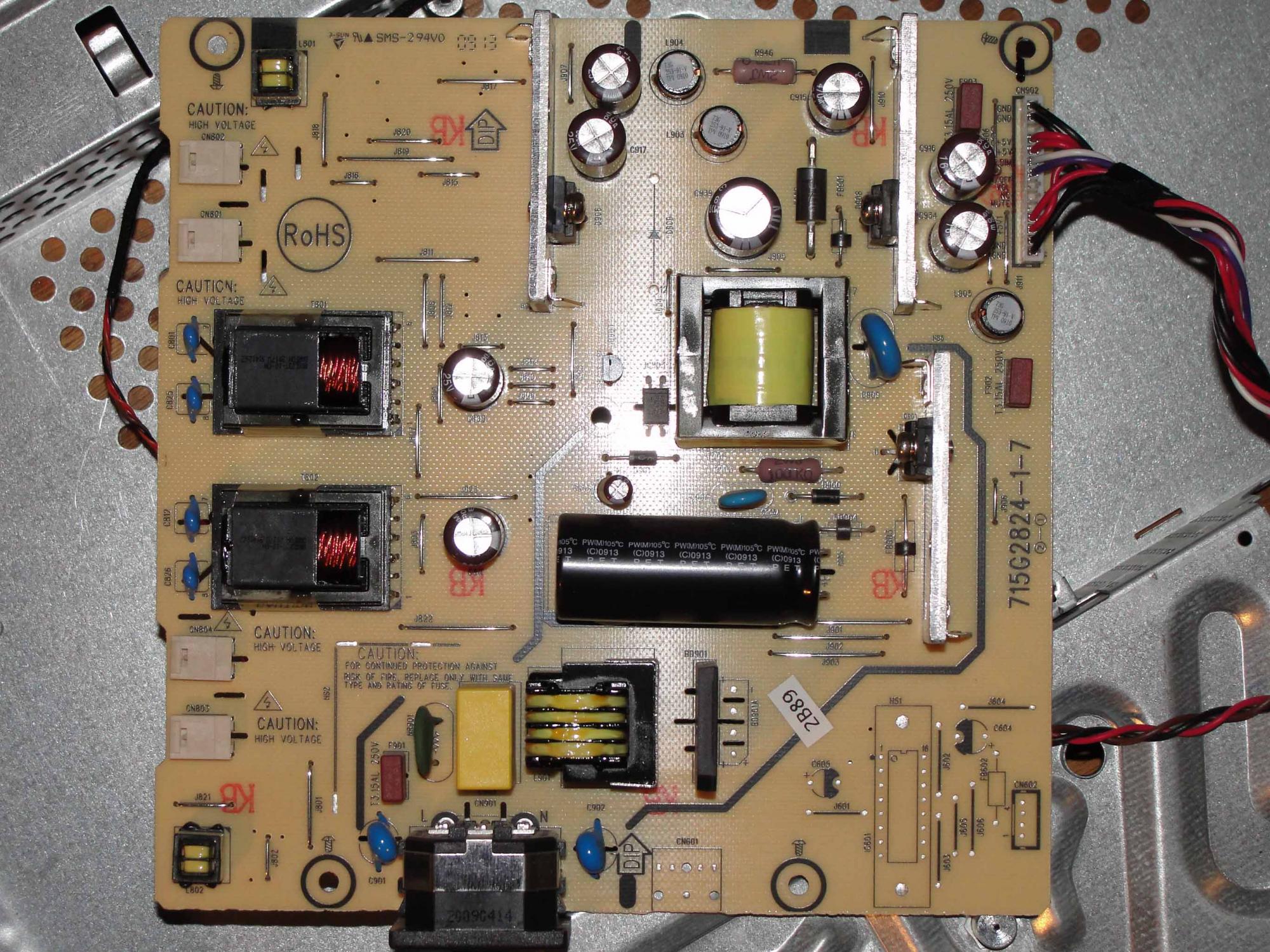

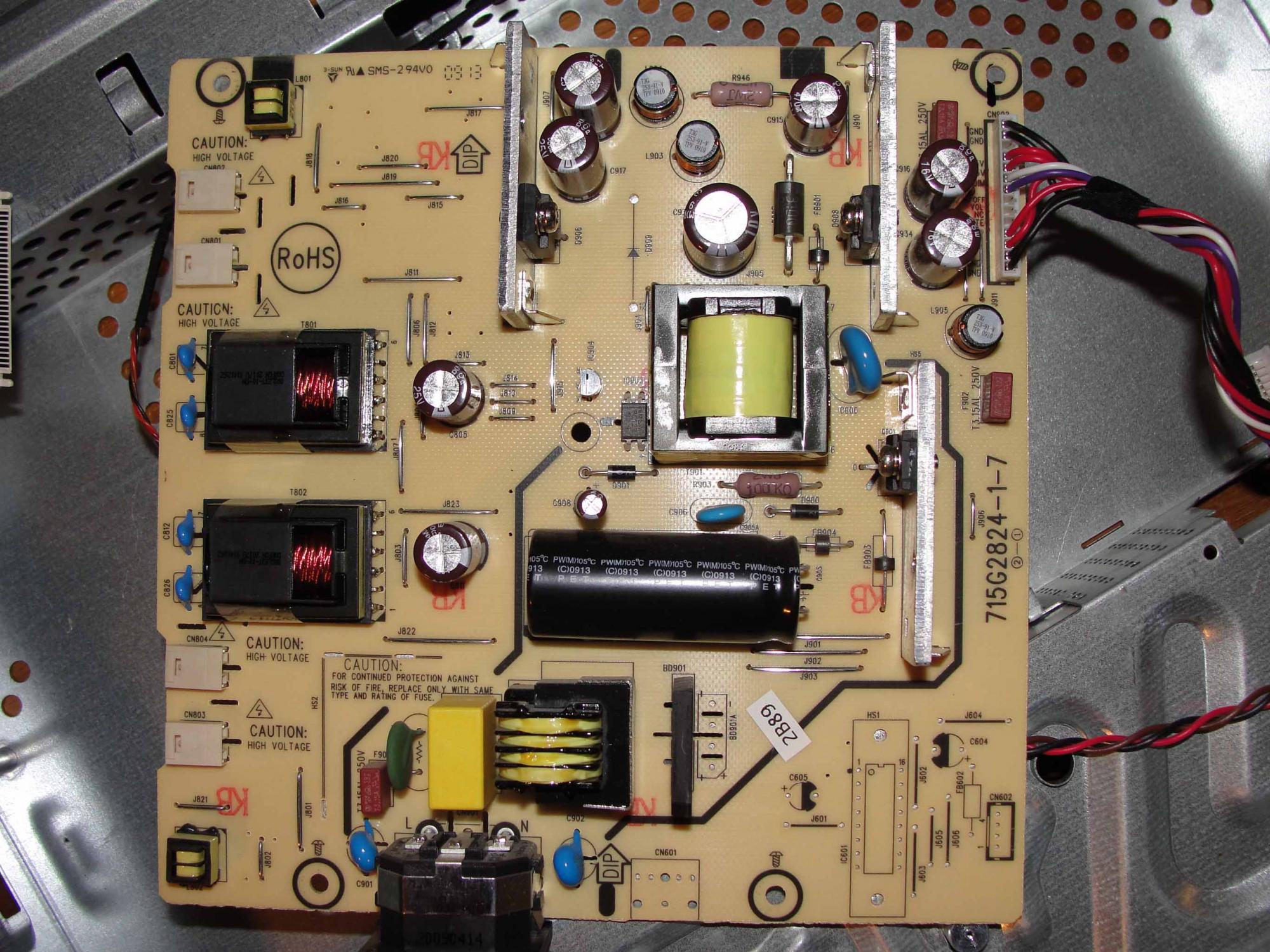

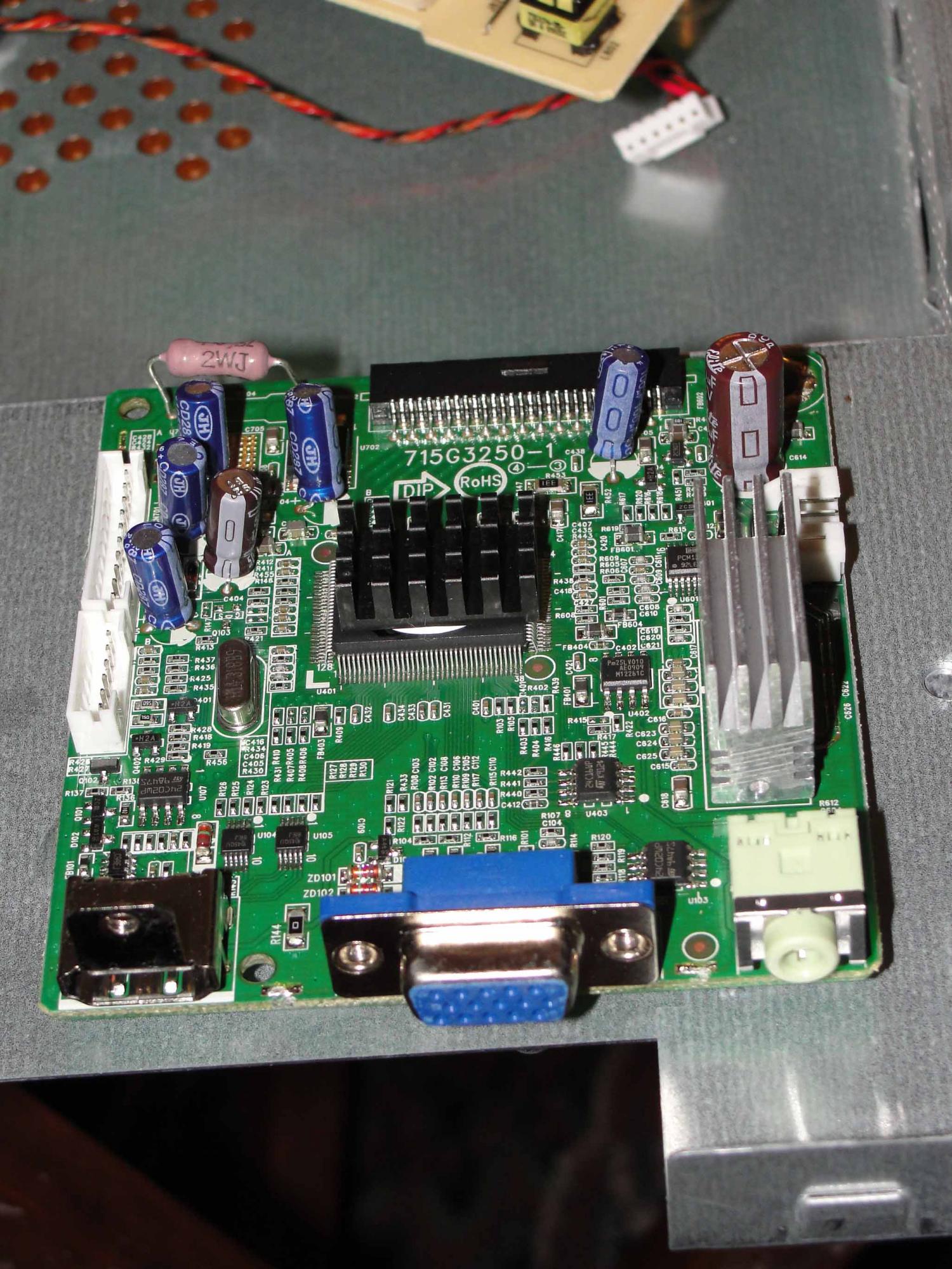

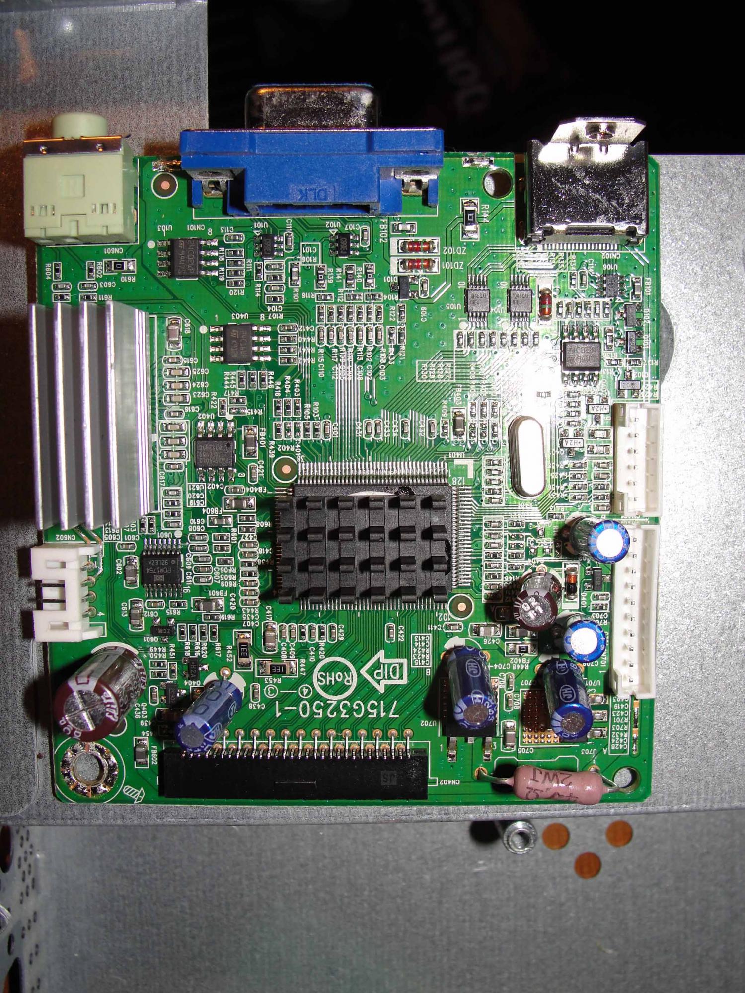

    Just started having problems with this monitor and not sure why. I have it taken apart and can't see any bad caps. I was hoping someone might have an eye for what's going on better than I.
    I can turn it on and it will run fine for random amounts of time. From turning off immediately to waiting half hour. Sometimes it simply won't turn on. Any help would be greatly appreciated. Thank you in advance.

        Re: HP w2338h LCD Monitor randomly powers off and randomly won't power on.

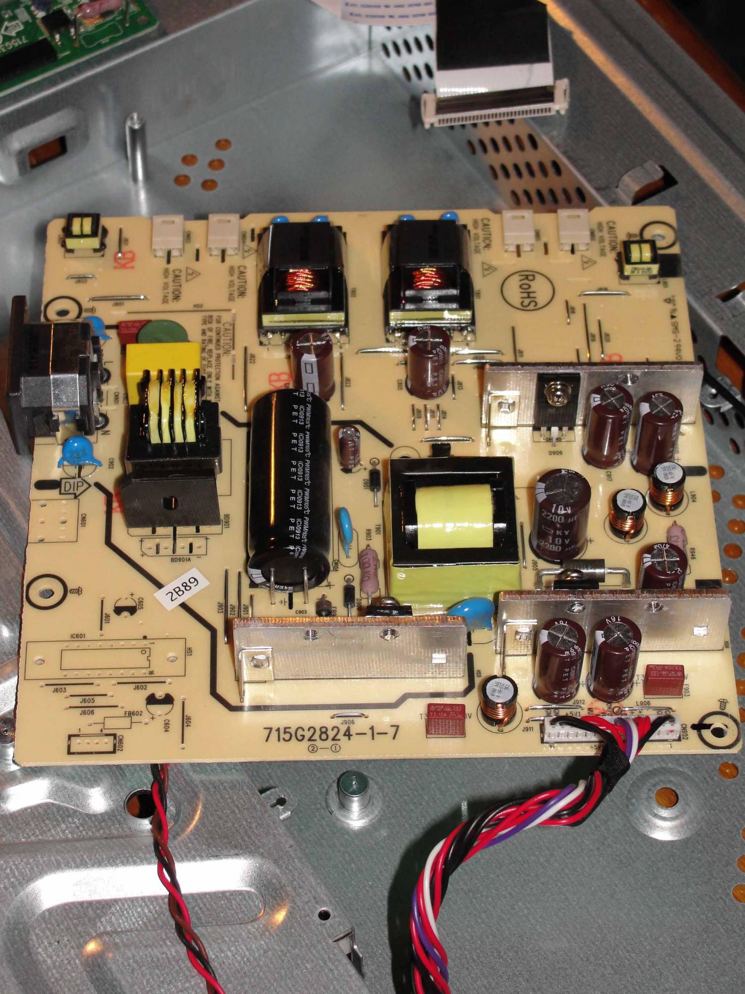

        Hi - Good set of pictures thanks -Can we have similar for the backs of the boards if possible without the flash.
        Intermittant problems are often difficult to bottom. Whilst the caps may not be bulged or leaky most seem to be ELITE which are not considered great, particularly on Power Supply. - Are they all elite?. If no -one can spot anything else perhaps consider a recap - if it runs hot they may be dried out.
        There are a number of these coming up where the ccfls are broken - they may be extra brittle so suggest you handle panel with care. Also there has been some with burning/ arcing reported at the ccfl end wiring - you could check for this - maybe triggering a protection circuit and shutting it off . Perhaps Senndogg was working on that theory - if the power light stays the same colour and just the screen seems to go off it could be the backlights. When it is in that state can you see any image of what is on the pc - perhaps by shining a flashlight at the screen at different angles

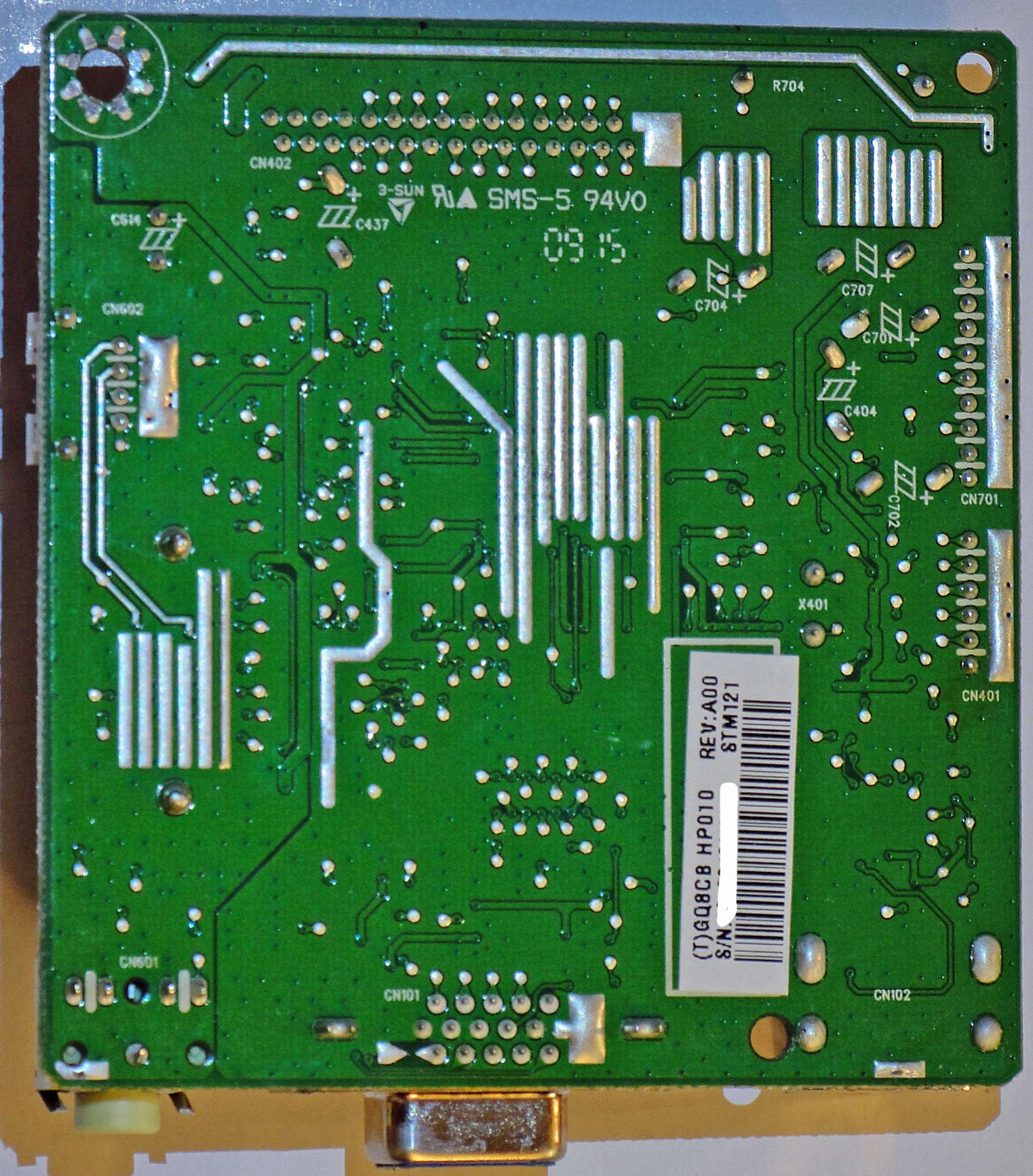

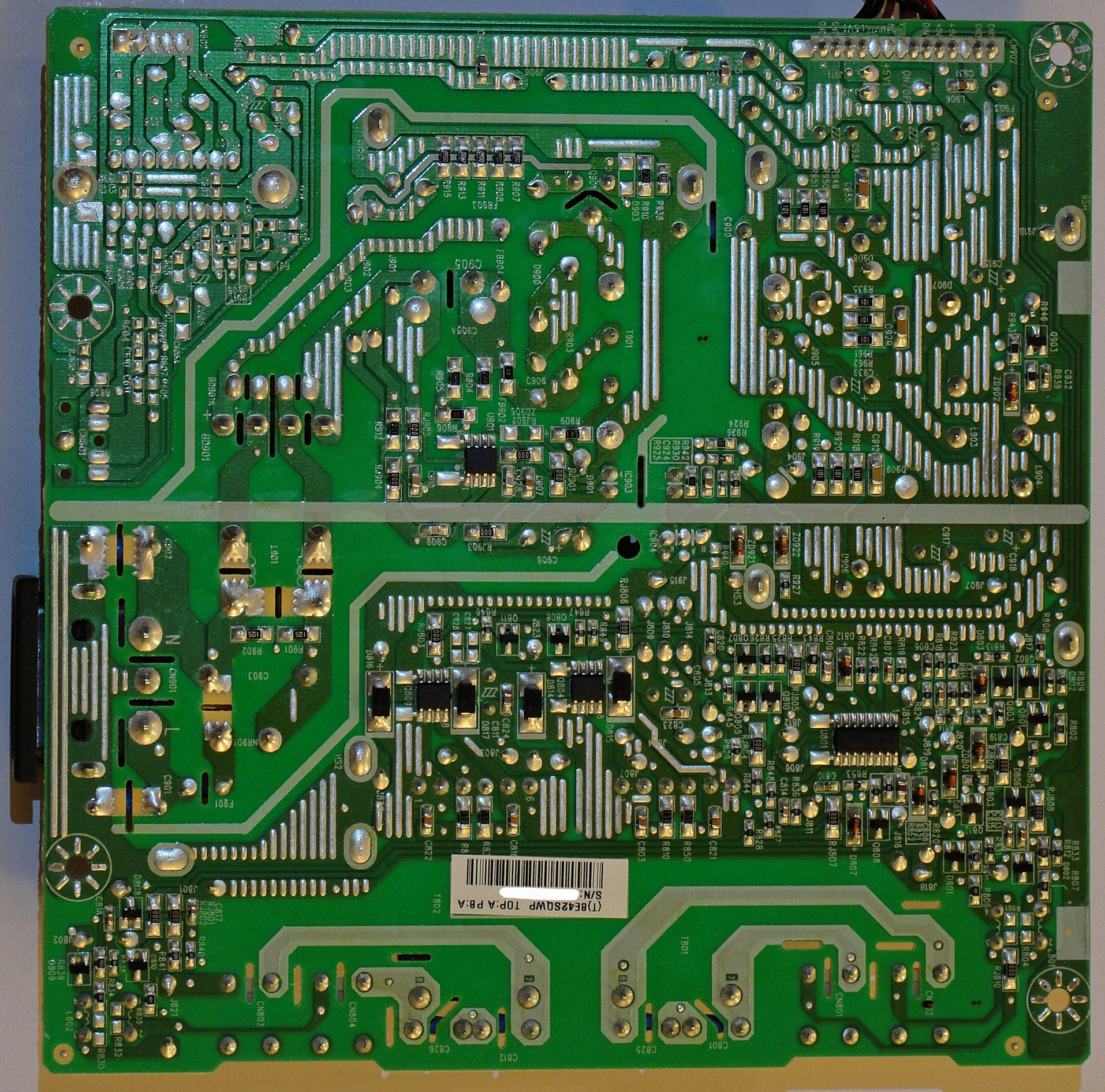

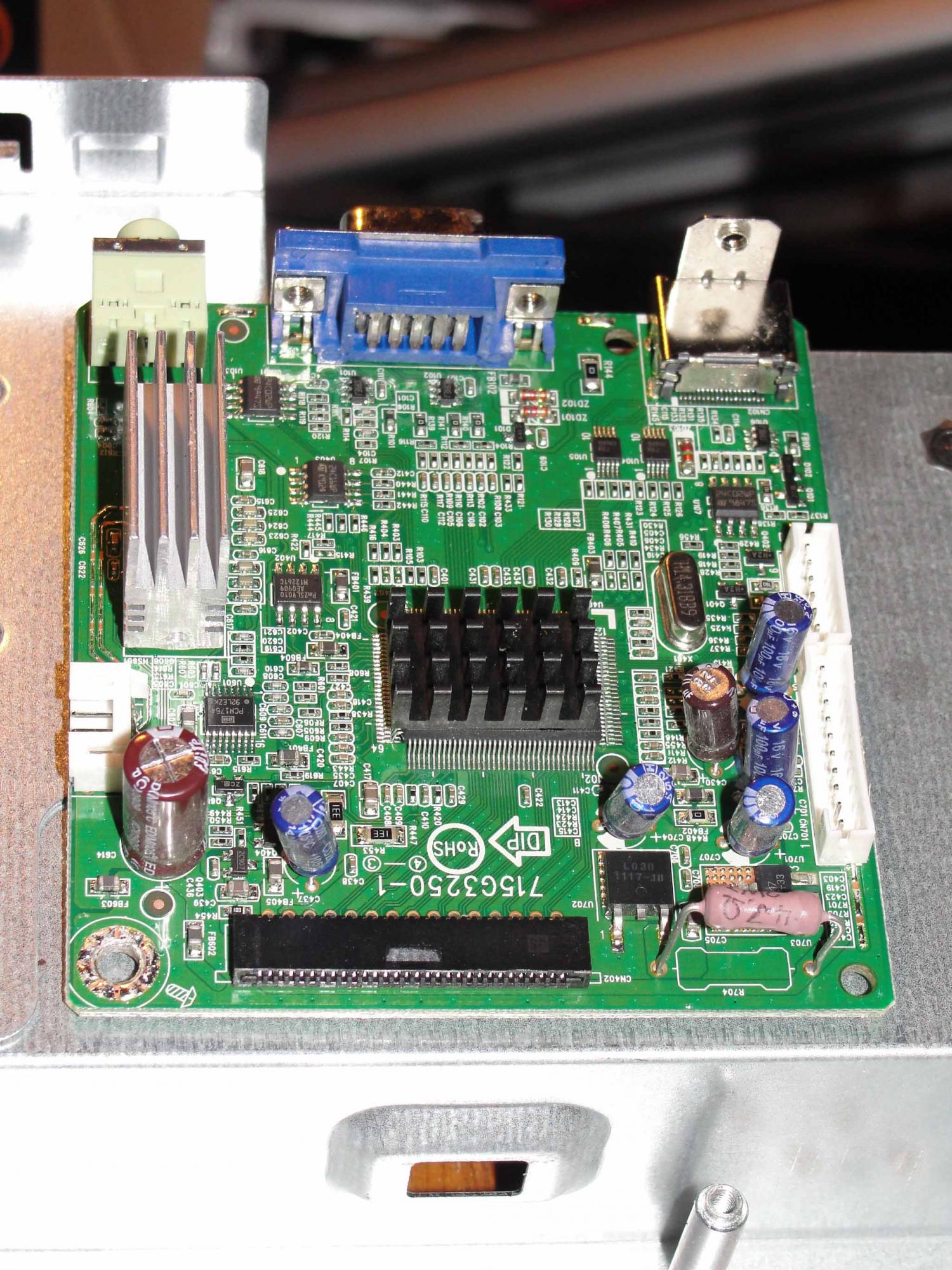

            Backs of the boards.
            2088 is the logic board. 2089 is the power board.
              Next time it is all connected and working measure the voltages on the power out socket on the power supply board. When it goes off measure again and post the results.

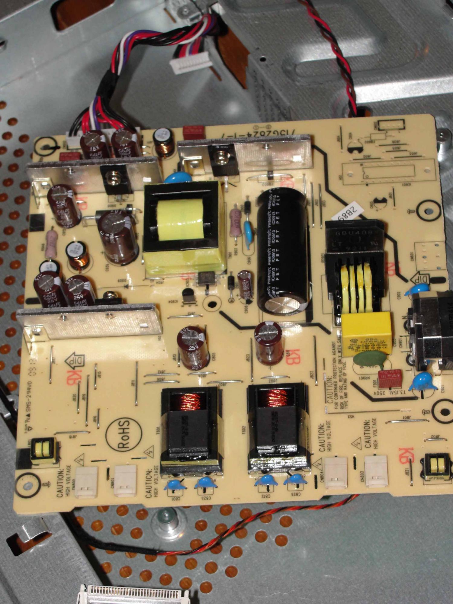

                    @selldoor: in fact i have had a similar issue with a hp monitor, when plugged in the mains; led was amber and pressing the power button had no effect. sometimes it started ok. it was an easy fix: caps in the 5V rail.
                        it was a different board but at yours seem to be the C915 and C939 in the power board.
                          Thanks very much. I found a complete cap replacement kit on Ebay for 13. I'm going to hook everything up one more time and check for shorts while it's powered up. I found a black mark in the casing that looks like a short. SO I think selldoor was on to something when he talked about the safety being tripped. That really sounds like the behavior it was showing.
                          Course, your description is just as valid really. So, both will be tended to. I really appreciate the help guys.
