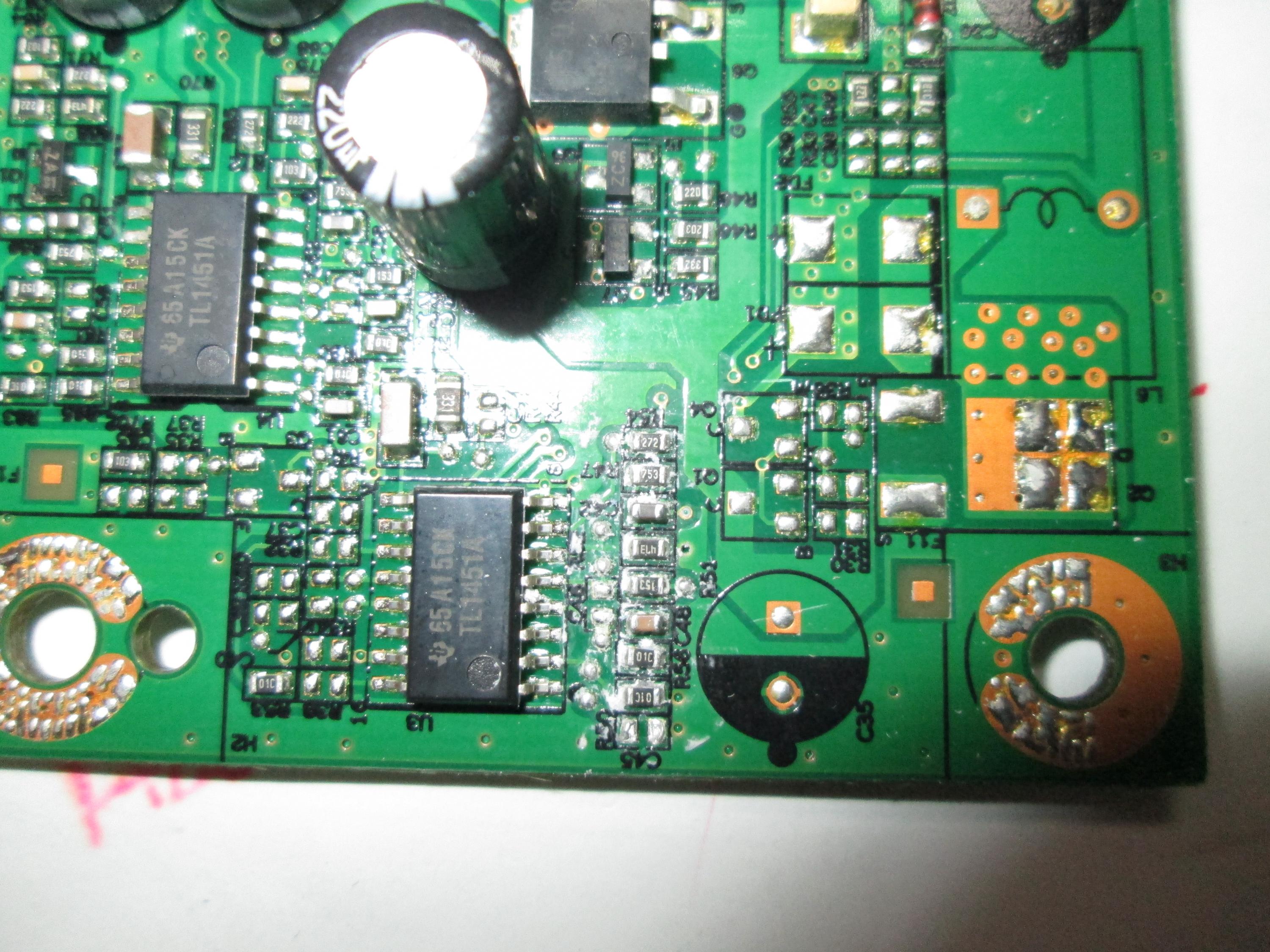

        I am curious, are the parts in that section damaged or missing?

          #84
          Re: Dell 2007FPB teardown
          If there was the silicone, I would guess maybe damaged

            #85
            The parts are damaged

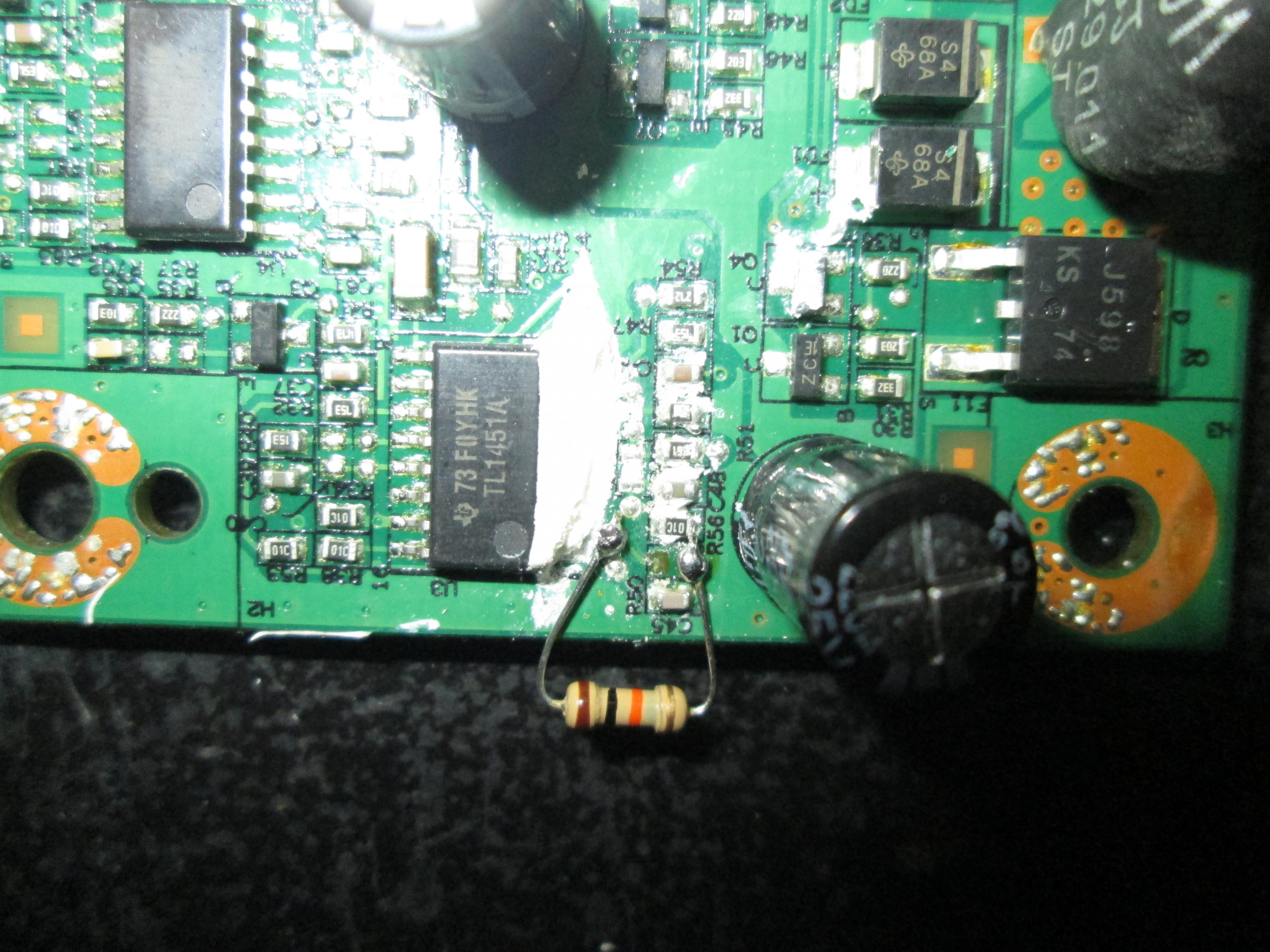

              In my case (2007FPB) it was R50 on the USB board that was open. Labeled as 01C (10K Ohm).
              Managed to pull one of the pads off when I was desoldering the resistor, but there is another spot just next to the pad I was able to get to.
              Not sure why Dell felt the need to gunk up this area with the silicone. Would have been a TON easier to troubleshoot without it.
              Threw a 1/4watt 10k in the spot and everything appears to be back to normal.

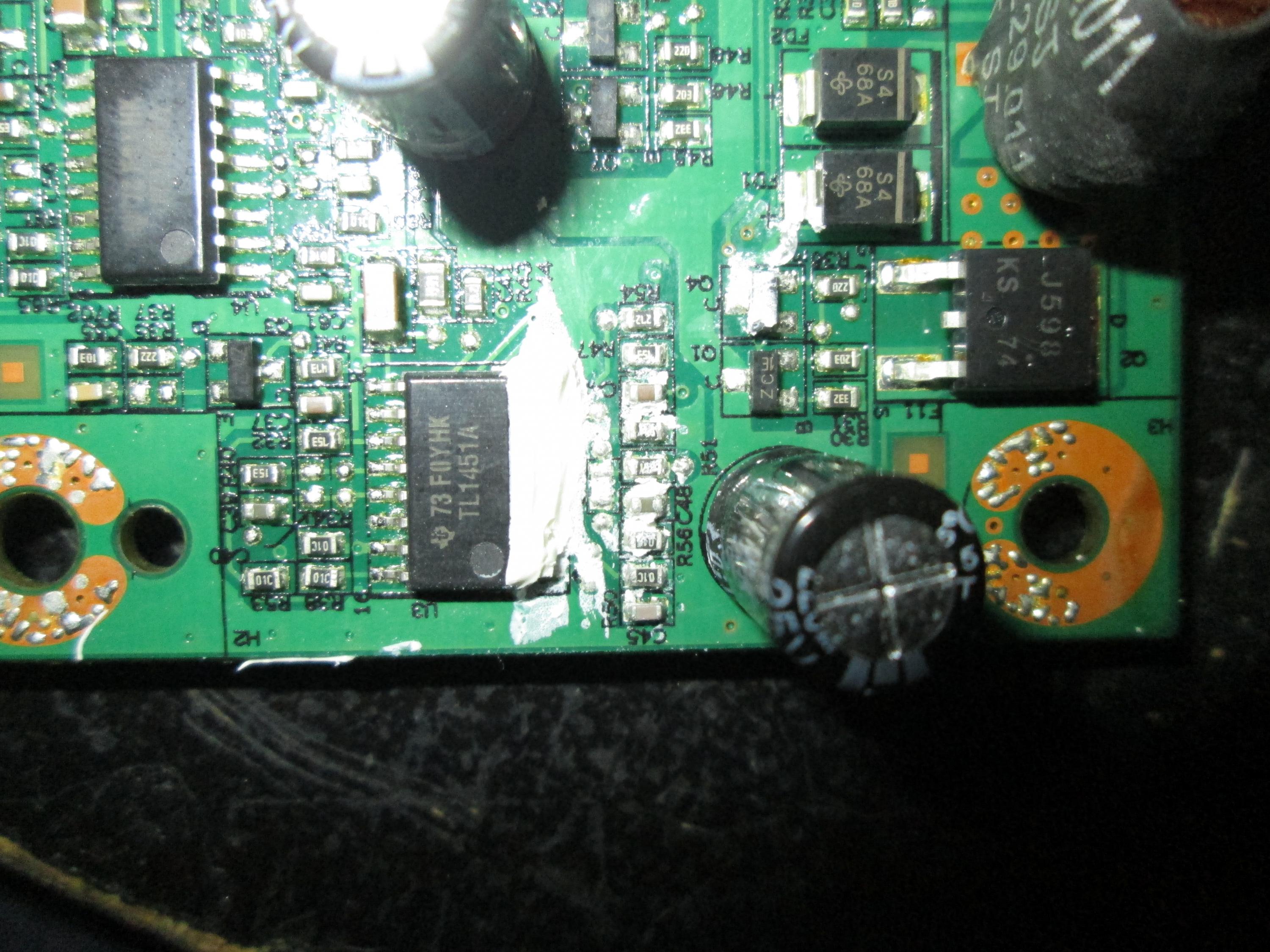

                Does anyone have any suggestions for how to remove the white glue?
                • ctechbob
                  • Jun 2018
                  • 3
                  #88
                  You just have to carefully scrape it off with something plastic. There's not much else that will do it. I don't think there's any chemical that would take care of it and not hurt the board.

                        #91
                        My second 2007FPB took a dump earlier today. Immediately went to the resistors and there were 3 of them pretty far out of spec, a 2.7k 47k and 75k. Oddly the 10k's that were bad on my other monitor showed fine. I'll have to look at the pictures I took to see if the boards are different. But its back up and running like it should be.

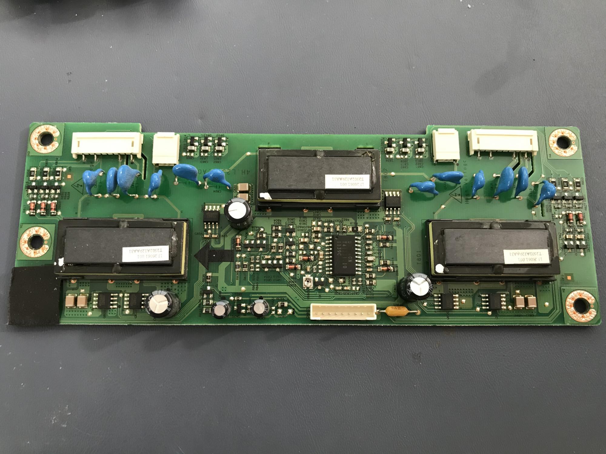

                          #92
                          Hi everyone,

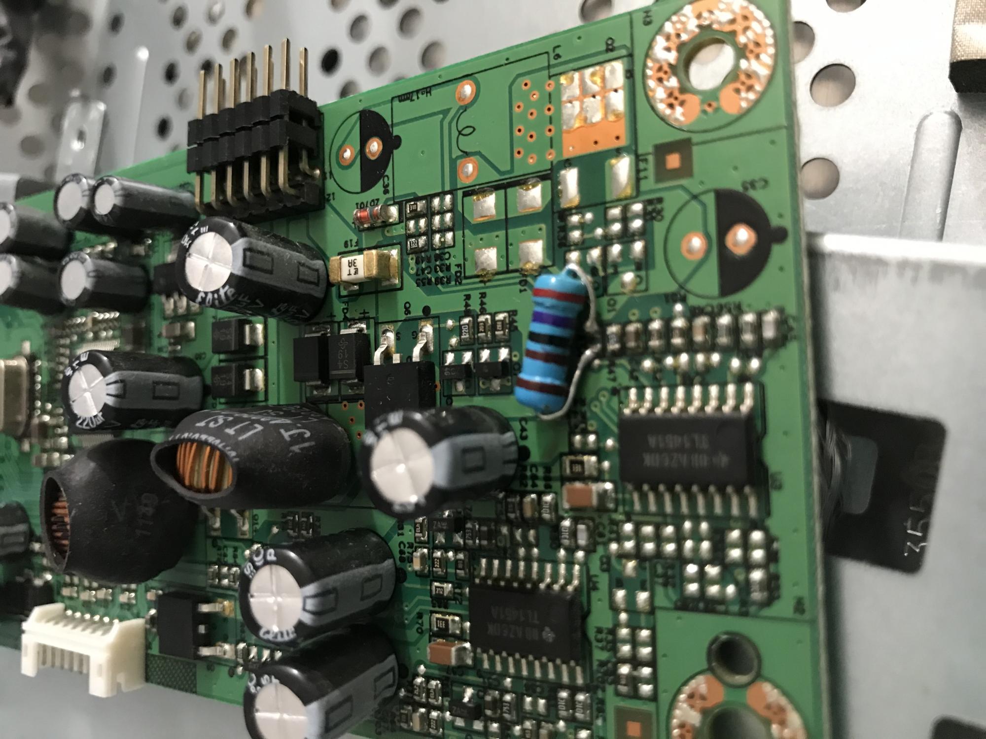

                          I have a Dell 2007FPb and found this thread with others experiencing my issue. My monitor turns on for about a half a second before the screen turns black. This is in the self test mode also. I took it apart and did not find any bulging or leaking capacitors. I tried replacing the 272 resistor others had mentioned in this thread, but it did not work and my symptoms are the same. Additionally I did not have a dielectric white blob on my board when I opened it like others have seen. See the last picture where I almost exactly copied someone earlier in this thread with a 1 W resistor.

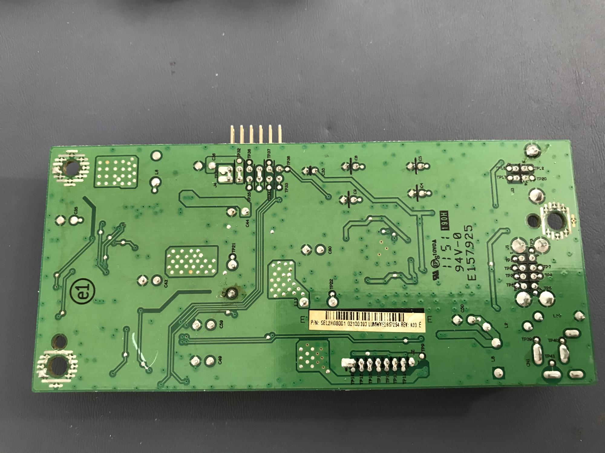

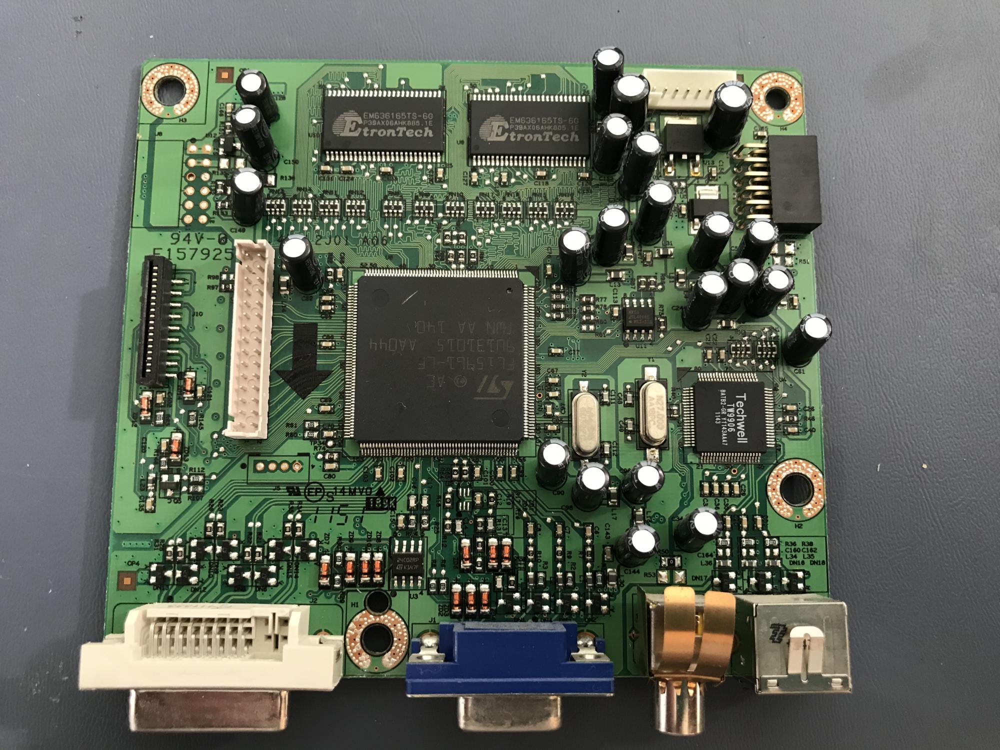

                          I don't really know where to go from here. I really love this monitor, it was my favorite monitor because it was so bright and crisp and sharp colors. I would REALLY like to get it working. I have a multimeter, but I have never used one before, and it's a cheap harbor freight one. I don't know if it is up to the task but I will measure anything anyone asks me to measure and report back. Does anyone have any ideas please? I have included pictures front and back of all four of my boards below. Thank you so much for your time.

                          • Behemot
                            • 4845
                            • CZ
                            #93
                            Does it shut down completely, or just the backlight?
                            • Muggz
                              • May 2020

                              #94
                              I reassembled it just to test. Self test comes on for half a second, and then the screen goes black. The power light and the number 2 light stay lit. It does not appear to be backlit, and when I shine my mobile phone light on the screen I don't see anything. I ordered another multimeter on Amazon and expect it to arrive tomorrow. Thank you for responding.

                                #95
                                Phone's usually not enough, there are two polarisation filters 90° against each other so almost no light comes through, you need some strong light to se. However if the indicator LEDs are on, likely just the backlight is the problem.

                                    #97
                                    Check the secondary sides of those three inverter transformers, if all six have the same (within 1-2 %) resistance.

                                      #98
                                      I had no clue what you meant, and several YouTube videos later... lol (I like this though, I’m learning!)
                                      Chip 1 - 878 and 1037
                                      Chip 2 - 1029 and 1029
                                      Chip 3 - 1020 and 1017

                                        #99
                                        If that's correct, first transformer's busted, that's what's making the driver shut down.

                                          #100
                                          Thanks! I wasn't sure how to look up and order transformers. It doesn't seem to be as easy as resistors. So I picked up an inverter board for $12 off of eBay. It should arrive in a week and hopefully I can pull one of the transformers off of that.
