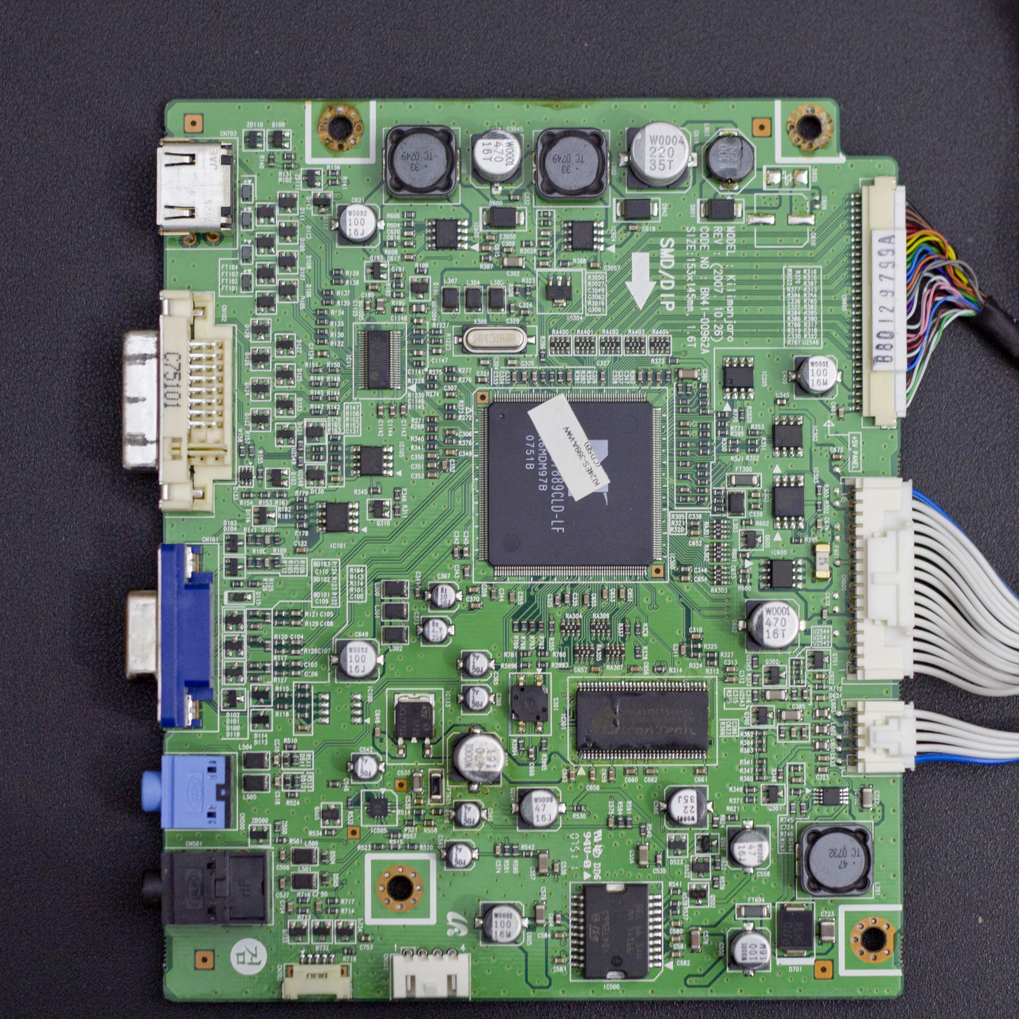

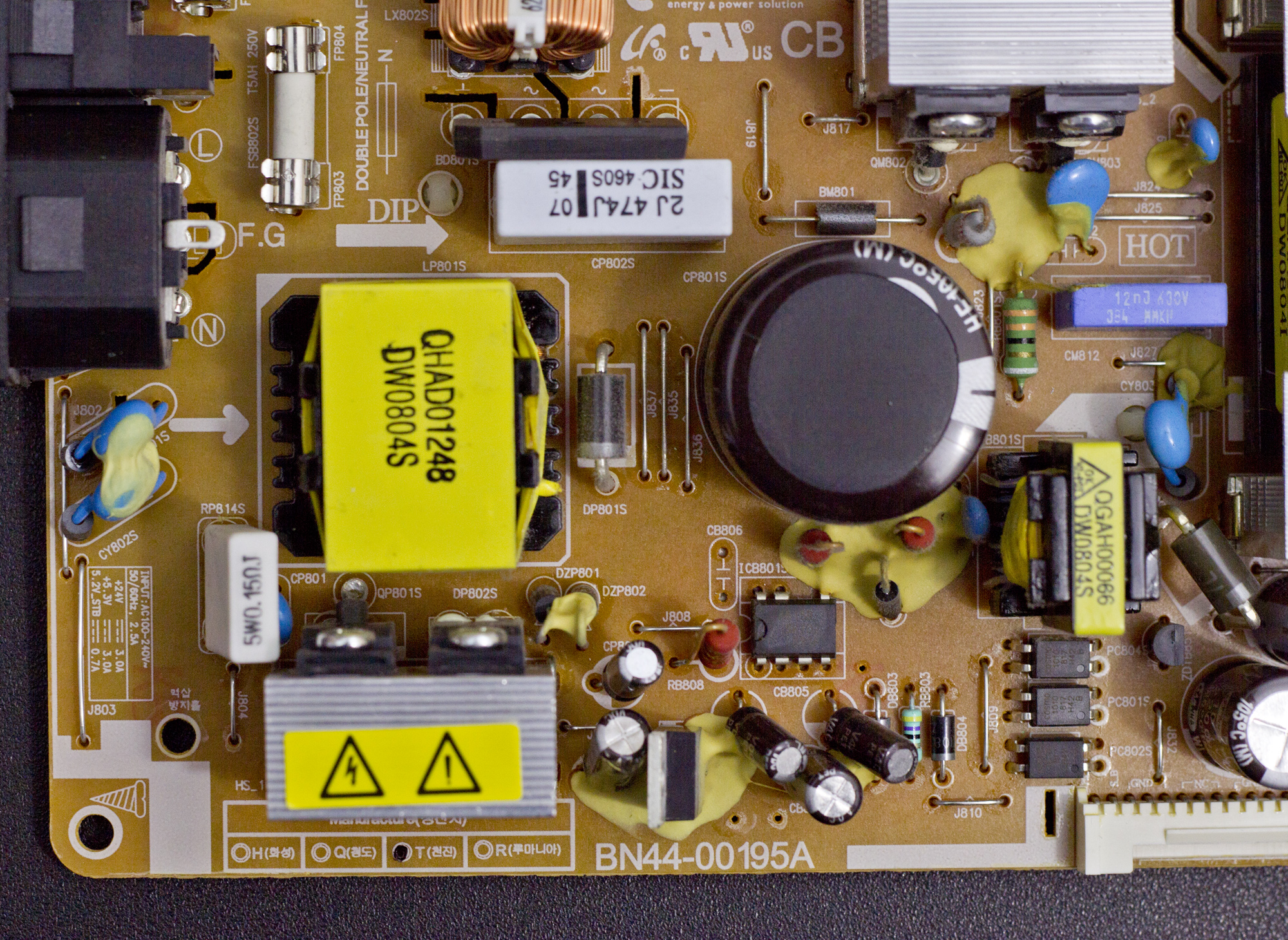

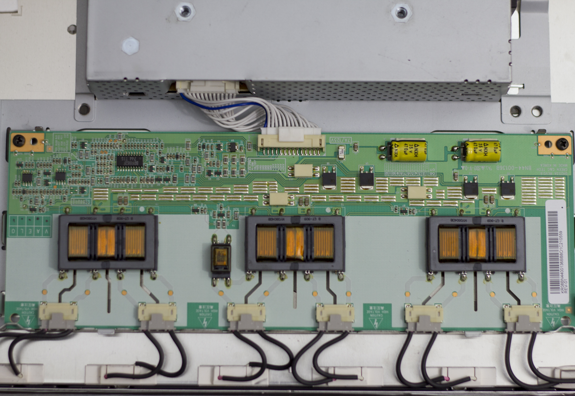

    Hi everyone,
    I've been lurking around the Badcaps forum for a while trying to find a solution to my Samsung 2493HM's intermittent death. Unfortunately I wasn't able to find a solution to my exact problem. I'll list my observations below:
    -Screen suddenly goes black, this includes a loss of HDMI speaker output. This occurs both with video/audio from PC and PS3. The power light remains lit solid when this happens.
    - If I leave it unplugged for a period of time it will work again for a period. I had it sitting unplugged for a few weeks and it worked flawlessly for a day and a half. Once it packed up again, a short cool-down was giving me 5-10 minutes use (or nothing at all)
    - After leaving it powered on with a black screen, sometimes there will be a series of intermittent pops. These follow no obvious pattern and range in loudness.
    - Occasionally after the screen blacks out there will be a loud screech and the screen will burst back to life. If I give the screen a good tap on the bezel I can force it to do this the odd time.
    - A quick inspection of the power supply board by my not-quite-untrained eyes didn't reveal any bulging caps. I did notice what appeared to be burn marks around the edge of the logic board, but I'm no expert, so that may not be the case.
    At any rate I'll crack it open again and take some decent photos. Thanks in advance.

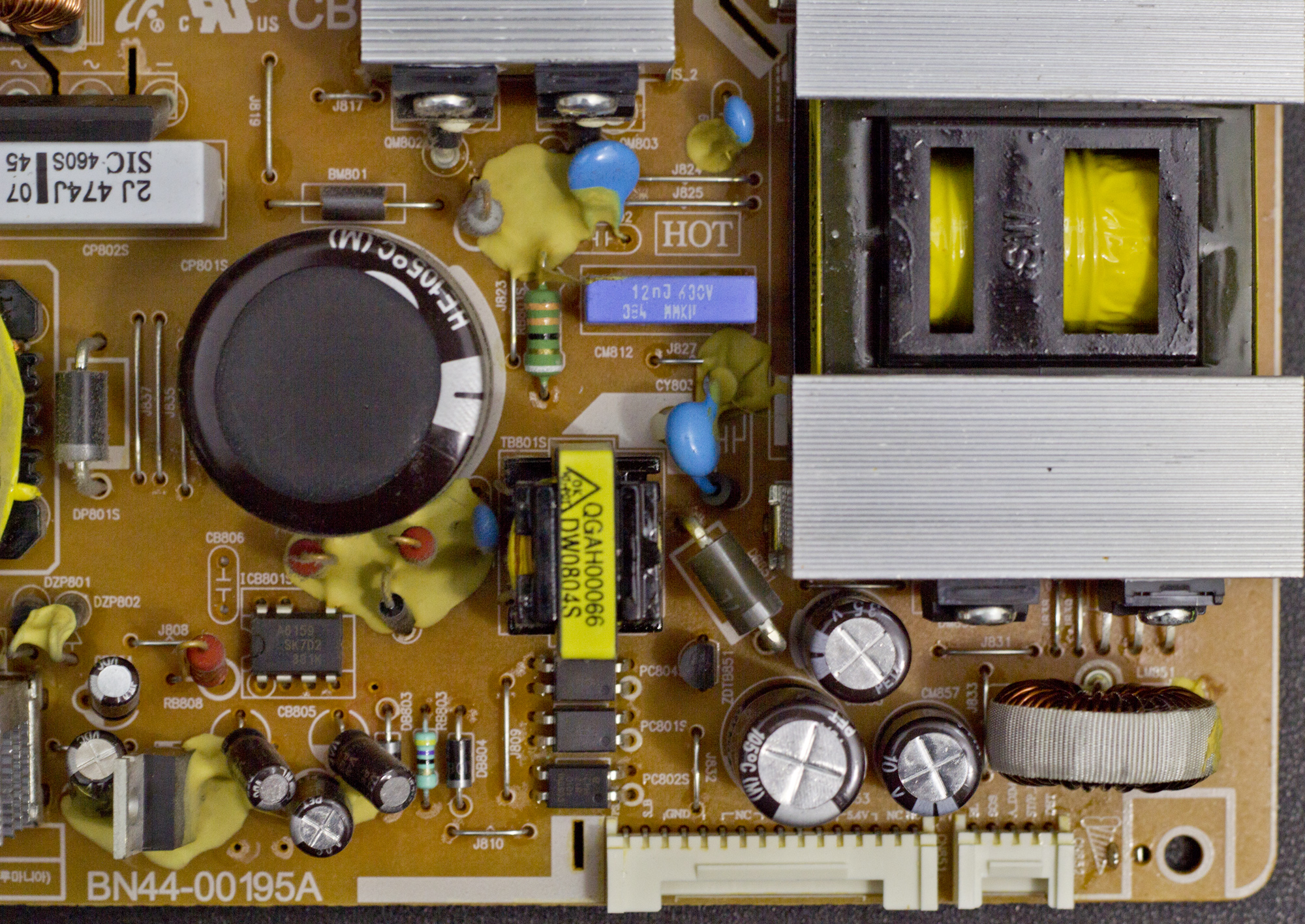

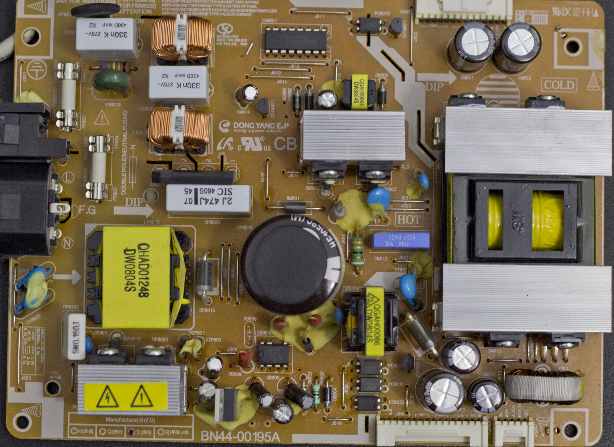

    1) Post clear focused top down view photos of all your boards following my sig file below exactly.
    2) Do you have a multimeter and do you know how to use it?

      Re: Samsung 2493HM On the way out

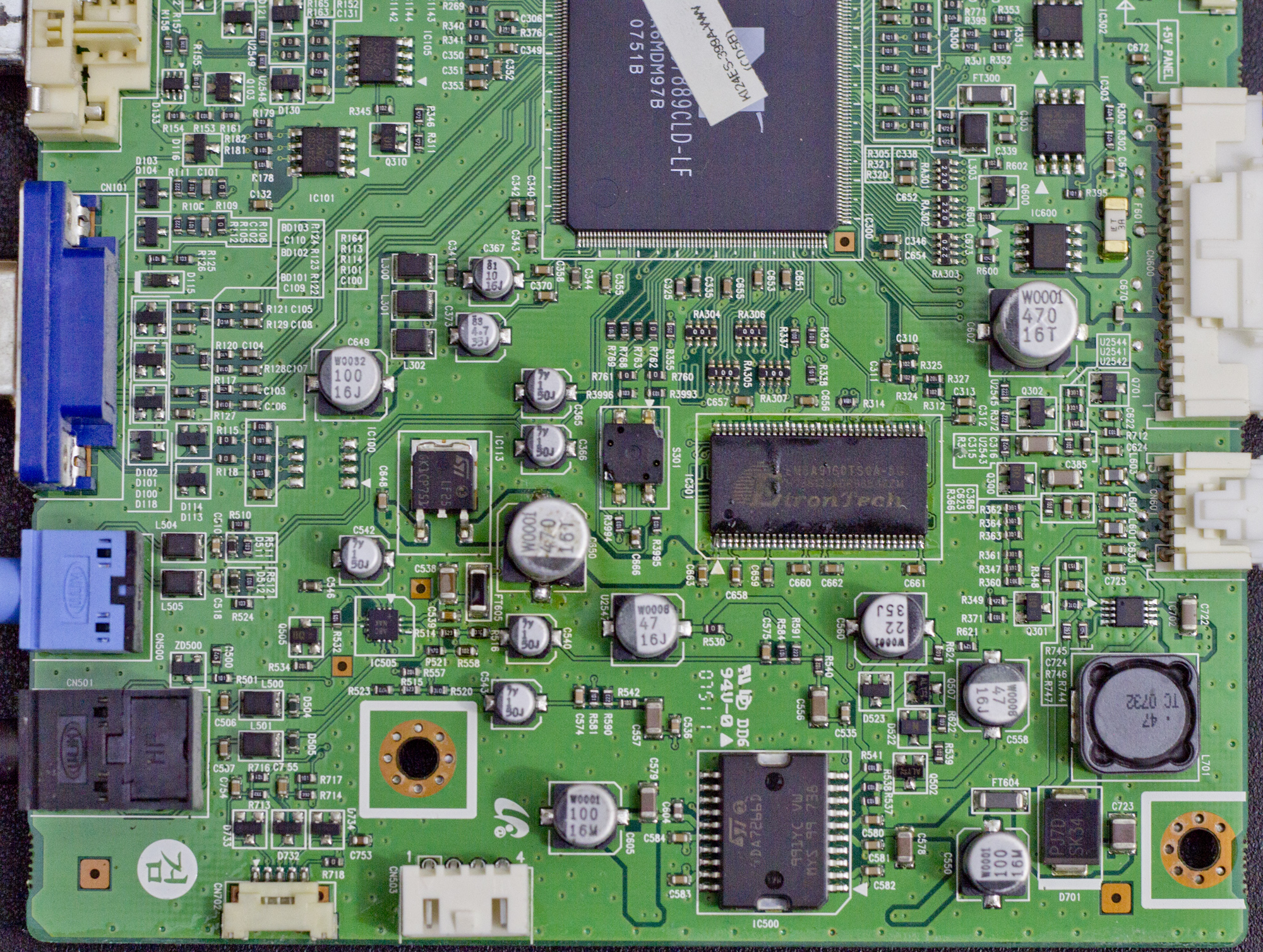

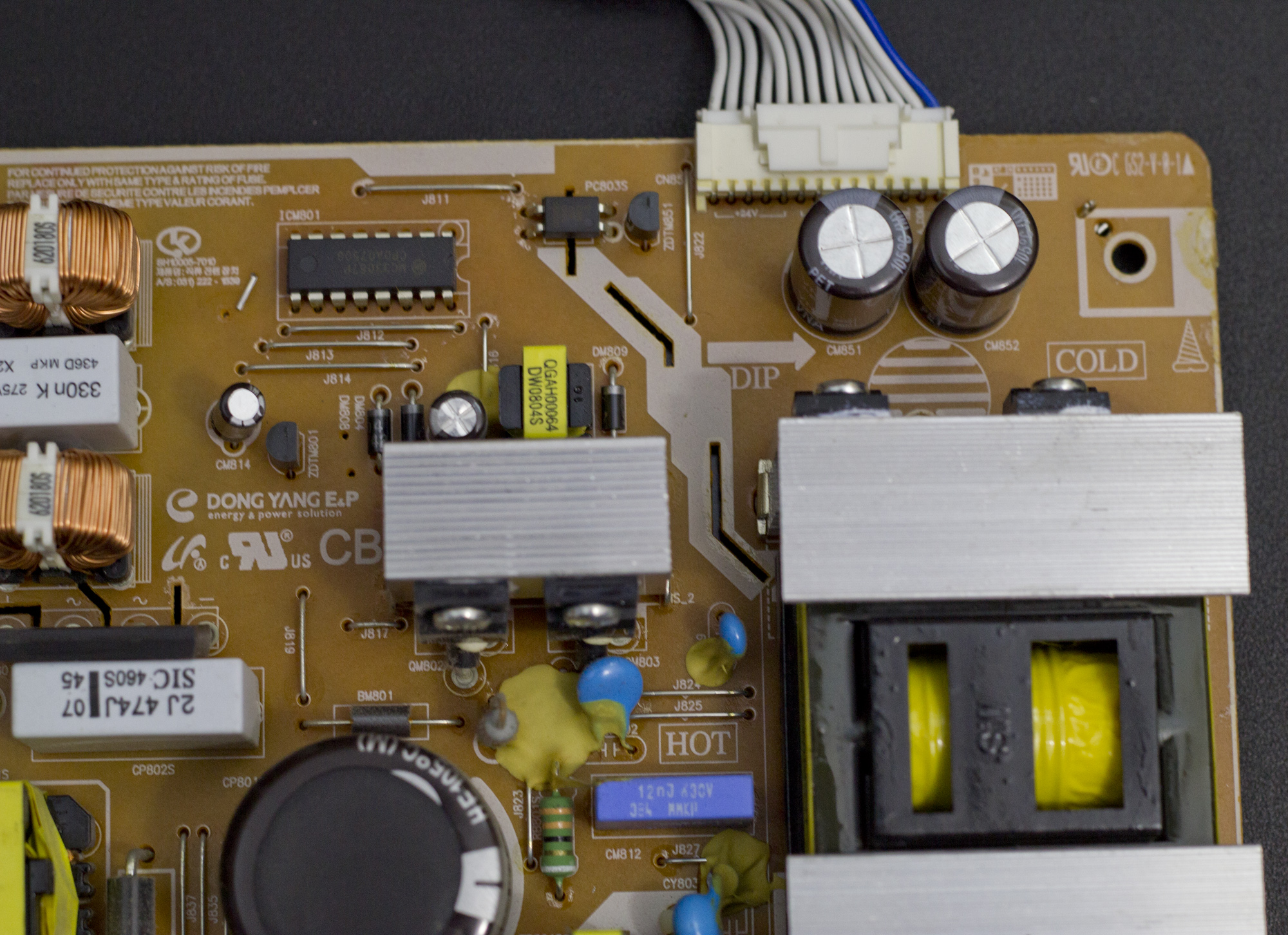

      Pictures are attached. Let me know if more views or closeups of anything would help.
      I have a multimeter, but I don't know how to use it. I may be able to get one of my electronically inclined friends to help me with this part.
        1) Get one of them to show you how to measure DC voltage.
        2) Measure each pin of the 3 connectors (circled in red).
        3) Measure each pin on the 3 connectors when the monitor is working. This is your reference.
        4) Do the same when the monitor is not working.
        5) Report both.
          Alright, finally some progress. I've got results from the two connectors going to the logic board. My electronically inclined friend doesn't like to mess around with high voltage stuff (and I don't blame him), so measurements are from the logic board side.
          We also swapped a blown cap on the logic board, but that hasn't fixed the problem.
          Working-Not working
          5.3v -N/A
          2.3v -0.1v
          2.9v -0.1v
          0.6v -0.2v
          4.4v -0.2v
          N/A -N/A
          N/A -N/A
          5.4v -0.5 - 3.9v
          5.4v -0.5 - 3.9v
          5.4v -0.5 - 3.9v
          GND -GND
          GND -GND
          GND -GND
          N/A -N/A
          N/A -N/A
          N/A -N/A
          GND -GND
          GND -GND
          GND -GND
          5.2v -5.2v
          3.2v -3.2v
          The fluctuating 5v seems to be tied to the speaker popping when the display isn't working.

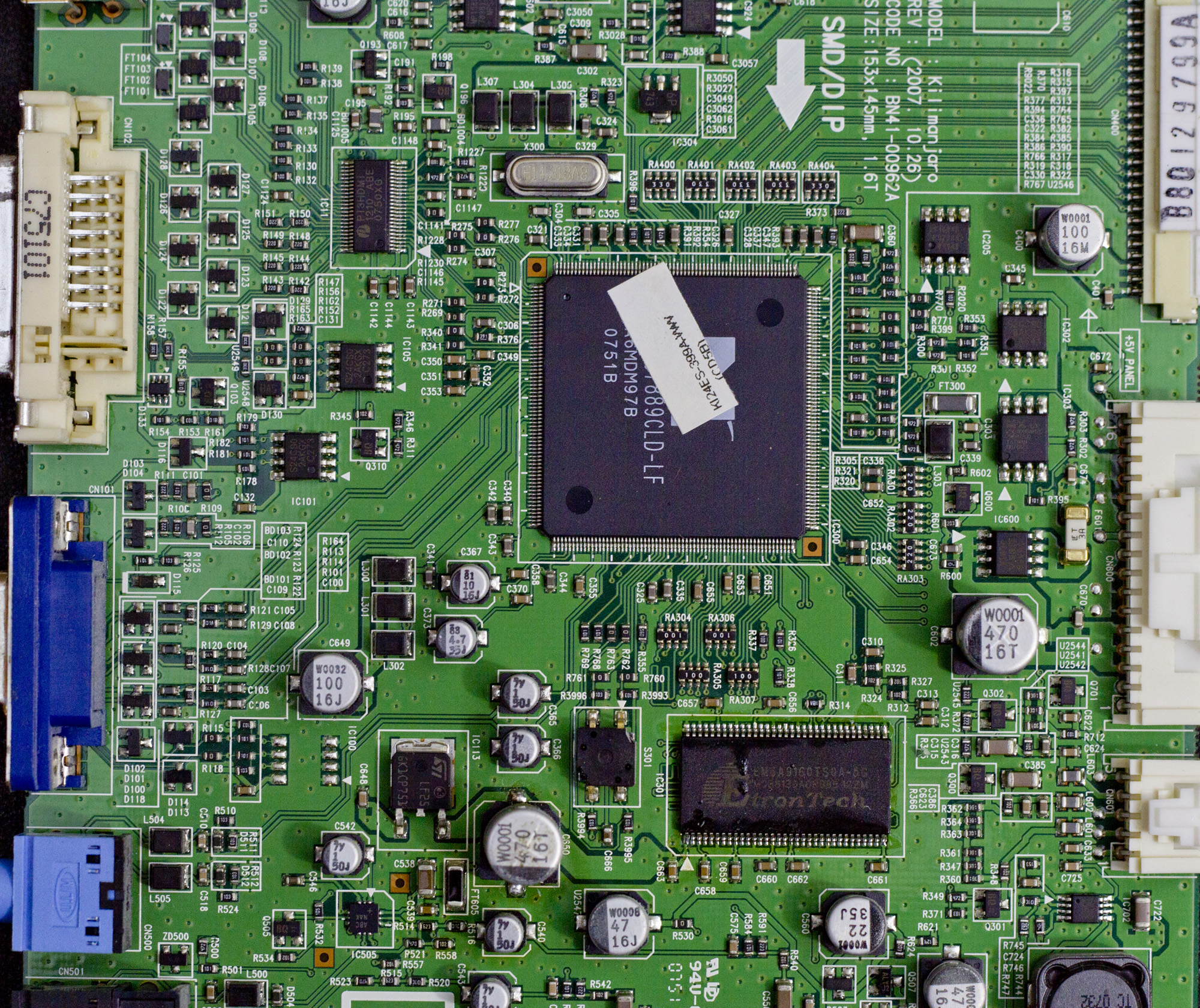

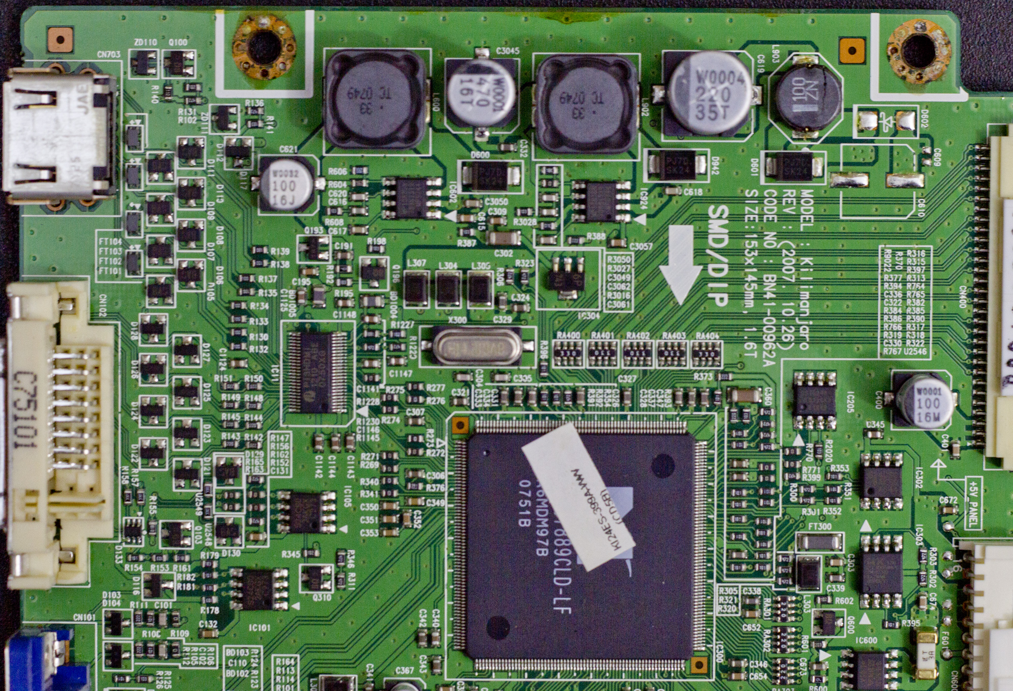

              All those connectors I circled in red are on the cold side.
              I didn't see a blown cap on the logic board at first glance, but I do notice that L903 has a crack at the top. L903 is an inductor.
              Which cap was bad on the logic board?
                Oh, I meant the proximity to high voltage components. Neither of us has particularly steady hands.
                Picture attached. We we're taking a closer look at the burn marks on the logic board when we noticed the big one in the center of the frame wasn't straight. Turns out it had popped and was leaking from the bottom.
